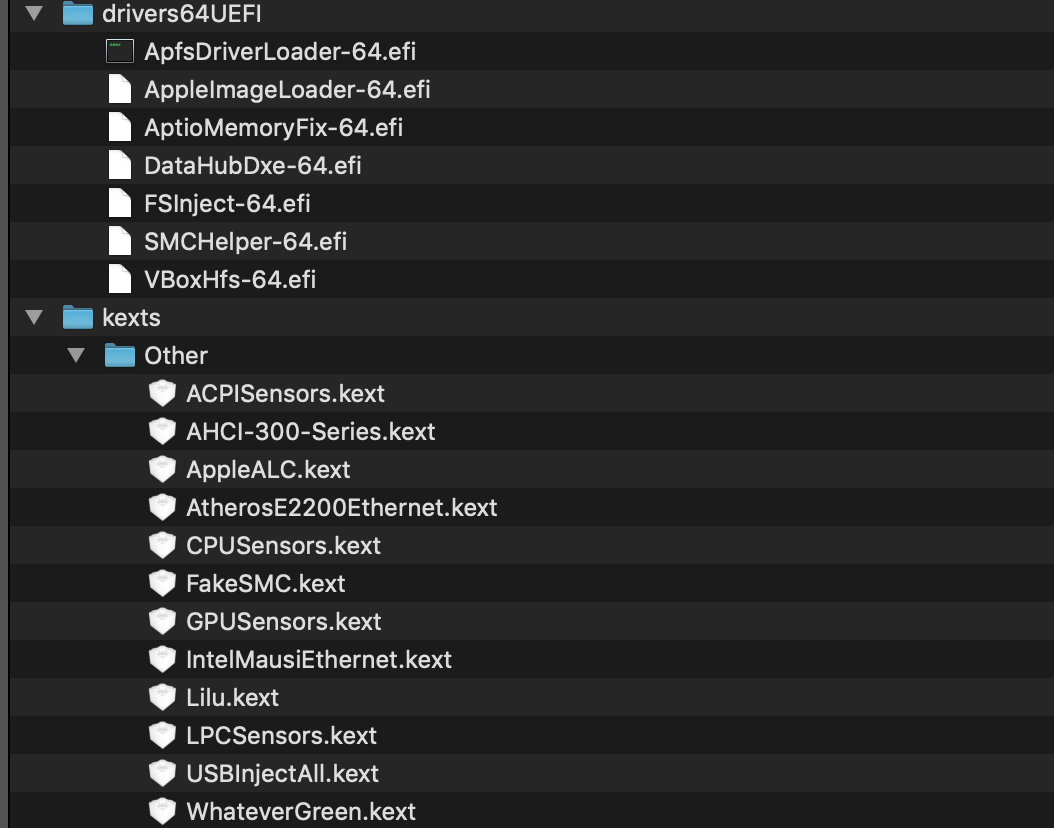

SavageAUS Posted November 17, 2018 Share Posted November 17, 2018 Update post. I don't have external GPU. Dont work USB 3.0 (externals hdd) e dont word USB 3.1 with adapter USB-C HDMI. Once moreWhich Wifi card is in your machine?Have you created an custom SSDT/Kext for USB?For more specific help you need to upload your clover folder as requested previously. Edit:1. Intel wifi will never work. 2. You have 2 ethernet kexts but 1 port? Keep the intel one, remove the other.3. For USB search Intel Fbpatcher on these forums and you will find a way to create a custom kext for your USB ports. Sent from my iPhone using Tapatalk Link to comment https://www.insanelymac.com/forum/topic/336502-mojave-audio-and-usb-31-hdmi-adapter-z370-gaming-wifi/#findComment-2648167 Share on other sites More sharing options...

boesbo Posted November 17, 2018 Author Share Posted November 17, 2018 (edited) 6 hours ago, SavageAUS said: Does your audio work? If so what are you using? Edit: Try this clover folder attached. Back up yours to a USB to use just in case or put this one on a USB and boot from it. CLOVER.zip See here for USB https://www.insanelymac.com/forum/topic/335018-intel-fb-patcher-v165/ I followed the guide step by step, and I must say that it is very clear. I have also added the XHCI-unsupported.kext file because my Controller is: 8086:A2AF Starting with -uia_exclude_sh and starting Intel FB-Patcher I can see the ports, connecting and reconnecting USB3 devices I see correctly that they are used. I export the Kext file to the correct location but it still does not work. The problem I repeat: All USB ports work with USB2.0 sticks and not with USB3.0. The only USB port that works with USB3 sticks is the USB 3.1 that makes HUB. The strange thing is that this problem is also present with: USBInjectAll.kext and XHCI-unsupported.kext inserted (usually it works even only with these) Ideas? Edited November 17, 2018 by boesbo Link to comment https://www.insanelymac.com/forum/topic/336502-mojave-audio-and-usb-31-hdmi-adapter-z370-gaming-wifi/#findComment-2648219 Share on other sites More sharing options...
