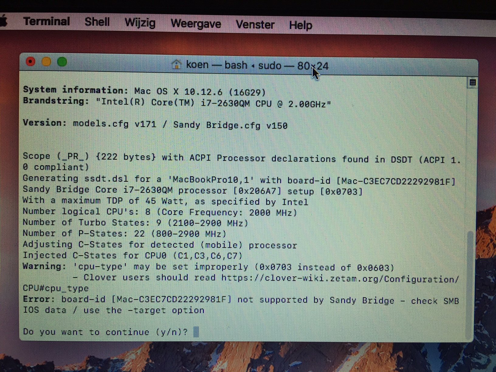

FCU4ever Posted October 17, 2018 Share Posted October 17, 2018 I succesfully installed MacOS Sierra 10.12.6 on my Asus G73sw laptop with the MacBookPro10,1 SMBios. My Hackintosh also work with the MacBookPro10,1 SMBios. The problem is that MacBookPro10,1 is for “Ivy Bridge” laptops and not for “Sandy Bridge” like mine. Because of the MacBookPro10,1 SMBios I’m unable to generate a SSDT.aml file with ssdtPRGen.sh from Piker-Alpha (see attachment). My Asus G73sw laptop has an Intel I7-2630QM processor and a Nvidia GTX460m videocard. The SMBios that comes close to my specifications is the MacBookPro8,2 SMBios. I changed the SMBios to MacBookPro8,2 with CloverConfigurator, copied the config.plist to my EFI folder and reboot -> black screen. Then I tried a few things to get the MacBookPro8,2 SMBios working: - Changed the SMBIOS to MacBookPro8,2 and add the below to KextToPatch com.apple.driver.AppleGraphicsDevicePolicy BA050000 00 BA000000 00 Prevent AGDP from loading Reboot -> Apple bar won’t load - Changed the SMBIOS to MacBookPro8,2 and changed productname to iMac13,2 Reboot -> Apple bar load but get a blackscreen - Changed the SMBIOS to MacBookPro8,2 and changed productname to iMac13,2 and add the below to KextToPatch com.apple.driver.AppleGraphicsDevicePolicy BA050000 00 BA000000 00 Prevent AGDP from loading Reboot -> laptop boots good So the laptop boots with the MacBookPro8,2 SMBios when I changed the productname and add a few lines to my kextToPatch. Changing the productname isn’t the right solution I think because I’m again not able to generate a SSDT.aml. Can someone help me to get the MacBookPro8,2 SMBios working so that I can generate a correct SSDT.aml for my hackintosh Link to comment https://www.insanelymac.com/forum/topic/336024-how-to-get-smbios-macbookpro82-working-on-my-asus-g73sw/ Share on other sites More sharing options...
styrian Posted October 17, 2018 Share Posted October 17, 2018 Hello! I would stay at Smbios of MBP 10,1/2 and let Clover generate C- and P-states for your Sandybridge CPU. Clover is reading your cpu type not depending on chosen SMBios. If AGPM is not loaded you have to make a LegacyAGPM.kext. For a HOWTO use please the forum search. Have fun. PS: SSdtPregen should only be used for Ivy Bridge CPU's and up. Link to comment https://www.insanelymac.com/forum/topic/336024-how-to-get-smbios-macbookpro82-working-on-my-asus-g73sw/#findComment-2641472 Share on other sites More sharing options...
