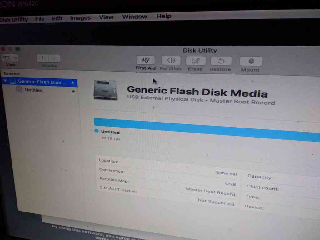

robif2002 Posted October 10, 2018 Share Posted October 10, 2018 Help, I'm wanna try to install newer version of macOS on my old PC, then i'm download mojave from AppStore then create bootable using mojave patcher program from dosdude and clover then. After succsesfull booting from USB then open disk utility hard drive not showing/detect on there and when os install also (only flashdisk installer showing), before i'm tried make bootable previous version macos and this same problem :'( also But i'm not faced this problem on installer from distro hackintosh zone in Yosemite-Sierra Now i'm using Sierra zone for while.... please anyone explain how to fix this. my PC specification : Intel Core 2 duo e8500 Asus p5k nVidia 9500gt thanks, Link to comment https://www.insanelymac.com/forum/topic/335752-solved-installer-reboots-at-2-minutes-remaining/#findComment-2640039 Share on other sites More sharing options...

winipcfg Posted October 26, 2018 Author Share Posted October 26, 2018 On 10/11/2018 at 3:48 AM, robif2002 said: Help, I'm wanna try to install newer version of macOS on my old PC, then i'm download mojave from AppStore then create bootable using mojave patcher program from dosdude and clover then. After succsesfull booting from USB then open disk utility hard drive not showing/detect on there and when os install also (only flashdisk installer showing), before i'm tried make bootable previous version macos and this same problem :'( also But i'm not faced this problem on installer from distro hackintosh zone in Yosemite-Sierra Now i'm using Sierra zone for while.... please anyone explain how to fix this. my PC specification : Intel Core 2 duo e8500 Asus p5k nVidia 9500gt thanks, Hi, try the Apple AHCI port kext here: One of my WD 250gb mechanical HDD won't appear during and after installation, but this kext helps the HDD being recognised. Place it at clover efi/kext/other Link to comment https://www.insanelymac.com/forum/topic/335752-solved-installer-reboots-at-2-minutes-remaining/#findComment-2643207 Share on other sites More sharing options...
