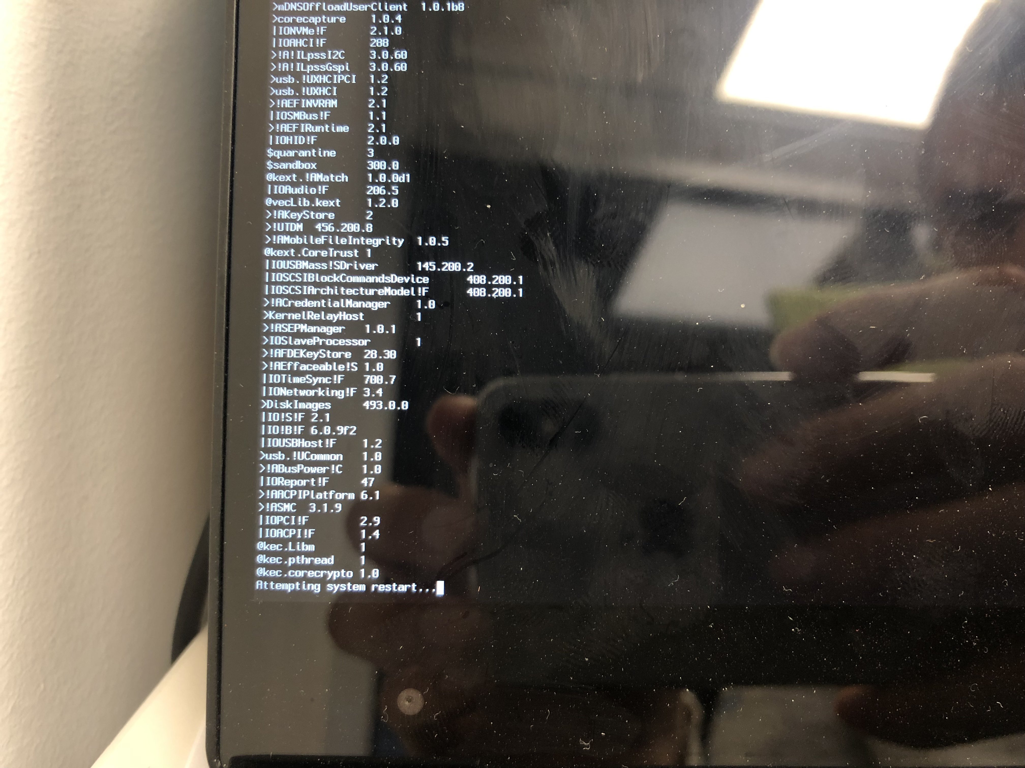

joseferre Posted November 5, 2018 Share Posted November 5, 2018 Hi tlefko, I followed all steps of the “preinstall steps”. I copied all files of your github folder inside the EFI folder in the EFI partition overwriting everything that was already there, but I get the following message at startup “Attempting system restart...” when start system at verbose mode. I don’t reach the installation screen. Any idea what is happening? Thank you. Regards, Jose Link to comment https://www.insanelymac.com/forum/topic/335390-macos-mojave-xps-13-guide-support/#findComment-2645543 Share on other sites More sharing options...
tlefko Posted November 20, 2018 Author Share Posted November 20, 2018 (edited) Hello, could you attach your EFI partition? Also, any idea what the last error message is? Sorry for the late reply @joseferre Okay, I figured out the issue. You need to make a new folder called EFI in your EFI partition, then copy the contents of EFI into the new EFI folder. Edited November 20, 2018 by tlefko Link to comment https://www.insanelymac.com/forum/topic/335390-macos-mojave-xps-13-guide-support/#findComment-2648723 Share on other sites More sharing options...

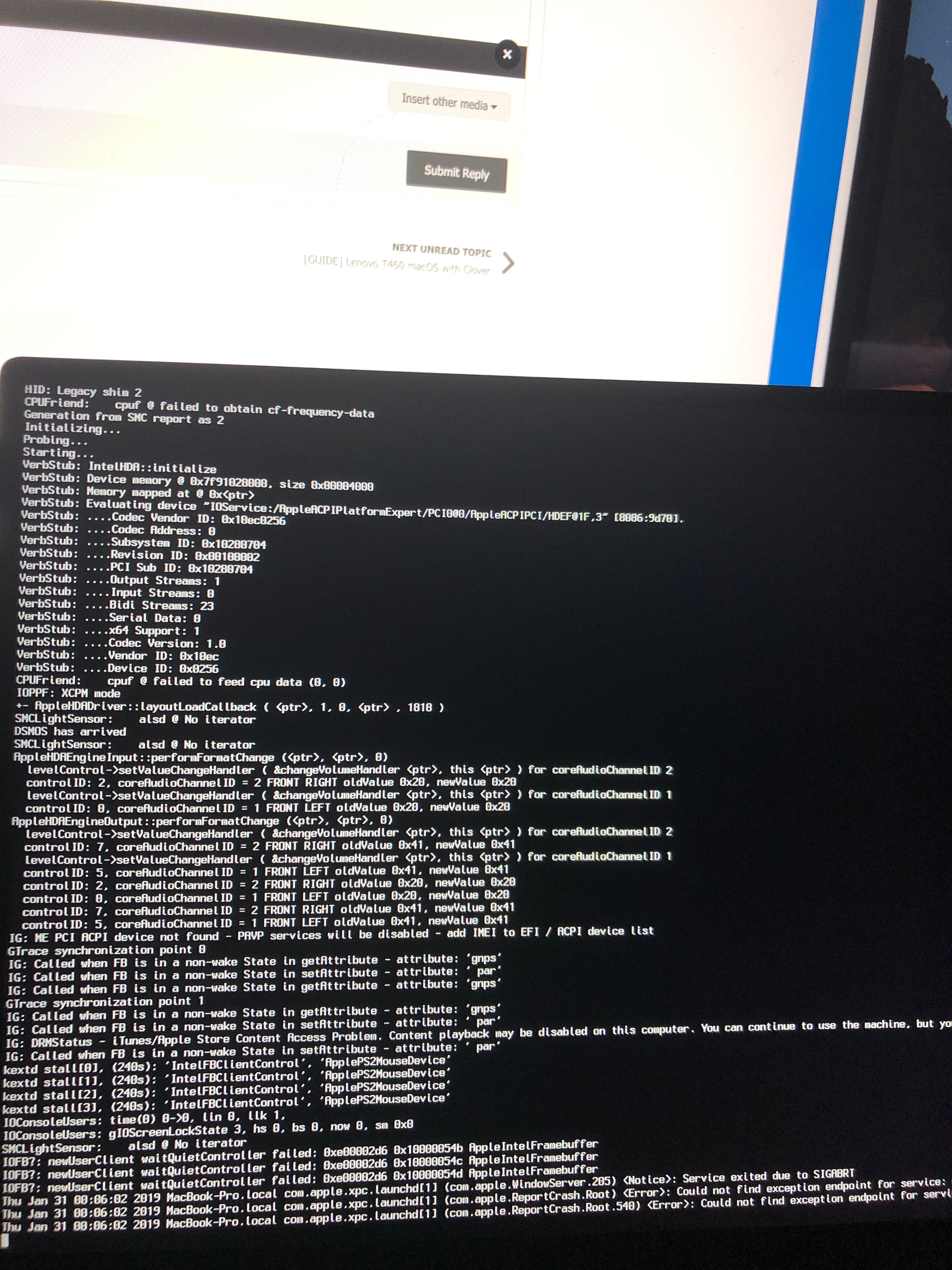

wgord001 Posted January 31, 2019 Share Posted January 31, 2019 It continues to loop the (240s): 'IntelFBClientControl', 'ApplePS2MouseDevice" for 3 counts then starts the count over again. Please help Link to comment https://www.insanelymac.com/forum/topic/335390-macos-mojave-xps-13-guide-support/#findComment-2662086 Share on other sites More sharing options...
tlefko Posted February 6, 2019 Author Share Posted February 6, 2019 @wgord001Errors seem to be throughout, attach your EFI partition also list your specs Link to comment https://www.insanelymac.com/forum/topic/335390-macos-mojave-xps-13-guide-support/#findComment-2662882 Share on other sites More sharing options...

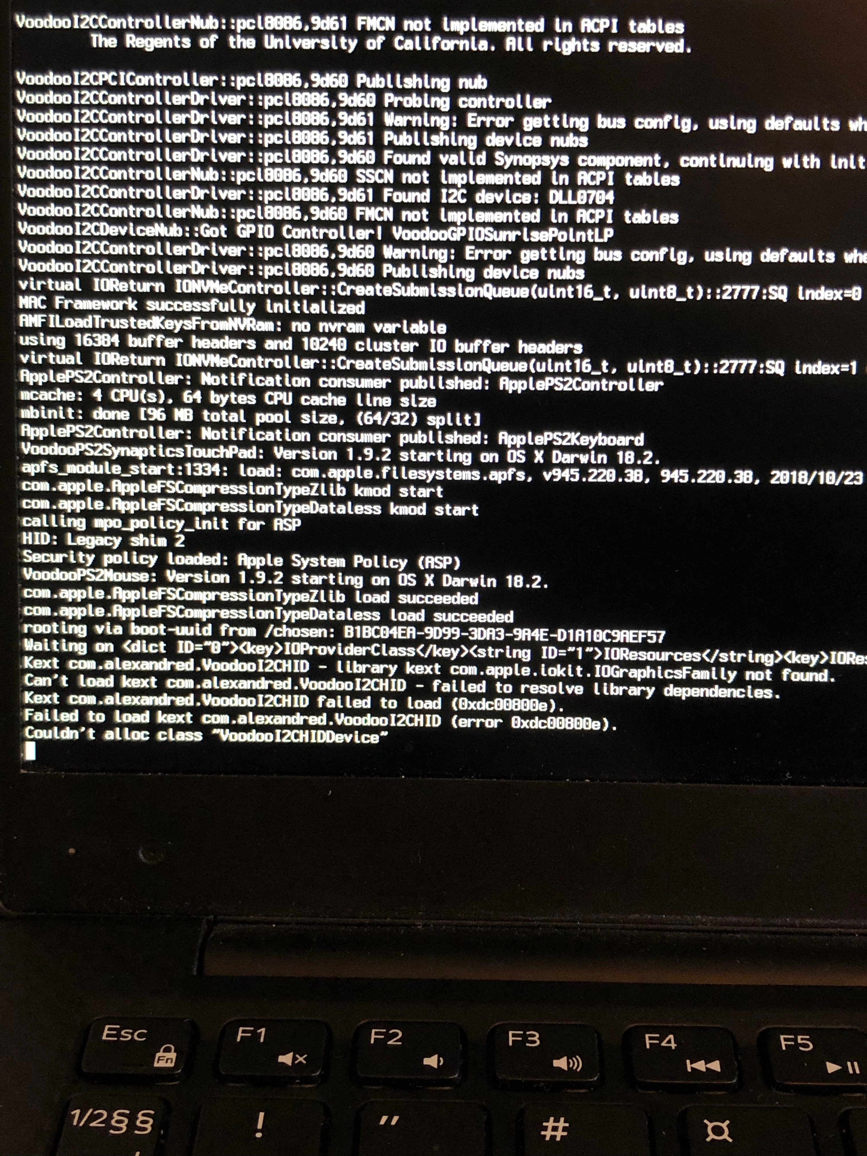

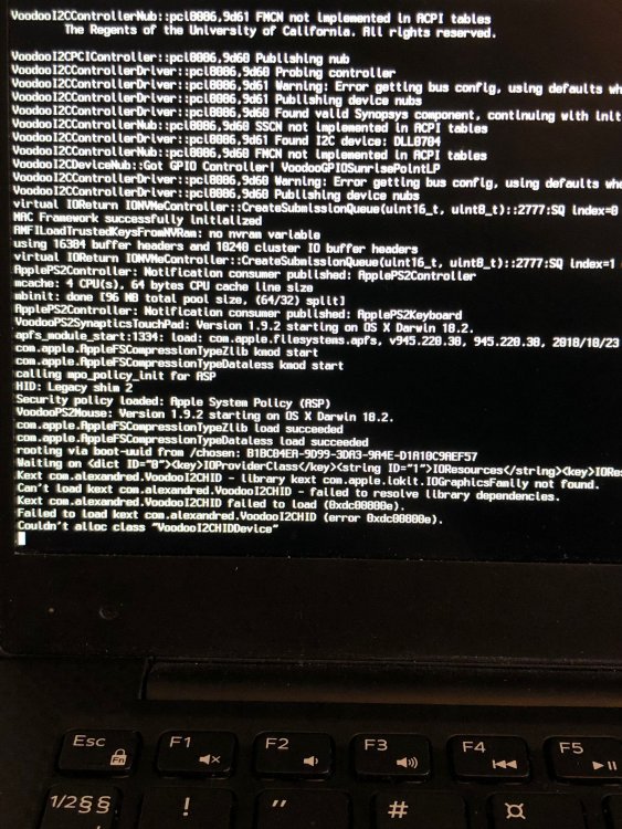

Snakkemand Posted February 11, 2019 Share Posted February 11, 2019 Hi Guys I know this post is a tad "old" but I must admit that I need some assistance. New to this site but I do have experience with desktop hacktintosh before, BUT I have never tried to set up a a laptop before. The past 2 days i've been trying to get to the installer without any luck on my Dell XPS 9350 i5-6200u with intel-520 and FHD screen. The BIOS settings of the laptop is: SATA set as ACHI Fastboot disabled SecureBoot Disabled UEFI boot enabled Also to be noted is that I'm currently using the CLOVER 2.4 r4871 version and the BIOS is updated to 1.9.0. The attached pictures and EFI folder should be an exact representation of the instructions for this setup, at post#1. Short after the "Couldn't alloc class "VoodooI2CHIDevice" the installer crashes with the classic "stop sign" thingy. Any ideers on how to proceed ? Thanks in advance guys ! EFI.zip Link to comment https://www.insanelymac.com/forum/topic/335390-macos-mojave-xps-13-guide-support/#findComment-2663637 Share on other sites More sharing options...
tlefko Posted March 2, 2019 Author Share Posted March 2, 2019 @SnakkemandRemove voodooIHCI and Voodooi2c from kexts folder. Should do the trick Link to comment https://www.insanelymac.com/forum/topic/335390-macos-mojave-xps-13-guide-support/#findComment-2665790 Share on other sites More sharing options...

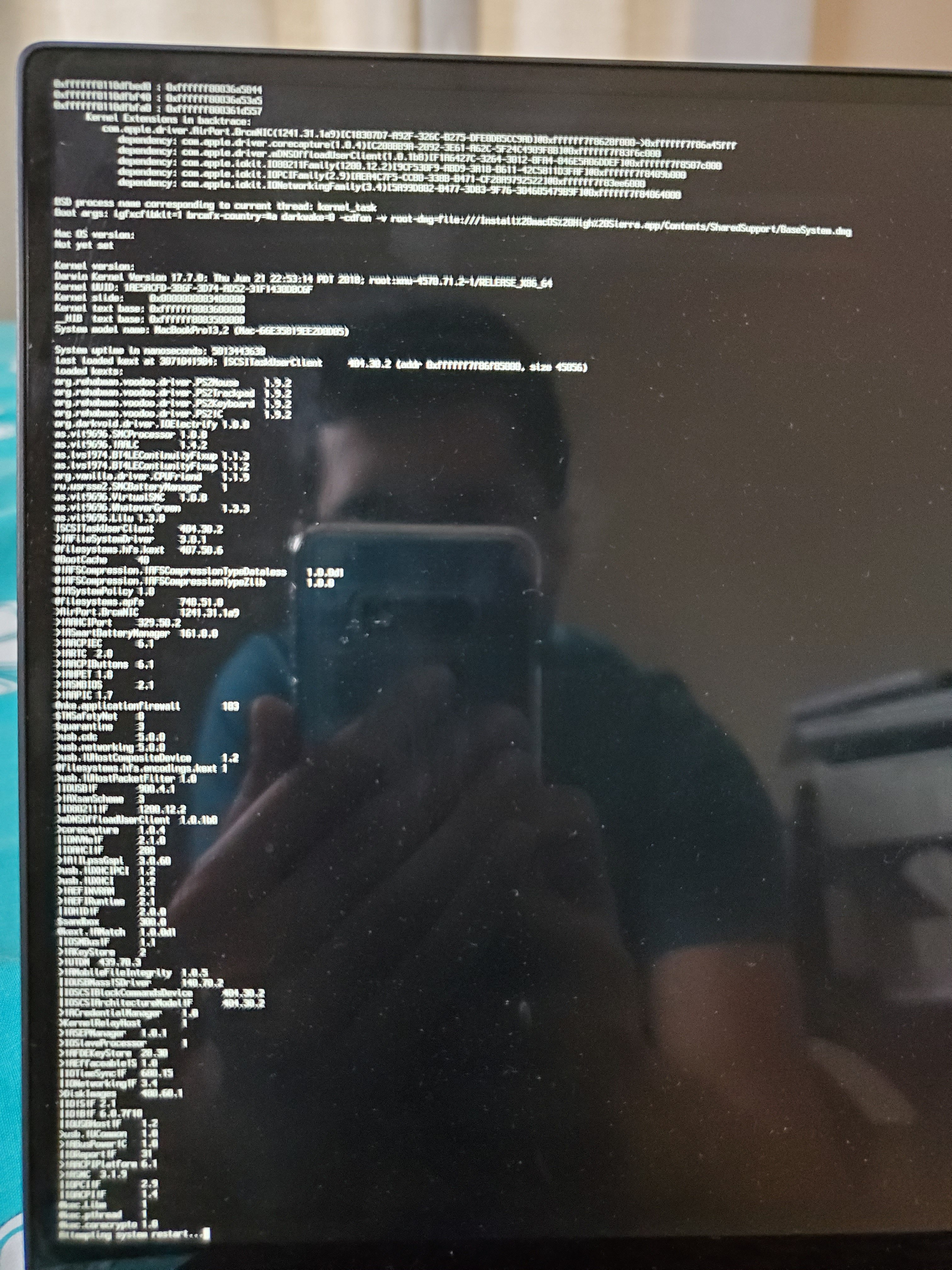

saadi93 Posted February 29, 2020 Share Posted February 29, 2020 Hi Hackintosh Community! Please advise... 1. My specs: Dell XPS 13 9350 | i5 6200U | Intel HD 520 Graphics | 3200x1800 Display | 8GB RAM | 256GB Samsung SSD | Dell Bios 1.12.2 2. My Story: I've been trying to install OSX Mojave 10.14.6 on this machine and am stuck in a weird spot. I was following this same guide.Created Clover USB using a Virtualbox VM as I don't have access to a real Mac. It booted just fine the first time to the installer, with everything working fine (mouse, keyboard) apart from Wifi which was expected. The UI was scaling well too meaning the graphics were working. I formatted my drive and the installation began but about 5 mins in, the screen turned black/grey and stayed there. So, I rebooted thinking to start over but now for some reason the installer does not even start. It would neither continue from the SSD using the USB nor through the USB partition itself for the installation to start afresh. It always reboots saying Attempting System Restart... and then reboots. Tried multiple guides for Mojave for this XPS but it always does the same reboot. Thought it was an issue with Mojave, so I made a High Sierra USB and switched to this guide and Clover folder: https://github.com/tlefko/OSX-XPS13-9350 But same reboot loop issue. Some pictures of the verbose output (for High Sierra) are attached at the bottom. I've tried changing USBs from 3.0 to 2.0, tried multiple guides and Clover folders, but still the same result. This leads me to believe the issue lies somewhere else. I have set the BIOS as advised in the guides btw. Can you guys debug what the issue can be? It booted fine the first time. What gives? If you need anymore info, I will be happy to help. The Clover folder is the same as in the github account linked above. Link to comment https://www.insanelymac.com/forum/topic/335390-macos-mojave-xps-13-guide-support/#findComment-2710466 Share on other sites More sharing options...
saadi93 Posted February 29, 2020 Share Posted February 29, 2020 On 11/5/2018 at 5:56 AM, joseferre said: Hi tlefko, I followed all steps of the “preinstall steps”. I copied all files of your github folder inside the EFI folder in the EFI partition overwriting everything that was already there, but I get the following message at startup “Attempting system restart...” when start system at verbose mode. I don’t reach the installation screen. Any idea what is happening? Thank you. Regards, Jose Did you solve it? I have the exact same issue and verbose output. Link to comment https://www.insanelymac.com/forum/topic/335390-macos-mojave-xps-13-guide-support/#findComment-2710469 Share on other sites More sharing options...
tlefko Posted March 21, 2020 Author Share Posted March 21, 2020 On 2/29/2020 at 12:48 PM, saadi93 said: Hi Hackintosh Community! Please advise... 1. My specs: Dell XPS 13 9350 | i5 6200U | Intel HD 520 Graphics | 3200x1800 Display | 8GB RAM | 256GB Samsung SSD | Dell Bios 1.12.2 2. My Story: I've been trying to install OSX Mojave 10.14.6 on this machine and am stuck in a weird spot. I was following this same guide.Created Clover USB using a Virtualbox VM as I don't have access to a real Mac. It booted just fine the first time to the installer, with everything working fine (mouse, keyboard) apart from Wifi which was expected. The UI was scaling well too meaning the graphics were working. I formatted my drive and the installation began but about 5 mins in, the screen turned black/grey and stayed there. So, I rebooted thinking to start over but now for some reason the installer does not even start. It would neither continue from the SSD using the USB nor through the USB partition itself for the installation to start afresh. It always reboots saying Attempting System Restart... and then reboots. Tried multiple guides for Mojave for this XPS but it always does the same reboot. Thought it was an issue with Mojave, so I made a High Sierra USB and switched to this guide and Clover folder: https://github.com/tlefko/OSX-XPS13-9350 But same reboot loop issue. Some pictures of the verbose output (for High Sierra) are attached at the bottom. I've tried changing USBs from 3.0 to 2.0, tried multiple guides and Clover folders, but still the same result. This leads me to believe the issue lies somewhere else. I have set the BIOS as advised in the guides btw. Can you guys debug what the issue can be? It booted fine the first time. What gives? If you need anymore info, I will be happy to help. The Clover folder is the same as in the github account linked above. Hey @Snakkemand, send me a pm if you're still interested I'll try to help you out, I think it's an outdated driver for the hard drive On 2/29/2020 at 1:00 PM, saadi93 said: Did you solve it? I have the exact same issue and verbose output. Feel free to shoot me a message, like I said I believe it could be an issue with the hard disk driver. I also released an updated guide which may help Link to comment https://www.insanelymac.com/forum/topic/335390-macos-mojave-xps-13-guide-support/#findComment-2713159 Share on other sites More sharing options...

saadi93 Posted March 22, 2020 Share Posted March 22, 2020 On 3/21/2020 at 1:08 AM, tlefko said: Hey @Snakkemand, send me a pm if you're still interested I'll try to help you out, I think it's an outdated driver for the hard drive Feel free to shoot me a message, like I said I believe it could be an issue with the hard disk driver. I also released an updated guide which may help Hi, thanks for the help. I figured out the issue. The kernal panic was related to the stock DW 1820A wifi card inside. It appeared above as BRCM.NIC in backtrace. I disabled the chip in bios and it booted fine. Link to comment https://www.insanelymac.com/forum/topic/335390-macos-mojave-xps-13-guide-support/#findComment-2713361 Share on other sites More sharing options...
tlefko Posted March 22, 2020 Author Share Posted March 22, 2020 13 minutes ago, saadi93 said: Hi, thanks for the help. I figured out the issue. The kernal panic was related to the stock DW 1820A wifi card inside. It appeared above as BRCM.NIC in backtrace. I disabled the chip in bios and it booted fine. wow that's a great find, I never would've thought of that as I used the DW1560. That's great work! Link to comment https://www.insanelymac.com/forum/topic/335390-macos-mojave-xps-13-guide-support/#findComment-2713363 Share on other sites More sharing options...
saadi93 Posted March 22, 2020 Share Posted March 22, 2020 12 minutes ago, tlefko said: wow that's a great find, I never would've thought of that as I used the DW1560. That's great work! You should add this as a pre-install step in your new guide for any newby, like me, who is too broke to get a DW1560 and instead goes the route of cheap USB Wifi dongle :D. It would really help. I was stuck with this for weeks without any clue from anywhere (one place which I can't recall but that did not mention this BRCM.NIC kernel panic being caused because of the chip not being disabled). Link to comment https://www.insanelymac.com/forum/topic/335390-macos-mojave-xps-13-guide-support/#findComment-2713366 Share on other sites More sharing options...
