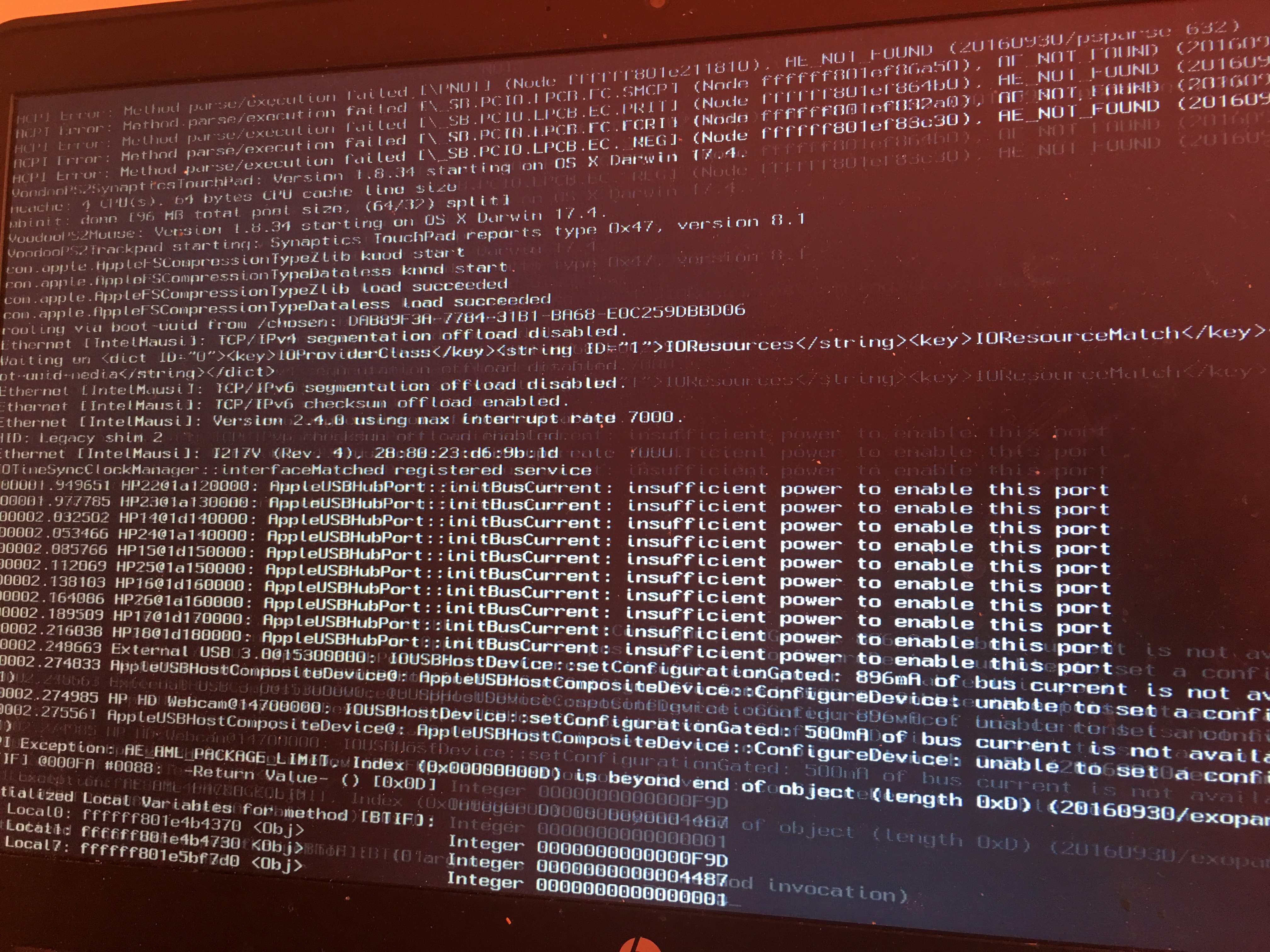

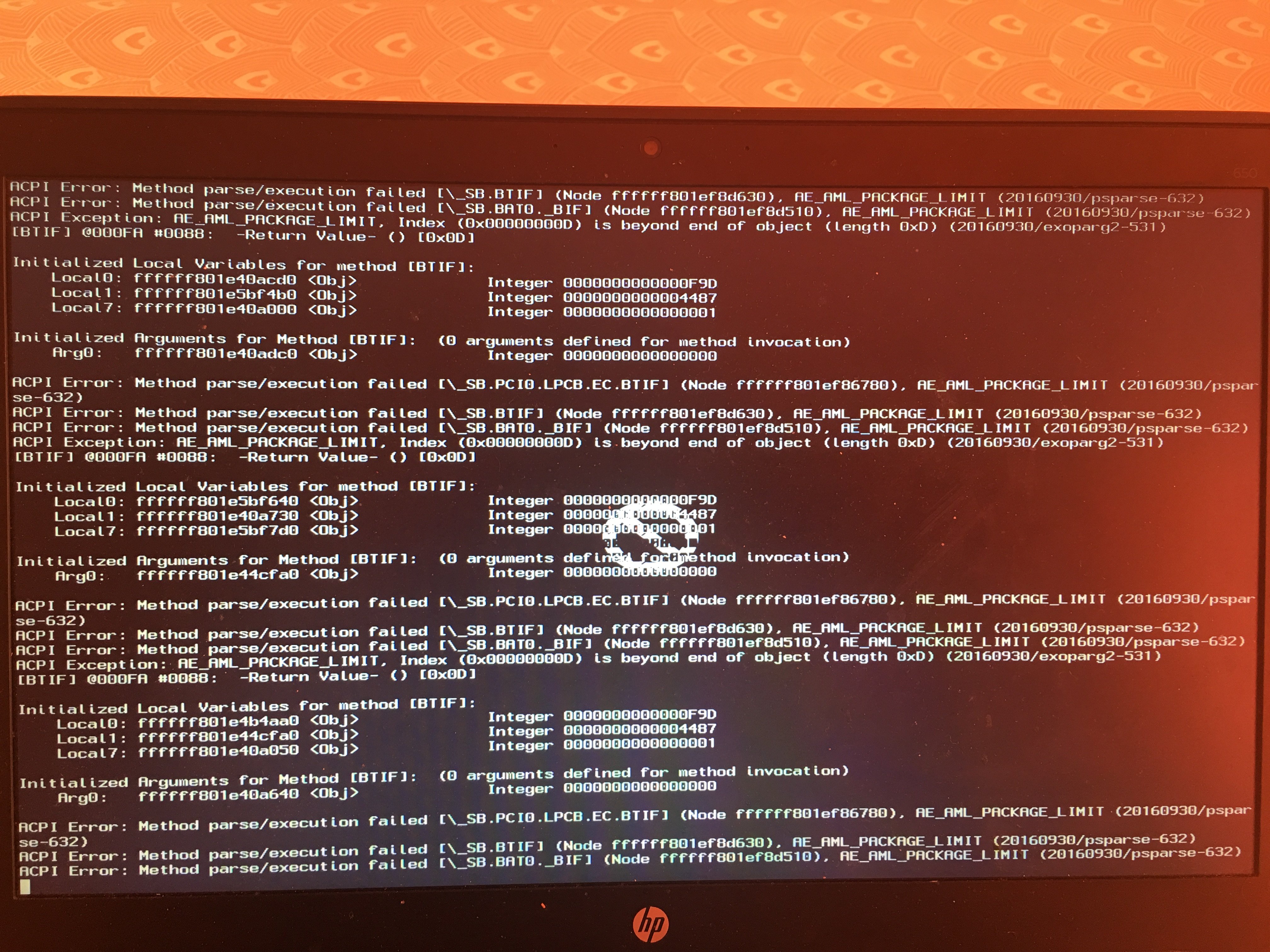

BibouI Posted August 30, 2018 Author Share Posted August 30, 2018 53 minutes ago, Allan said: Your old EFI doesn't have the new SMC fixes, you don't make a backup? I have but when i add the new SMC.kext When i add VirtualSMC.kext and VirtualSMC.efi to my new EFI my system wont boot and gives me the same errors VirtualSMC Key missing VirtualSMC value Not found like the picture i have sent it to you but when i remove it from my EFI my system start working normal Link to comment https://www.insanelymac.com/forum/topic/335321-battery-0-on-high-sierra-1032-hp-probook-650-g1/page/2/#findComment-2632289 Share on other sites More sharing options...

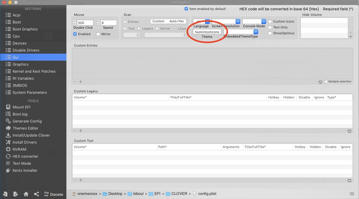

onemanOSX Posted September 2, 2018 Share Posted September 2, 2018 7 hours ago, BibouI said: This is my entire eFI folder Are you really using zone distro for installation? In any case, try this DSDT.aml.zip Link to comment https://www.insanelymac.com/forum/topic/335321-battery-0-on-high-sierra-1032-hp-probook-650-g1/page/2/#findComment-2632862 Share on other sites More sharing options...
BibouI Posted September 2, 2018 Author Share Posted September 2, 2018 5 minutes ago, onemanOSX said: Are you really using zone distro for installation? In any case, try this DSDT.aml.zip Yes i swear i used before a modifed one but after that i formated everything and i'm using a clean version they call it vanilla but i use the icon from a modifed version otherwise I'm using a clean vanilla version i will use your dsdt and i will tel you for any thing news Thank you i use also abm_delaypole boot-flag for battery 1 Link to comment https://www.insanelymac.com/forum/topic/335321-battery-0-on-high-sierra-1032-hp-probook-650-g1/page/2/#findComment-2632863 Share on other sites More sharing options...

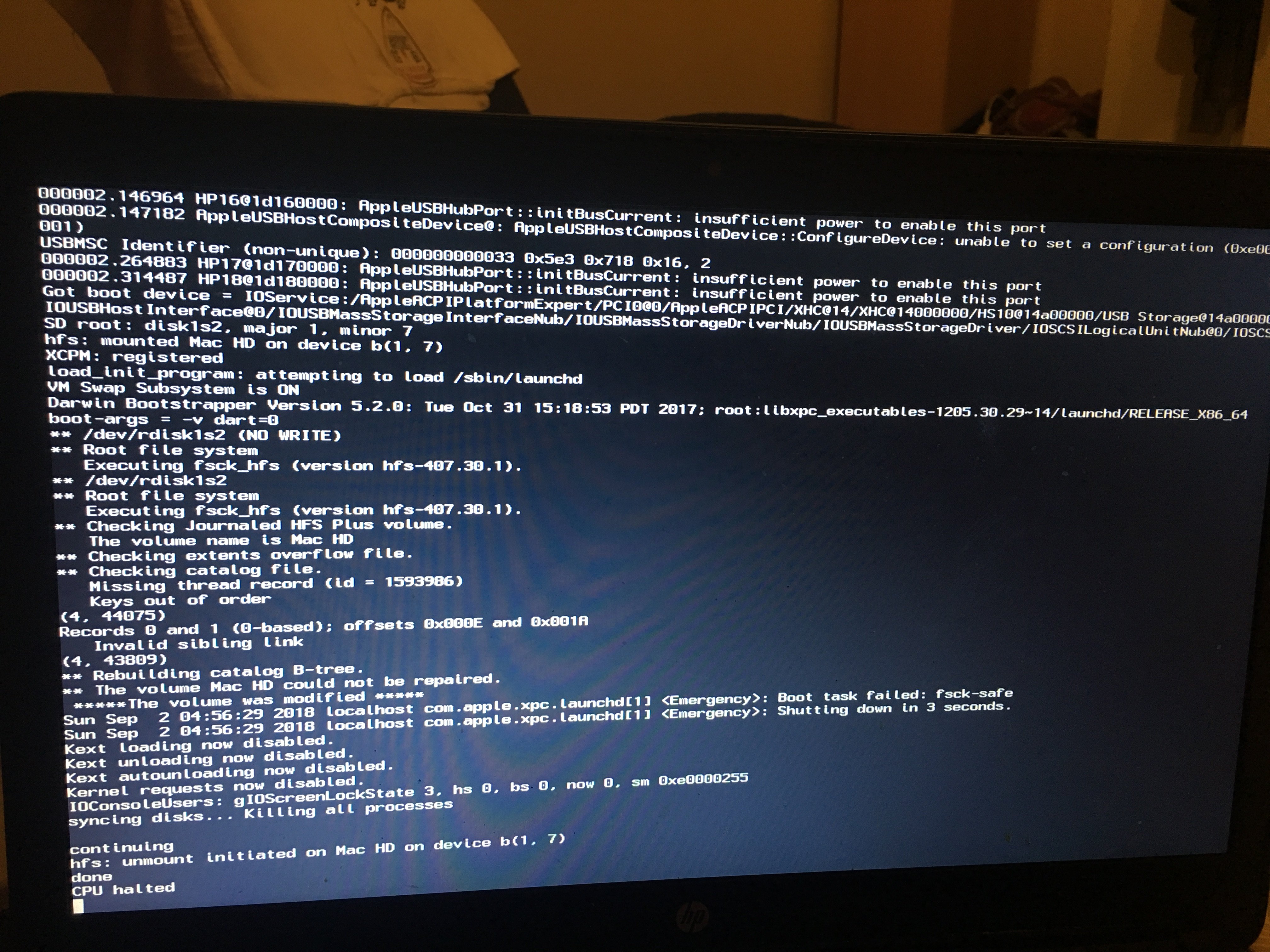

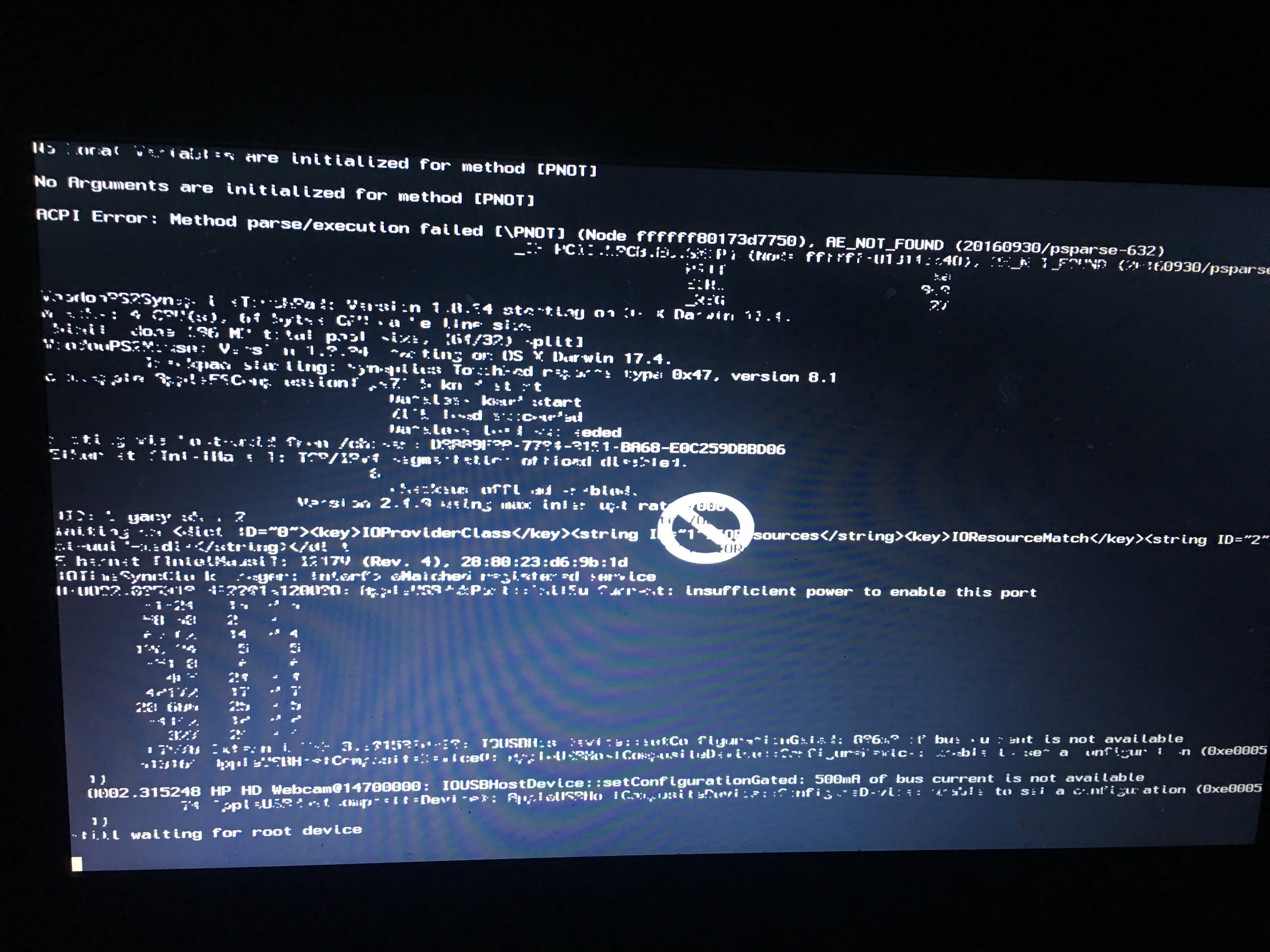

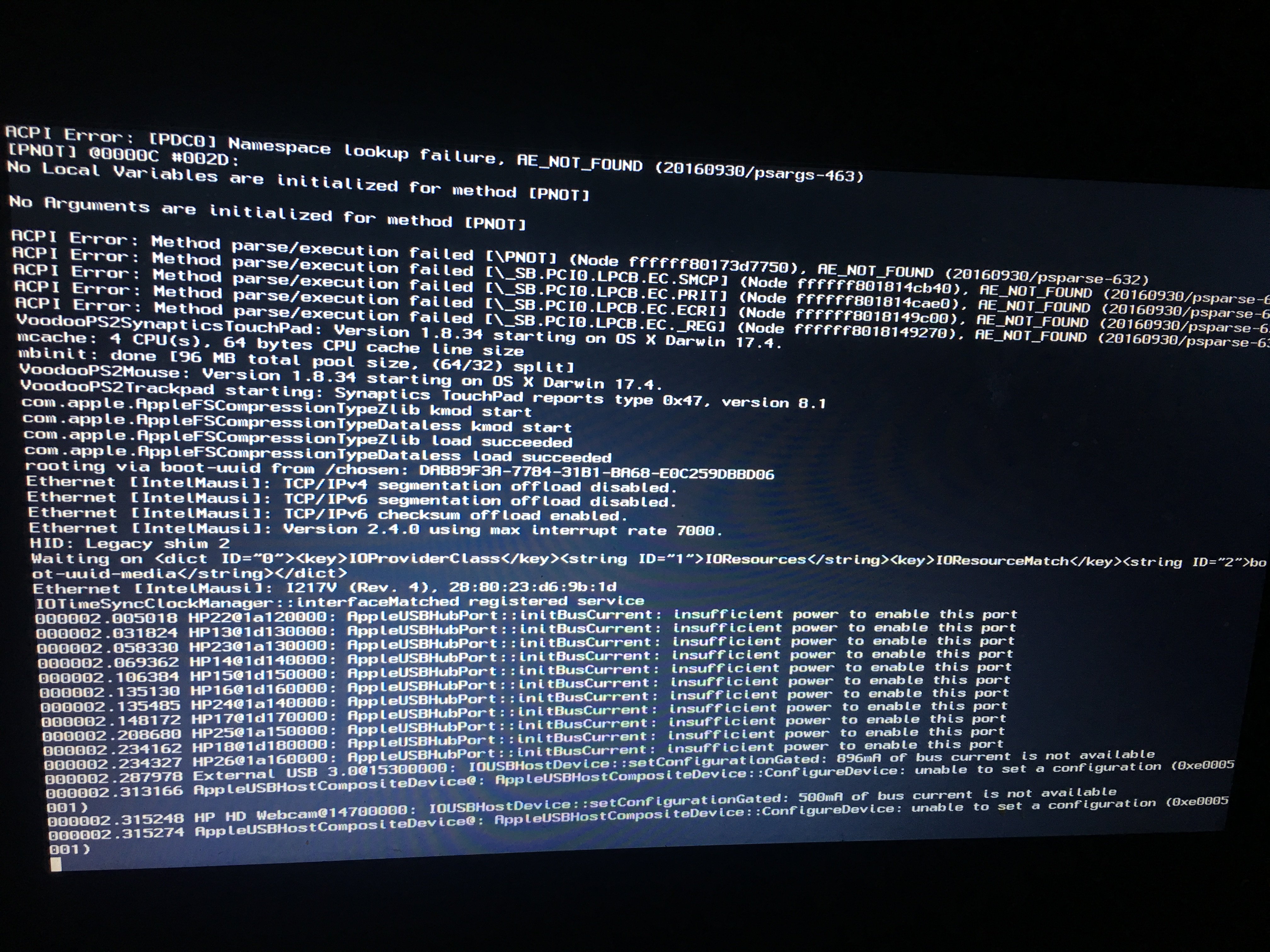

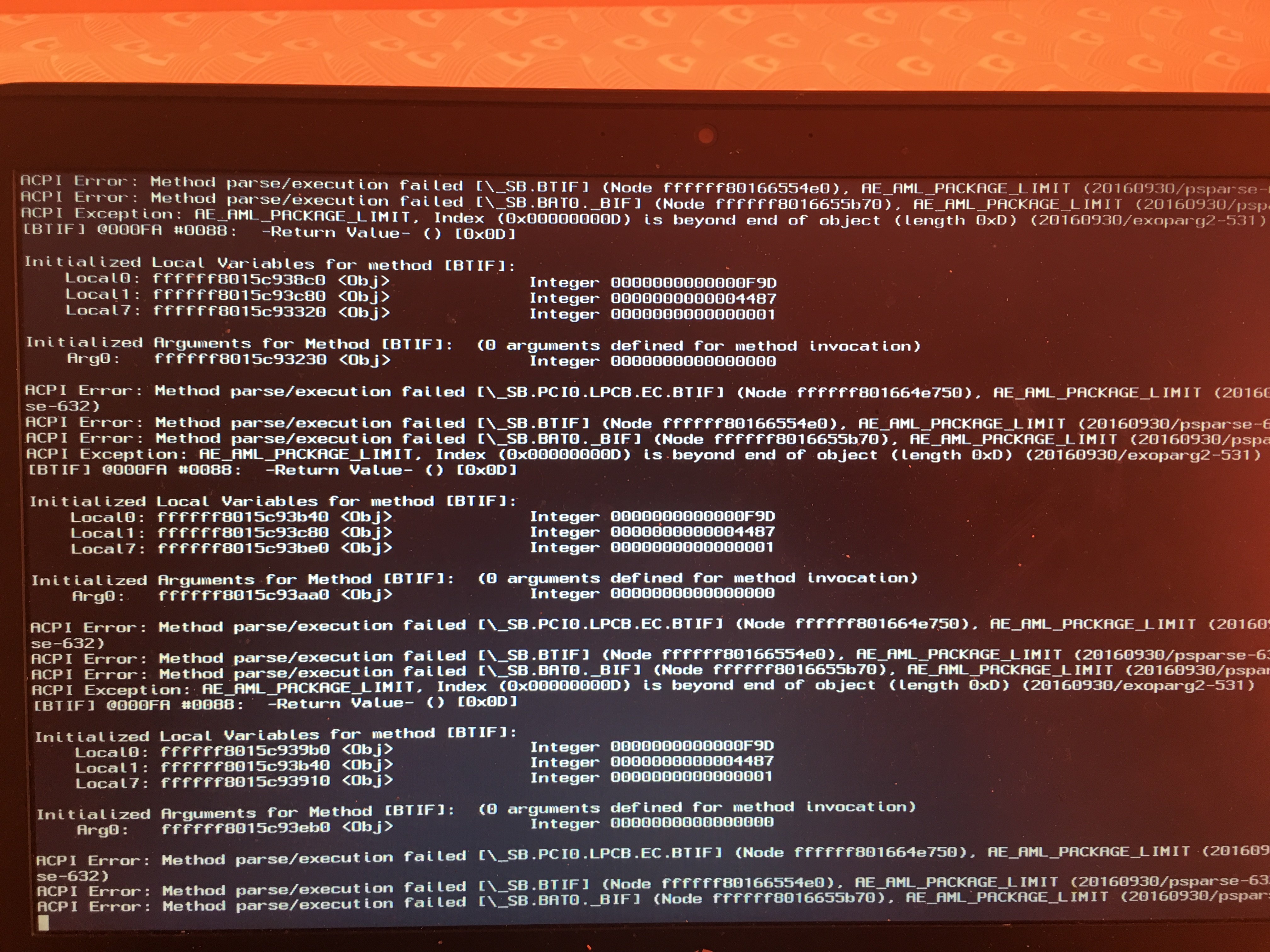

BibouI Posted September 2, 2018 Author Share Posted September 2, 2018 (edited) 4 minutes ago, onemanOSX said: Not required as far as I know. I only rebuild cache & permissions when dealing with kexts installed in S/L/E only. Thanks For clearing it i used your dsdt with and without the boot-flag my system stuck on this: After couple minutes It showed me this one: Edited September 2, 2018 by BibouI Link to comment https://www.insanelymac.com/forum/topic/335321-battery-0-on-high-sierra-1032-hp-probook-650-g1/page/2/#findComment-2632867 Share on other sites More sharing options...
onemanOSX Posted September 2, 2018 Share Posted September 2, 2018 the verbose shows more of failure of usb ports. What other dsdt patches were done before in your patched folder? I dissembled your dsdt and applied windows 10 patch and the battery patch, only. Link to comment https://www.insanelymac.com/forum/topic/335321-battery-0-on-high-sierra-1032-hp-probook-650-g1/page/2/#findComment-2632868 Share on other sites More sharing options...
BibouI Posted September 2, 2018 Author Share Posted September 2, 2018 1 minute ago, onemanOSX said: the verbose shows more of failure of usb ports. What other dsdt patches were done before in your patched folder? I dissembled your dsdt and applied windows 10 patch and the battery patch, only. It’s dsdt patched from madln i really don’t know but i think for graphic cards maybe failure cuz i’m using my external hard drive there when my Macintosh is and with your new dsdt failed to read my system ? Link to comment https://www.insanelymac.com/forum/topic/335321-battery-0-on-high-sierra-1032-hp-probook-650-g1/page/2/#findComment-2632869 Share on other sites More sharing options...
onemanOSX Posted September 2, 2018 Share Posted September 2, 2018 2 minutes ago, BibouI said: i’m using my external hard drive there when my Macintosh is try using a different usb port. You will need a reliable way of booting to eliminate problems Link to comment https://www.insanelymac.com/forum/topic/335321-battery-0-on-high-sierra-1032-hp-probook-650-g1/page/2/#findComment-2632870 Share on other sites More sharing options...
BibouI Posted September 2, 2018 Author Share Posted September 2, 2018 1 minute ago, onemanOSX said: try using a different usb port. You will need a reliable way of booting to eliminate problems I already tried all my usb ports all of them 3.0 and wont work the system i can restor the system i have usb stick Link to comment https://www.insanelymac.com/forum/topic/335321-battery-0-on-high-sierra-1032-hp-probook-650-g1/page/2/#findComment-2632871 Share on other sites More sharing options...
onemanOSX Posted September 2, 2018 Share Posted September 2, 2018 (edited) 4 minutes ago, BibouI said: all my usb ports all of them 3.0 and wont work the system Try this and see if it helps DSDT.aml.zip Edited September 2, 2018 by onemanOSX Link to comment https://www.insanelymac.com/forum/topic/335321-battery-0-on-high-sierra-1032-hp-probook-650-g1/page/2/#findComment-2632873 Share on other sites More sharing options...
BibouI Posted September 2, 2018 Author Share Posted September 2, 2018 1 minute ago, onemanOSX said: Try this and see if it helps DSDT.aml.zip Thank you just one moment I have an idea i will take off my hard drive and put it in 2.0 adabtapeur and i will use your old dsdt see if it works if didnt i will restor the system and use your new one Link to comment https://www.insanelymac.com/forum/topic/335321-battery-0-on-high-sierra-1032-hp-probook-650-g1/page/2/#findComment-2632874 Share on other sites More sharing options...
BibouI Posted September 2, 2018 Author Share Posted September 2, 2018 Mr @onemanOSX actually when i used the 2.0 it make the booting veryyyy slow but i think it works and faild or something check with the old dsdt and using 2.0 adaptaur what i get after this msg my laptop shutdown automatically Link to comment https://www.insanelymac.com/forum/topic/335321-battery-0-on-high-sierra-1032-hp-probook-650-g1/page/2/#findComment-2632875 Share on other sites More sharing options...
