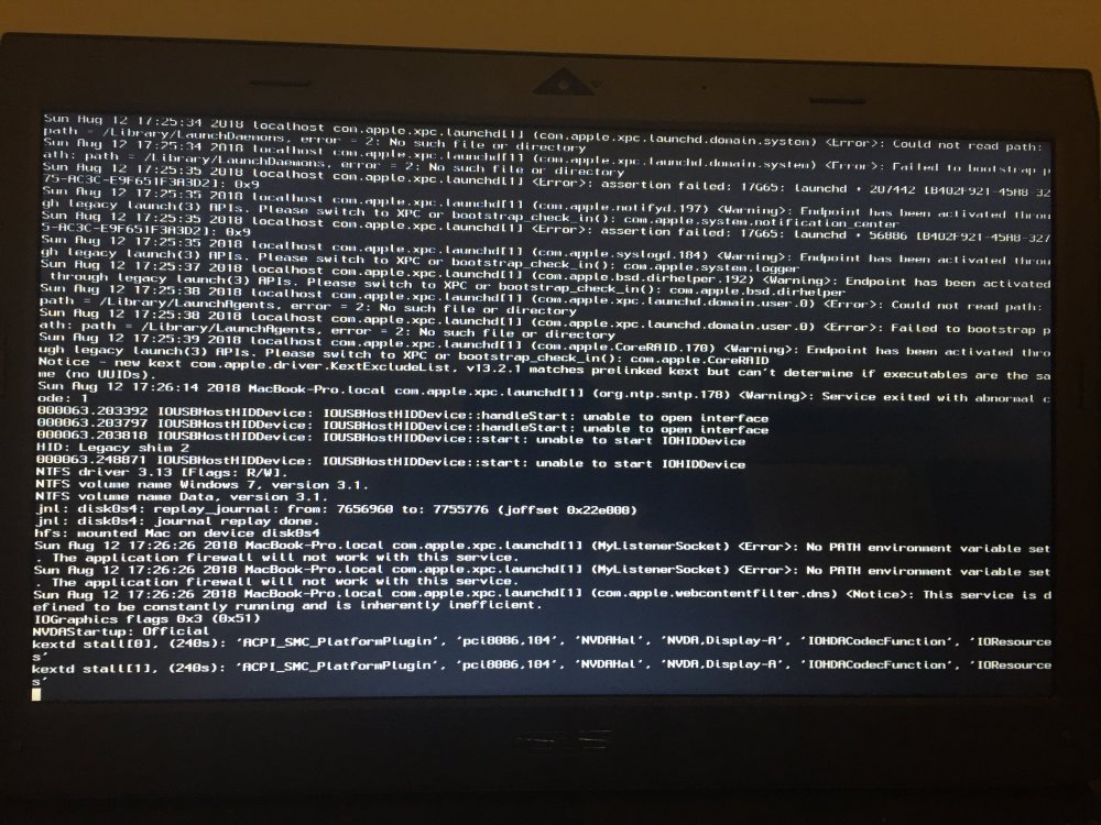

FCU4ever Posted August 12, 2018 Share Posted August 12, 2018 Hello, I'm trying to install Mac OSX High Sierra on my Asus G73sw laptop. Previous versions of Mac OSX worked (like El Capitain, Yosemite & Mavericks). But with this version of OSX (10.13.6) I can't even reach te installer. After 75 percent of loading the Apple bar the laptop reboots (see attached movie). My specs are: - Mobo: Asus 73w rev 2.0 - CPU: I7-2630QM / Intel® HM65 Express Chipset - Graphics: Nvidia Geforce GTX 460M 1.5GB GDDR5 VRAM - SSD + HDD BIOS settings: - UEFI Boot --> Enable - Intel (VMX) Virtualization Technologie --> Disabled First I created a bootable USB using this guide: https://www.insanelymac.com/forum/topic/329828-making-a-bootable-high-sierra-usb-installer-entirely-from-scratch-in-windows-or-linux-mint-without-access-to-mac-or-app-store-installerapp/ Then I copied AptioMemoryFix.efi & HFSPlus.efi to drivers64UEFI folder and FakeSMC.kext, USBInjectAll.kext and VoodooPS2Controller.kext to kext folder. For the config.plist I used the one from this thread: https://www.tonymacx86.com/threads/guide-asus-rog-g73jh-using-clover-uefi.242770/ Changed some values with CloverConfigurator. I add Inject Nvidia, Load Vbios and enable NvidiaWebdrivers and removed all the ATI stuff. Now it's time to boot the Clover bootloader and install High Sierra...... No luck, after loading 75 percent of the Apple bar the laptop reboots. Can someone help me? Config.plist in attached files 4617ede8-43ea-4ac5-8dbd-c8893c295382.MP4 config.plist Link to comment Share on other sites More sharing options...

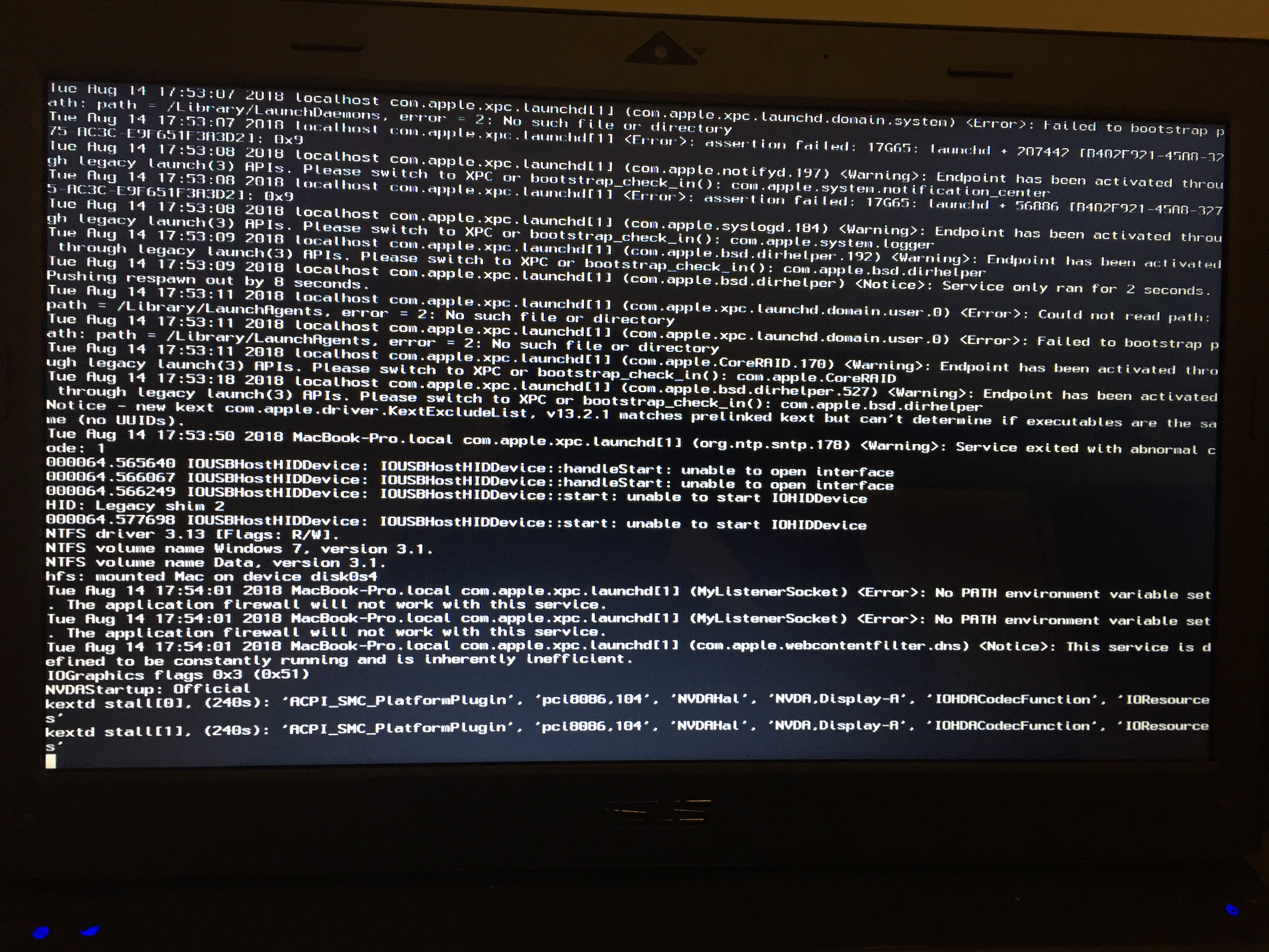

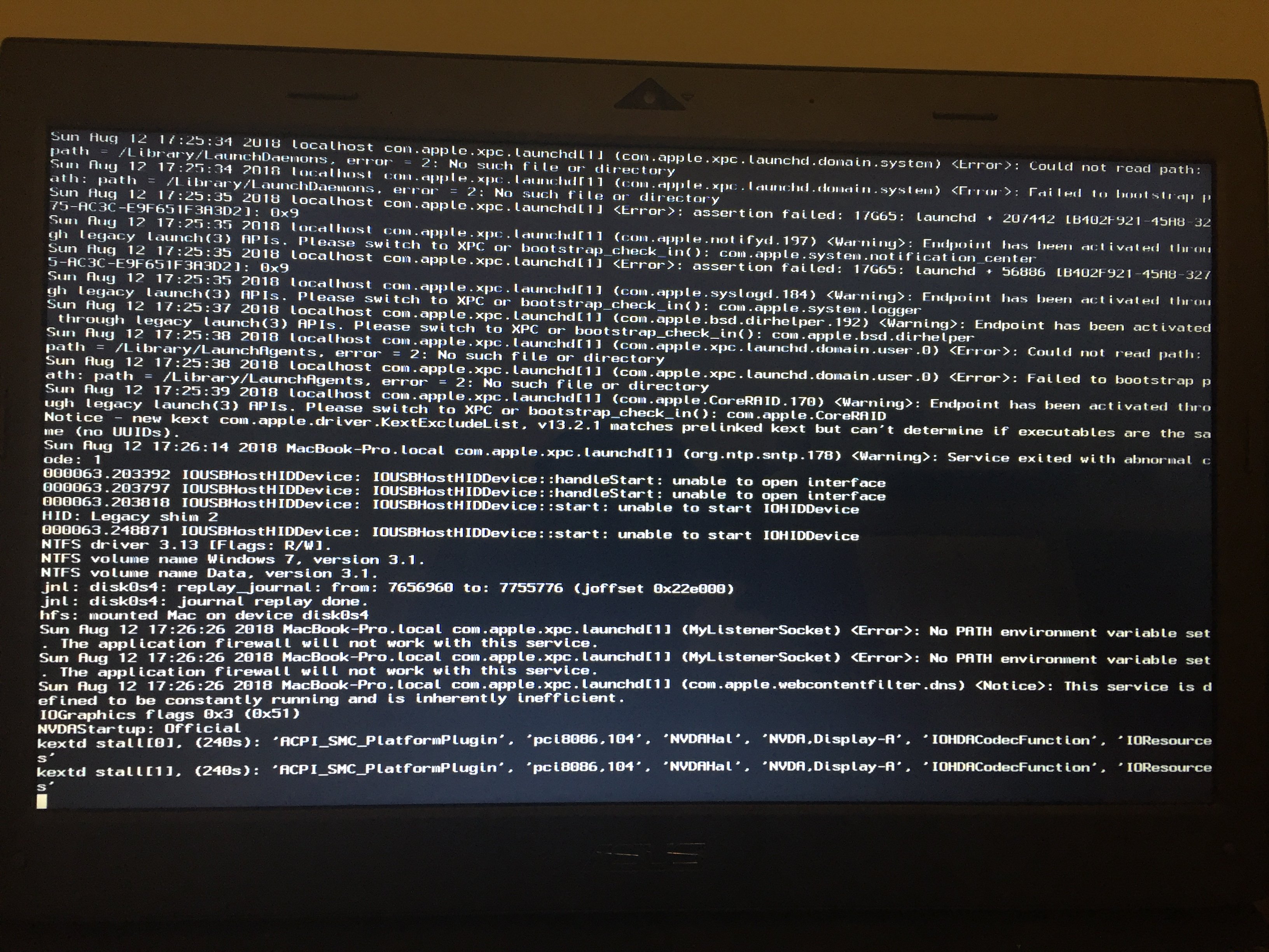

FCU4ever Posted August 12, 2018 Author Share Posted August 12, 2018 1 hour ago, Hervé said: Why didn't you re-use your existing working Clover config, updating it as/if necessary? Because that config.plist won't even start. Get directly kernel panic... Quote Try the attached revised Clover config where CPU Power Management, SMBIOS and APCI table settings were changed. config.plist.zip Many thanks for the edited config.plist. The installer won't reboot anymore but stucks after NVDAStartup: Official. If you are interested I also uploaded the config.plist I used in El Capitain. config_EL_Capitan.plist Link to comment Share on other sites More sharing options...

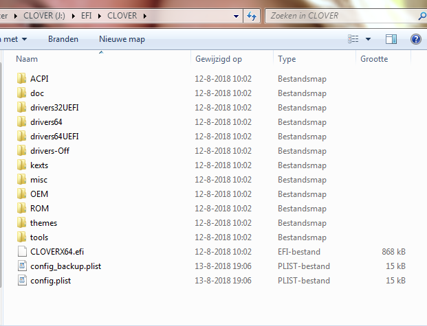

FCU4ever Posted August 13, 2018 Author Share Posted August 13, 2018 Unfortunately, stuck at the same place. For completeness I'll post my EFI folder. EFI.rar Link to comment Share on other sites More sharing options...

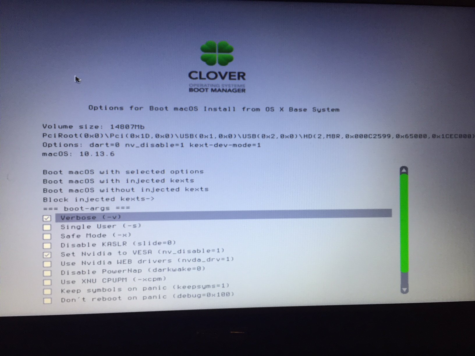

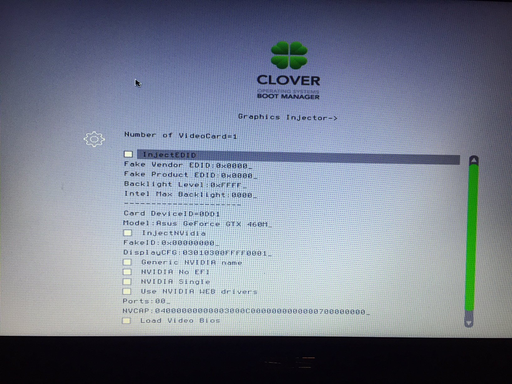

FCU4ever Posted August 13, 2018 Author Share Posted August 13, 2018 6 minutes ago, Hervé said: Try and uncheck/deselect: Boot tab: npci=0x2000 ACPI tab: Drop OEM (SSDT) You obviously cannot have nVidia Web drivers installed on your USB installer. You could also try and remove Load VBIOS parameter. Thanks. I’ll try this after work. maybe I can also try to deselct the inject nVidia and VBios and check the inject Intel and add bootflag nv_disable=1 Link to comment Share on other sites More sharing options...

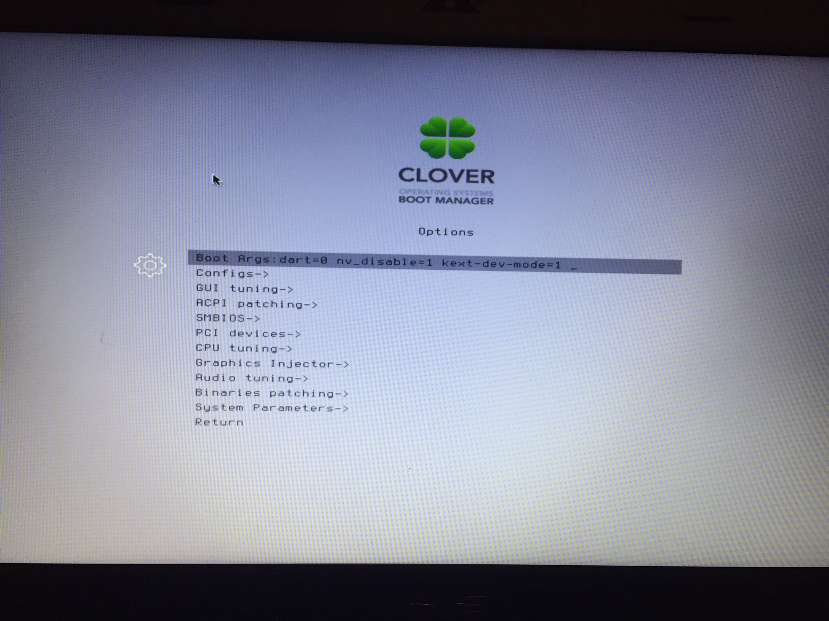

FCU4ever Posted August 13, 2018 Author Share Posted August 13, 2018 First I tried to boot with: - UNCHECK -> npci=0x2000 - UNCHECK -> ACPI Tab: Drop OEM (SSDT) No luck Second I tried to boot with: - UNCHECK -> npci=0x2000 - UNCHECK -> ACPI Tab: Drop OEM (SSDT) - UNCHECK -> Load VBios No luck Third I tried to boot with: - NV_disables=1 - UNCHECK -> inject nVidia - UNCHECK -> Load VBios - Check -> Inject Intel Also no luck. Then I dowloaded a pre-configured config.plist for intel HD3000. I edited some parameters and tried to boot the installer. The good news is that I pass the NVDAStartup but now I'm stuck a few lines later..... See attachment for my new config.plist config.plist Link to comment Share on other sites More sharing options...

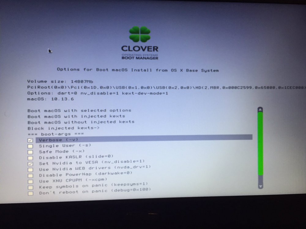

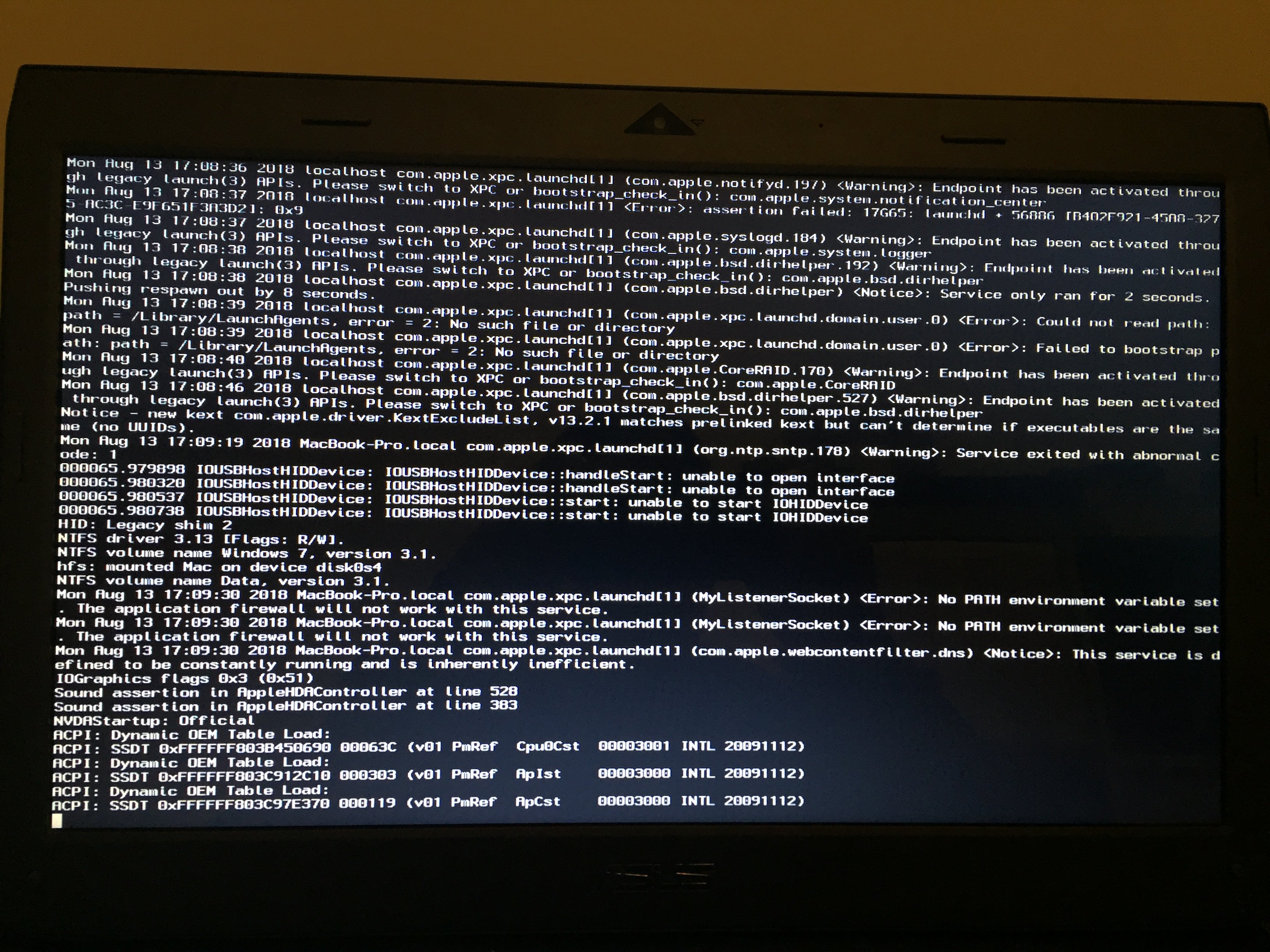

FCU4ever Posted August 14, 2018 Author Share Posted August 14, 2018 44 minutes ago, Hervé said: Try this Clover config file. If you have a HiRes LCD (1600x900 or above), enable DualLink in the Graphics section (use Clover Configurator app). config.plist.zip My LCD is 1600x900 so I enabled DualLink. Copied the new config.plist to my USB and booted the installer. Still stuck at the same place but this time without the ACPI: Dynamic OEM table Load lines (see attached picture) 46 minutes ago, Hervé said: Could you also press F4 when you're at Clover's main menu (where you see the disk partitions) to retrieve all raw ACPI tables from BIOS? You'll then find them in ACPI/origin folder. Compress the folder and post it. Done that. See attachment origin.zip Link to comment Share on other sites More sharing options...

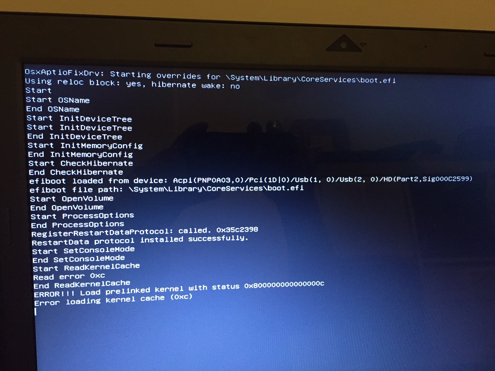

FCU4ever Posted August 15, 2018 Author Share Posted August 15, 2018 8 hours ago, Hervé said: Try this one where I've enabled "Drop OEM". config.plist.zip Thanks for the new config.plist. With this config.plist I get directly "Error loading kernel cache (oxc)" 8 hours ago, Hervé said: But I'm surprised you last screenshot showed Nvidia graphics; it should be disabled. Are you placing the config file in the right place? In the EFI partition? I'm surprised too. The config.plist is in the right directory and in the clover bootloader it's looks good and Nvidia should be disabled. Link to comment Share on other sites More sharing options...
FCU4ever Posted August 15, 2018 Author Share Posted August 15, 2018 YES!!! I've reached the installer. So what have I done to fix te issue's???? I had to change the SMBios to iMac 13,2 instead of Macbook Pro 8,1 (just like in El Capitan). I also needed HFSPlus-64.efi (off course to see the partitions) and OsxAptioFixDrv-64.efi. About the kexts I needed USBInjectAll.kext, FakeSMC.kext and VoodooPS2Controller.kext. So lets try to install High Sierra. Link to comment Share on other sites More sharing options...
