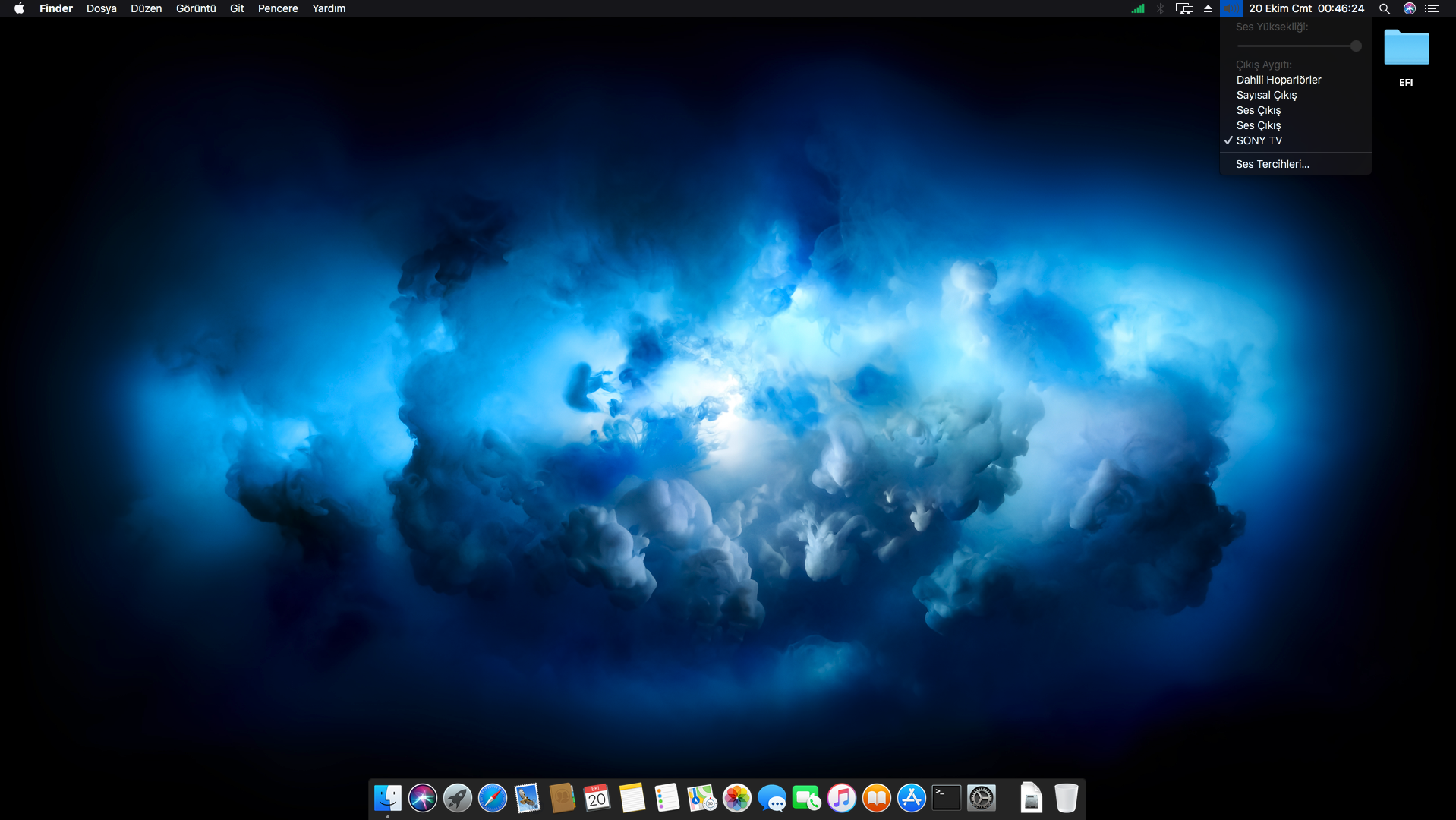

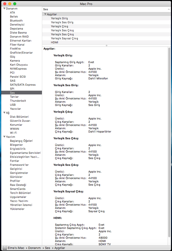

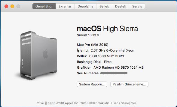

uisik34 Posted October 20, 2018 Author Share Posted October 20, 2018 (edited) Now I want to give final feedback about my system. Â It runs on High Sierra 10.13.6 with power problem (Shut down, wake up from sleep stuck at black screen and restart do sometimes the function but sometimes stuck at black screen) My Config.plist is attached and Audio device ID finally worked with Native AppleHDA + AppleALC + Lilu kexts. Â In addition to solve my power problems I found ready DSDT.aml (Attached ready aml file of my mobo) on Internet and put it in EFI/CLOVER/ACPI/Patched and it seems to function but sometimes needed power off to restart which is not %100 healthy. And another problem with this patch is; Native audio does not work when i apply it. Â Runme.app output of the system with DSDT.aml patch in use but have no audio is attached. config.plist DSDT-GA-EX58-UD3R-1.6-FK.aml Send me Elmas-MacPro.zip Edited October 20, 2018 by uisik34 Link to comment https://www.insanelymac.com/forum/topic/334998-brief-and-simple-way-to-explain-dsdt-and-ssdt/#findComment-2641893 Share on other sites More sharing options...

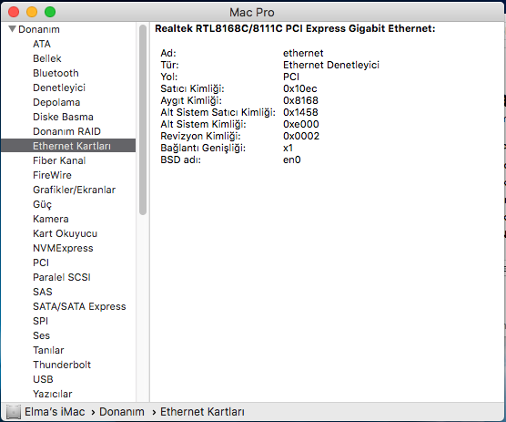

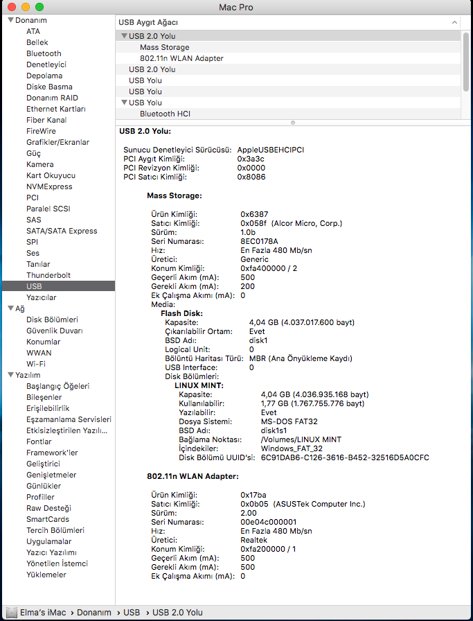

uisik34 Posted October 20, 2018 Author Share Posted October 20, 2018 To be helpful to other people which will use EX58-UD3R Mainboard with High Sierra I want to give some extra infos. Â The mainboard I use is 1.6 Revision and has tweaktown FK bios (Meltdown + Spectre fix included) version on it. You can see as attached here. I used as min as possible to run on system and tried to delete unnecessary kexts in EFI/Clover/Kexts/Others. I attach the screen shot of folder. EX58UD3R.FK Link to comment https://www.insanelymac.com/forum/topic/334998-brief-and-simple-way-to-explain-dsdt-and-ssdt/#findComment-2641894 Share on other sites More sharing options...
uisik34 Posted October 20, 2018 Author Share Posted October 20, 2018 (edited) Here attached some other output I created by another applications on Mac. DSDT.aml System DSDT.dsl    Edited October 22, 2018 by uisik34 I added some more reference pictures for other users Link to comment https://www.insanelymac.com/forum/topic/334998-brief-and-simple-way-to-explain-dsdt-and-ssdt/#findComment-2641895 Share on other sites More sharing options...

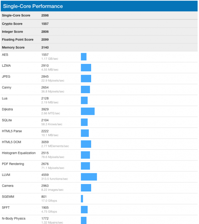

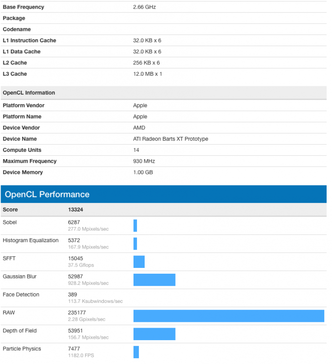

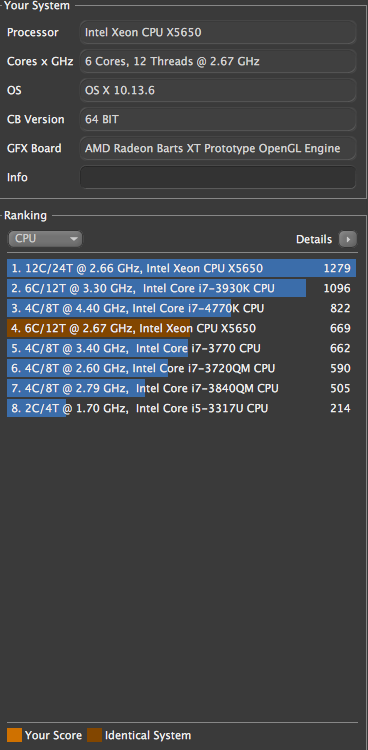

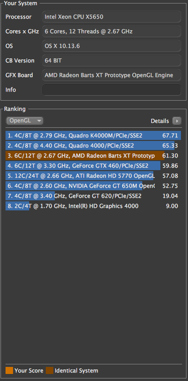

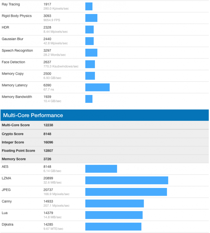

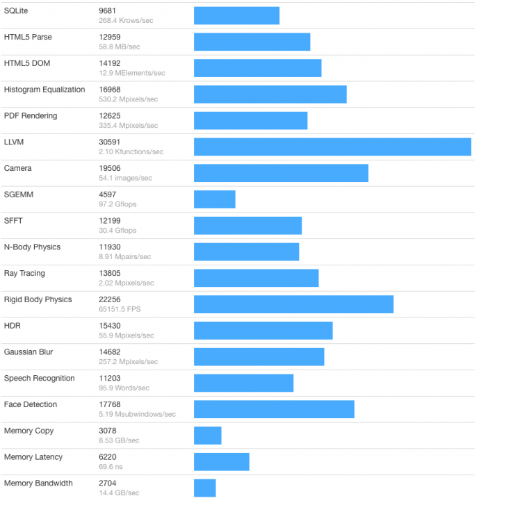

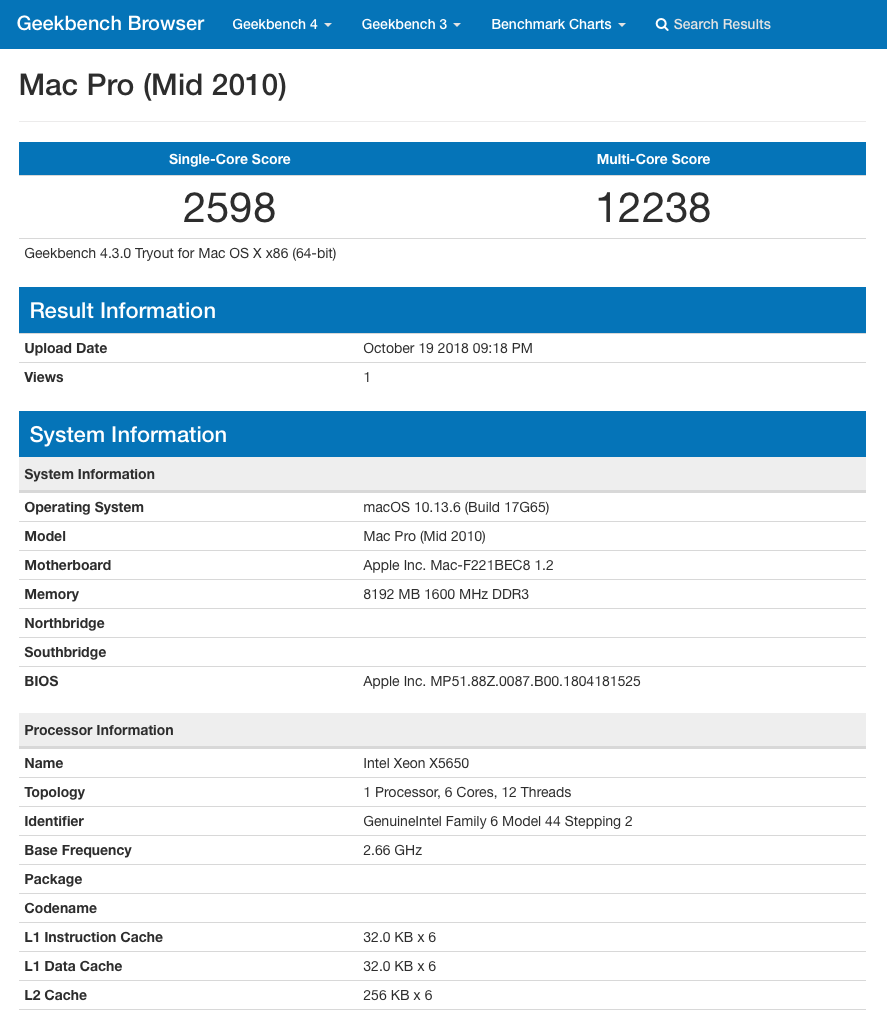

uisik34 Posted October 20, 2018 Author Share Posted October 20, 2018 Cinebench and Geekbench Scores; Â Â Link to comment https://www.insanelymac.com/forum/topic/334998-brief-and-simple-way-to-explain-dsdt-and-ssdt/#findComment-2641898 Share on other sites More sharing options...
