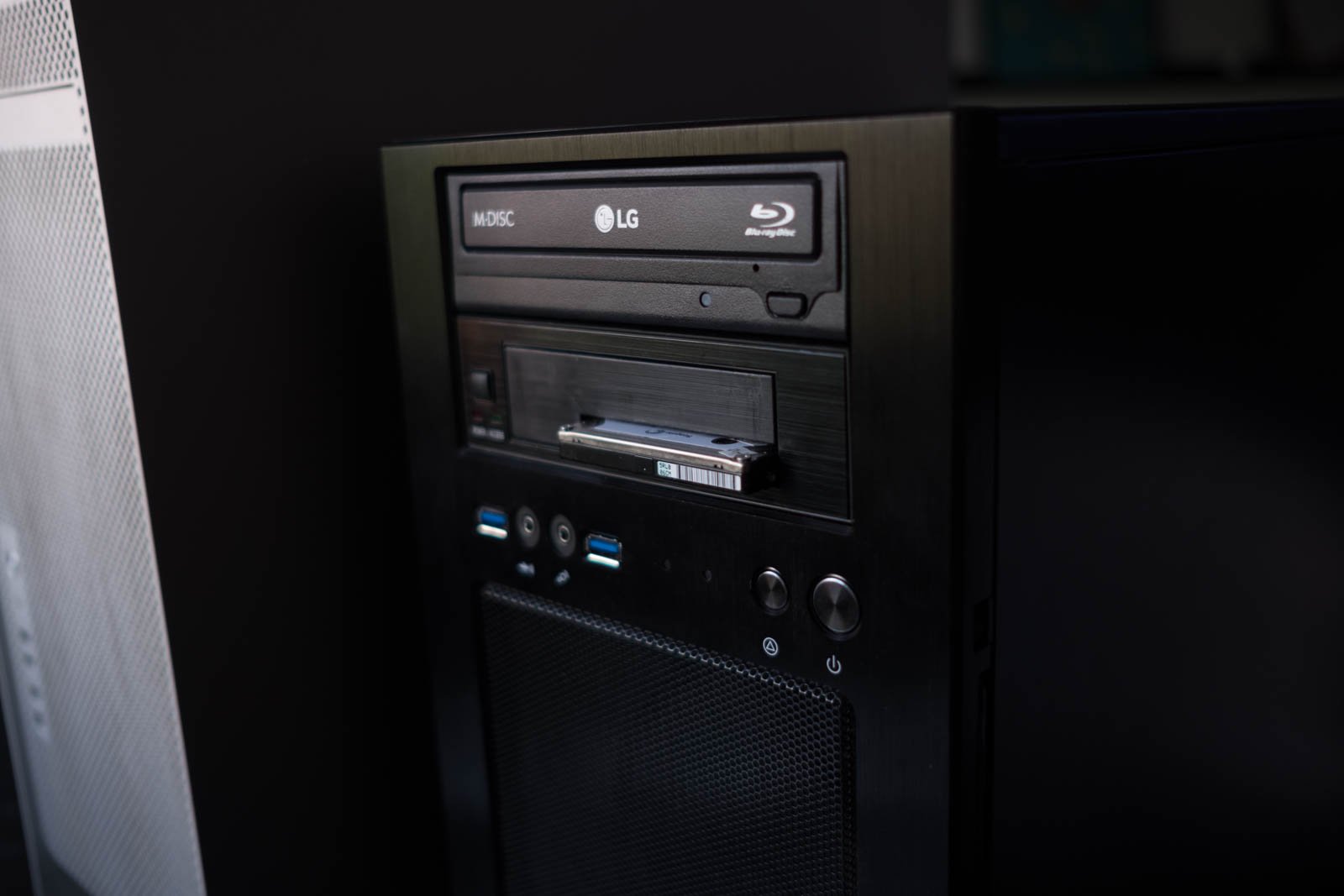

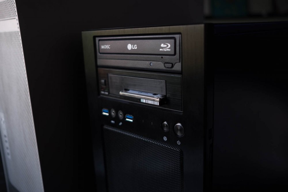

DESCRIPTION
This build is for a NAS/server/workstation hackintosh build.  This machine has been on 24/7 runs 10.13.5 with Plex server and is also used as a workstation with adobe creative suite, Lightroom and several other video and photo tools.  This build has been rock solid stable and everything is working as expected for the past couple of weeks.  Since the machine is a server and is on all the time, I cannot vouch for its reliability in sleep/wake.

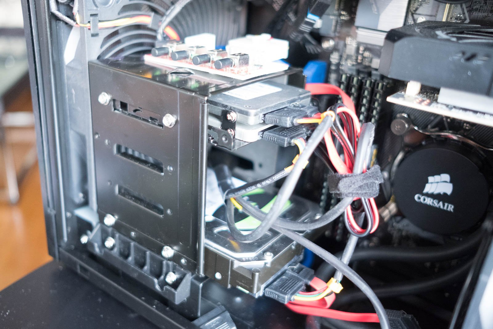

* 2.5/3.5 harddrive dock for backing up OS clones to quickly restore images
* Boot SSD - Primary boot drive
* Single large storage drive for NAS & Plex

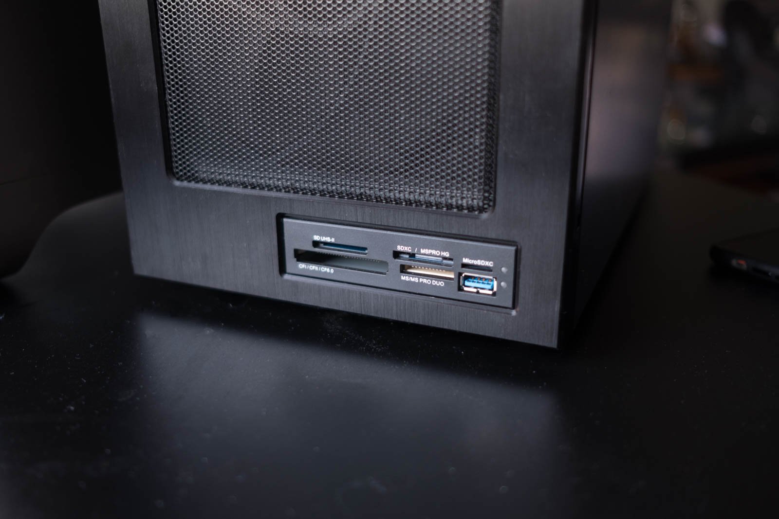

* $28.71 StarTech.com USB 3.0 Internal Multi-Card Reader : https://amzn.to/2u7B1jy

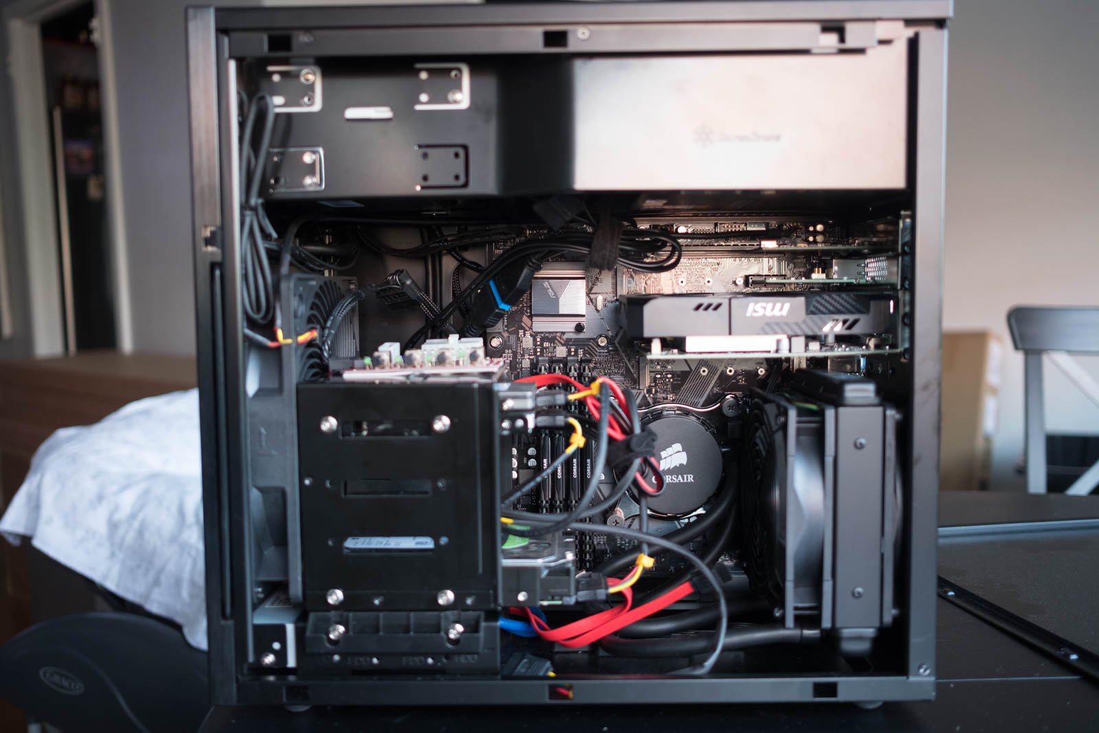

CPU choice: Intel i7-8700
Any Coffee Lake i3, i5, i7 CPU is going to work with macOS High Sierra. I have chosen an i7 8700 since the server may be doing some transcoding in the background and all the extra threads can help. Also it will be running at least one virtual machine which be OSX in Parallels for all activities that will be connected VPN such as torrent and newsgroups. I did look at the i5 8600K as its regarded by some as the best value for performance, but in the end I opted to pay a little more to avoid any special over clocking headaches.  The machine will always be on so choosing a non-K CPU would run the CPU at its TDP @ 65 W rather than the 95 W of a K version.
Motherboard: Asus h370M Prime Plus
H370 chipset is, as of 6/2018, the best chipset for coffee lake if you aren’t overclocking the  CPU and Memory.  It may even be a step above z370 chipsets in that it supports usb 3.1 gen.2 ports (but OSX may not). It supports a total of 14 USB ports so you won’t have as much limitations or need to be fiddling with USB port mapping like on the b360 and h310 motherboards. The H370 also gives you the ability to set up a RAID 1 or 5 which is something I may explore in the future. I chose the Asus brand board as it has a really nice bios. Right away, the bios detects my Logitech wireless usb keyboard and mouse so hitting a key on boot, which you’ll be doing a lot after setup, just works. (I had problems with an Asrock motherboard previously using the same keyboard/mouse.) Using the mouse in the bios and especially in combination w Asus’s setting search for bios changes, makes setting the bios hackintosh requirements a breeze. I choose the micro ATX sized motherboard because I wanted a case with a small footprint. ITX motherboards were a bit too limited as I wanted to put my black magic HDMI capture card and have a secondary NIC so micro ATX was the smallest I could go. The onboard ethernet works right away with correct kext.files. The onboard audio is the intel 887 which is also supported and works well, however from what I read it is considered to be inferior to other motherboard implementations. I have a dell usb soundbar that I used previously which also worked OOB and already satisfies my requirements.
The onboard video is the intel hd 630. It works pretty well, although not perfect, with high sierra.  For anything graphic intensive, I experienced slight glitches during moderate use, however it would probably be usable if this was strictly a server build. I’ll be instead using a MSI RADEON RX 560 PCIe video card for full acceleration.
Graphics card: MSI radeon rx 560
I chose the radeon rx series because High Sierra appears to support it OOB with correct kext.files installed and it work without a hitch from what I can see.  I have run all the standard benchmarks and don’t experience any glitches or other abnormalities at all. The MSI card was one of the cheapest rx 560 versions I could find.  Since the build is server and will only do occasional Lightroom and Premiere work, again I choose a non-overclocked card for cooler operation despite an overclocked rx 560 can be gotten for about the same price.  I initially tried to get an XFX card working, however on further research, it appeared to be only possible with a bios flash. I opted to skip the headache and just return it and get an MSI card instead. Which worked right away without any extra work. It also doesn’t need an extra power connection which leads me to believe its less power hungry in general than some other rx 560s

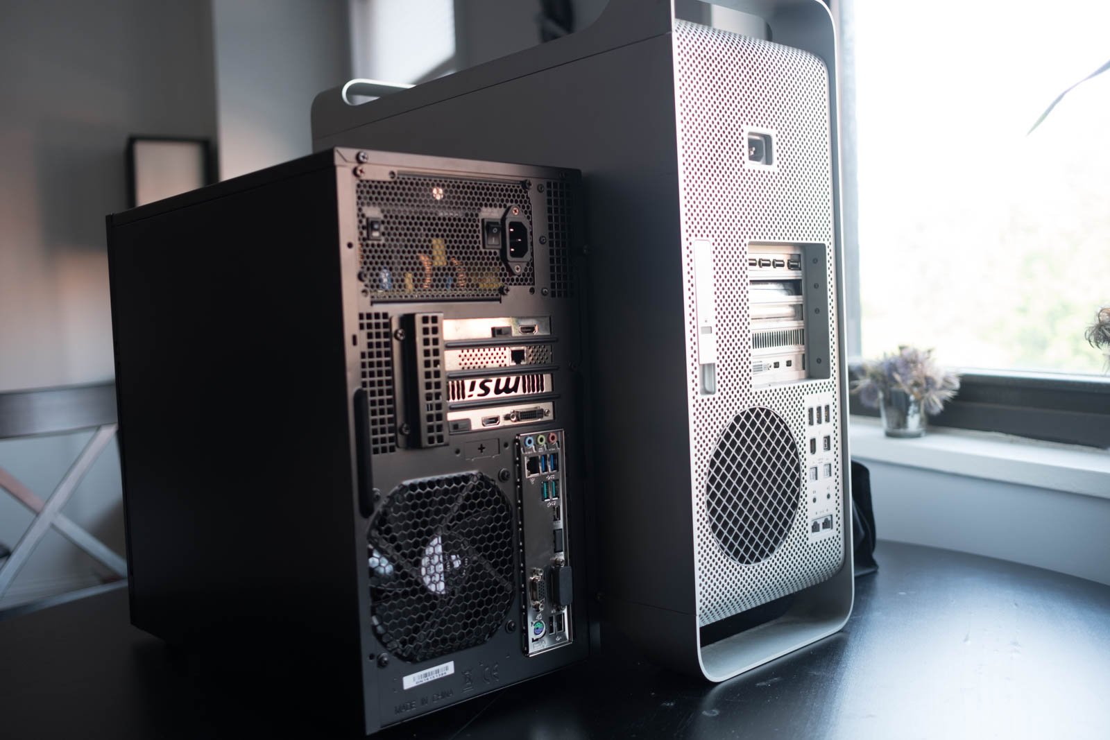

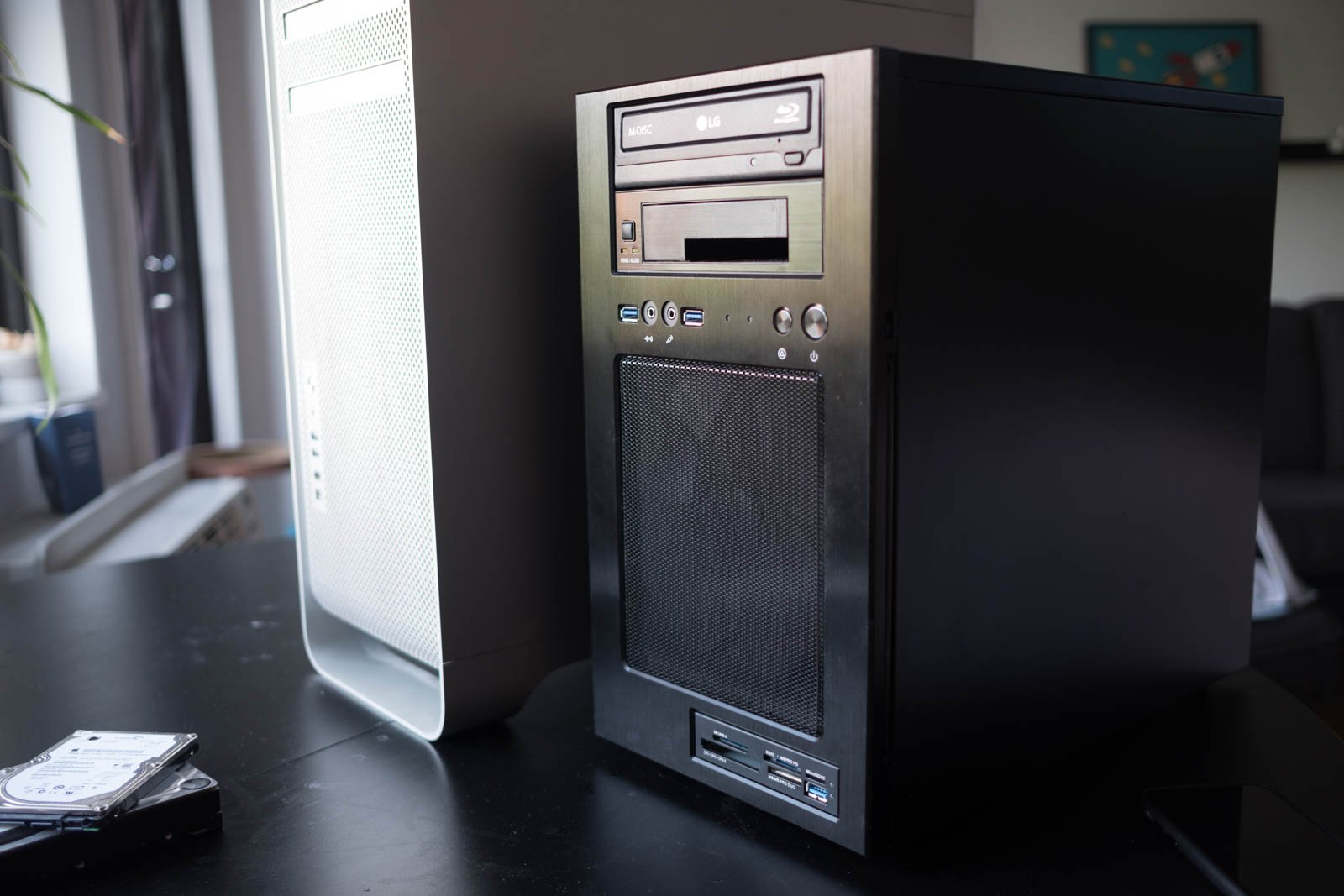

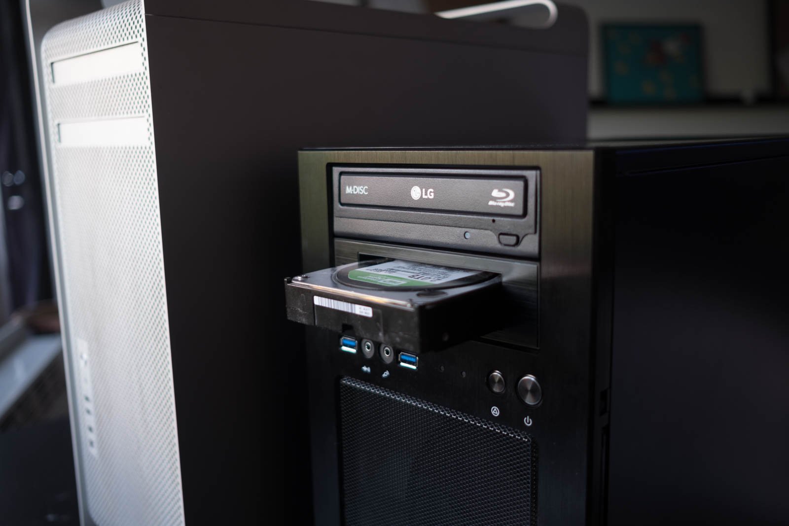

CASE:  Silverstone Tek Micro-ATX TJ08B-E
I chose the Silverstone tj08 mostly for its build quality, small
size, and number of drive bays. I needed 2 5.25 drive bays because I wanted a blu ray and a 3.5/2.5 dock, both for backup purposes. The blu ray player will mostly be for making hardcopies of personal photos and videos. The hard drive dock will be for larger backup jobs like OS restores using clonezilla or alternate boot drives to test new OSes on. I have many extra hard drives laying around and with this I can put them to use without always having them plugged in to save energy.  The case also has a 3.5 inch bay on the bottom of the case which I’ll be utilizing for a multicard reader. I’ll be only using it’s sd card slot for my digital camera , the USB port for a bluetooth adapter, and very rarely, the microSD slot for my audio recorder’s memory card.
Cooler: Corsair h55 AIO
I choose the Corsair h55 hydro series cooler for cpu cooling. Water cooling in general is probably overkill for this cpu, however it’s silent operation and very reasonable price make it an attractive alternative to traditional large aftermarket coolers. Also, since I decided on the SilverStone tj-08, it can be a bit cramped with it’s internal hard drive bays filled with a traditional cooler. Water cooling in this specific case makes it much easier to work in and optimizes it’s airflow considerably.
OTHER
EVGA SuperNOVA 650 G3 - it was a reasonably priced gold quality power supply.
Memory Choice : corsair vengeance ddr4 266
USB bluetooth adapter - for wireless headphones
Secondary Ethernet Nic : Intel I210-T1 , Works OOB so no drivers are required

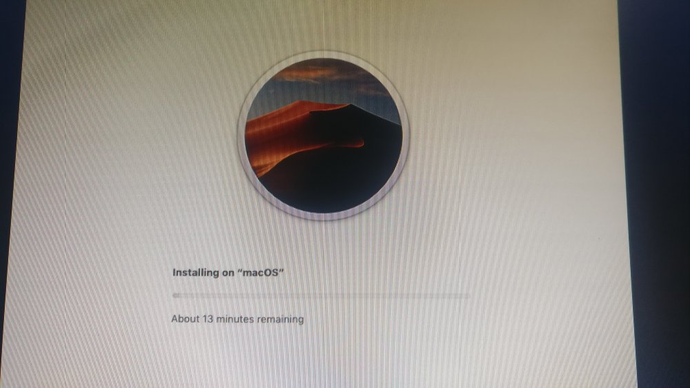

Hi,
I tried to install mojave 10.14.1 on ASUS PRIME H370-Plus. But it freezes on 13 mins to remaining screen after first installation.
I also added these files on bootable flash drive before installation,
  1. USBInjectAll.kext and place it in /EFI/Clover/kexts/Other
  2. Download OS-X-USB-Inject-All folder & unzip OS-X-USB-Inject-All & copy appropriate injector kext into /EFI/Clover/kexts/Other which is XHCI-unsupported.kext
Also in BIOS I already made these necessary changes:
  1.  VT-d-> disabled
  2.  CFG-Lock-> disabled
  3.  Secure Boot Mode-> disabled
  4.  Set OS Type to Other OS
  5.  IO Serial Port-> disabled
  6.  XHCI Handoff->enabled
I have tried all 2.0 USB ports but every time it stucks on this screen even if I formatted the boot drive and started from scratch.
Any help will be appreciated.

22 hours ago, poles89 said:
Hi,
  1.  VT-d-> disabled
Solved it by using OsxAptioFixDrv-64.efi or or OsxAptioFixDrv3-64.efi in place of  AptioMemoryFix.efi first on /EFI/drivers64UEFI/ folder.
