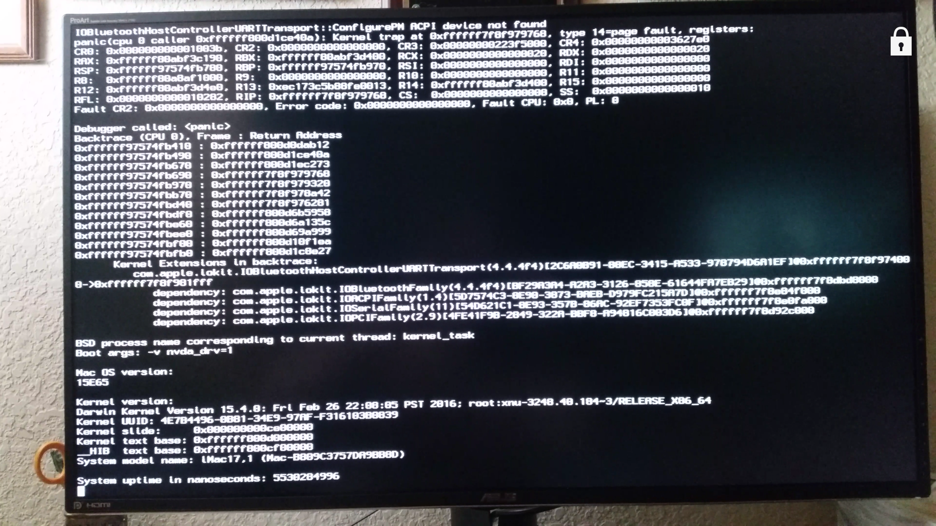

astroguy Posted June 11, 2018 Share Posted June 11, 2018 (edited) Sorry for the vague subject line, but I think I have a hardware issue and I'm having trouble diagnosing it. This is a LONG post because I'm trying to explain what I tried and to give you all the info that I do have. History: This has been a successful Hackintosh for 2 years 2 months. I have not changed the OS (still running 10.11.4) just to avoid any problems. I have not changed the hardware other than GPU about a year ago, hard drives over time, and RAM about two weeks ago. (Keep that RAM in mind.) Hardware: Motherboard: ASRock Z170 OC Formula CPU: Intel i7-6700K RAM: G.SKILL Ripjaws V Series 32GB DDR4 @2400, replaced with Corsair 64GB DDR4 @2133 (but lower CAS latency) GPU: MSI GeForce GTX 970 PSU: CORSAIR AX760 760W 80+ Platinum CPU Heatsink: CORSAIR Hydro Series H105 Problem, Tuesday Night: Catastrophic death. Just shut down, couldn't get it up. I spent over two hours midnight–2am, then another hour after I got up in the AM, determining that the heatsink pump had died. To make a three hour story short, the errors on the motherboard were all related to RAM, but it had been running fine with the new RAM for 10 days. I put in the old RAM and got the computer to boot, and then I heard that the fans were going full-tilt and saw the CPU temperature at just under boiling. And it shut down. I determined it was the pump and not motherboard because the pump did not turn on when I moved it to a header on the motherboard that had just been powering a fan that was fine. So I ordered a new CPU cooler and installed it yesterday. Problem, Sunday Night: It was running fine for a day, after installing the new CPU heat sink. We had a brown-out in the morning which apparently did NOT trip any UPS in the house, and the computer restarted. Seemed fine, then tonight (11 hrs after the brownout), I went to make dinner, came back and all the fans were going and the computer wasn't on. The light on the Corsair pump was flickering. Trying to Diagnose: So, with the light flickering, I thought maybe it was the motherboard after all, and the CPU fan 1 was just dead (or dying). No problem, moved it to CPU fan 2 and moved the fans for the heatsink to chassis 2 and tweaked the fan speeds in the BIOS (I was able to boot to it) and ... couldn't boot. I can get to the BIOS. I can start getting to the Mac OS, but I can't actually boot fully. The motherboard is cycling between error codes 00 and 19, which from what I can find means CPU (00) or RAM (19). I have tried powering the whole system down (on the PSU) for awhile, going back to the old RAM (works but then same error code on reboot), and even going to a passive heatsink I had in storage. Why this May Be a Hackintosh Question: I have a pattern now to diagnose. After hitting the restart a few times, I can get into the BIOS, no longer getting the 00/19 error on the motherboard. I can get to the Clover boot menu, at which point the diagnostic LED on the motherboard turns off. I can start the Mac OS, it spits out a bunch of diagnostic stuff, and then freezes, and the lights on the motherboard turn back on and flash between the 00 and 19 errors and the display shuts off. I get to the same spot in the Mac OS startup, and that's when it shuts down. To me, from the zero that I know about this, it looks like it's saying there's a CPU error. Meaning I may have fried the CPU (or motherboard? or both?) during that initial CPU cooler failure five days ago. I have attached a screenshot from the video I took of the screen while starting up the last time. CMOS Reset: I tried doing this as an addendum, after taking pictures of every screen in the BIOS so I could restore. The reset definitely reset the BIOS, I got it to boot to the BIOS again, but I'm stuck at the same death point as in the screenshot. The ONLY difference is that now instead of just stopping there, it goes black for a few seconds and returns to the BIOS option screen (F2 for BIOS, F11 for Boot, etc.), and then tries to boot the Mac OS again. Fails at the same point again, the only difference each time is that in that "Backtrace (CPU #) ..." line, the # changes, and the com.apple.lokit.IOBluetoothHostController... hex stuff is different. Help!? Do I need a new motherboard and CPU? Fortunately, everything is backed up hourly, and on my laptop, and the HDDs should still be fine. Edited June 11, 2018 by astroguy formatting issue Link to comment https://www.insanelymac.com/forum/topic/334426-kernel-panic-for-unknown-reason-maybe-cpu-or-mb-problem-help/ Share on other sites More sharing options...
MaLd0n Posted June 12, 2018 Share Posted June 12, 2018 disable serial port in bios send me files, run it and post here RunMe.app.zip Link to comment https://www.insanelymac.com/forum/topic/334426-kernel-panic-for-unknown-reason-maybe-cpu-or-mb-problem-help/#findComment-2618698 Share on other sites More sharing options...
astroguy Posted June 12, 2018 Author Share Posted June 12, 2018 Will try. I had to leave for a week-long trip just a few hours after the computer died, I get home late Sunday. Two questions to hopefully head off a delay: (a) Do you know how to disable the serial port in the BIIOS, but chance? (b) Your application clearly requires the macOS to boot ... if I do disable the serial ports and it still doesn't boot, what should I do? Link to comment https://www.insanelymac.com/forum/topic/334426-kernel-panic-for-unknown-reason-maybe-cpu-or-mb-problem-help/#findComment-2618817 Share on other sites More sharing options...
astroguy Posted June 18, 2018 Author Share Posted June 18, 2018 Okay, was able to change that in the BIOS, and it booted into macOS. Ran the diagnostic, and I've sent you a private message asking how to get it to you. The computer was up for about 3 hours and shut down again overnight. Restarted this morning perfectly fine. I have it up now, but I'm at work for 14 hours today in meetings. I have a MINIMUM of stuff going on: E-mail checking, Skype is up, weather server running, and a few downloads. Other things not needed, like USB external drives, are disconnected. Will see if it's still up when I get home tonight and will post here regardless. Link to comment https://www.insanelymac.com/forum/topic/334426-kernel-panic-for-unknown-reason-maybe-cpu-or-mb-problem-help/#findComment-2620641 Share on other sites More sharing options...

astroguy Posted June 19, 2018 Author Share Posted June 19, 2018 The computer was still going when I got home, but about 10 minutes ago, it froze and restarted and booted fine. I finally captured the report that Apple generates: Quote Anonymous UUID: 6252F72C-1727-A3B3-82D0-CF3F0EBFD3BD Mon Jun 18 20:54:08 2018 *** Panic Report *** panic(cpu 2 caller 0xffffff80069b44c4): "Possible memory corruption: pmap_pv_remove(0xffffff80a71ba8a0,0x89740000,0xed7d9d, 0x8000000ed7d9d066, 0xffffff874cda3b74, 0xfffffebce557ba00): null pv_list!"@/Library/Caches/com.apple.xbs/Sources/xnu/xnu-3248.40.184/osfmk/i386/pmap_internal.h:772 Backtrace (CPU 2), Frame : Return Address 0xffffff874cda3a30 : 0xffffff80068dab12 0xffffff874cda3ab0 : 0xffffff80069b44c4 0xffffff874cda3ba0 : 0xffffff80069b4c36 0xffffff874cda3c10 : 0xffffff8006960cc5 0xffffff874cda3d20 : 0xffffff800695626c 0xffffff874cda3d50 : 0xffffff80068fea41 0xffffff874cda3d90 : 0xffffff80068fe870 0xffffff874cda3df0 : 0xffffff80069074c5 0xffffff874cda3e30 : 0xffffff800690b96a 0xffffff874cda3e60 : 0xffffff80068d54c9 0xffffff874cda3ea0 : 0xffffff80069cec4e 0xffffff874cda3ec0 : 0xffffff80069ec23f BSD process name corresponding to current thread: Unknown Boot args: -v nvda_drv=1 Mac OS version: 15E65 Kernel version: Darwin Kernel Version 15.4.0: Fri Feb 26 22:08:05 PST 2016; root:xnu-3248.40.184~3/RELEASE_X86_64 Kernel UUID: 4E7B4496-0B81-34E9-97AF-F316103B0839 Kernel slide: 0x0000000006600000 Kernel text base: 0xffffff8006800000 __HIB text base: 0xffffff8006700000 System model name: iMac17,1 (Mac-B809C3757DA9BB8D) System uptime in nanoseconds: 42655023536066 last loaded kext at 38421979867: com.apple.filesystems.smbfs 3.0.0 (addr 0xffffff7f87895000, size 413696) last unloaded kext at 114327410676: com.kext.HDAEnabler 1.0.0d1 (addr 0xffffff7f8912d000, size 16384) loaded kexts: com.Cycling74.driver.Soundflower 1.6.7 com.checkpoint.cpfw 1.0 com.intel.driver.EnergyDriver 2.0 com.nvidia.web.GeForceWeb 10.1.1 com.nvidia.web.NVDAGM100HalWeb 10.1.1 com.nvidia.web.NVDAResmanWeb 10.1.1 com.Logitech.Unifying.HID Driver 1.3.3 com.Logitech.Control Center.HID Driver 3.9.3 com.silabs.driver.CP210xVCPDriver64 3.0.0d1 at.obdev.nke.LittleSnitch 4718 org.hwsensors.driver.LPCSensors 1406 com.insanelymac.IntelMausiEthernet 2.1.0d5 org.hwsensors.driver.GPUSensors 1406 org.hwsensors.driver.CPUSensors 1406 as.vit9696.AppleALC 1.0.8 org.netkas.driver.FakeSMC 1406 com.apple.filesystems.smbfs 3.0.0 com.apple.driver.AGPM 110.21.18 com.apple.driver.ApplePlatformEnabler 2.6.0d0 com.apple.driver.X86PlatformShim 1.0.0 com.apple.driver.pmtelemetry 1 com.apple.iokit.IOUserEthernet 1.0.1 com.apple.iokit.IOBluetoothSerialManager 4.4.4f4 com.apple.Dont_Steal_Mac_OS_X 7.0.0 com.apple.driver.AppleHV 1 com.apple.filesystems.autofs 3.0 com.apple.driver.AppleHDA 274.7 com.apple.driver.AudioAUUC 1.70 com.apple.driver.AppleUpstreamUserClient 3.6.1 com.apple.driver.AppleMCCSControl 1.2.13 com.apple.driver.AppleOSXWatchdog 1 com.apple.driver.AppleIntelPCHPMC 1.1 com.apple.driver.AppleIntelSlowAdaptiveClocking 4.0.0 com.apple.iokit.SCSITaskUserClient 3.7.7 com.apple.iokit.IOAHCIBlockStorage 2.8.5 com.apple.AppleFSCompression.AppleFSCompressionTypeDataless 1.0.0d1 com.apple.AppleFSCompression.AppleFSCompressionTypeZlib 1.0.0 com.apple.BootCache 38 com.apple.driver.AppleAHCIPort 3.1.8 com.apple.driver.AppleACPIButtons 4.0 com.apple.driver.AppleRTC 2.0 com.apple.driver.AppleHPET 1.8 com.apple.driver.AppleSMBIOS 2.1 com.apple.driver.AppleAPIC 1.7 com.apple.nke.applicationfirewall 163 com.apple.security.quarantine 3 com.apple.security.TMSafetyNet 8 com.apple.iokit.IOSurface 108.2.1 com.apple.driver.CoreCaptureResponder 1 com.apple.driver.corecapture 1.0.4 com.apple.kext.triggers 1.0 com.apple.driver.DspFuncLib 274.7 com.apple.kext.OSvKernDSPLib 525 com.apple.driver.AppleSMBusController 1.0.14d1 com.apple.iokit.IOSMBusFamily 1.1 com.apple.iokit.IOAcceleratorFamily2 205.3 com.apple.AppleGraphicsDeviceControl 3.12.6 com.apple.iokit.IONDRVSupport 2.4.1 com.apple.driver.AppleHDAController 274.7 com.apple.iokit.IOGraphicsFamily 2.4.1 com.apple.iokit.IOHDAFamily 274.7 com.apple.driver.X86PlatformPlugin 1.0.0 com.apple.driver.AppleSMC 3.1.9 com.apple.driver.IOPlatformPluginFamily 6.0.0d7 com.apple.iokit.IOSlowAdaptiveClockingFamily 1.0.0 com.apple.iokit.IOSCSIMultimediaCommandsDevice 3.7.7 com.apple.iokit.IOBDStorageFamily 1.8 com.apple.iokit.IODVDStorageFamily 1.8 com.apple.iokit.IOCDStorageFamily 1.8 com.apple.iokit.IOAHCISerialATAPI 2.6.2 com.apple.iokit.IOSCSIArchitectureModelFamily 3.7.7 com.apple.driver.AppleUSBAudio 303.3.1 com.apple.iokit.IOAudioFamily 204.3 com.apple.vecLib.kext 1.2.0 com.apple.driver.AppleHIDKeyboard 181 com.apple.driver.usb.IOUSBHostHIDDevice 1.0.1 com.apple.driver.IOBluetoothHIDDriver 4.4.4f4 com.apple.iokit.IOBluetoothFamily 4.4.4f4 com.apple.iokit.IOUSBHIDDriver 900.4.1 com.apple.iokit.IOSerialFamily 11 com.apple.driver.usb.cdc 5.0.0 com.apple.driver.usb.networking 5.0.0 com.apple.driver.usb.AppleUSBHostCompositeDevice 1.0.1 com.apple.driver.usb.AppleUSBHub 1.0.1 com.apple.iokit.IONetworkingFamily 3.2 com.apple.iokit.IOAHCIFamily 2.8.1 com.apple.driver.usb.AppleUSBXHCIPCI 1.0.1 com.apple.driver.usb.AppleUSBXHCI 1.0.1 com.apple.iokit.IOUSBFamily 900.4.1 com.apple.iokit.IOUSBHostFamily 1.0.1 com.apple.driver.AppleUSBHostMergeProperties 1.0.1 com.apple.driver.AppleEFINVRAM 2.0 com.apple.driver.AppleEFIRuntime 2.0 com.apple.iokit.IOHIDFamily 2.0.0 com.apple.security.sandbox 300.0 com.apple.kext.AppleMatch 1.0.0d1 com.apple.driver.AppleKeyStore 2 com.apple.driver.AppleMobileFileIntegrity 1.0.5 com.apple.driver.AppleCredentialManager 1.0 com.apple.driver.DiskImages 417.2 com.apple.iokit.IOStorageFamily 2.1 com.apple.iokit.IOReportFamily 31 com.apple.driver.AppleFDEKeyStore 28.30 com.apple.driver.AppleACPIPlatform 4.0 com.apple.iokit.IOPCIFamily 2.9 com.apple.iokit.IOACPIFamily 1.4 com.apple.kec.pthread 1 com.apple.kec.Libm 1 com.apple.kec.corecrypto 1.0 Model: iMac17,1, BootROM IM171.0105.B07, 4 processors, Intel Core i7, 4.01 GHz, 64 GB, SMC 2.33f10 Graphics: NVIDIA GeForce GTX 970, NVIDIA GeForce GTX 970, PCIe, 4095 MB Memory Module: BANK0/DIMM0, 16 GB, DDR4, 2133 MHz, Corsair, Part# Memory Module: BANK1/DIMM0, 16 GB, DDR4, 2133 MHz, Corsair, Part# Memory Module: BANK0/DIMM1, 16 GB, DDR4, 2133 MHz, Corsair, Part# Memory Module: BANK1/DIMM1, 16 GB, DDR4, 2133 MHz, Corsair, Part# Network Service: Ethernet, Ethernet, en0 Serial ATA Device: WDC WD80EFZX-68UW8N0, 8 TB Serial ATA Device: ST8000DM005-2EH112, 8 TB Serial ATA Device: HL-DT-ST BD-RE WH16NS40 Serial ATA Device: Samsung SSD 850 EVO 1TB, 1 TB Serial ATA Device: Samsung SSD 840 EVO 1TB, 1 TB USB Device: USB 3.0 Bus USB Device: USB2.0 Hub USB Device: Logitech USB Headset H540 USB Device: USB2.0 Hub USB Device: USB2.0 Hub USB Device: USB Receiver USB Device: ASM107x USB Device: Keyboard Hub USB Device: Apple Keyboard USB Device: CP2102 USB to UART Bridge Controller USB Device: USB 3.0 Bus Thunderbolt Bus: Link to comment https://www.insanelymac.com/forum/topic/334426-kernel-panic-for-unknown-reason-maybe-cpu-or-mb-problem-help/#findComment-2620751 Share on other sites More sharing options...
astroguy Posted June 20, 2018 Author Share Posted June 20, 2018 Okay, it shut down at 4pm today and would not boot. RAM check cycling on the motherboard, then 00 and 19 (CPU and RAM, per before). Took all new RAM out, put in old, same thing. Then worked in single-module mode. Worked in dual. And ... then worked in quad. However, 17GB is taken up by "Wired" memory, instead of ~3GB per usual. Now I'm starting to wonder if there was that motherboard surge and it fried not only the old CPU cooler pump, but also fried one of the RAM slots. Here's the kernel panic report this time: Quote Anonymous UUID: 6252F72C-1727-A3B3-82D0-CF3F0EBFD3BD Tue Jun 19 19:59:49 2018 *** Panic Report *** panic(cpu 0 caller 0xffffff8015320b4e): "a freed zone element has been modified in zone kalloc.48: expected 0xffffff80bfc2b980 but found 0xffffff80bfc2bb80, bits changed 0x200, at offset 0 of 48 in element 0xffffff80bfc2b3a0, cookies 0x3f001192e9424bee 0x5352161a222cfaf"@/Library/Caches/com.apple.xbs/Sources/xnu/xnu-3248.40.184/osfmk/kern/zalloc.c:503 Backtrace (CPU 0), Frame : Return Address 0xffffff975fb93930 : 0xffffff80152dab12 0xffffff975fb939b0 : 0xffffff8015320b4e 0xffffff975fb93a20 : 0xffffff80153205f6 0xffffff975fb93a60 : 0xffffff801531f282 0xffffff975fb93b90 : 0xffffff801583933b 0xffffff975fb93bb0 : 0xffffff80158538da 0xffffff975fb93be0 : 0xffffff801585e4e2 0xffffff975fb93c30 : 0xffffff801585ea92 0xffffff975fb93c80 : 0xffffff801585e862 0xffffff975fb93cd0 : 0xffffff8015856177 0xffffff975fb93d20 : 0xffffff801583ee23 0xffffff975fb93d60 : 0xffffff8015884a51 0xffffff975fb93d90 : 0xffffff80158dd801 0xffffff975fb93e00 : 0xffffff80153993a9 0xffffff975fb93e30 : 0xffffff80152df283 0xffffff975fb93e60 : 0xffffff80152c28b8 0xffffff975fb93ea0 : 0xffffff80152d2665 0xffffff975fb93f10 : 0xffffff80153b8bda 0xffffff975fb93fb0 : 0xffffff80153eca96 BSD process name corresponding to current thread: WindowServer Boot args: -v nvda_drv=1 Mac OS version: 15E65 Kernel version: Darwin Kernel Version 15.4.0: Fri Feb 26 22:08:05 PST 2016; root:xnu-3248.40.184~3/RELEASE_X86_64 Kernel UUID: 4E7B4496-0B81-34E9-97AF-F316103B0839 Kernel slide: 0x0000000015000000 Kernel text base: 0xffffff8015200000 __HIB text base: 0xffffff8015100000 System model name: iMac17,1 (Mac-B809C3757DA9BB8D) System uptime in nanoseconds: 77057864765805 last loaded kext at 36238831753: com.apple.filesystems.smbfs 3.0.0 (addr 0xffffff7f96295000, size 413696) last unloaded kext at 111806227772: com.kext.HDAEnabler 1.0.0d1 (addr 0xffffff7f97b93000, size 16384) loaded kexts: com.Cycling74.driver.Soundflower 1.6.7 com.checkpoint.cpfw 1.0 com.intel.driver.EnergyDriver 2.0 com.nvidia.web.GeForceWeb 10.1.1 com.nvidia.web.NVDAGM100HalWeb 10.1.1 com.nvidia.web.NVDAResmanWeb 10.1.1 com.Logitech.Unifying.HID Driver 1.3.3 com.Logitech.Control Center.HID Driver 3.9.3 com.silabs.driver.CP210xVCPDriver64 3.0.0d1 at.obdev.nke.LittleSnitch 4718 com.insanelymac.IntelMausiEthernet 2.1.0d5 org.hwsensors.driver.LPCSensors 1406 org.hwsensors.driver.GPUSensors 1406 org.hwsensors.driver.CPUSensors 1406 as.vit9696.AppleALC 1.0.8 org.netkas.driver.FakeSMC 1406 com.apple.filesystems.smbfs 3.0.0 com.apple.driver.AGPM 110.21.18 com.apple.driver.ApplePlatformEnabler 2.6.0d0 com.apple.driver.X86PlatformShim 1.0.0 com.apple.driver.pmtelemetry 1 com.apple.iokit.IOUserEthernet 1.0.1 com.apple.iokit.IOBluetoothSerialManager 4.4.4f4 com.apple.Dont_Steal_Mac_OS_X 7.0.0 com.apple.driver.AppleHV 1 com.apple.driver.AppleIntelPCHPMC 1.1 com.apple.filesystems.autofs 3.0 com.apple.driver.AppleHDA 274.7 com.apple.driver.AudioAUUC 1.70 com.apple.driver.AppleUpstreamUserClient 3.6.1 com.apple.driver.AppleMCCSControl 1.2.13 com.apple.driver.AppleOSXWatchdog 1 com.apple.driver.AppleIntelSlowAdaptiveClocking 4.0.0 com.apple.iokit.SCSITaskUserClient 3.7.7 com.apple.iokit.IOAHCIBlockStorage 2.8.5 com.apple.AppleFSCompression.AppleFSCompressionTypeDataless 1.0.0d1 com.apple.AppleFSCompression.AppleFSCompressionTypeZlib 1.0.0 com.apple.BootCache 38 com.apple.driver.AppleAHCIPort 3.1.8 com.apple.driver.AppleRTC 2.0 com.apple.driver.AppleACPIButtons 4.0 com.apple.driver.AppleHPET 1.8 com.apple.driver.AppleSMBIOS 2.1 com.apple.driver.AppleAPIC 1.7 com.apple.nke.applicationfirewall 163 com.apple.security.quarantine 3 com.apple.security.TMSafetyNet 8 com.apple.iokit.IOSurface 108.2.1 com.apple.driver.CoreCaptureResponder 1 com.apple.driver.corecapture 1.0.4 com.apple.kext.triggers 1.0 com.apple.driver.DspFuncLib 274.7 com.apple.kext.OSvKernDSPLib 525 com.apple.driver.AppleSMBusController 1.0.14d1 com.apple.iokit.IOSMBusFamily 1.1 com.apple.iokit.IOAcceleratorFamily2 205.3 com.apple.AppleGraphicsDeviceControl 3.12.6 com.apple.driver.AppleHDAController 274.7 com.apple.iokit.IOHDAFamily 274.7 com.apple.iokit.IONDRVSupport 2.4.1 com.apple.iokit.IOGraphicsFamily 2.4.1 com.apple.iokit.IOSlowAdaptiveClockingFamily 1.0.0 com.apple.driver.X86PlatformPlugin 1.0.0 com.apple.driver.IOPlatformPluginFamily 6.0.0d7 com.apple.driver.AppleSMC 3.1.9 com.apple.iokit.IOSCSIMultimediaCommandsDevice 3.7.7 com.apple.iokit.IOBDStorageFamily 1.8 com.apple.iokit.IODVDStorageFamily 1.8 com.apple.iokit.IOCDStorageFamily 1.8 com.apple.iokit.IOAHCISerialATAPI 2.6.2 com.apple.driver.AppleUSBAudio 303.3.1 com.apple.iokit.IOAudioFamily 204.3 com.apple.vecLib.kext 1.2.0 com.apple.iokit.IOSCSIBlockCommandsDevice 3.7.7 com.apple.driver.AppleHIDKeyboard 181 com.apple.driver.usb.IOUSBHostHIDDevice 1.0.1 com.apple.driver.IOBluetoothHIDDriver 4.4.4f4 com.apple.iokit.IOBluetoothFamily 4.4.4f4 com.apple.iokit.IOUSBHIDDriver 900.4.1 com.apple.iokit.IOUSBMassStorageDriver 1.0.0 com.apple.iokit.IOSCSIArchitectureModelFamily 3.7.7 com.apple.iokit.IOSerialFamily 11 com.apple.driver.usb.cdc 5.0.0 com.apple.driver.usb.networking 5.0.0 com.apple.driver.usb.AppleUSBHostCompositeDevice 1.0.1 com.apple.driver.usb.AppleUSBHub 1.0.1 com.apple.iokit.IONetworkingFamily 3.2 com.apple.iokit.IOAHCIFamily 2.8.1 com.apple.driver.usb.AppleUSBXHCIPCI 1.0.1 com.apple.driver.usb.AppleUSBXHCI 1.0.1 com.apple.iokit.IOUSBFamily 900.4.1 com.apple.iokit.IOUSBHostFamily 1.0.1 com.apple.driver.AppleUSBHostMergeProperties 1.0.1 com.apple.driver.AppleEFINVRAM 2.0 com.apple.iokit.IOHIDFamily 2.0.0 com.apple.driver.AppleEFIRuntime 2.0 com.apple.security.sandbox 300.0 com.apple.kext.AppleMatch 1.0.0d1 com.apple.driver.AppleKeyStore 2 com.apple.driver.AppleMobileFileIntegrity 1.0.5 com.apple.driver.AppleCredentialManager 1.0 com.apple.driver.DiskImages 417.2 com.apple.iokit.IOStorageFamily 2.1 com.apple.iokit.IOReportFamily 31 com.apple.driver.AppleFDEKeyStore 28.30 com.apple.driver.AppleACPIPlatform 4.0 com.apple.iokit.IOPCIFamily 2.9 com.apple.iokit.IOACPIFamily 1.4 com.apple.kec.pthread 1 com.apple.kec.Libm 1 com.apple.kec.corecrypto 1.0 Model: iMac17,1, BootROM IM171.0105.B07, 4 processors, Intel Core i7, 4.01 GHz, 64 GB, SMC 2.33f10 Graphics: NVIDIA GeForce GTX 970, NVIDIA GeForce GTX 970, PCIe, 4095 MB Memory Module: BANK0/DIMM0, 16 GB, DDR4, 2133 MHz, Corsair, Part# Memory Module: BANK1/DIMM0, 16 GB, DDR4, 2133 MHz, Corsair, Part# Memory Module: BANK0/DIMM1, 16 GB, DDR4, 2133 MHz, Corsair, Part# Memory Module: BANK1/DIMM1, 16 GB, DDR4, 2133 MHz, Corsair, Part# Network Service: Ethernet, Ethernet, en0 Serial ATA Device: WDC WD80EFZX-68UW8N0, 8 TB Serial ATA Device: ST8000DM005-2EH112, 8 TB Serial ATA Device: HL-DT-ST BD-RE WH16NS40 Serial ATA Device: Samsung SSD 850 EVO 1TB, 1 TB Serial ATA Device: Samsung SSD 840 EVO 1TB, 1 TB USB Device: USB 3.0 Bus USB Device: USB2.0 Hub USB Device: Logitech USB Headset H540 USB Device: USB2.0 Hub USB Device: USB2.0 Hub USB Device: USB Receiver USB Device: ASM107x USB Device: Keyboard Hub USB Device: Apple Keyboard USB Device: USB 3.0 Bus Thunderbolt Bus: Link to comment https://www.insanelymac.com/forum/topic/334426-kernel-panic-for-unknown-reason-maybe-cpu-or-mb-problem-help/#findComment-2621127 Share on other sites More sharing options...
astroguy Posted July 6, 2018 Author Share Posted July 6, 2018 A final update: The computer has been running continuously for about two weeks now, though I will need to replace the motherboard, I got an RMA and will be replacing the RAM, while I'm replacing the motherboard I might as well replace the CPU (upgrade), and because of what might have happened, I'll be replacing the PSU. What I think happened: A surge in the motherboard, either due to a fault in it or the PSU, blew out the connector to the CPU pump, and the CPU pump. It also blew out one or two RAM slots and at least one of the RAM modules. Replacing the CPU cooler worked, once I moved the hookups around, and going back to my original RAM before my upgrade has allowed the computer to run without crashing, though the OS thinks half the RAM is used up upon startup which is why I think the RAM sockets are also borked. Link to comment https://www.insanelymac.com/forum/topic/334426-kernel-panic-for-unknown-reason-maybe-cpu-or-mb-problem-help/#findComment-2624456 Share on other sites More sharing options...
