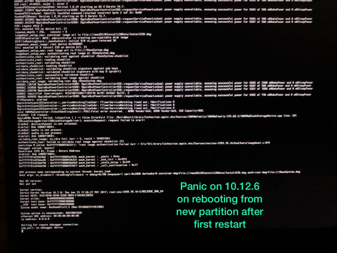

shamota Posted May 19, 2018 Share Posted May 19, 2018 Hello. With a friend experienced hackintosher we try to install High Sierra on Yoga 730 15ikb laptop (i7 8550U,16gb,Samsung m.2, intel 620, UHD) with no success. When we go on APFS way (current Clover folder attached), the installer panics on the first step when 2 minutes remaining before the first reboot. If we go on JHFS+ way, it finishes 1st step, reboots, loads and gets panic on the second stage with apple logo on the black screen, sometimes on 21 minute remains, sometimes on 15th or later on calculating time remaining. The text of panic is not shown above the frozen screen (or just rebooting without debug=0x100), keepsyms=1 was on/off.. So literally it's no way to see what causing the panic.. Another strange thing is that when booting after unsuccessful APFS installing attempt, USB mouse doesn't work, I have to format drive with disk utility to JHFS+ using keyboard, reboot installer, and then the mouse works. If we don't use APFS there is no such a problem. We also tried 10.12.6 (with appropriate config and kexts of course) and there is a panic after first restart and before booting second step from newly created partition - shot of that panic is attached. Is there anything wrong in my laptop? Or we missing something? we tried a lot of different things, can someone please check our clover folder, I've extracted tables with F2 + F4 ) CLOVER.zip here https://drive.google.com/open?id=1eKboAgHwYPImBcDE-8sPp7hJ4oLEgVYJ thank you Link to comment https://www.insanelymac.com/forum/topic/334129-lenovo-yoga-730-panic-during-intallation/ Share on other sites More sharing options...

shamota Posted May 19, 2018 Author Share Posted May 19, 2018 We realized after deeper research that my laptop has Samsung PM981 SSD which is reported to have problems with macOS, so now trying the cloning way, crossing fingers it will work Link to comment https://www.insanelymac.com/forum/topic/334129-lenovo-yoga-730-panic-during-intallation/#findComment-2614221 Share on other sites More sharing options...
MaLd0n Posted May 19, 2018 Share Posted May 19, 2018 012345678 is not dor ig-platform-id, is for intel gfx fake PM981 dont work xD Link to comment https://www.insanelymac.com/forum/topic/334129-lenovo-yoga-730-panic-during-intallation/#findComment-2614222 Share on other sites More sharing options...
shamota Posted May 19, 2018 Author Share Posted May 19, 2018 I see people reporting success with some workarounds and cloning instead of installing: Link to comment https://www.insanelymac.com/forum/topic/334129-lenovo-yoga-730-panic-during-intallation/#findComment-2614225 Share on other sites More sharing options...
MaLd0n Posted May 19, 2018 Share Posted May 19, 2018 only crash, don't work good, forget it Link to comment https://www.insanelymac.com/forum/topic/334129-lenovo-yoga-730-panic-during-intallation/#findComment-2614234 Share on other sites More sharing options...
