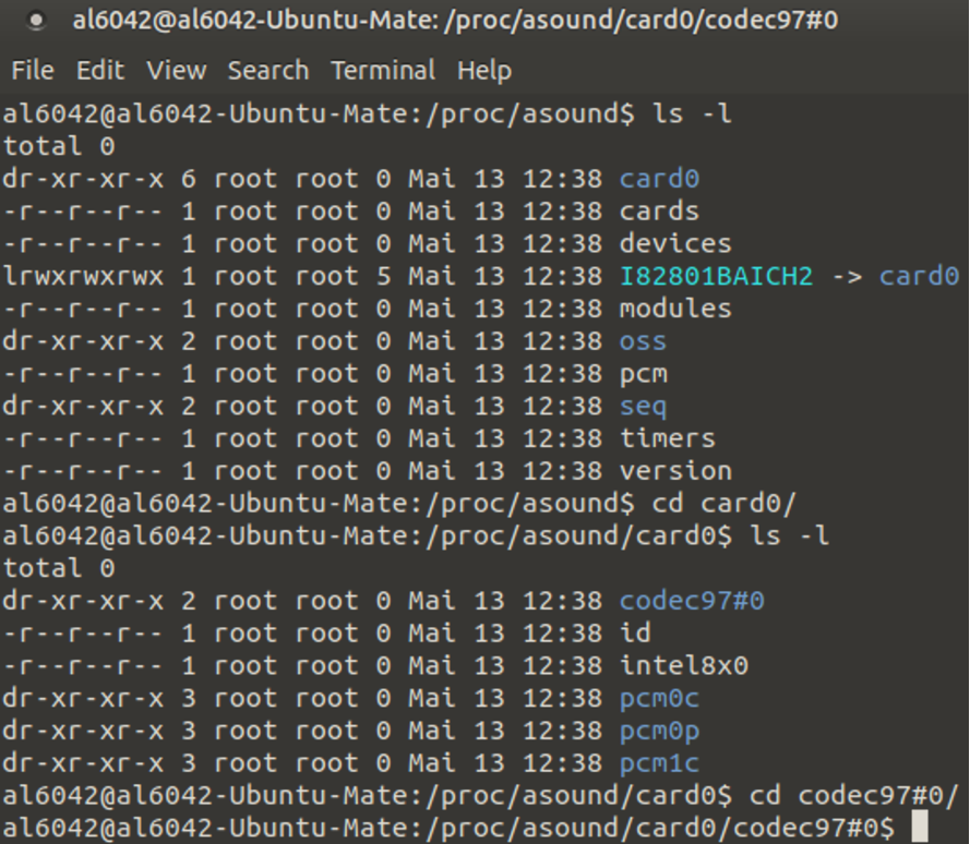

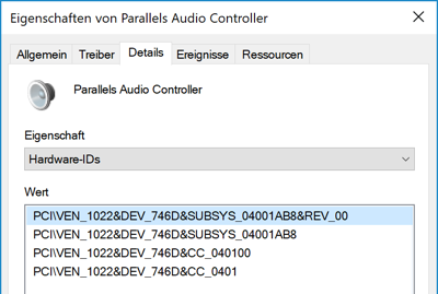

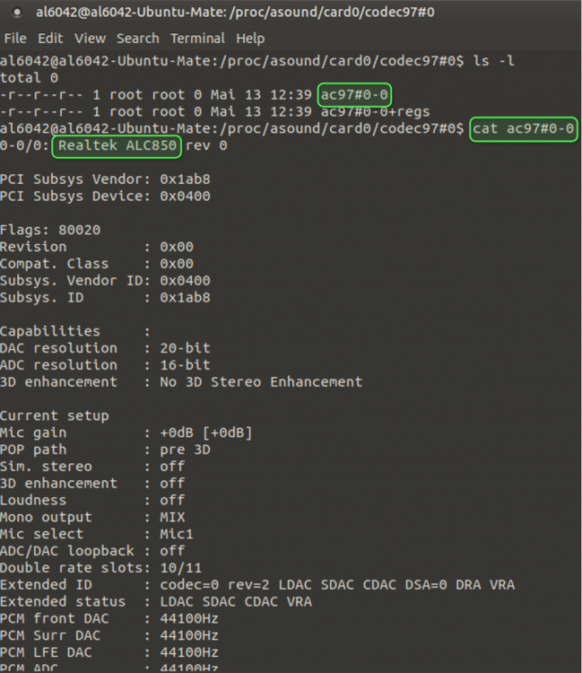

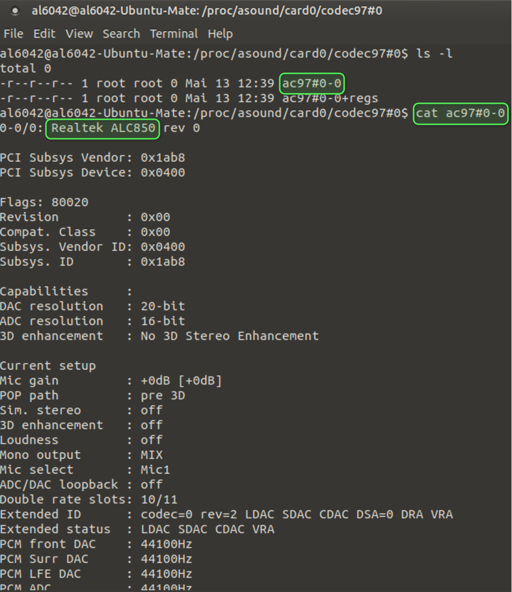

al6042 Posted May 13, 2018 Share Posted May 13, 2018 That depends on which Audio codec is used in your laptop... To get the information from windows, use the device manager and check in the "Properties" of your sound card the "Details" tab... under "Hardware-IDs" you should find the Vendor- & Device-IDs which tells us the name of the Audio codec. Or you use a Live-Linux-Bootstick and check out the directory /proc/asound which should contain different "/cardX" directories, in which "X" stands for a number. In each such a directory you should also find one or more subdirs with the "#X" extension. For each of those check with cat name#X the contents, which should show something like Link to comment https://www.insanelymac.com/forum/topic/334071-msi-gv62-10134-wifi-not-work/#findComment-2613397 Share on other sites More sharing options...
