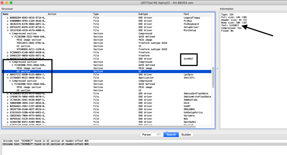

..hey devs, looking for an assist getting sensors read... chipset SCH5617...not currently supported by LPCSensors plugin....I've found some info, and an app in windows that does read from the chip (Hmonitor Version 4.5.4.2) but I'm not knowledgeable enough to tear into the app and see how it works.....I'll include what info I could find...please find attached 2 pdf files, one relates specifically to the SCH5617, the other is data sheet for SCH5627P but refers to SCH5617 differences (hoping it supplies some useful tidbits)
...hoping for a reply...thx.
Edited by RobertX
cleaning up another tooooo long post
https://www.insanelymac.com/forum/topic/333787-main-sensor-sch5617reprise/
some more  information maybe can be help full

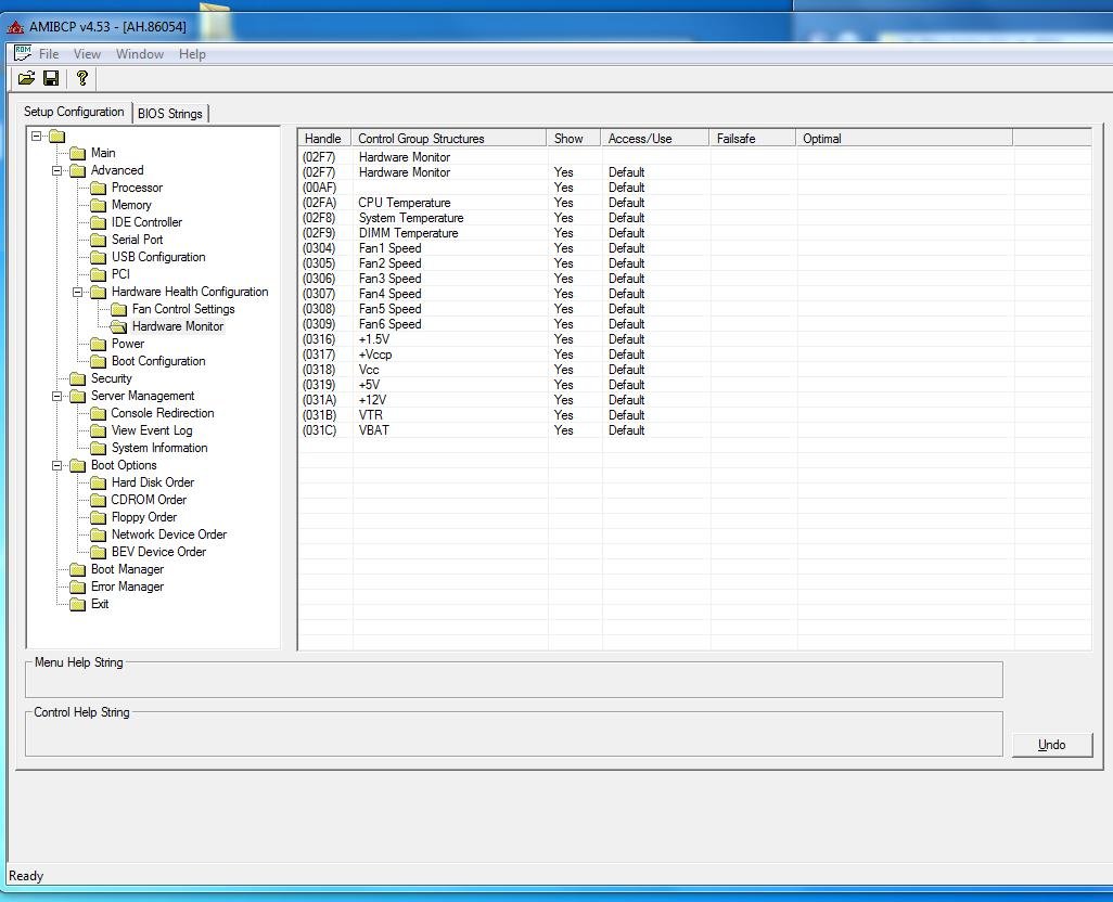

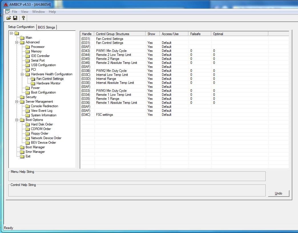

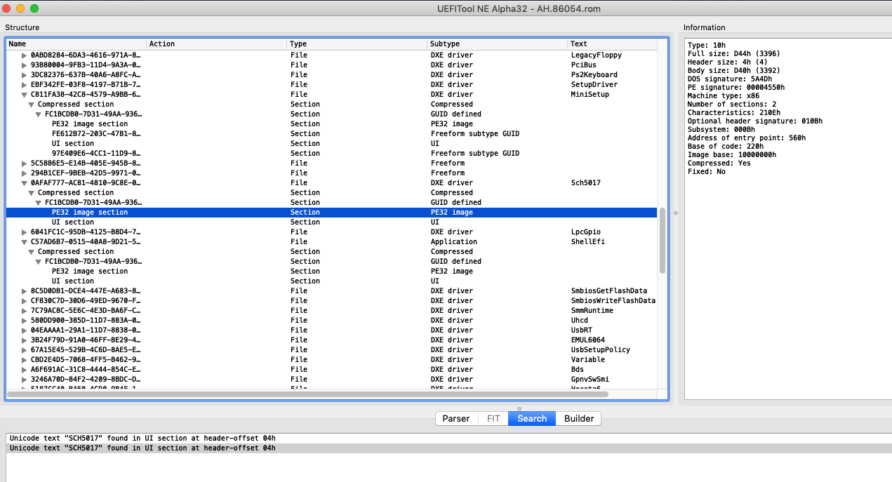

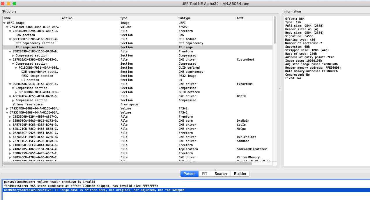

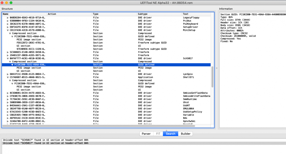

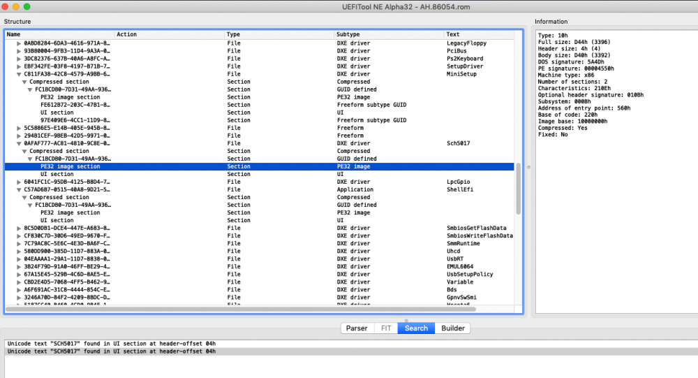

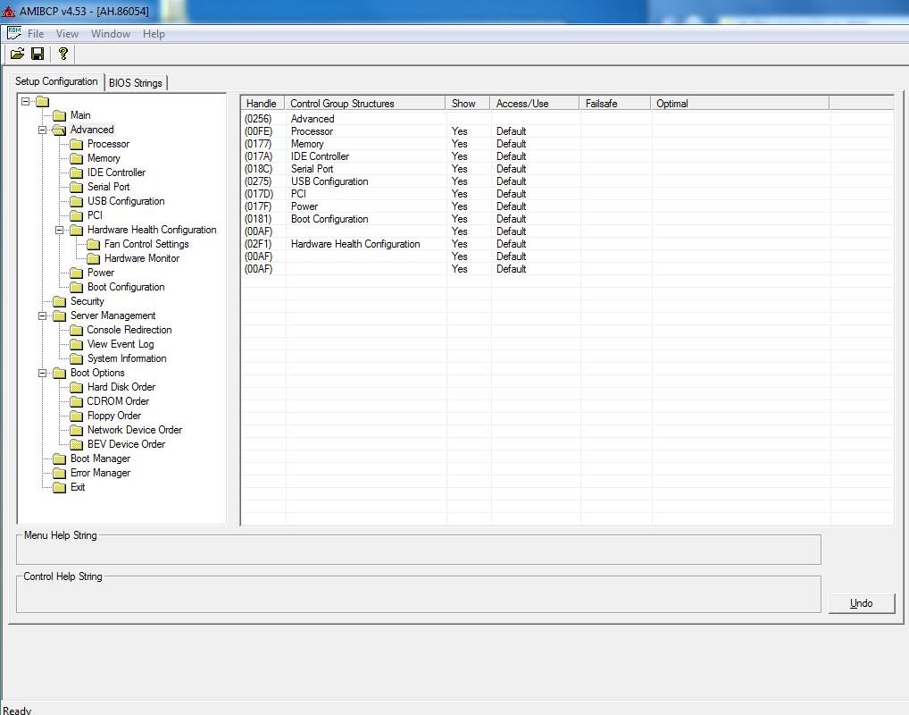

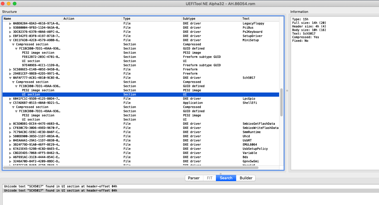

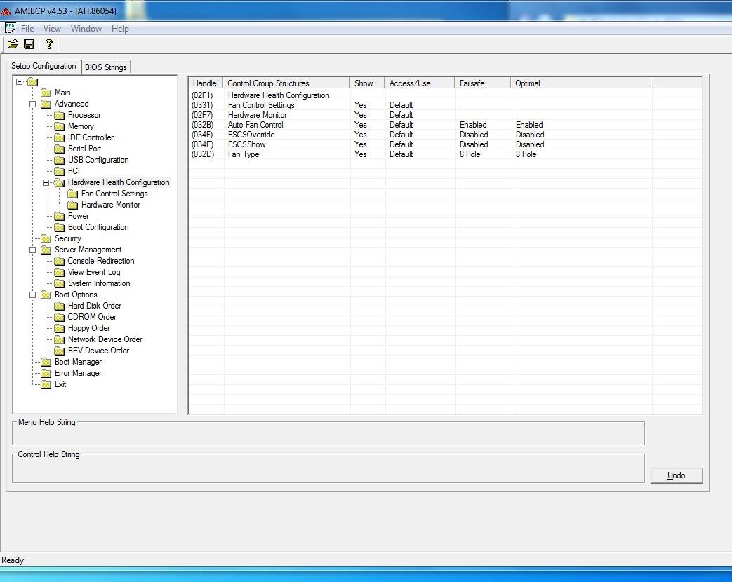

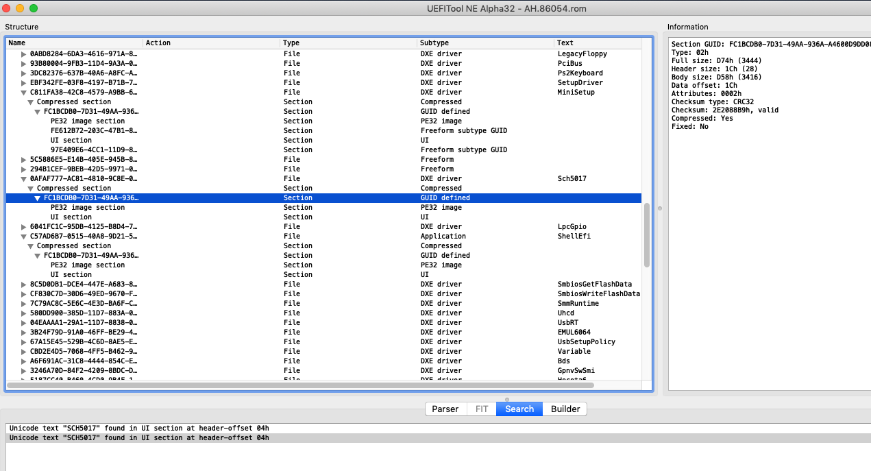

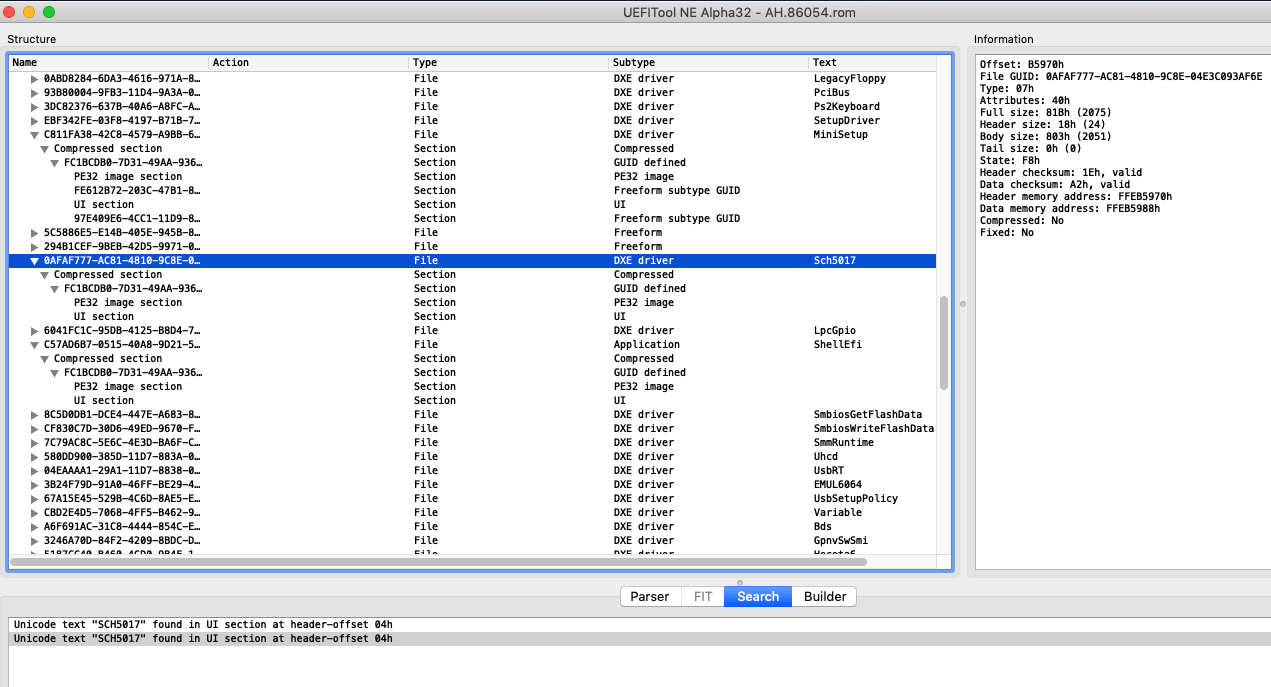

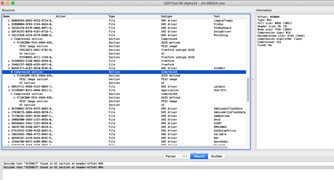

i am again in the hope that you Dev guy can do something more then i can
i got a UEFI Rom which is easily readable  and hold all the information what we need
Specifically i am talking about sensor chip or Super IO what ever you want to call
These are some of the Chips they are working just the same way
SMSC DME1737 - SMSC SCH5027D-NW -SMSC SCH5027E-NW - SMSC SCH5017-NW - Asus A8000
  • my request is if we can use the data to add this chip SMSC SCH5027E-NW Screenshot 2019-04-17 at 05.10.38.png
Edited by Rockey12
