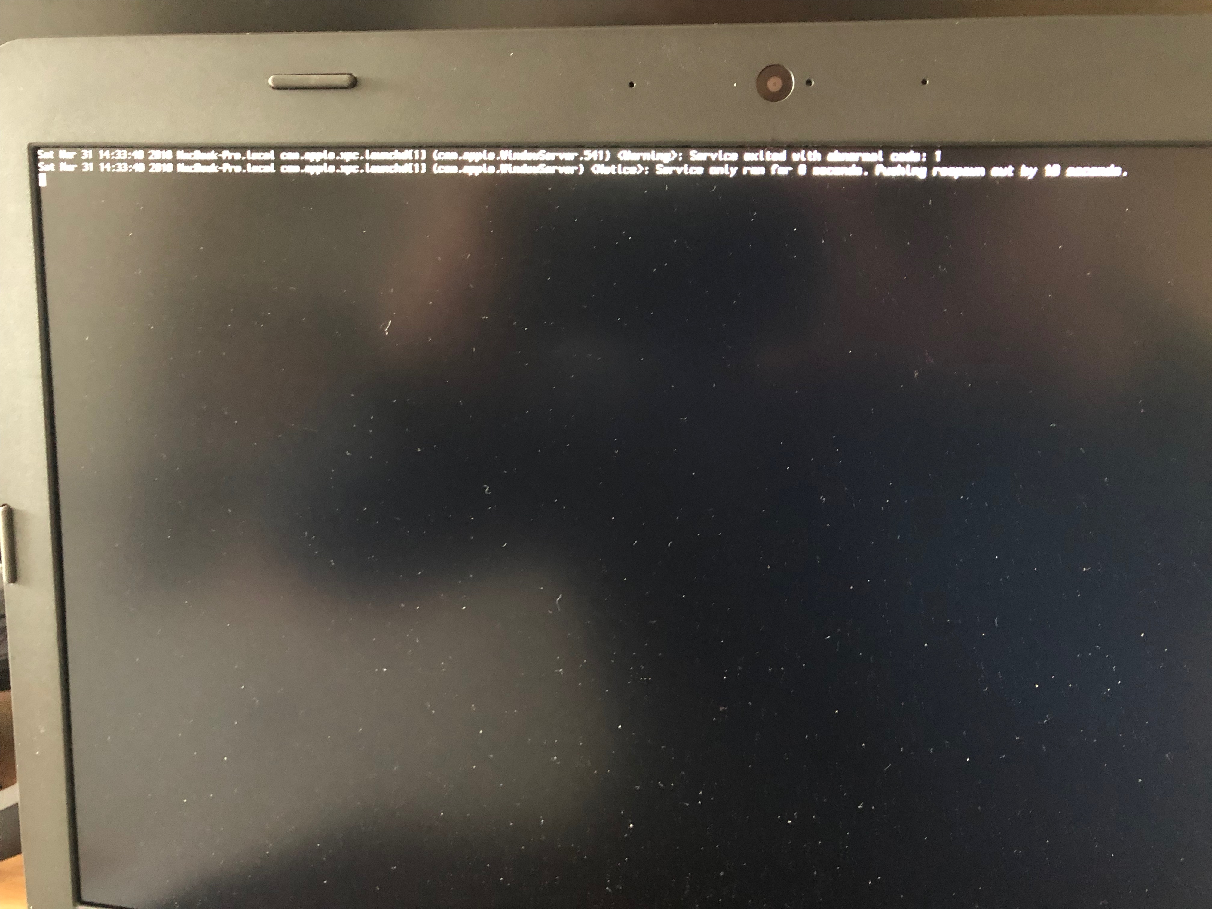

ITABRA Posted March 31, 2018 Author Share Posted March 31, 2018 allora con intelgraphicsfixup fa il restart con fake id 0x12345678 si blocca con questa schermata Link to comment https://www.insanelymac.com/forum/topic/333543-lenovo-e560-high-sierra-problemi-con-installazione/page/2/#findComment-2606698 Share on other sites More sharing options...
gengik84 Posted March 31, 2018 Share Posted March 31, 2018 Hai lasciato ssdt in EFI? Link to comment https://www.insanelymac.com/forum/topic/333543-lenovo-e560-high-sierra-problemi-con-installazione/page/2/#findComment-2606699 Share on other sites More sharing options...
ITABRA Posted March 31, 2018 Author Share Posted March 31, 2018 si SSDT-PS2K-T460 e SSDT-Disable_DGPU Link to comment https://www.insanelymac.com/forum/topic/333543-lenovo-e560-high-sierra-problemi-con-installazione/page/2/#findComment-2606700 Share on other sites More sharing options...
gengik84 Posted March 31, 2018 Share Posted March 31, 2018 Rimuovi dal config il rename GFX0 to IGPU riprova Link to comment https://www.insanelymac.com/forum/topic/333543-lenovo-e560-high-sierra-problemi-con-installazione/page/2/#findComment-2606703 Share on other sites More sharing options...
ITABRA Posted March 31, 2018 Author Share Posted March 31, 2018 esce lo stesso errore Link to comment https://www.insanelymac.com/forum/topic/333543-lenovo-e560-high-sierra-problemi-con-installazione/page/2/#findComment-2606708 Share on other sites More sharing options...
gengik84 Posted March 31, 2018 Share Posted March 31, 2018 prova a sostituire SSDT-Disable_DGPU.aml.zip Link to comment https://www.insanelymac.com/forum/topic/333543-lenovo-e560-high-sierra-problemi-con-installazione/page/2/#findComment-2606715 Share on other sites More sharing options...

gengik84 Posted April 2, 2018 Share Posted April 2, 2018 Normale.. Il problema è la video discreta Questa porta problemi su 10.13 Link to comment https://www.insanelymac.com/forum/topic/333543-lenovo-e560-high-sierra-problemi-con-installazione/page/2/#findComment-2607177 Share on other sites More sharing options...
ITABRA Posted April 3, 2018 Author Share Posted April 3, 2018 Ciao. ci sono novità sono riuscito ad installare High Sierra Finalmente selezionando nv-disable in Clover , purtroppo il dsdt patch mi blocca il boot la wifi funziona ma il bluetooth non viene riconosciuto nemmeno nelle porte usb anche l'audio non va e il kext della batteria mi da problemi grazie per il vostro aiuto Link to comment https://www.insanelymac.com/forum/topic/333543-lenovo-e560-high-sierra-problemi-con-installazione/page/2/#findComment-2607357 Share on other sites More sharing options...
