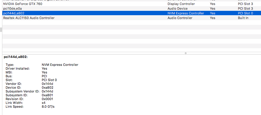

ergot Posted March 20, 2018 Share Posted March 20, 2018 Hello, in the picture my NVIDIA audio has strange naming, also the NVME controller (Should be Samsung) how can I change/edit that? 1 Link to comment Share on other sites More sharing options...

WaldMeister Posted March 20, 2018 Share Posted March 20, 2018 Does the device work as it should? Or is it more than just a cosmetic change? Link to comment Share on other sites More sharing options...

ergot Posted March 21, 2018 Author Share Posted March 21, 2018 20 hours ago, WaldMeister said: Does the device work as it should? Or is it more than just a cosmetic change? Device work fine however did not checked HDMI audio...maybe it is a cosmetic thing Link to comment Share on other sites More sharing options...

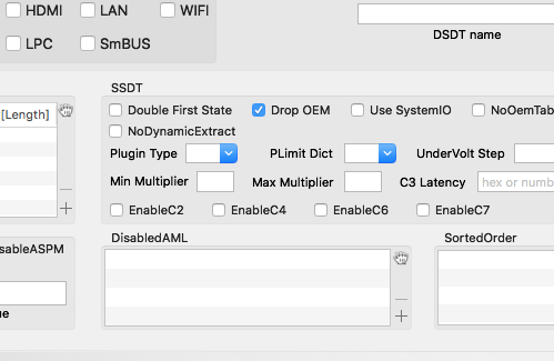

MaLd0n Posted March 21, 2018 Share Posted March 21, 2018 2 hours ago, ergot said: Hi Maldon, the uploader don't work for me so I upload file to dropbox https://www.dropbox.com/s/cv1t3lbqk9wuei7/Send me MacPro.zip?dl=0 thank you! by the way I posted long time ago regarding NVME orange icons can you also take a look at that? Thanks!!!! ergot.zip full patches in config plist for rename devices EVMR to PMCR 4556 4d52 504d 4352 GLAN to GIGE 474c 414e 4749 4745 ALZA to HDEF 414c 5a41 4844 4546 LPC0 to LPCB 4c50 4330 4c50 4342 SMBS to SBUS 534d 4253 5342 5553 XHCI to XHC 5848 4349 5848 435f SAT1 to SATA 5341 5431 5341 5441 HECI to IMEI 4845 4349 494d 4549 EVSS to SAT0 4556 5353 5341 5430 drop all oem and update ur clover bootloader 1 1 Link to comment Share on other sites More sharing options...
ergot Posted March 22, 2018 Author Share Posted March 22, 2018 10 hours ago, MaLd0n said: ergot.zip full patches in config plist for rename devices EVMR to PMCR 4556 4d52 504d 4352 GLAN to GIGE 474c 414e 4749 4745 ALZA to HDEF 414c 5a41 4844 4546 LPC0 to LPCB 4c50 4330 4c50 4342 SMBS to SBUS 534d 4253 5342 5553 XHCI to XHC 5848 4349 5848 435f SAT1 to SATA 5341 5431 5341 5441 HECI to IMEI 4845 4349 494d 4549 EVSS to SAT0 4556 5353 5341 5430 drop all oem and update ur clover bootloader THANK YOU MASTER!!!!!!!!!!!!!!!!!!!!!! Link to comment Share on other sites More sharing options...

ergot Posted March 26, 2018 Author Share Posted March 26, 2018 (edited) Hi Maldon, I think I finally found the issue, it was your modified DSDT for me, when I revert back to previous one I had no issues with video encoding with CUDA, long short story: So installing web drivers with CUDA (I know my GPU is native support how ever without web drivers CUDA is not enabled in programs such as AE Pr etc.) causing me many restarts when using load encoding / exporting or just tracking for example. when using Apple drivers no issues then I found out that your DSDT show that my GPU is in PCI slot 0 which is not true, my GPU physically is in slot 3, switching back DSDT I can see that the PCI slot number is correct...maybe when changing it to PCI 0 I had some miss match configuration from the web drivers...I don't know I'm not expert however it is working fine when the slot# is 3 right now. Now I just need to fix the orange NVME drive...could you tell me what specificlly I need to change in DSDT? PS, I have NVME drive on PCI slot 0 Thanks! Edited April 28, 2018 by ergot Link to comment Share on other sites More sharing options...
