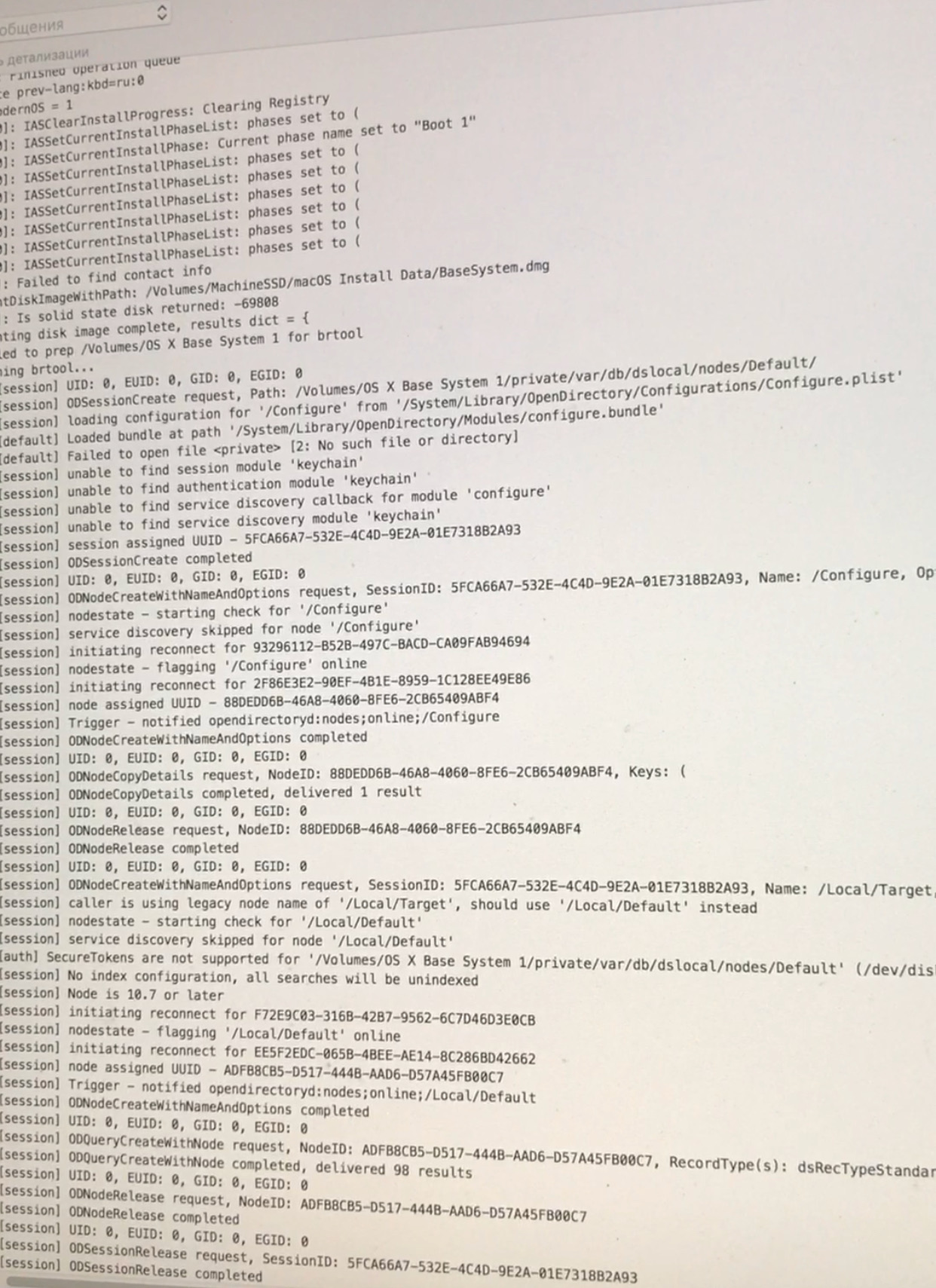

I'm trying to install 10.13.3 for iMacPro on SATA SSD. The motherboard is ASUS WS X299 PRO.
The installation process hangs when 'less than a minute left' is displayed on screen. The last messages I can see in the installation log are at the picture attached to this post.
If I then reset the system and boot what was installed I can continue the installation. Unfortunately, it stucks at the end again. Next, if I try to boot what was finally installed I can even get to working system. But I cannot install the updates because of the same hanging at the end!

Moving a bit further... The first stage of installation goes fine in Safe Mode (-x). Installation log indicates the same log message and after that it reboots immediately. Seems to be a normal behaviour. However, the second stage ("install macOS from <volume>") still hangs. Running the second stage in Safe Mode panics with "process 1 exec of /sbin/launchd failed".
SOLVED. It turned out that "hardware" NVRAM doesn't work with AptioMemoryFix on this motherboard. But works in Safe Mode. This is weird but it's true. Fallback to OsxAptioFixDrv2 + EmuVariableUEFIDrv solved my problem. Installation now finished just fine.
UPDATE. Turning off 'Above 4G decoding' BIOS option resolved the problem with NVRAM. Now I back to AptioMemoryFix.
