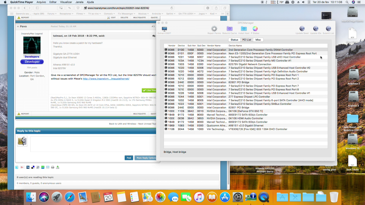

Pavo Posted February 20, 2018 Author Share Posted February 20, 2018 Hello you know create a patch for my hardware? Thankful. Gigabyte GA-Z77X-UD5H Gigabyte dual Ethernet Atheros AR8151 v2.0 Intel 82579V Give me a screenshot of DPCIManager for all the PCI List, but the Intel 82579V should work without issues with Mieze's http://www.insanelymac.com/forum/files/download/396-intelmausiethernet/ Link to comment Share on other sites More sharing options...
talmazi Posted February 20, 2018 Share Posted February 20, 2018 Ai being. Link to comment Share on other sites More sharing options...
Pavo Posted February 21, 2018 Author Share Posted February 21, 2018 Ai being. There is no native kexts for either of these devices, I would suggest using Mieze's http://www.insanelym...lmausiethernet/ to at least get the Intel 82579V working. See mixed results for the Atheros AR8151 v2.0 Link to comment Share on other sites More sharing options...

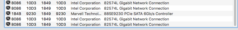

e97 Posted May 23, 2018 Share Posted May 23, 2018 (edited) Hi @Pavo, Thanks for this info! My motherboard has 4 Intel 82574L NICs, DPCIManager screenshot: Do I need a SSDT for each interface? When the Intel 82754L Ethernet is heavily loaded (~10k packets/s) [OS X 10.11.6] I'm seeing this flood the console. kernel[0]: 0x<ptr>, 0x<ptr> Intel82574L::outputStart - NoResources from txFrame - pkt tossed kernel[0]: 0x<ptr>, 0x<ptr> Intel82574L::outputStart - NoResources from txFrame - pkt tossed kernel[0]: 0x<ptr>, 0x<ptr> Intel82574L::outputStart - NoResources from txFrame - pkt tossed Hoping this will fix the issue. Will report back after giving this a try. Edited May 23, 2018 by e97 Link to comment Share on other sites More sharing options...
