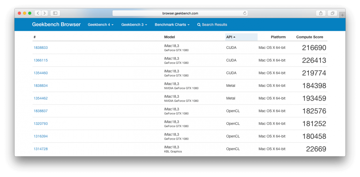

GeekBench scores
Single-core / Multi-core 7,153 / 33,395 (all-time high: 34,110)
GTX1080 w/ UHD630
OpenCL 182,576
Metal 193,459
CUDA 226,413

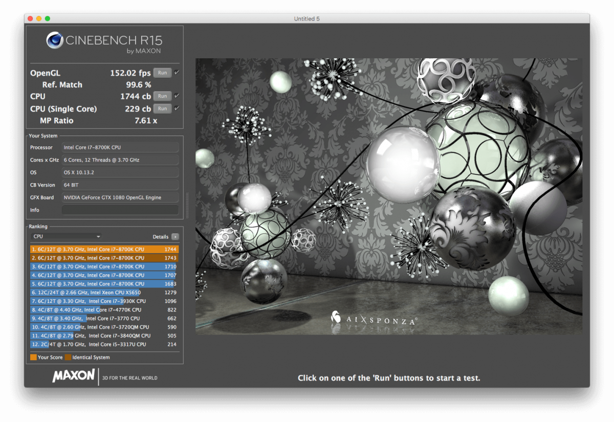

Cinebench R15
160 fps / 1,744 cb / 229 cb

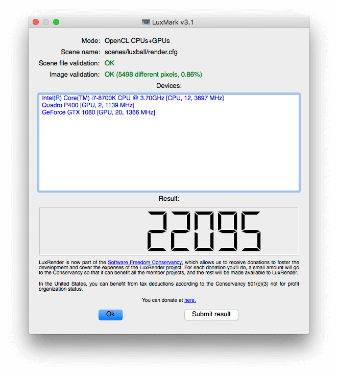

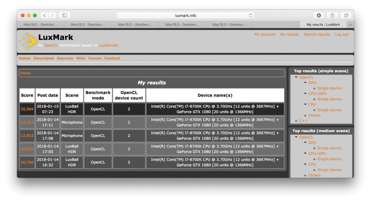

LuxBall (default compiler settings)
20,935

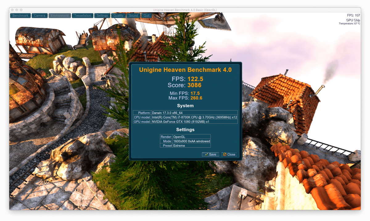

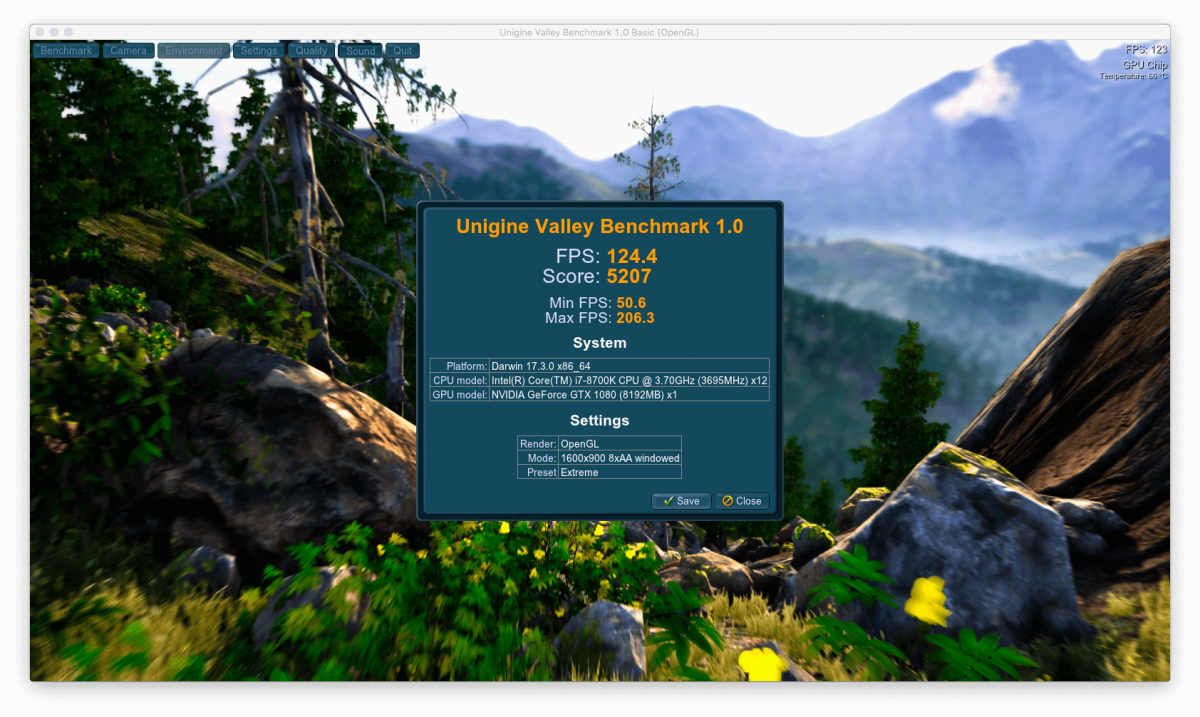

Heaven / Valley
post-2298827-0-85625100-1516929198_thumb.pngpost-2298827-0-57975400-1516928960_thumb.png

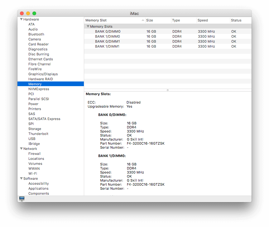

  3. G.Skill TridentZ 4x 16GB DDR4 CL16 — F4-3200C16D-32GTZSK, https://www.newegg.com/Product/Product.aspx?Item=N82E16820232415, $479.99 (total), O.C. at 3300

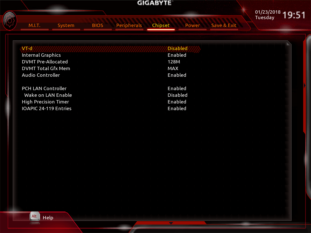

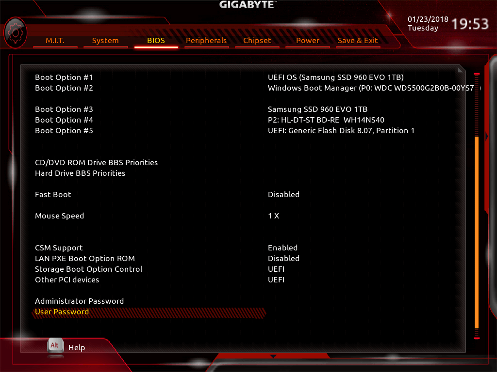

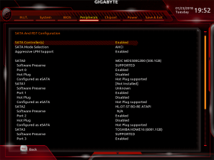

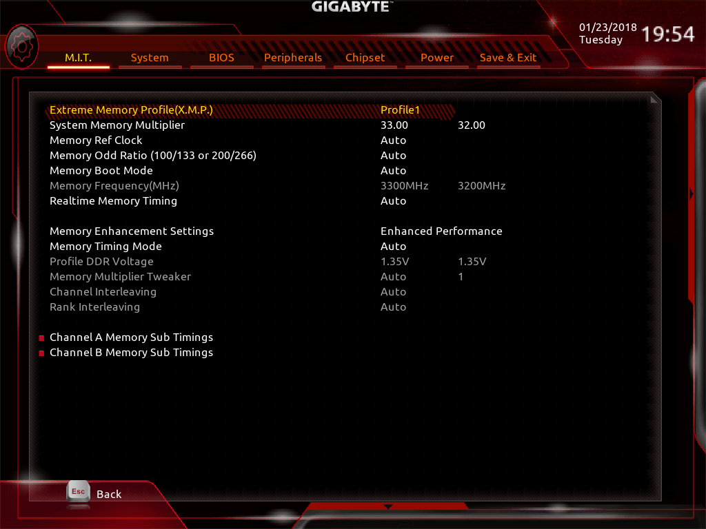

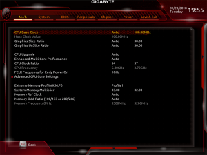

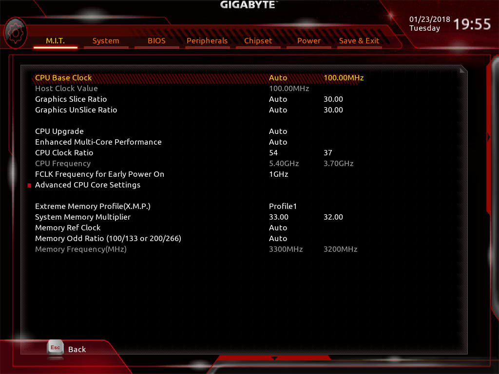

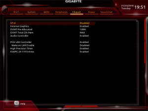

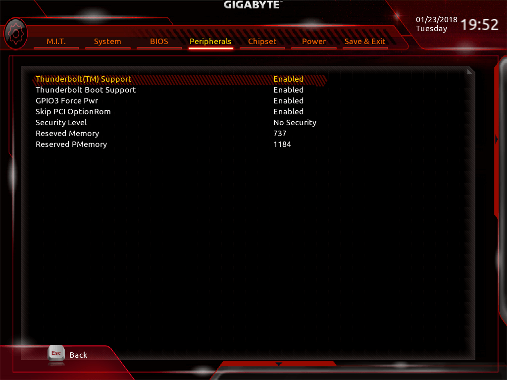

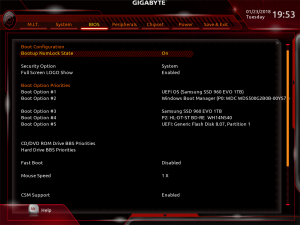

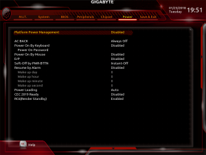

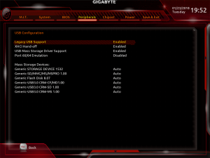

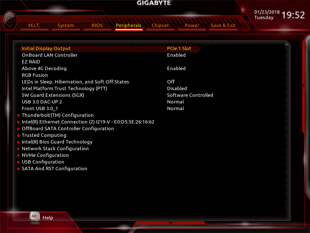

BIOS Settings
cf. screenshots; I have deliberately not included full O.C. settings; for the record, this is not something that I encourage and I am therefore not responsible in any way, shape, or form for any bad outcomes you may experience. Just sayin’…
post-2298827-0-76495700-1516928709_thumb.pngpost-2298827-0-05839800-1516928721_thumb.pngpost-2298827-0-19531200-1516928727_thumb.pngpost-2298827-0-44312100-1516928737_thumb.pngpost-2298827-0-29118900-1516928750_thumb.pngpost-2298827-0-63950200-1516928758_thumb.pngpost-2298827-0-58098700-1516928770_thumb.pngpost-2298827-0-16181300-1516928779_thumb.pngpost-2298827-0-85216300-1516928793_thumb.pngpost-2298827-0-44574900-1516928802_thumb.png

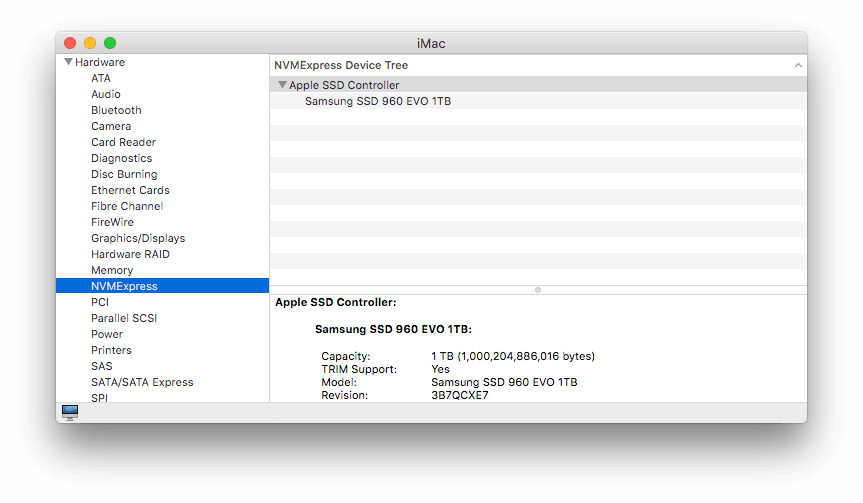

Drives - Boot
  1. Samsung 960 EVO NVMe M.2 PCIe 1TB — MZ-V6E1T0BW, https://www.newegg.com/Product/Product.aspx?Item=N82E16820147595, $399.99, boot with MacOS, top M.2 slot under thermal shield

  • Thunderbolt: boot into Windows and connect a Thunderbolt device; I used an OWC TB 2 dock. When recognized, reboot into Mac OS X; I used a G-Drive TB 2 drive for that, as the OWC didn’t show up. Once the G-Drive showed up, I was able to hot-add the dock. No issues since (aside from using the internal USB 3.1 Gen 2 header, which led to a big mess; see next item). Note that if you disconnect the computer from power, you will have to boot into Windows again and connect a Thunderbolt device again prior to booting into Mac OS X.

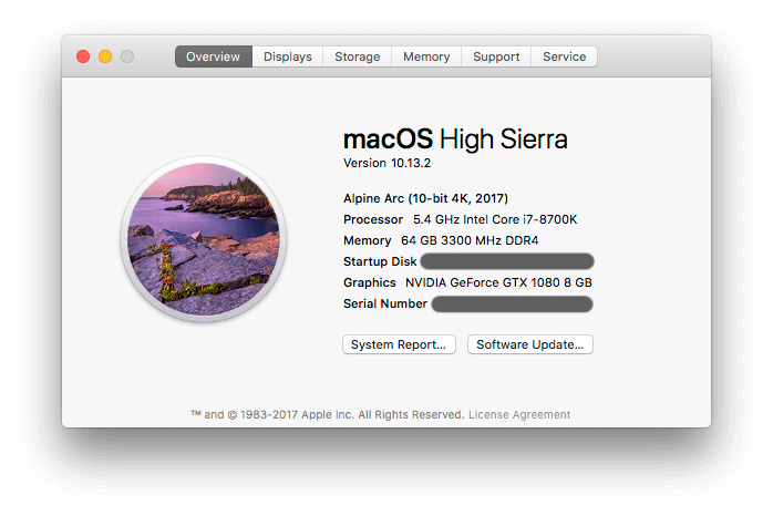

MacOS 10.13.2 [17C205] “High Sierra” — all Mac drives are Journaled Extended MacOS (JHFS+); no APFS. [uPDATE: now on 10.13.3 [17D47; see below about issues]

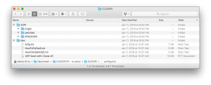

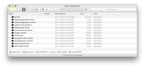

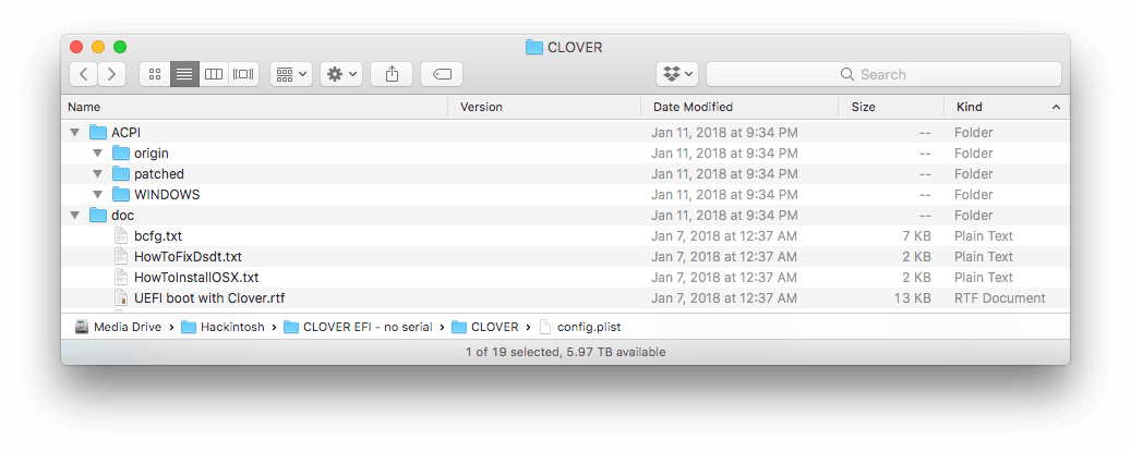

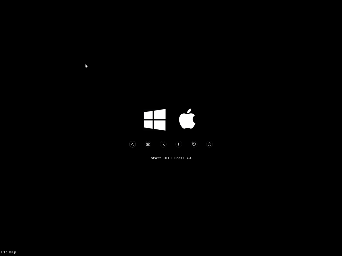

Clover
Clover Bootloader 2.4 4269 [uPDATE: now 4380 and OsxAptioFix3Drv]
Clover Configurator 4.60.0.0

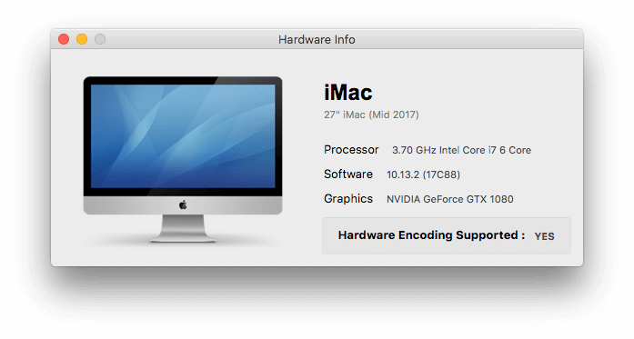

Running as: iMac 18,3
EFI attached (sans Serial #)
To get TB running without boot process freezing, I had to add:
Remove EmuVariableUefi
Connect only one screen (add all you want later)
Acpi: FixRegions: True
Boot: slide=0 [KSLR disabled]
Manual addition of kexts to 'other' folder.
post-2298827-0-24851200-1516928677_thumb.pngpost-2298827-0-86246200-1516928877_thumb.pngpost-2298827-0-05543600-1516928986_thumb.png

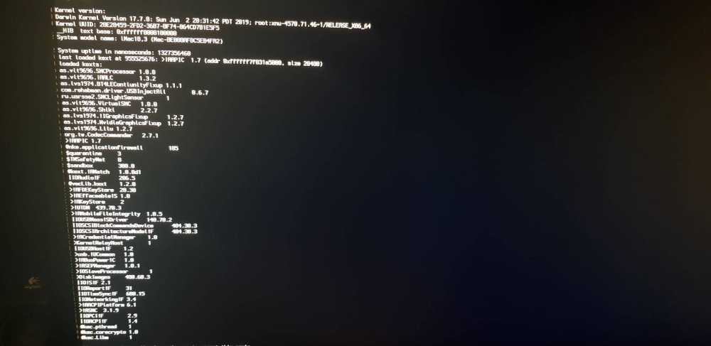

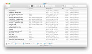

Kexts (all in EFI/Clover/kexts/Other) [uPDATE: Since then running all latest versions; will not not be updating this list]
AppleALC.kext 1.2.2

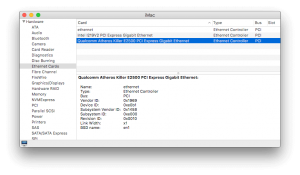

AtherosE2200Ethernet.kext 2.2.2
CodecCommander.kext 2.6.3
FakeSMC_ACPISensors.kext 6.26-322-g1b20eab7.1765
FakeSMC_CPUSensors.kext 6.26-322-g1b20eab7.1765
FakeSMC_GPUSensors.kext 6.26-322-g1b20eab7.1765
FakeSMC_LPCSensors.kext 6.26-322-g1b20eab7.1765
FakeSMC.kext 6.26-322-g1b20eab7.1765
IntelGraphicsFixup.kext 1.2.1
IntelMausiEthernet.kext 2.3.0
Lilu.kext 1.2.1
NvidiaGraphicsFixup.kext 1.2.1
RealtekRTL8111.kext 2.2.1
Shiki.kext 2.2.0
USBInjectAll.kext 0.6.2
XHCI-200-series-injector.kext 0.5.0

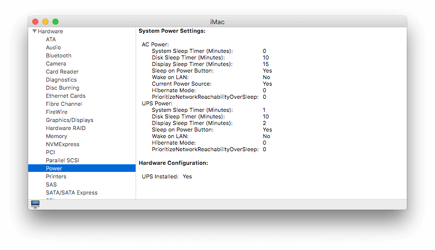

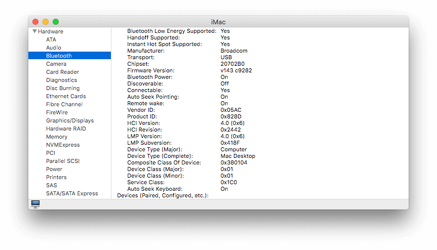

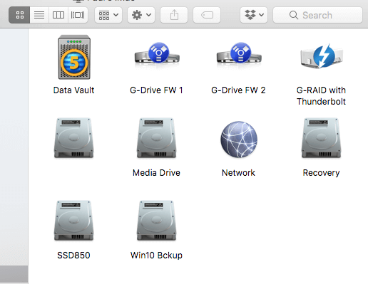

Works
  1. WiFi

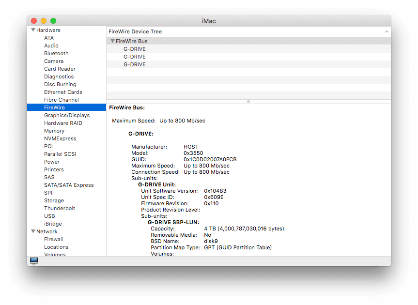

  2. Bluetooth (with Apple keyboard and MagicTrack Pad 2; see note below)
  3. Logitech Anywere MX mouse (with receiver)
  4. UHD630 Acceleration (see image)

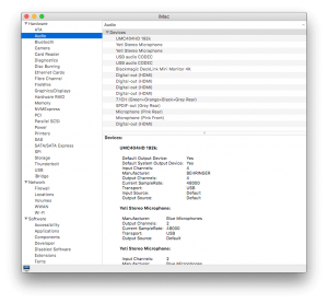

  5. Audio (back panel and front panel)
  6. USB 3.0; tested with BlackMagic Disk Speed Test and Samsung Portable T3 SSD 1TB
  7. iMessage
  8. iCloud
  9. FaceTime
  10. Continuity / Handoff
  11. AppStore
  12. Universal Copy/Paste
  13. Eject key with DVD reader
  14. Thunderbolt
  15. Dual Boot

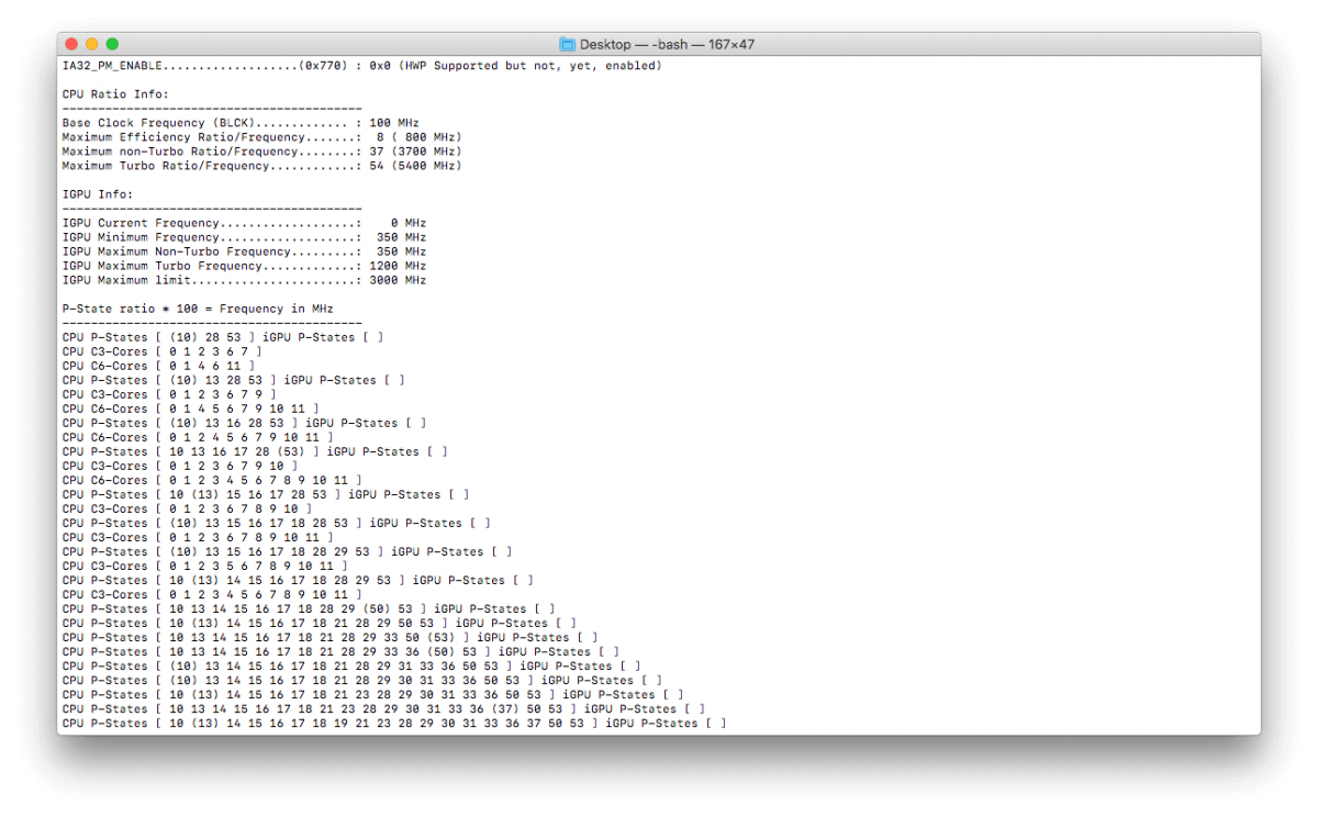

  16. Power Management
  17. UPS (mine is a CyberPower)
post-2298827-0-27366300-1516928813_thumb.pngpost-2298827-0-87318500-1516928694_thumb.pngpost-2298827-0-17150100-1516928686_thumb.pngpost-2298827-0-28058400-1516928888_thumb.pngpost-2298827-0-21194800-1516928900_thumb.pngpost-2298827-0-02322800-1516928914_thumb.pngpost-2298827-0-53319300-1516928836_thumb.pngpost-2298827-0-38554600-1516928950_thumb.pngpost-2298827-0-45604200-1516929180_thumb.pngpost-2298827-0-17257100-1516929172_thumb.pngpost-2298827-0-13417300-1516929161_thumb.pngpost-2298827-0-17310000-1516929111_thumb.pngpost-2298827-0-23209600-1516929125_thumb.pngpost-2298827-0-88430200-1516929153_thumb.png

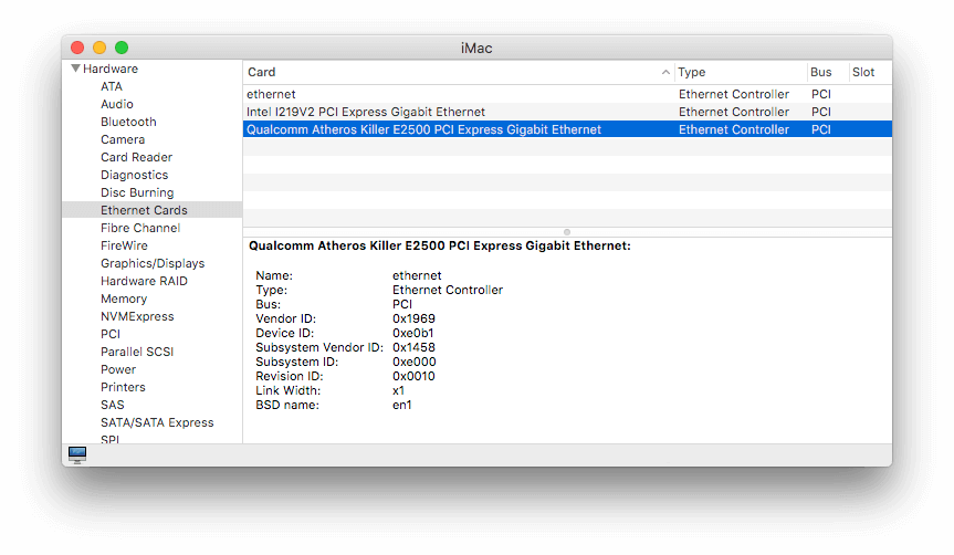

Not Working

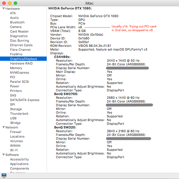

  1. Overclocking on EVGA 1080 FTW 2; see note below.
  2. Cannot get a signal on the iGPU connectors (in ig-platform 0x5912000 config); ghost monitor appears in Displays and monitor turns out, but remains dark. Currently running with ig-plaftform 0x5912003.
  3. PCI boards shows as pci8xxx in Profiler; no names. Don’t think GPU shows either.
  4. Thunderbolt does not appear in profile.
  5. 10-bit display; perhaps need Vega FE for that. [uPDATE: added a Quadro P400; all good now with OpenGL display]
Jury Still Out
  1. Sleep / Hibernate; the System Preferences : Energy panel is rather minimalistic. For example, Power Nap doesn’t show up. [update: was told that that might be because I am connected via Wi-Fi and not RJ45; either way, I don't need it and set Darkwake=no]

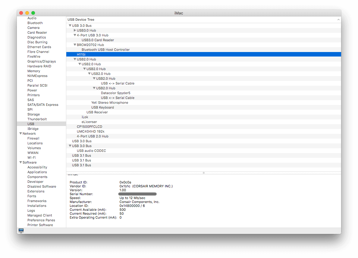

  2. USB ports; still have to map out unused out; my Anker USB hub shows as a 2.0, but I thought it was a 3.0. Need to investigate that further. [update: hub works fine; what I was seeing was—correctly—a USB 2.0 device plugged into it; 3.0 devices work as they should.]
  3. Booting with all 3 monitors on sometimes causes the 1080 to flicker and then hang. If I boot with two of them and then turn on the SW320 after login (I can leave it connected though), all is fine.

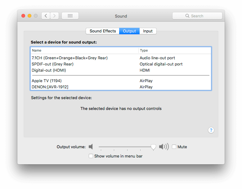

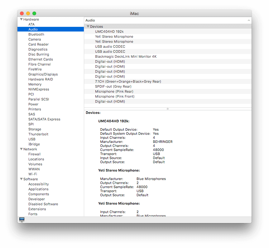

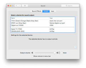

Hi. I am currently building a Hackintosh with the same processor and motherboard.
Everything is working fine and still needs adjustments, except for the sound.
I have noticed that you have on one list a VoodooHDA.kext (on the screenshot), but not on your final textual list of kexts ... What is the status ?
I only installed the RealtekRTL8111.kext version 2.2.1 and after trying all the possible injection code 11, 1, 2, 5, 7, I came up only with stereo sound. I would like to get the 5.1 output on the rear motherboard jacks but cannot get it. I have seen on your screenshot that you did get 7.1 output. How did you did it ?
All I've seen in the details of my installation is only stereo sound across all type of output including digital optical.
I have the 5.1 speakers from Logitec and they don't take optical sound in.
Do you have some insight to share on how you got the 7.1 output from the motherboard ? Is it related to the voodoo  kext ?
Thanks for your possible help.
Yes, I installed Voodoo HDA following Glasgood's guide (pinned in forums), rebooted, and the ports appeared. I have not physically hooked up that setup, so I cannot guarantee that 7.1 actually would output 7.1. All I can say is that I now see the ports.

On 5/10/2018 at 11:57 AM, Carungaua said:
- Can't use my external HDDs from e-sata card. I put in the PCIe 1x lane 1 as you said and tried different slots. no success.
One issue I had is that I had to leave the bottom 1x slot empty, as it shares the bandwidth with SATA internal connectors (disables 0 or 1, don't remember exactly). The TB slot (bottom) also shares lanes with M.2 connector, so you cannot put anything in the bottom M.2 slot.
- the fenvi wi-fi/BT doesn't works too. But I tested it in another hack with sierra and doesn't works there too. I think it's a faulty card.
I have moved to an OSX Wifi card, as I was having lag issues. Turned out that my Fenvi was indeed fine, but interference with BT came from USB drives. (if you search forums, you will find it). I moved the external drives and things are better. No issues with WiFi side on either card.
- my back panel audio is not working. I have audio in the front panel, but it's not a major issue because my main audio output is through balckmagic (when I put the thunderbolt to work...)
I used Voodoo HDA. Some say it isn't required, but I don't see the ports without it. Note that I don't have a 5.1 system, so I haven't been able to check every connector, but most work and show up in the sound menu. My main audio, however, is a Behringer UDC404 USB interface.
I really appreciate any help!
Thanks in advance
For future reference, you might want to consider blacking out your serial number. :)

Hi, thanks for your answer.
Actually the problem with the sata card was just a matter of jumpers! I was trying to use the external esata ports so I just changed the jumpers in the board and everything works fine now. my mistake, sorry.

Hello, i have Aorus Gaming 3 and Titan Ridge. I cannot enter Osx with TR plugged in. Any suggestions?
I followed this guide by the book. I have a custom DSDT.
Card works fine in windows but no matter what i always get the same error when trying to boot osx.
High Sierra 10.13.6
Here is my CLOVER folder.....
CLOVER.zip
