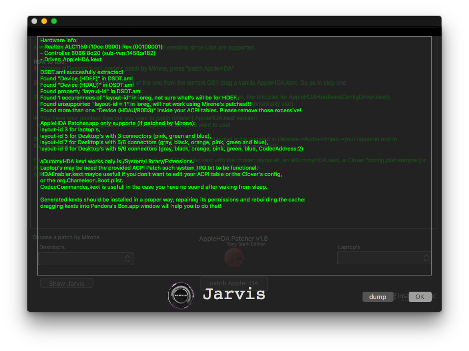

MaLd0n Posted January 21, 2018 Share Posted January 21, 2018 let's try a native audio download it http://www.insanelymac.com/forum/files/file/496-applehda-patcher/ open and send me one screenshot, go to Show Jarvis Native PM Run it in terminal and paste here kextstat | grep AppleIntel Link to comment Share on other sites More sharing options...
PPCnostalgic Posted January 21, 2018 Author Share Posted January 21, 2018 Ok, see attachment MironeAudio.zip 1 Link to comment Share on other sites More sharing options...
MaLd0n Posted January 21, 2018 Share Posted January 21, 2018 Pm work, two necessary kexts is load audio codec dont appears, DPCIManager dont apperas? here DPCIManager.app.zip Link to comment Share on other sites More sharing options...
