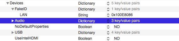

heptas Posted December 30, 2017 Share Posted December 30, 2017 Olá a todos. fiz o Upgrade do Sierra para o HS e estou com quase tudo ok. Já tentei muitas coisas para fazer a LAN funcionar e nada. no Sierra funcionava de Boa com a Kext AtherosL1cEthernet.kext em EFI/CLOVER/KEXT/OTHER Ja tentei: AtherosL1cEthernetSierra.kext AtherosE2200Ethernet.kext ALXEthernet.kext (essa da pal e nem boota) ja tentei por o device id em fake lan , já tentei outro device id Estou mandando o config.plist e IOREG (com e sem DSDT ) e DSDT.aml estou no 10.13.1 Quem tiver alguma sugestão eu agradeço. abraço e feliz 2018 EFI.zip 1 Link to comment https://www.insanelymac.com/forum/topic/331103-atheros-ar8151-alienware-m17x-r4/ Share on other sites More sharing options...

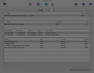

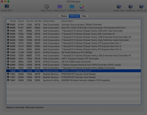

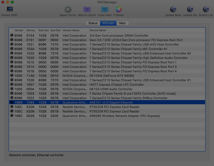

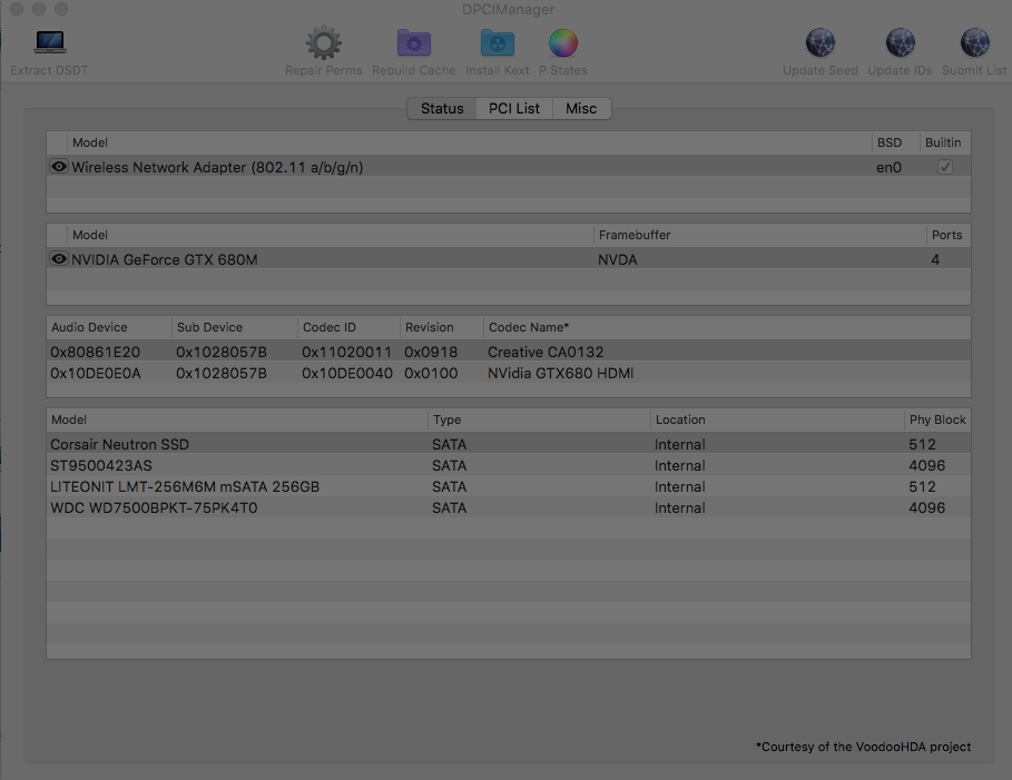

enryson Posted February 12, 2018 Share Posted February 12, 2018 Ola tenho o mesmo problema meu wifi funciona sem problema, mas a AR8151 V1969 D1083 nao vai! Quero fazer ela funcionar pq com o wifi so pego 41mb ja no cabo eu pegaria os 70mb da internet. Tentei ALXEthernet, AtherosE2200Ethernet, AtherosL1cEthernet. e nada... nenhuma mostra no IOREG. tenho apenas wifi.nao sei se o problema ta no DSDT..caso alguem possa ajudar. m17xr4.zip 1 Link to comment https://www.insanelymac.com/forum/topic/331103-atheros-ar8151-alienware-m17x-r4/#findComment-2590261 Share on other sites More sharing options...

enryson Posted February 12, 2018 Share Posted February 12, 2018 usa o dpcimanager e confere DPCIManager.app.zip Nada... so wifi.. Link to comment https://www.insanelymac.com/forum/topic/331103-atheros-ar8151-alienware-m17x-r4/#findComment-2590273 Share on other sites More sharing options...
MaLd0n Posted February 12, 2018 Share Posted February 12, 2018 é na aba PCI List, confere lá Link to comment https://www.insanelymac.com/forum/topic/331103-atheros-ar8151-alienware-m17x-r4/#findComment-2590274 Share on other sites More sharing options...
enryson Posted February 12, 2018 Share Posted February 12, 2018 é na aba PCI List, confere lá Link to comment https://www.insanelymac.com/forum/topic/331103-atheros-ar8151-alienware-m17x-r4/#findComment-2590276 Share on other sites More sharing options...

artur_pt Posted March 31, 2018 Share Posted March 31, 2018 olá estes são os que estão na kext de atheros2200 0x10901969 0x10911969 0x10A01969 0x10A11969 0xE0911969 0xE0A11969 0xE0B11969 podes tentar com clover fake id da lan bom hack Link to comment https://www.insanelymac.com/forum/topic/331103-atheros-ar8151-alienware-m17x-r4/#findComment-2606623 Share on other sites More sharing options...

heptas Posted March 31, 2018 Author Share Posted March 31, 2018 já tentei com fake id, apenas uma correção. a placa de rede não é AR8151, mas sim AR8162. não sei de onde eu tirei esse AR8151. o id que passei, 1090 é o ID correto mesmo. Vendor : 1969 Device :1090 SubVen:1028 Vendor Name: Qualcomm Atheros Link to comment https://www.insanelymac.com/forum/topic/331103-atheros-ar8151-alienware-m17x-r4/#findComment-2606782 Share on other sites More sharing options...
