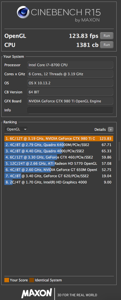

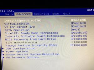

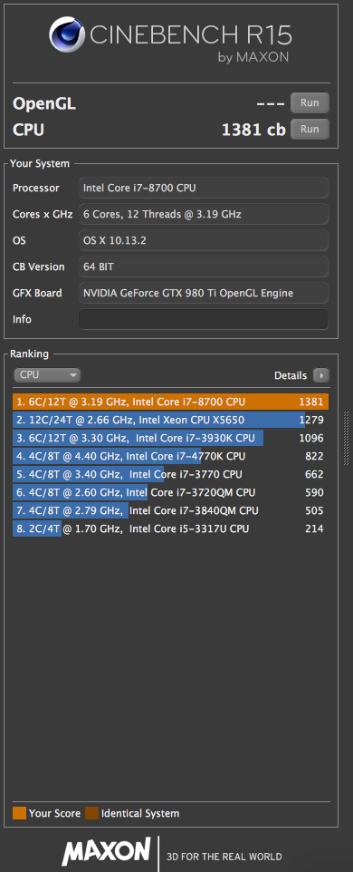

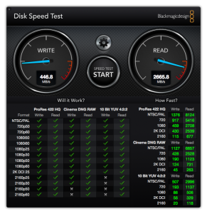

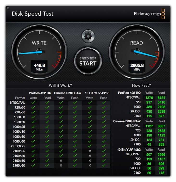

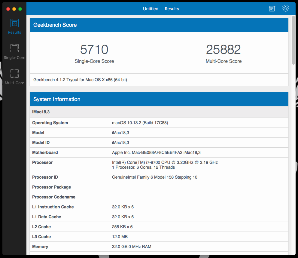

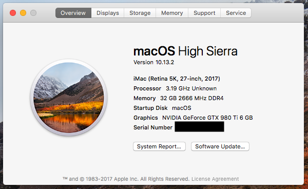

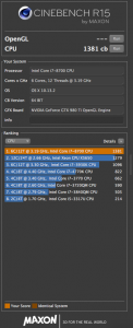

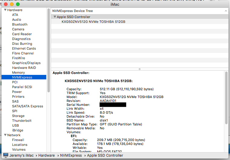

slave-zeo Posted December 16, 2017 Share Posted December 16, 2017 Overall status: WORKING WELL Hello again, True Believers! On today's episode of Spider-man and His Amazing Friends we'll be looking at the Dell XPS 8930 tower system. Lets start off by looking at a detailed list of the 8930's hardware, Intel® Core i7-8700 CPU @ 3.20GHz, 3192 Mhz, 6 Core(s), 12 Logical Processor(s), Coffee Lake 32GB DDR4 2666MHz RAM (2x16GB sticks @ 2133MHz, aftermarket) NVIDIA GeForce GTX 980 Ti, Graphics card #1 (aftermarket) Intel® UHD Graphics 630, Graphics card #2 (cannot disable in UEFI BIOS) Realtek Audio (not sure what chip yet) KXG50ZNV512G NVMe TOSHIBA 512GB WDC WD30EFRX-68EUZN0 (3TB hard drive, aftermarket) PLDS DVD+-RW DU-8A5LH, Optical drive Killer E2400 Gigabit Ethernet Controller Qualcomm QCA9377 802.11ac Wireless Adapter ASMedia USB 3.1 eXtensible Host Controlle Intel® USB 3.0 eXtensible Host Controller The UEFI BIOS has tons of options that need to be disabled. This is the main UEFI BIOS screen. Nothing to change here, except maybe the date. The Advanced tab. Make sure to switch RAID to AHCI or your disk will not show up. Everything else should be set as in the picture. Next up is the Security tab. Make the changes to match the picture. I'm not sure if this is needed but I went into the Secure Boot option and selected "Delete All Secure Boot Variables", see picture below. Secure boot options. As stated above I deleted the variables. Finally the Boot tab. Just set as in the picture. Never mind the "Windows Boot Manager". I ended up deleting the entry via the "File Browser Del Boot Option" and added Clover via the "File Browser Add Boot Option". GREAT SCOTT! This had to be the easiest install of a Hackintosh ever. Basically I made an install USB stick and put FakeSMC.kext and AtherosE2200Ethernet.kext in the EFI/CLOVER/kexts/other folder. No other kexts were needed. I booted off the USB stick, installed macOS and I was done with the OS portion. After installation I rebooted the computer and then booted from the USB stick. I chose the freshly installed drive and it booted to the setup portion of the installation. After setup it was onward to the desktop. I'll not bore you with the specifics of fully setting up a bootable macOS install, but after all was said and done it was smooth sailing. Post install was basically installing VooDooHDA and the nVidia web drivers. Ethernet was taken care of via the AtherosE2200Ethernet kext. USB and Bluetooth worked without any extra effort. As far as I can tell the only thing NOT WORKING is the WiFi. I Googled a bit but nothing turned up for the Qualcomm QCA9377. I keep on the look out for a kext though. The CPU shows up as unknown, but everything else seems to be in order. The CPU's speedstep works as intended. I monitored it via the Intel® Power Gadget for a good bit and it was scaling fine. The NVMExpress ssd looks to be detected and set up properly. I really didn't expect it to be. A very pleasant surprise. Geekbench 4 scores. Not sure if it's good or bad. Take with a grain of salt. Here are the Cinebench results. Again, I'm not sure if these are good or bad. This test seems a bit dated considering the comparative results of the other hardware. People seem to still use it, though, so here it is. This is supposed to mean something about disk speed. I'm still not sure if it's good or not. Enjoy, if you're into this sort of thing. Here is my EFI folder for the Dell XPS 8930, Google Drive Link Here are the Post Installation tools I used for this install, Google Drive Link I have more information to share. I'll get back to this later on. 2 Link to comment https://www.insanelymac.com/forum/topic/330706-dell-xps-8930-resource-extravaganza/ Share on other sites More sharing options...
PPCnostalgic Posted December 16, 2017 Share Posted December 16, 2017 When I saw your GB4 scoring and your advice "Take with a grain of salt" I just gulped and said uh!?!?..... what a powerful machine bro, great job! 1 Link to comment https://www.insanelymac.com/forum/topic/330706-dell-xps-8930-resource-extravaganza/#findComment-2551648 Share on other sites More sharing options...

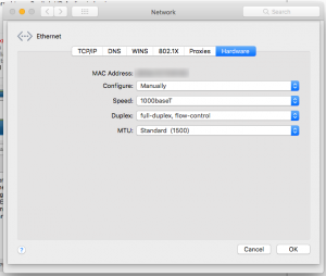

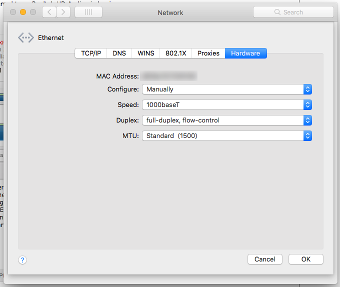

slave-zeo Posted January 27, 2018 Author Share Posted January 27, 2018 I ran into one problem which I just fixed last night after a few weeks of giving me fits. My Qualcomm ethernet chip would lose connection for a fraction of a second and then reconnect right back. This caused all kinds of lag problems for online gaming (World of Warcraft mainly). The way I fixed it was to go into the System Preferences > Network > select Ethernet from the lefthand side > click Advanced > and finally under the Hardware tab change Configuration to Manually and then Duplex to full-duplex, flow-control. I really think it was the energy-efficient-ethernet part under Duplex causing the problem. Regardless, no problems with disconnections now! Link to comment https://www.insanelymac.com/forum/topic/330706-dell-xps-8930-resource-extravaganza/#findComment-2577757 Share on other sites More sharing options...

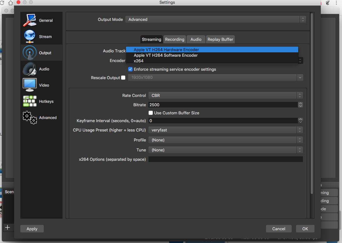

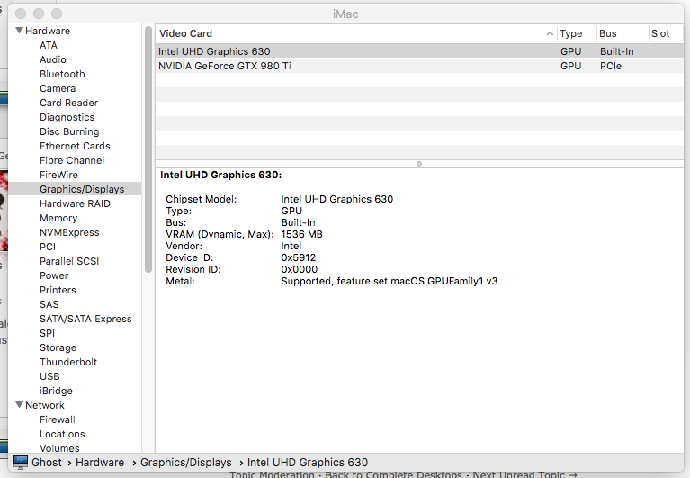

slave-zeo Posted February 11, 2018 Author Share Posted February 11, 2018 I'm diligently working toward getting the Intel UHD 630 graphics working. I've made progress but ultimately still failing. The GPU is showing up in System Information properly (See image below). But will not display anything on the attached monitor. The monitor is initialized at boot time as it powers on from it's sleep state, but no useable output. The Apple VT H264 encoder also seems to be available with both hardware and software options. Below is showing the OBS output options. I've tried all manner of kext's and device id's and pretty much anything I could find to make it work. I'm still looking and testing. I'll update as I experiment. Link to comment https://www.insanelymac.com/forum/topic/330706-dell-xps-8930-resource-extravaganza/#findComment-2589530 Share on other sites More sharing options...
Louviendevias Posted February 15, 2018 Share Posted February 15, 2018 I'm diligently working toward getting the Intel UHD 630 graphics working. I've made progress but ultimately still failing. The GPU is showing up in System Information properly (See image below). But will not display anything on the attached monitor. The monitor is initialized at boot time as it powers on from it's sleep state, but no useable output. Screen Shot 2018-02-11 at 6.37.49 AM.png The Apple VT H264 encoder also seems to be available with both hardware and software options. Below is showing the OBS output options. Screen Shot 2018-02-11 at 6.38.42 AM.png I've tried all manner of kext's and device id's and pretty much anything I could find to make it work. I'm still looking and testing. I'll update as I experiment. I fixed my graphics problem following this guide. See post #470. Hope it fixes the lag for you. Link to comment https://www.insanelymac.com/forum/topic/330706-dell-xps-8930-resource-extravaganza/#findComment-2592673 Share on other sites More sharing options...
