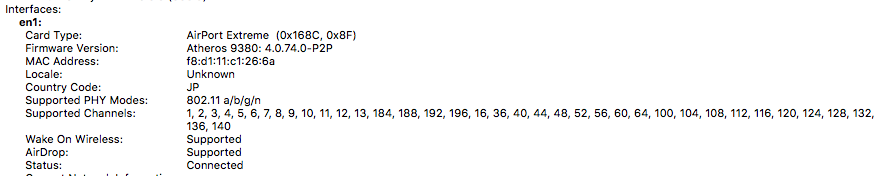

SavageAUS Posted November 30, 2017 Share Posted November 30, 2017 I have the TP-Link TL-WDN4800 in my hack but as seen below it does not detect where i am. Is there a way to correct this for my location? (South Australia) I have this patch which stops the spamming of unknown locale but obviously doesn't correct the locale. <dict> <key>Comment</key> <string>Atheros Locale Fix</string> <key>Disabled</key> <false/> <key>Find</key> <data> g/s3 </data> <key>Name</key> <string>AirPortAtheros40</string> <key>Replace</key> <data> g/sh </data> </dict> Link to comment https://www.insanelymac.com/forum/topic/330139-tp-link-tl-wdn4800-set-locale/ Share on other sites More sharing options...
