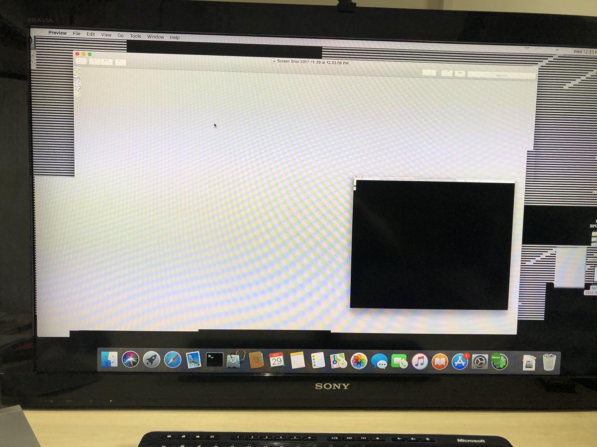

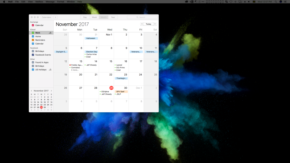

RSN Posted November 29, 2017 Share Posted November 29, 2017 Hi Y'all. I have a weird problem with the upgrade of Sierra to HS but ONLY( ) with the video card, Asus GT620. The install itself had a problem which got stuck but was solved by a patch the the AppleAHCIPort (found in the config.plist) that was another post , but it finally booted and the install went well. Its the same Hackintosh in a different SSD(same size/model), hence EVERYTHING is the same in terms of Hardware. In Sierra the 2 graphics cards work perfectly with all 4 screens(attached 2 of the 4 screens in Sierra). Needs the NVCAP in order for all 4 screens to work. (config.plist) In HS they do not work at all, image attached(gt620.png), does recognize (or tries to) all 4 screens, but rendering is useless, garbled, and flickering permanently. I have tried a lot of combinations of kexts, configs, drivers64 and drivers64 UEFI removing components to no avail. I mean a lot. Every NVIDIA kext, Nvidia web drivers, Cuda drivers, injects kexts the whole nine yards. No result. Same results for a APFS and non-APFS install. As I said, same Hackintosh, no hardware changes. Actually Im writing on the Sierra SSD and all works fine. Anybody any idea? Thanks in advance. Config.plist of HSierra attached Specs: MoBo: Intel Dx79T0 CPU: Intel i7-3820 RAM: 32GB SSD: 3-120GB and 500GB Kingston Graphics: 2 GT620 4 screens. Ethernet: IntelE1000 Wifi: Atheros40 Sound: VodooHDA OSX: Install macOS High Sierra.app (October 16, 2017 at 7:41 PM) downloaded Sunday Nov 19 confighs.plist.zip Link to comment https://www.insanelymac.com/forum/topic/330119-glitches-and-flickering-screens-update-from-sierra-10126-to-10131/ Share on other sites More sharing options...
