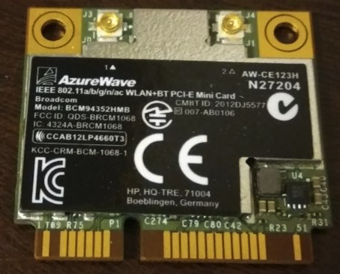

garti Posted November 5, 2017 Share Posted November 5, 2017 Mine BCM94352HMB . WIfi is Working fine. Only BT is causing me headaches. As I used to have both Wifi and BT fully working in 10.12.x. In 10.13.x BT sucks even if it is up. Scan is erratic detecting devices randomly but I cannot pair. Wifi is Fine with H Sierra. I am using Asus Vivo PC VM 60 i5 3337U recognized as Mac Mini (late 2012). I always have to use the patch below to have BT detected and UP. AirPortBrcm4360 - fcvo 81f952aa 00007529 81f952aa 00006690 with clover + BrcmFirmwareRepo and BrcmPatchRAM2 I gave up on bluetooth. Link to comment https://www.insanelymac.com/forum/topic/329300-wifi-card-bcm94352hmb-not-detected-high-sierra/page/2/#findComment-2529592 Share on other sites More sharing options...

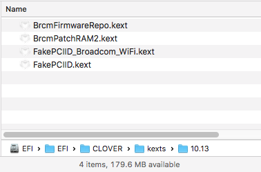

MARZILLO Posted November 5, 2017 Share Posted November 5, 2017 no good in efi BrcmPatchRAM2 with BrcmFirmwareData.kext Link to comment https://www.insanelymac.com/forum/topic/329300-wifi-card-bcm94352hmb-not-detected-high-sierra/page/2/#findComment-2529611 Share on other sites More sharing options...
garti Posted November 5, 2017 Share Posted November 5, 2017 no good in efi BrcmPatchRAM2 with BrcmFirmwareData.kext This is how I used to have very stable BT in 10.12.x. In High Sierra, Where should I put it ? Link to comment https://www.insanelymac.com/forum/topic/329300-wifi-card-bcm94352hmb-not-detected-high-sierra/page/2/#findComment-2529623 Share on other sites More sharing options...
MARZILLO Posted November 5, 2017 Share Posted November 5, 2017 this two kext go in efi..in folder 10.13 Link to comment https://www.insanelymac.com/forum/topic/329300-wifi-card-bcm94352hmb-not-detected-high-sierra/page/2/#findComment-2529629 Share on other sites More sharing options...
garti Posted November 6, 2017 Share Posted November 6, 2017 this two kext go in efi..in folder 10.13 This What I meant previously...They are there in Clover/Kexts/10.13 The BT seems UP but scan with no result and I cannot detect from other devices. Link to comment https://www.insanelymac.com/forum/topic/329300-wifi-card-bcm94352hmb-not-detected-high-sierra/page/2/#findComment-2529673 Share on other sites More sharing options...

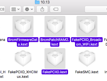

foskvs Posted November 6, 2017 Share Posted November 6, 2017 The highlighted kexts are necessary to have wifi (the two FakePCIIDs) and bluetooth (the other two) working. As of 10.13.1, there's no need to have patched regarding wifi or bt on your config.plist. If it doesn't work even with these kexts, you might have a patched (or missing) IO80211Family.kext. In this case, boot recovery mode or installer. They both use different kexts that are very unlikely to have been patched (at least for the common user). Link to comment https://www.insanelymac.com/forum/topic/329300-wifi-card-bcm94352hmb-not-detected-high-sierra/page/2/#findComment-2529776 Share on other sites More sharing options...
garti Posted November 7, 2017 Share Posted November 7, 2017 The highlighted kexts are necessary to have wifi (the two FakePCIIDs) and bluetooth (the other two) working. As of 10.13.1, there's no need to have patched regarding wifi or bt on your config.plist. If it doesn't work even with these kexts, you might have a patched (or missing) IO80211Family.kext. In this case, boot recovery mode or installer. They both use different kexts that are very unlikely to have been patched (at least for the common user). Are you saying the IO80211Family.kext need to be untouched ? I never get in hackintosh recovery mode...I will try that. Link to comment https://www.insanelymac.com/forum/topic/329300-wifi-card-bcm94352hmb-not-detected-high-sierra/page/2/#findComment-2530244 Share on other sites More sharing options...

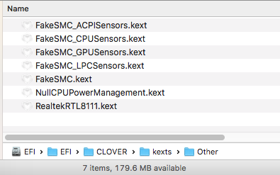

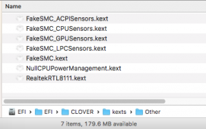

foskvs Posted November 10, 2017 Share Posted November 10, 2017 BT is connected through USB. Have you already increased usb port limit? Are you using usbinjectall.kext? Attach output from terminal after you run kextstat | grep -v com.apple Link to comment https://www.insanelymac.com/forum/topic/329300-wifi-card-bcm94352hmb-not-detected-high-sierra/page/2/#findComment-2532227 Share on other sites More sharing options...
garti Posted November 11, 2017 Share Posted November 11, 2017 BT is connected through USB. Have you already increased usb port limit? Are you using usbinjectall.kext? Attach output from terminal after you run kextstat | grep -v com.apple Thank you for helping me. kextstat | grep -v com.apple Index Refs Address Size Wired Name (Version) UUID <Linked Against> 16 0 0xffffff7f8311c000 0x2000 0x2000 org.tgwbd.driver.NullCPUPowerManagement (1.0.0d2) 93D39664-55FB-9220-39AD-A436B33DB160 <7 4 3> 37 3 0xffffff7f83120000 0x11000 0x11000 org.netkas.driver.FakeSMC (1759) 987B8DEE-6600-3463-BFFA-DF500771FA5B <11 7 5 4 3 1> 38 0 0xffffff7f83131000 0x5000 0x5000 org.hwsensors.driver.CPUSensors (1759) 1204F31F-1308-3F9A-B509-0425FC789815 <37 7 5 4 3> 49 0 0xffffff7f83137000 0x8000 0x8000 org.hwsensors.driver.ACPISensors (1759) FA4DF6C0-0D3A-3CE2-8569-0AB2C84053E7 <37 11 7 5 4 3> 59 0 0xffffff7f83141000 0xd000 0xd000 org.hwsensors.driver.LPCSensors (1759) 46F77040-FA0F-3AEC-8330-E776B2D56C60 <37 12 11 7 5 4 3> 61 0 0xffffff7f8314e000 0x67000 0x67000 com.insanelymac.RealtekRTL8111 (2.2.1) FDD47F63-B851-312E-AC10-047DCBD6708F <60 12 5 4 3 1> 67 0 0xffffff7f831b8000 0x7000 0x7000 org.rehabman.driver.FakePCIID (1.3.9) BC738576-B800-3E7F-992D-3851C67CCAA9 <12 7 5 4 3 1> https://pastebin.com/MCTnCbmX Raw https://pastebin.com/raw/MCTnCbmX Config.plist https://pastebin.com/raw/1KgtfCWC Kexts in Clover I am using this thing ; Link to comment https://www.insanelymac.com/forum/topic/329300-wifi-card-bcm94352hmb-not-detected-high-sierra/page/2/#findComment-2532544 Share on other sites More sharing options...
foskvs Posted November 11, 2017 Share Posted November 11, 2017 See post #32. Remove BrcmFirmwareRepo.kext and add BrcmFirmwareData.kext Link to comment https://www.insanelymac.com/forum/topic/329300-wifi-card-bcm94352hmb-not-detected-high-sierra/page/2/#findComment-2532692 Share on other sites More sharing options...
garti Posted November 11, 2017 Share Posted November 11, 2017 See post #32. Remove BrcmFirmwareRepo.kext and add BrcmFirmwareData.kext Still, BT is Dead. Link to comment https://www.insanelymac.com/forum/topic/329300-wifi-card-bcm94352hmb-not-detected-high-sierra/page/2/#findComment-2532848 Share on other sites More sharing options...

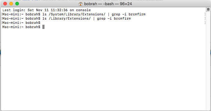

foskvs Posted November 11, 2017 Share Posted November 11, 2017 From terminal: ls /System/Library/Extensions/ | grep -i brcmfirm ls /Library/Extensions/ | grep -i brcmfirm Attach output. Link to comment https://www.insanelymac.com/forum/topic/329300-wifi-card-bcm94352hmb-not-detected-high-sierra/page/2/#findComment-2532851 Share on other sites More sharing options...
garti Posted November 11, 2017 Share Posted November 11, 2017 From terminal: ls /System/Library/Extensions/ | grep -i brcmfirm ls /Library/Extensions/ | grep -i brcmfirm Attach output. Empty Link to comment https://www.insanelymac.com/forum/topic/329300-wifi-card-bcm94352hmb-not-detected-high-sierra/page/2/#findComment-2532880 Share on other sites More sharing options...

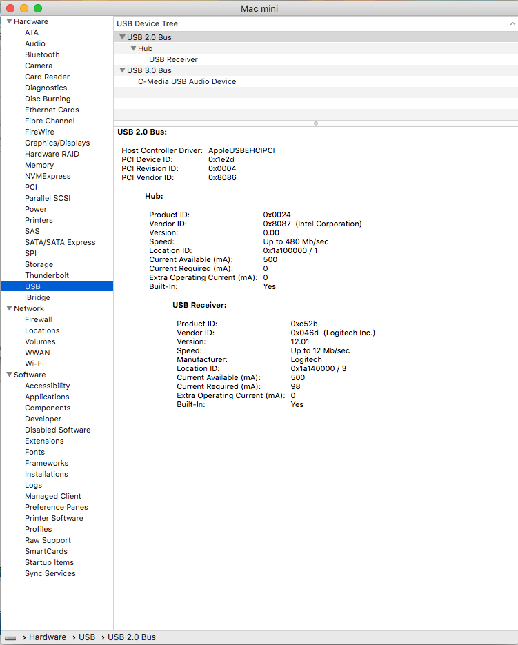

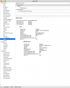

foskvs Posted November 11, 2017 Share Posted November 11, 2017 Attach screenshot from About this Mac -> System Report -> USB Link to comment https://www.insanelymac.com/forum/topic/329300-wifi-card-bcm94352hmb-not-detected-high-sierra/page/2/#findComment-2532896 Share on other sites More sharing options...
garti Posted November 11, 2017 Share Posted November 11, 2017 Attach screenshot from About this Mac -> System Report -> USB Attached The Mouse/Keyboard transmitter The USB Audio dongle. Link to comment https://www.insanelymac.com/forum/topic/329300-wifi-card-bcm94352hmb-not-detected-high-sierra/page/2/#findComment-2532901 Share on other sites More sharing options...
foskvs Posted November 11, 2017 Share Posted November 11, 2017 Attached The Mouse/Keyboard transmitter The USB Audio dongle. Screen Shot 2017-11-11 at 12.19.31 PM.png BT should be detected even if it's not enabled. Attach your config.plist. Link to comment https://www.insanelymac.com/forum/topic/329300-wifi-card-bcm94352hmb-not-detected-high-sierra/page/2/#findComment-2532904 Share on other sites More sharing options...
