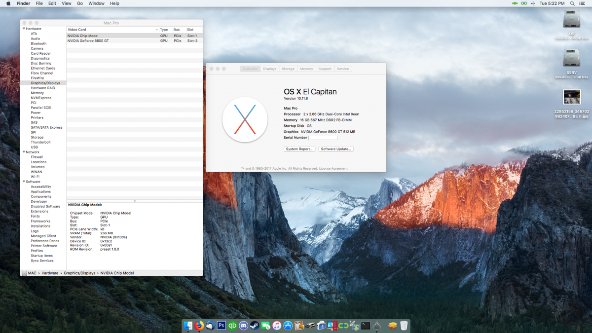

MylanVoid Posted October 31, 2017 Share Posted October 31, 2017 I have this exact card, I just installed in my MacPro 1 1.https://www.amazon.com/MSI-GAMING-GTX-970-100ME/dp/B00TPLKR7Q/ref=sr_1_1?s=electronics&ie=UTF8&qid=1509488203&sr=1-1&keywords=msi+geforce+gtx+970+gaming+100meI'm running 10.11.6, and using WebDriver 346.03.15f09.The card is installed in the 1st slot (bottom), and I have a 8600 GT in the one above it.The GTX 970 shows up as "Nvidia Chip Model", and gives no output on any interface. Surely there is some kext I can modify? Which one? Link to comment https://www.insanelymac.com/forum/topic/329155-msi-970-100me-on-macpro-1-1/ Share on other sites More sharing options...

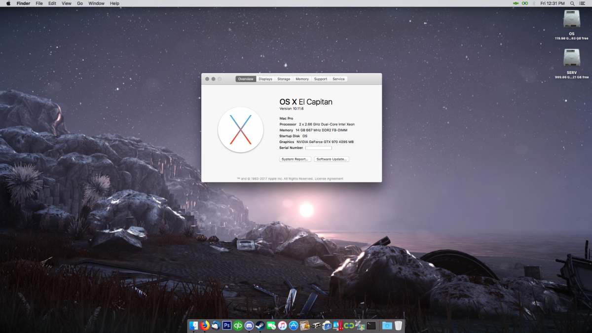

MylanVoid Posted November 3, 2017 Author Share Posted November 3, 2017 I fixed the problem. I traded a friend the MSI 970 with an EVGA 970 SC, and it worked flawlessly. Link to comment https://www.insanelymac.com/forum/topic/329155-msi-970-100me-on-macpro-1-1/#findComment-2528510 Share on other sites More sharing options...
