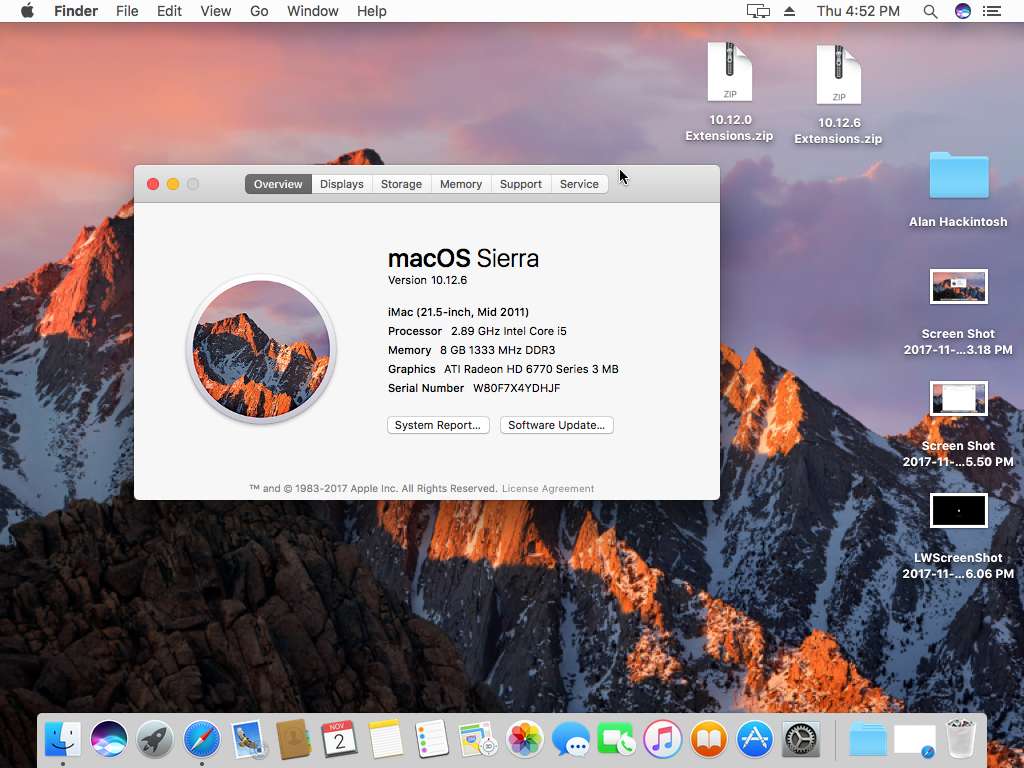

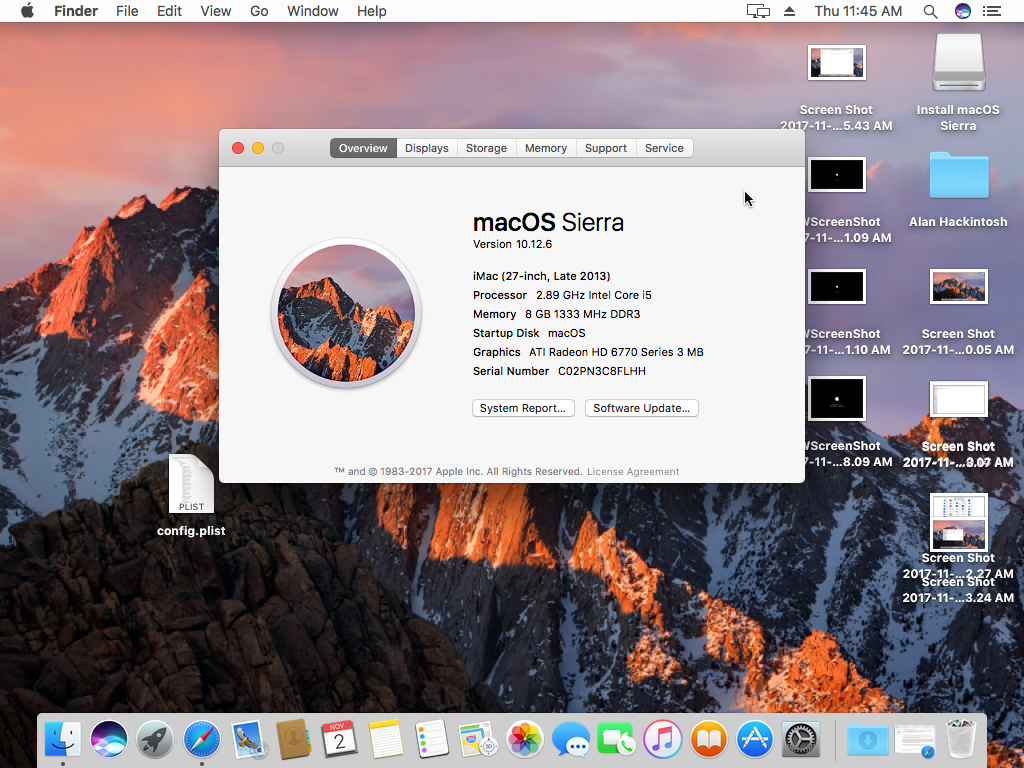

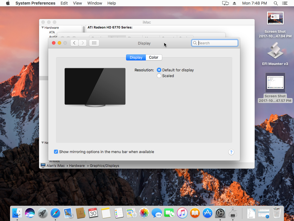

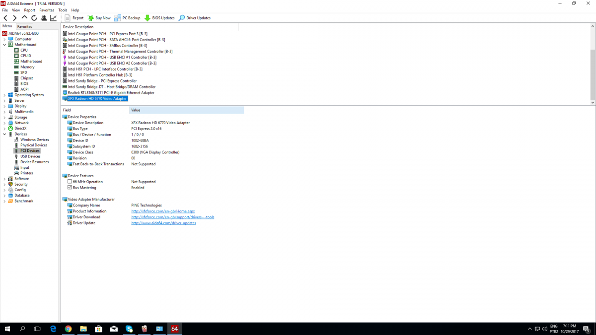

I am struggling to make my ATI XFX 6770 to work decently on my hackintosh running Sierra, I've tried everything that I saw about it but with no results.
I would like to ask someone's help of what I should do to have this card working and if it's possible show me where I can get kext of it, because I've downloaded so many of it that I don't know if it's not working because i'm using the wrong kexts. I've tried inject FakeID and lot's of other things that i saw.

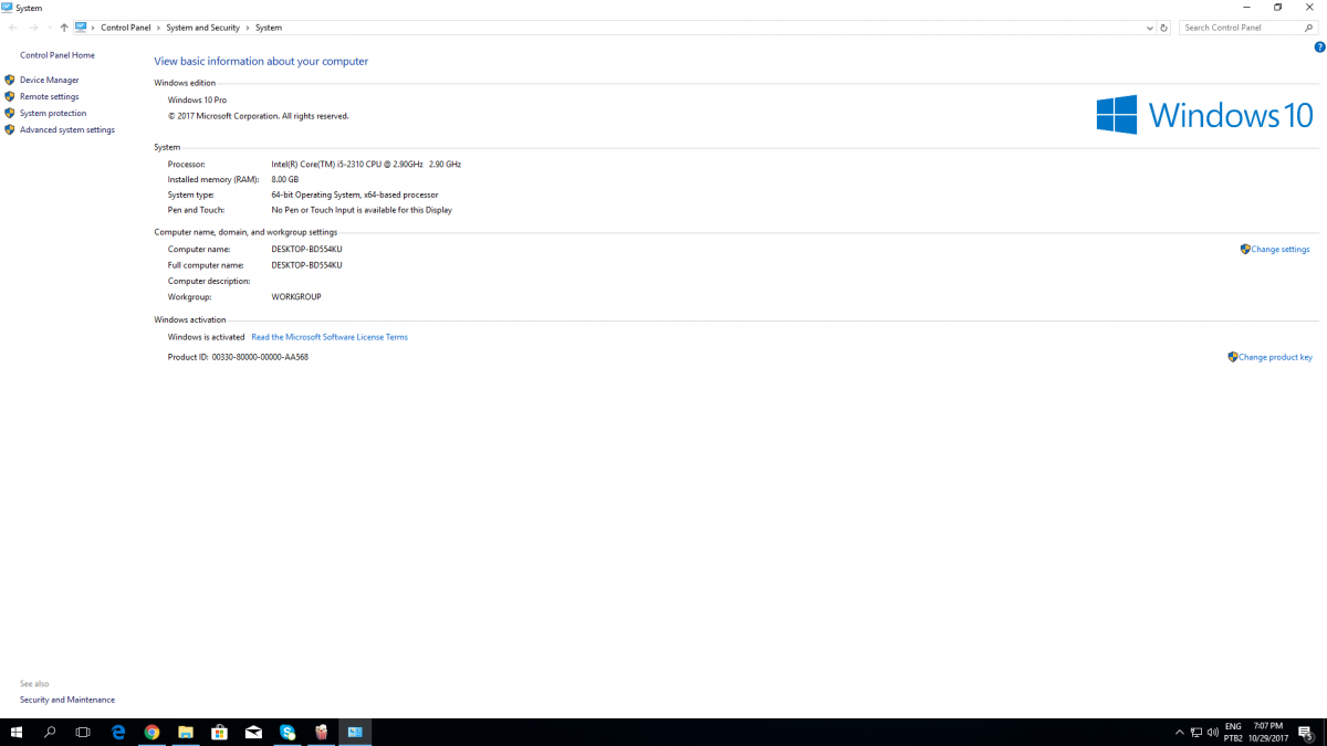

I will post my setup (it's on windows but I just want you to know my setup)
I would be so grad with someone's help.
Thank you very muc in advance!

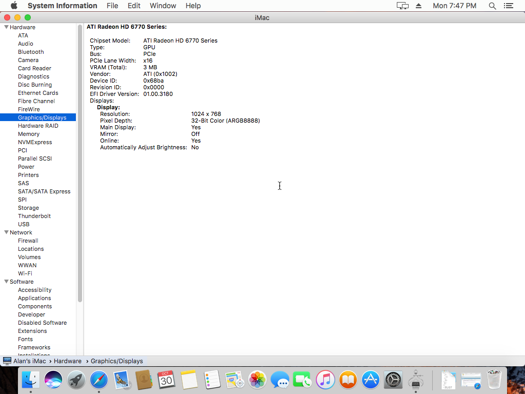

I've tried it again and I couldn't make it work. Probably I'm doing something wrong, but I can't find what :-(
I'll post what I have so far:

Try liukext and Whatevergreenkext these go in Clover EFI folder in Kexts folder "Other".
I tried it. But nothing happen :-(

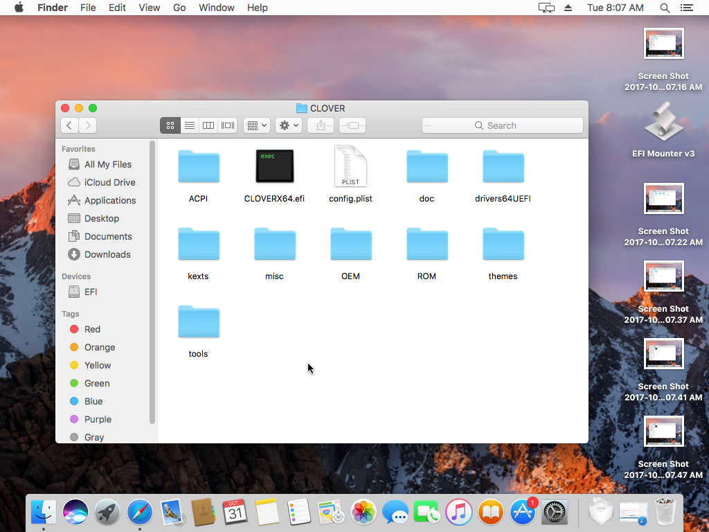

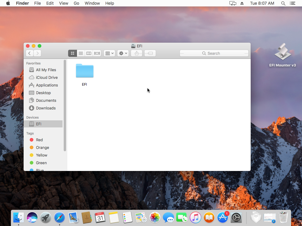

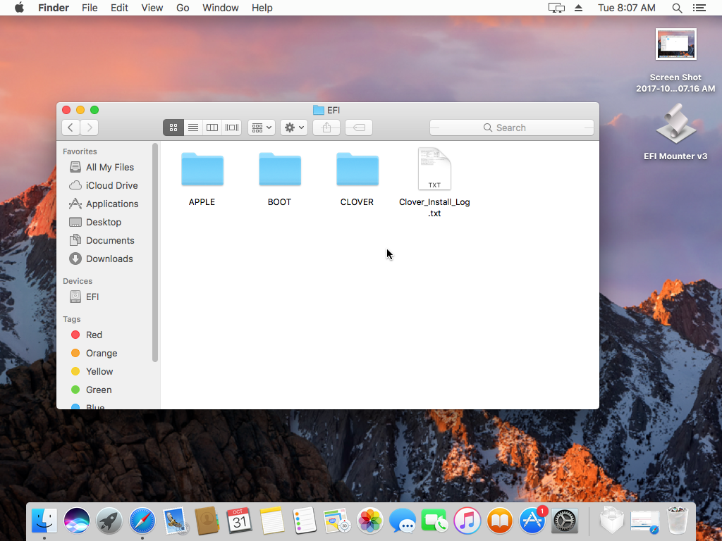

your efi please

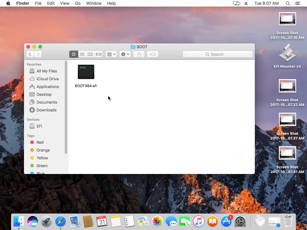

Here it goes:
( I could't upload it here)
https://mega.nz/#!97xTER6D!E-m6p3ih96WjxlFg39P7M46lB10CNN4yLg1GEYiUTjo
It's my whole EFI folder.
Thank you for your help!

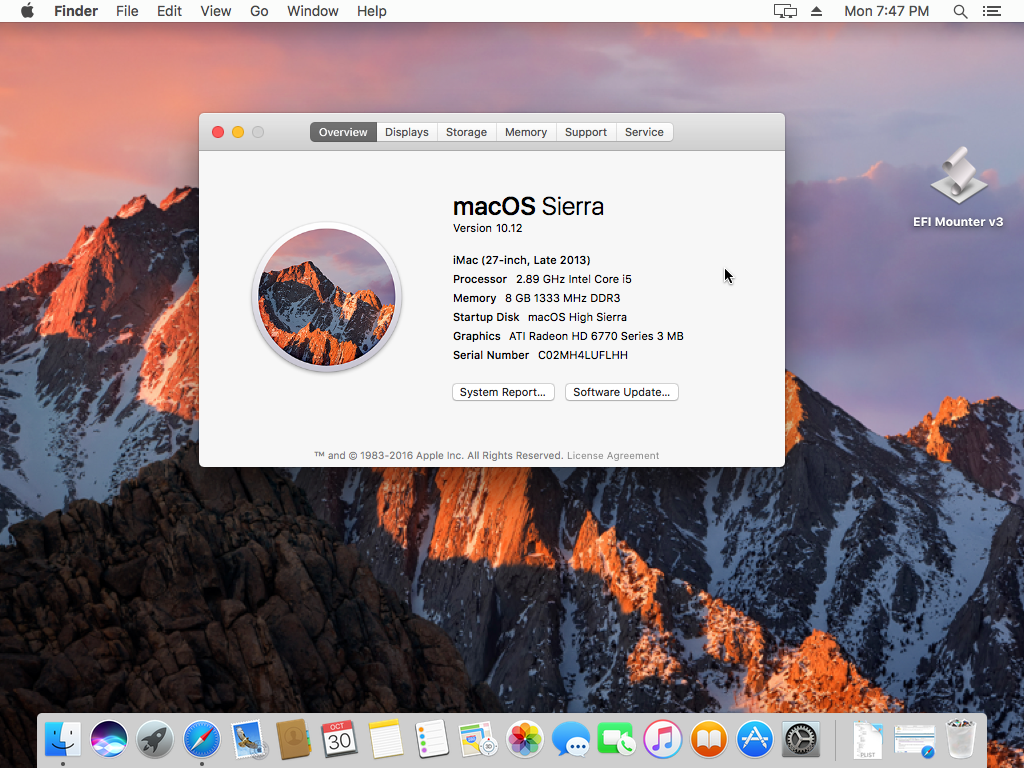

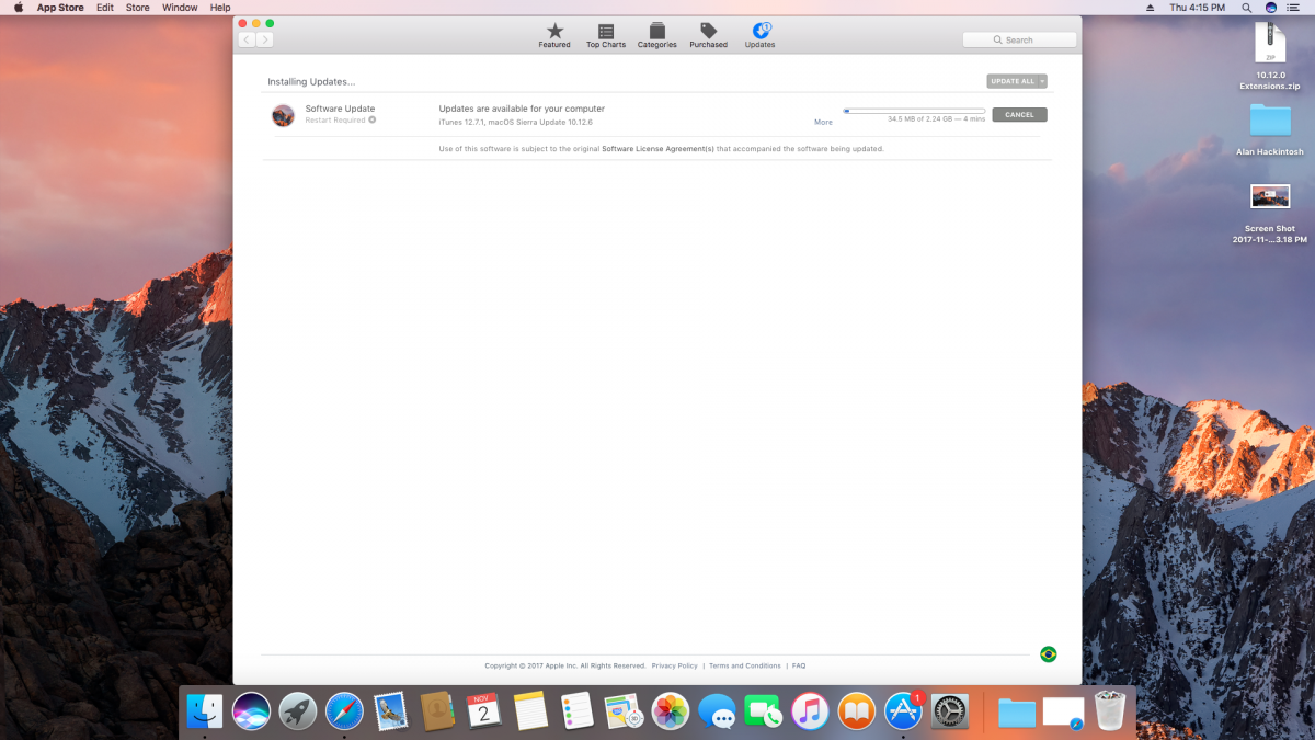

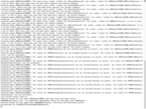

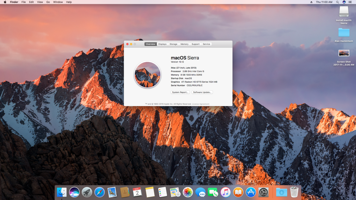

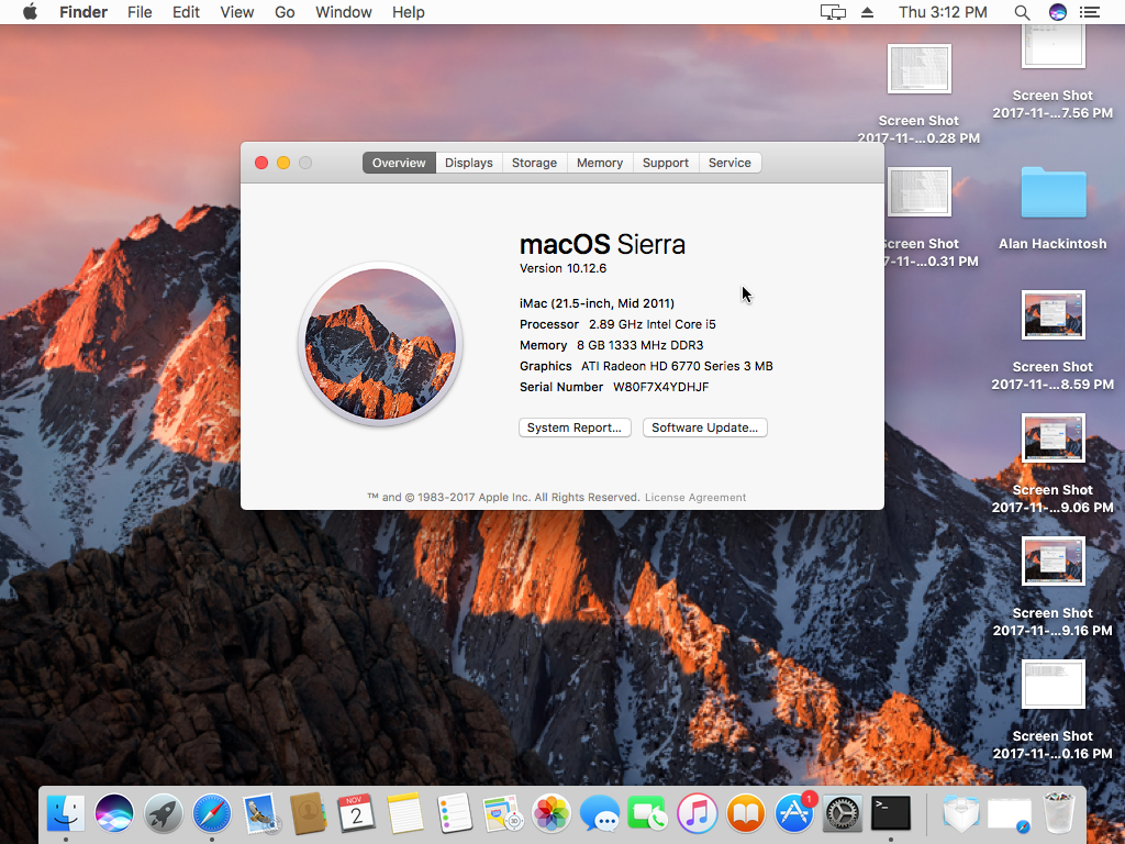

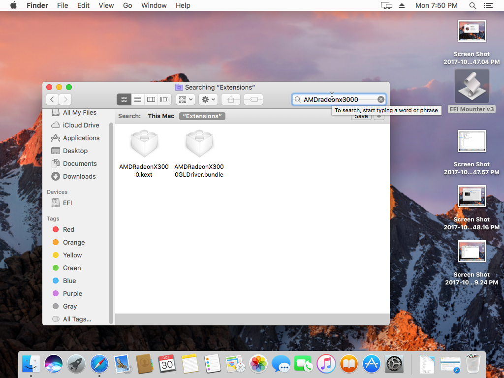

Sorry for the delay to answer but I was running a few tests. Actually I was successful in "Sierra with no update" using http://www.insanelymac.com/forum/files/file/565-hd6770-qe-ci-patch/ as you mentioned. But if I update it for the last version of Sierra 10.12.6 it does't work anymore and I needed at least this last version of sierra :-(
I also tried update for the High Sierra and try to use this > http://www.insanelymac.com/forum/files/file/749-hd6770-qe-ci-patch/but it didn't work.
I don't mind in using Sierra and not the high Sierra but for Sierra I needed it to be at least 10.12.6 update.
I did not finish looking for the other link you posted and I will look at it when I got home (I'm in my lunch time) but if you have some point about it I would love to hear it.
One more time, thank you very much for your help! :-)

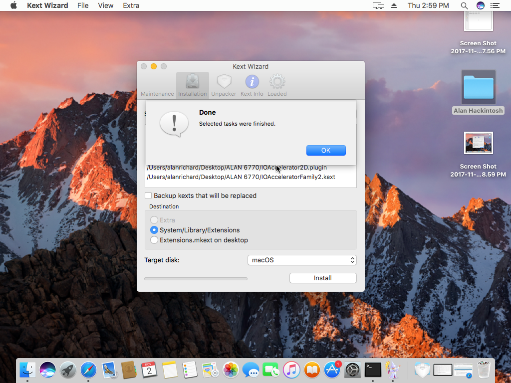

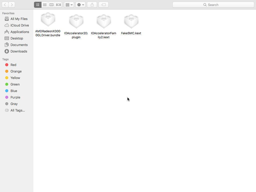

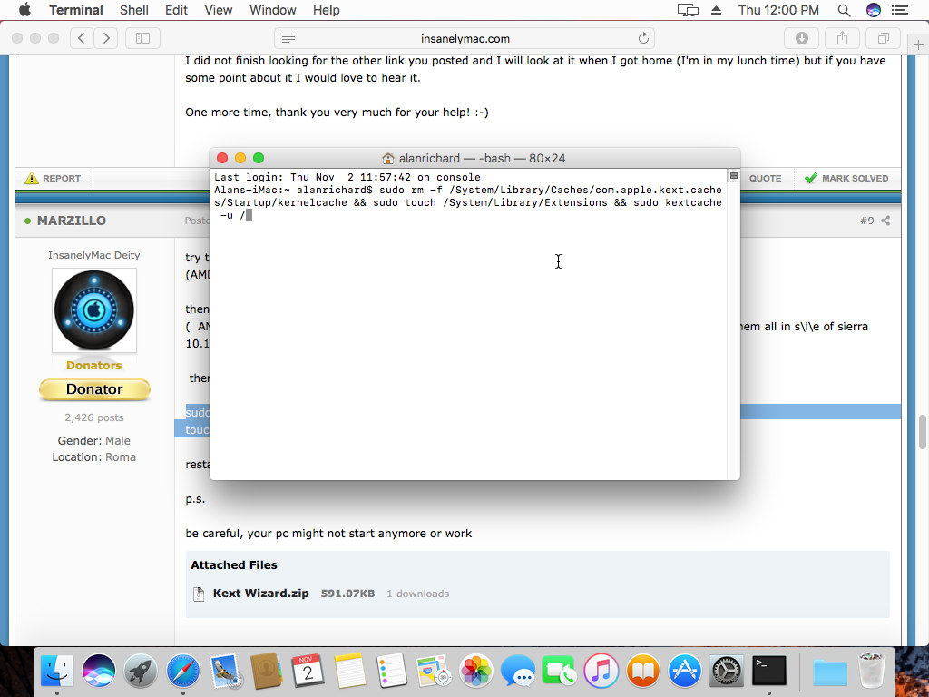

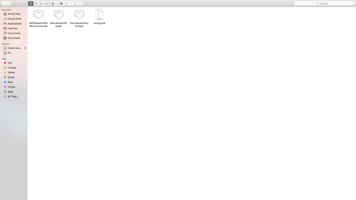

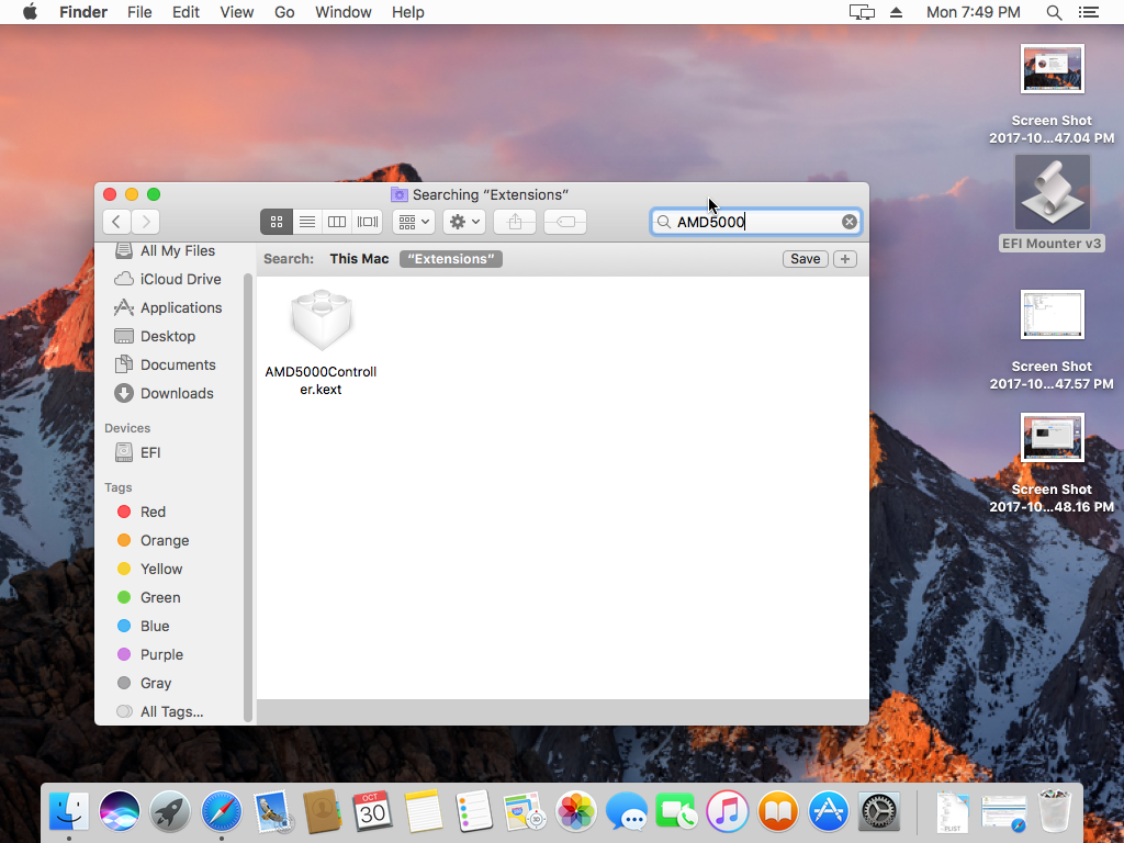

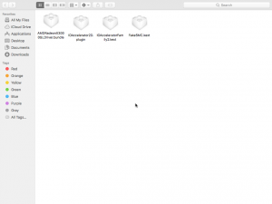

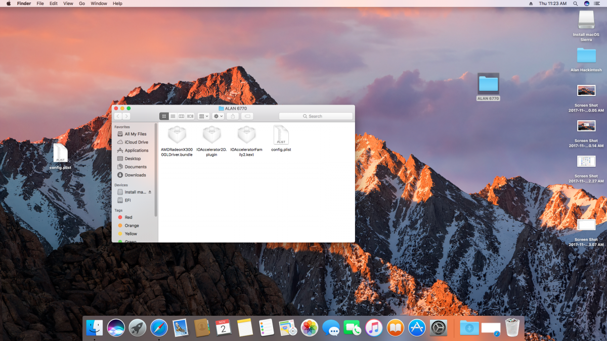

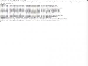

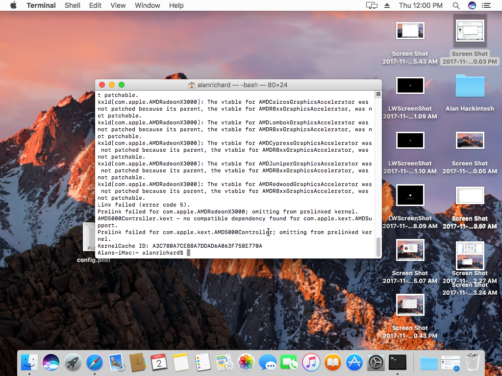

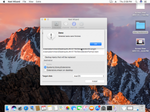

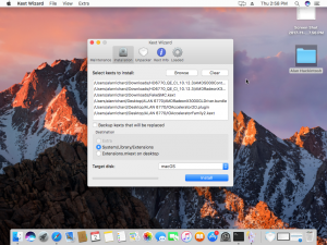

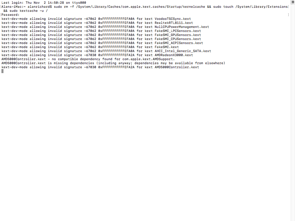

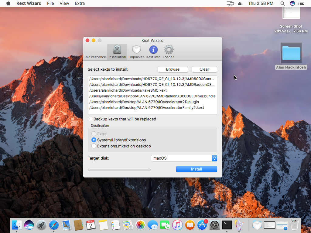

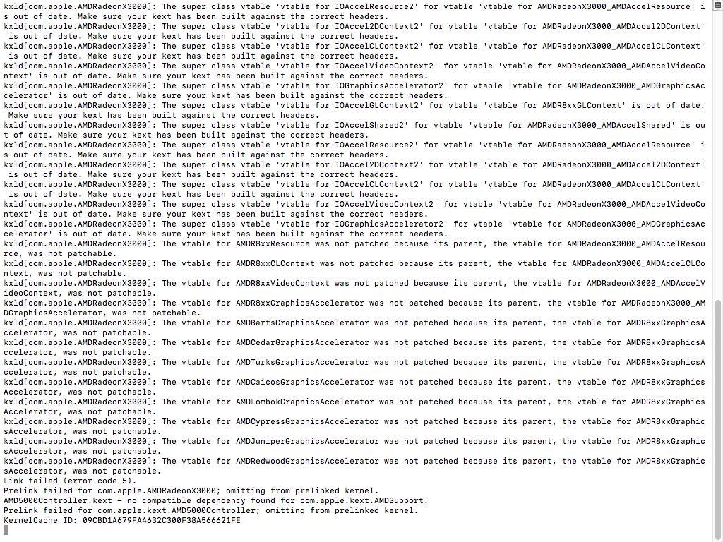

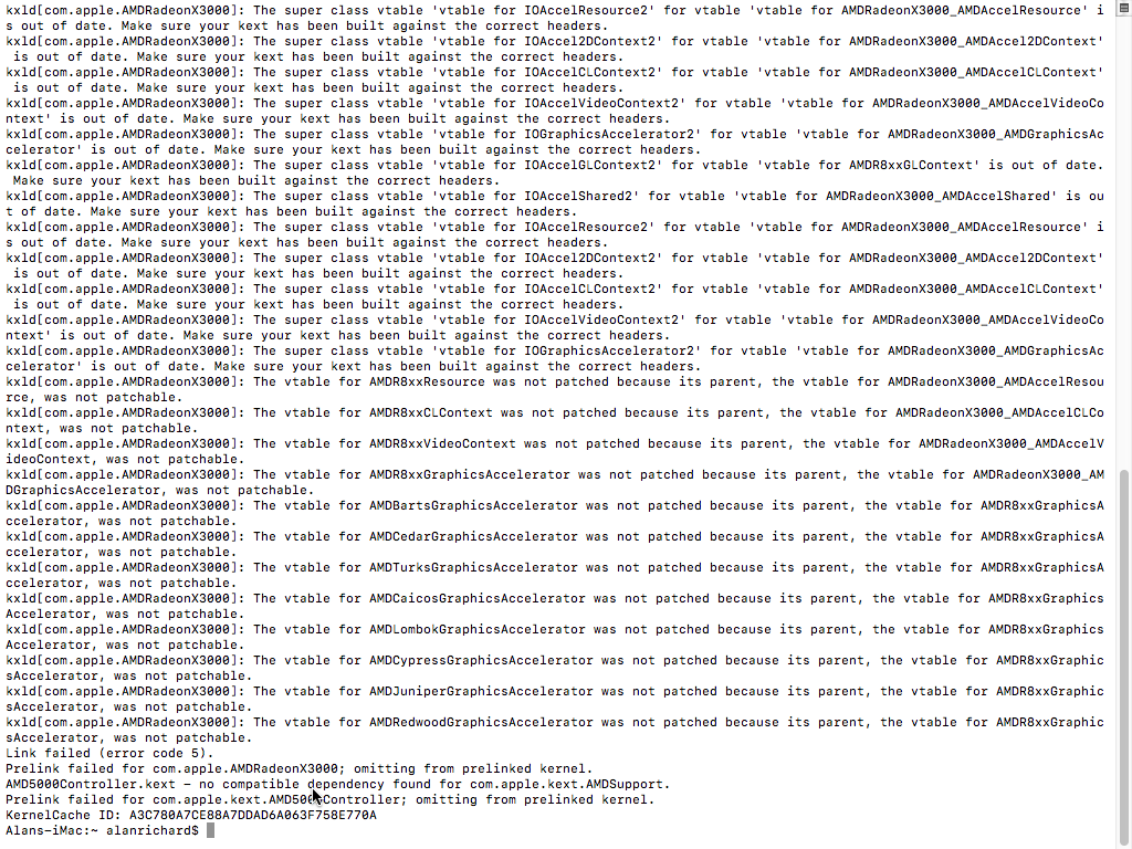

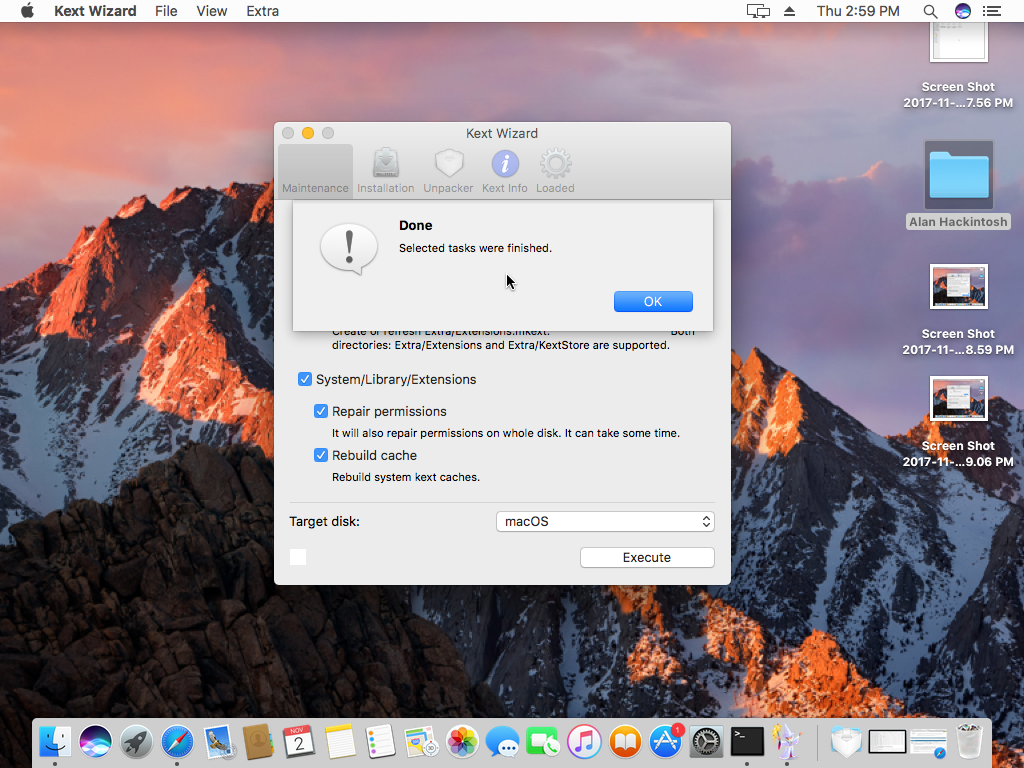

try this solution but I do not guarantee the result .... take kext of patch 12.10.5 (AMD5000Controller.kext, AMDRadeonX3000.kext)
then you  take these kext from sierra 10.12.5 (  AMDRadeonX3000GLDriver.bundle, IOAccelerator2D.plugin, IOAcceleratorFamily2.kext )  replace them all in s\l\e of sierra 10.12.6 with kext wizard

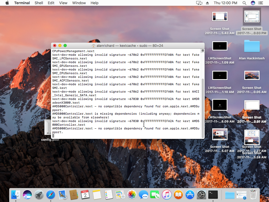

 then launch command from terminal:
sudo rm -/System/Library/Caches/com.apple.kext.caches/Startup/kernelcache && sudo touch /System/Library/Extensions && sudo kextcache -/
restart
p.s.
be careful, your pc might not start anymore or work
Kext Wizard.zip
sudo rm -f /System/Library/Caches/com.apple.kext.caches/Startup/kernelcache && sudo touch /System/Library/Extensions && sudo kextcache -u /
restart
p.s.
I'm home now and I'm gonna start it. But I have a question first:
There's no "patch 12.10.5" just 12.10.3 > http://www.insanelymac.com/forum/files/download/565-hd6770-qe-ci-patch/Or 12.13.1 > http://www.insanelymac.com/forum/files/file/749-hd6770-qe-ci-patch/
So I am alite confuse of how I should do it.

0:110  0:000   - [00]: AMDRadeonX3000 (NoLabel)[ERROR] bin2hex '0x68B81002' syntax error
0:110  0:000  [ERROR] bin2hex '0x68BA1002' syntax error
0:110  0:000   - invalid Find/Replace data - skipping!
0:110  0:000   - [01]: AMD5000Controller (NoLabel)[ERROR] bin2hex '0x68B81002' syntax error

22:606  0:000  ATI Juniper ATI Radeon HD 6770 Series 1024MB (Hoolock) [1002:68BA] (subsys [1682:3156]):: PciRoot(0x0)\Pci(0x1,0x0)\Pci(0x0,0x0)

try this solution but I do not guarantee the result .... take kext of patch 12.10.3 (AMD5000Controller.kext, AMDRadeonX3000.kext)
then you  take these kext from sierra 12.10.3 o 12.10.5(  AMDRadeonX3000GLDriver.bundle, IOAccelerator2D.plugin, IOAcceleratorFamily2.kext )  replace them all in s\l\e of sierra 10.12.6 with kext wizard
restart
p.s.

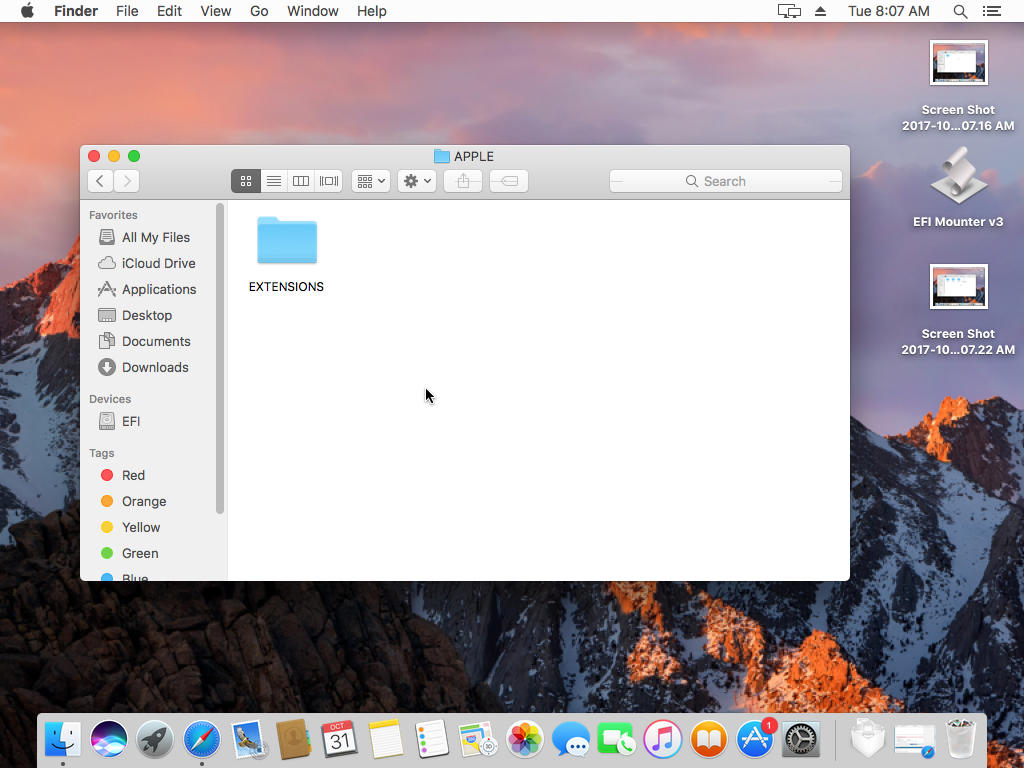

I couldn't find (  AMDRadeonX3000GLDriver.bundle, IOAccelerator2D.plugin, IOAcceleratorFamily2.kext ) in my system there's nothing like it here. neither I could get it from any of those patches.
These will be in the Main Partition or main drive in System then open Library then Extensions, now scroll to these kexts.
Start by going to top tool bar and select 'Finder" then go to "Preferences" check the box next to Hard Disk.    This will show your Hard drives on the desktop and make working on things easier.
Clock on the drive icon and open folder, go to "System" then "Library" Then "Extensions" and scroll to the desired kexts that are working now in 10.12.3 or 10.12.5 and drag copies to the desktop.   Don't worry they will stay in the "Extensions" folder.    These copies can be added to your new Sierra 10.12 6 or latest version by following the same method or path and dragging them form the desktop to the 'Extensions" folder just follow the replace prompts and after adding them make sure to run Kext Wizard to repair permissions and rebuild caches BEFORE you reboot or test.
One other major consideration is the reputation of XFX graphics cards in Hackintosh.    They are known to have incompatible vbios, but if you got it working in Sierra 10.12.3 then the kext replacement method should work.
So I finished running this tests but with no success. I did take so many prints as I could to help you guys to help me. I did reinstalled my Sierra with no update and the driver worked as you can see in my prints attached but when I update for the 10.12.6 version of Sierra it stops working :-(
When I was with Sierra with no updates the only code that was needed in my "config.plist" was the following:
<key>Graphics</key>
	<dict>
		<key>FBName</key>
		<string>Hoolock</string>
		<key>Inject</key>
		<dict>
			<key>ATI</key>
			<true/>
			<key>Intel</key>
			<false/>
			<key>NVidia</key>
			<false/>
		</dict>
		<key>NvidiaSingle</key>
		<false/>
		<key>VideoPorts</key>
		<integer>3</integer>
	</dict>
without this codes it worked also but the resolution was lite strange but when I used this it was just perfect (as you can see in my prints)
Please, see the prints that I did and try to figure out what I am doing wrong.
One more time, thank you very much for you time and afford toward helping me!

Sure,
I couldn't upload it here so I did here:
 https://mega.nz/#!l7InQJpR!OPq2JYSgpqc5M73iKzCmYlxT953eQ0kDYSpcqbkqhuA
(USE THE WHOLE LINK ABOVE)
And this is my "config.plist":

but you kext are in s\l\e\? fakesmc ecc ecc
Yes,
In (system\Library\Extensions) I have from “HD6770_QE_CI_10.12.3” ( http://www.insanelymac.com/forum/files/file/565-hd6770-qe-ci-patch/ ) kext "AMDRadeonX3000.kext and AMD5000Controller.kext) ,
from Sierra 10.12 (with no update) I have (AMDRadeonX3000GLDriver.bundle , IOAccelerator2D.plugin and  IOAcceleratorFamily2.kext)
And also "FakeSMC.kext", and I did it using kext wizard as you can see in my print.
And the efi you sended me
ok ... i asked for fantomas help 1 ... we wait

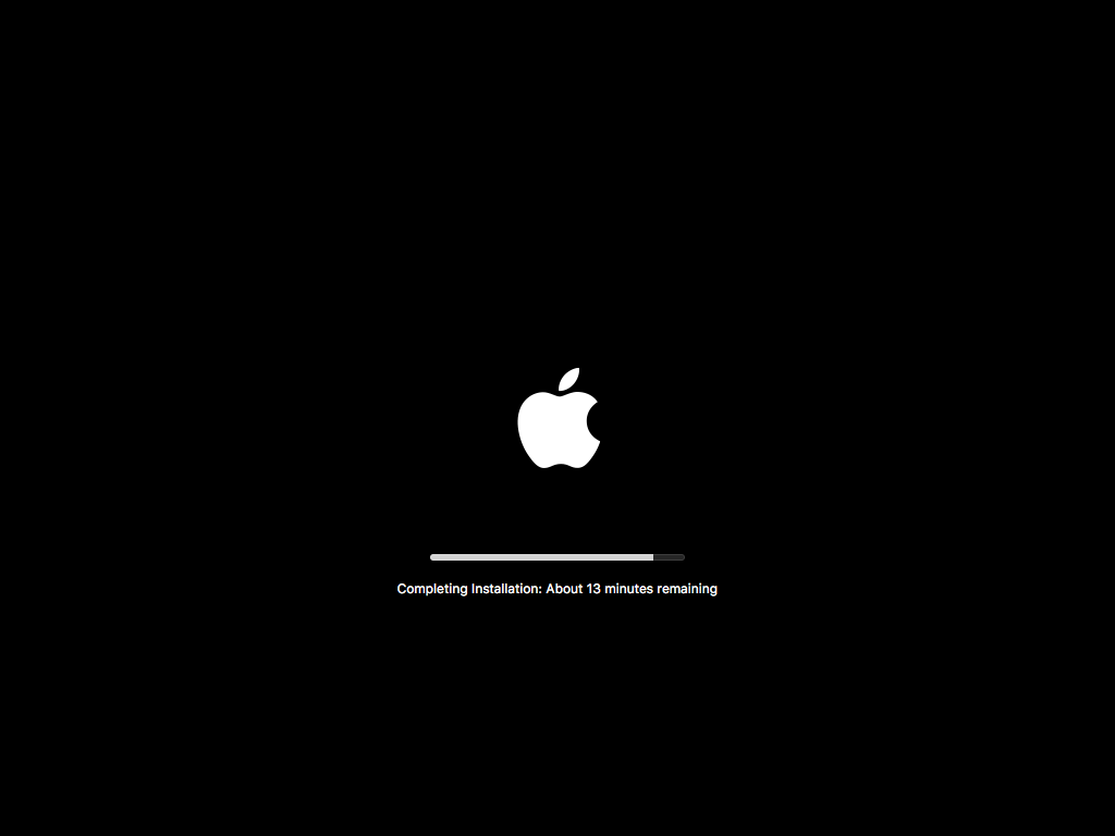

To be sure we're doing things properly, I suggest you (re)do a proper macOS Sierra install (10.12.6 installer) with Clover's config.plist strictly minimal essentials features for your config.
Once it is done, we'll continue.   ^_^
Hi everyone!   ^_^
@2013alanr

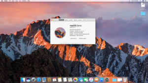

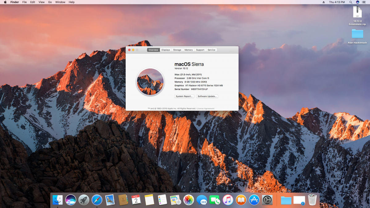

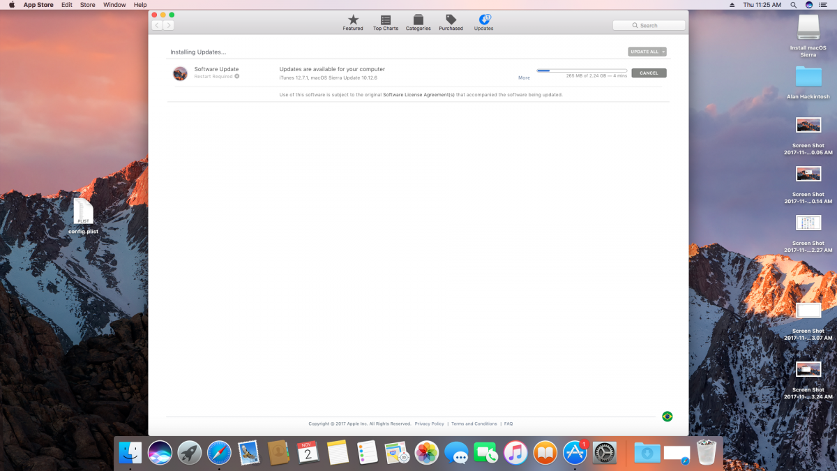

I just installed Sierra (Using 10.12.0) then updated to 10.12.6.
I used the kext HD6770_QE_CI_10.12.0.zip from here: http://www.insanelymac.com/forum/files/download/565-hd6770-qe-ci-patch/
Then the graphs worked as you can see on the prints.
But then updated it and it's stoped working so I did what MARZILLO suggested but no success.
Do you think I should reinstall Sierra directly from a installer 10.12.6 so I will not need to update ?
FYI:
I'm using clover v2.4k r4268
EFI: https://mega.nz/#!5ihDwajR!zkoKO3ZS_Xg340TUsfpo06zO1x0RnFr3_xolo58SONg
