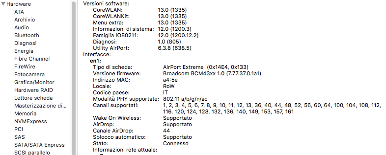

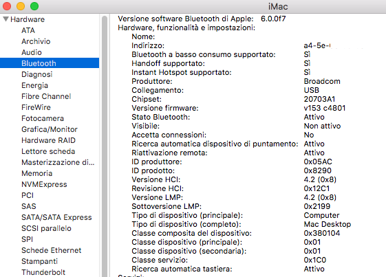

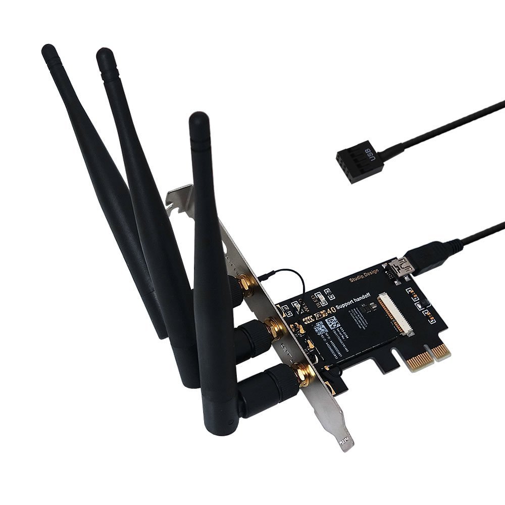

UltraLaser Posted October 15, 2017 Share Posted October 15, 2017 Hi friends, I have problem with this WIFI + BT card (Broadcom BCM94360CS look the picture below) : works perfectly OOTB without doing anything but don't send me to sleep the computer. I attach logs. Is there a solutions? thanx!! AirPortBrcm4360_Logs-001.txt Link to comment https://www.insanelymac.com/forum/topic/328507-bcm94360cs-no-sleep/ Share on other sites More sharing options...
