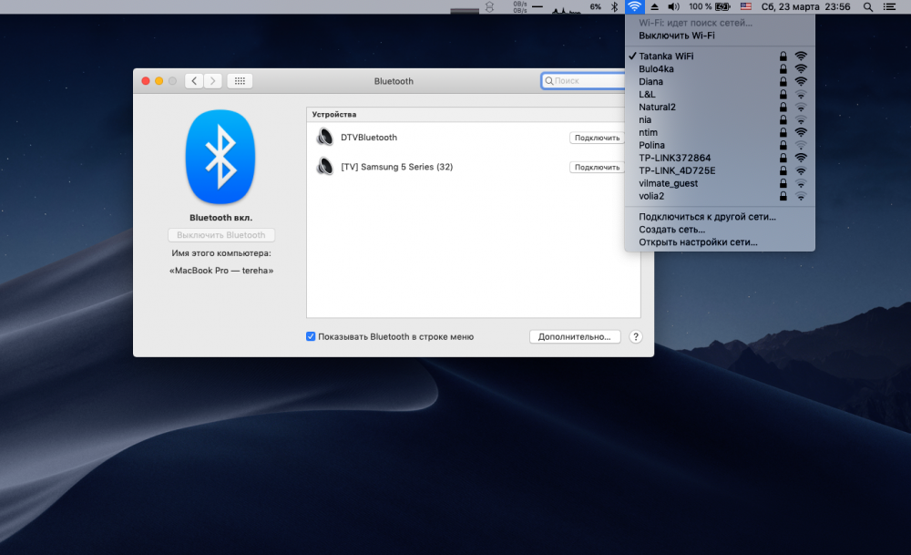

For Bluetooth I use this kexts, just put they to /EFI/CLOVER/kexts/Other/ directory (unzip they before)
BrcmFirmwareRepo.kext.zip
BrcmPatchRAM2.kext.zip
Integrated bluetooth device found other devices but I didn't try to connect they.
Could not find other devices (not discoverable) using Brcm kexts in Clover.  WiFi works very well.
