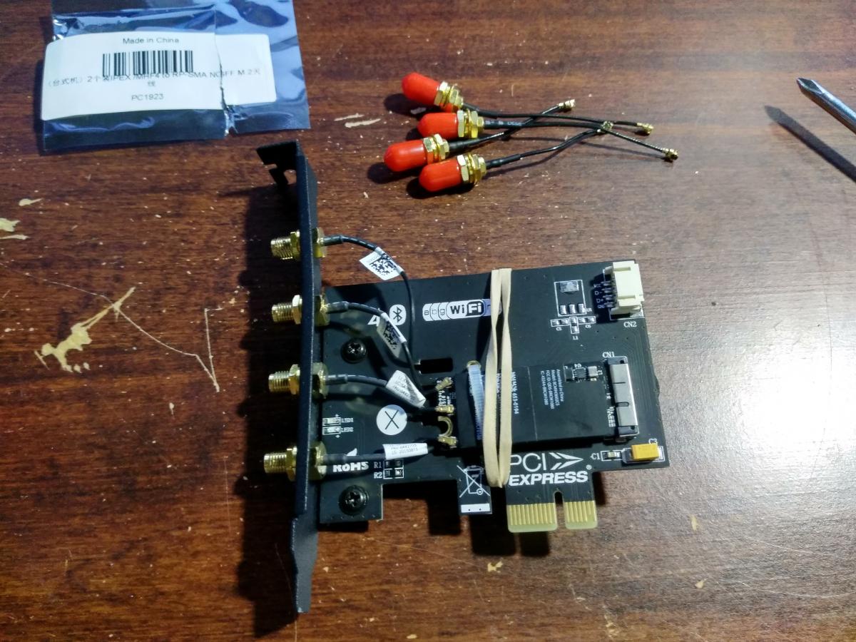

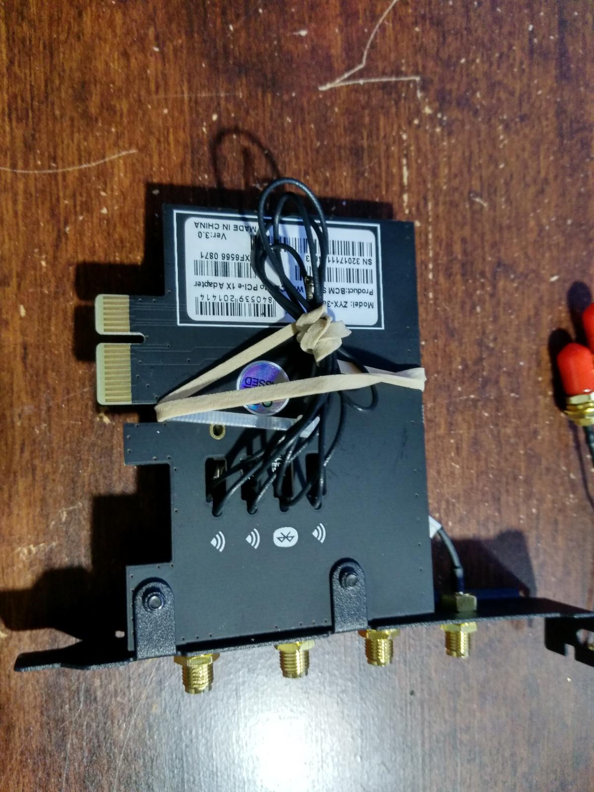

Wifi Module: Apple BCM943602CS: http://www.ebay.com/itm/MacBook-Pro...-Port-Card-BCM943602CS-653-0194-/272798823690
Bluetooth: Built in
Adapter: PCI-E 1x BCM4360CD Adapter: http://www.ebay.com/itm/BCM94360CD-...X-Adapter-for-hackintosh-and-PC-/232372992526
Antennas: MHF4 to RP-SMA Antenna Pigtail: http://www.ebay.com/itm/322627032027

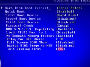

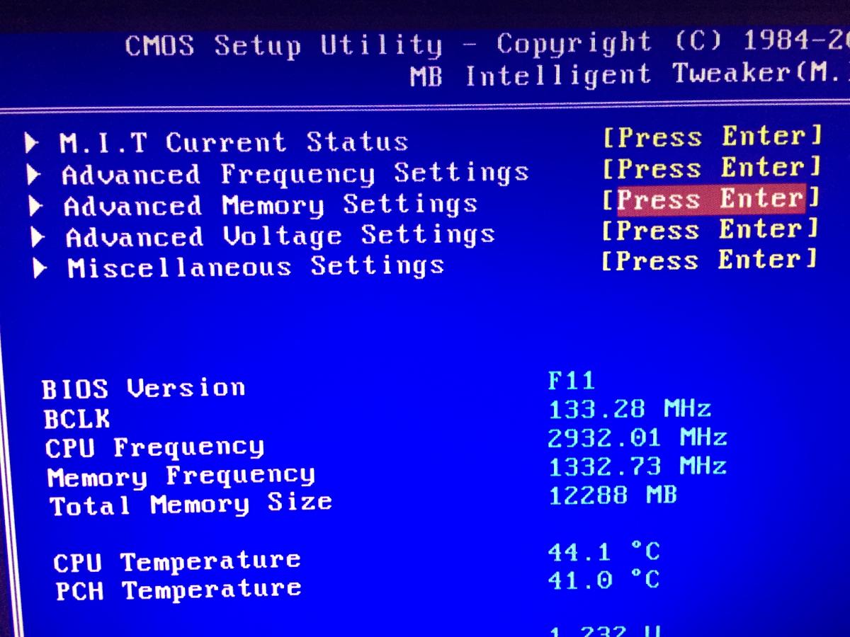

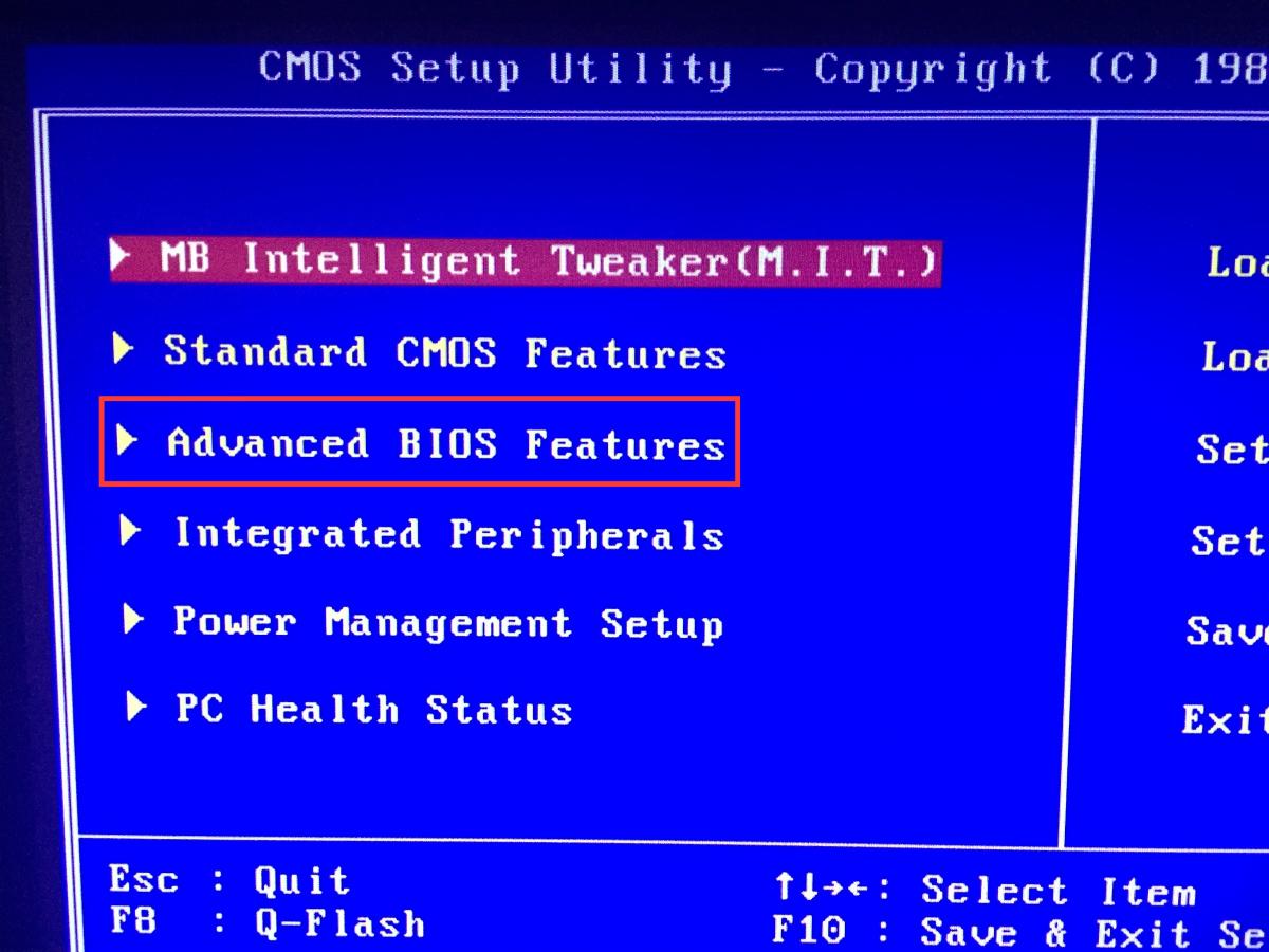

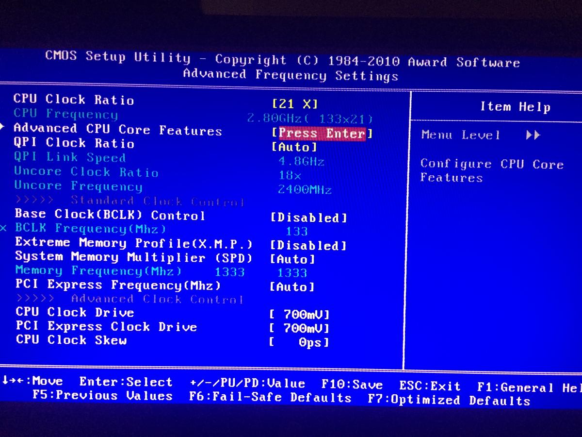

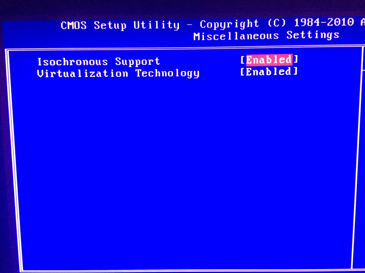

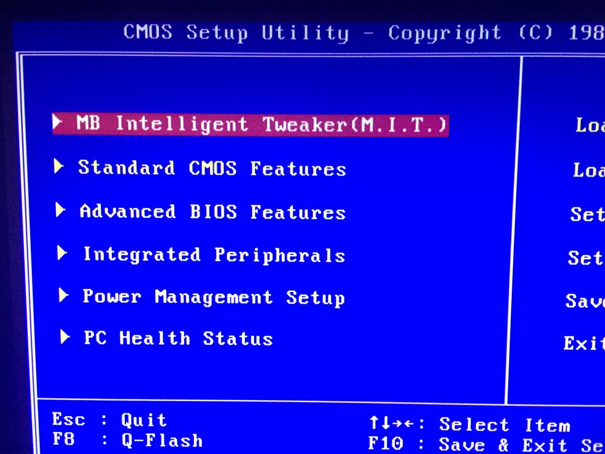

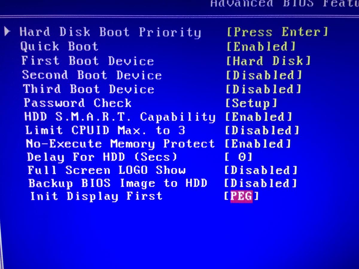

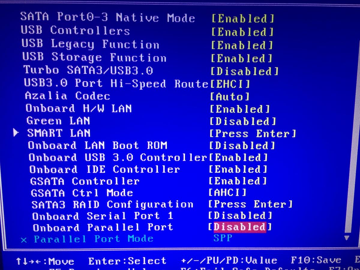

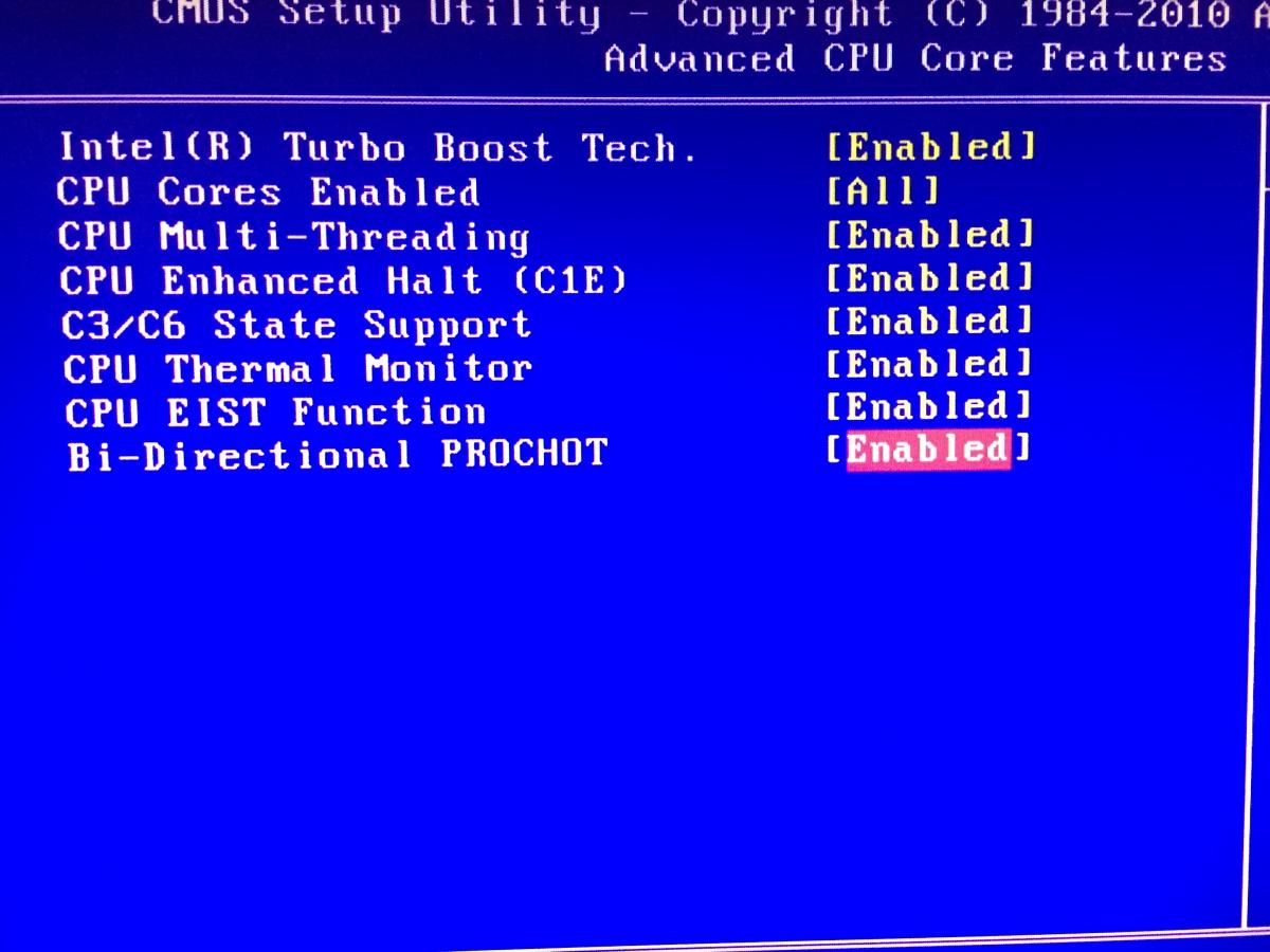

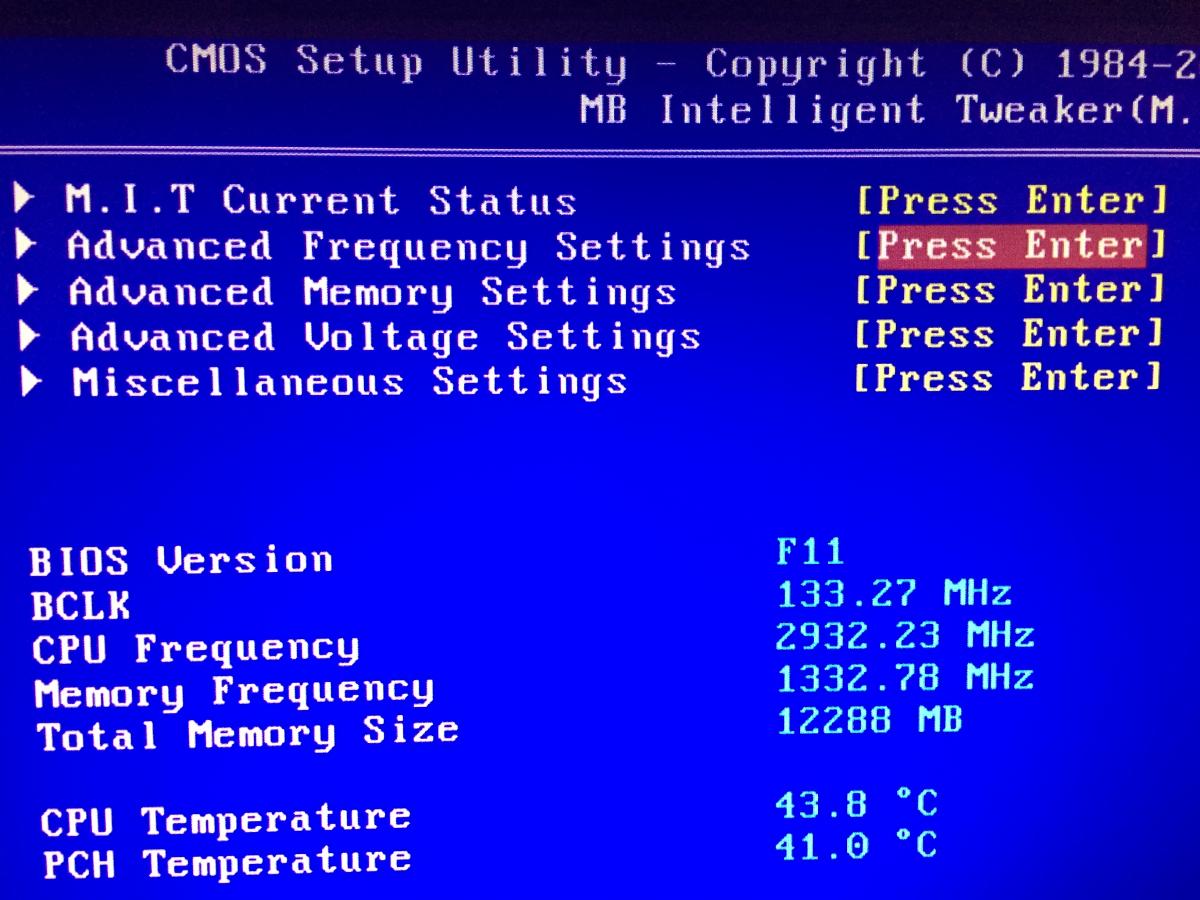

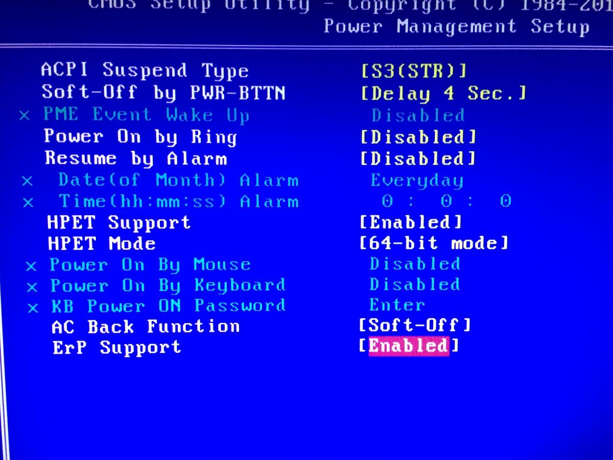

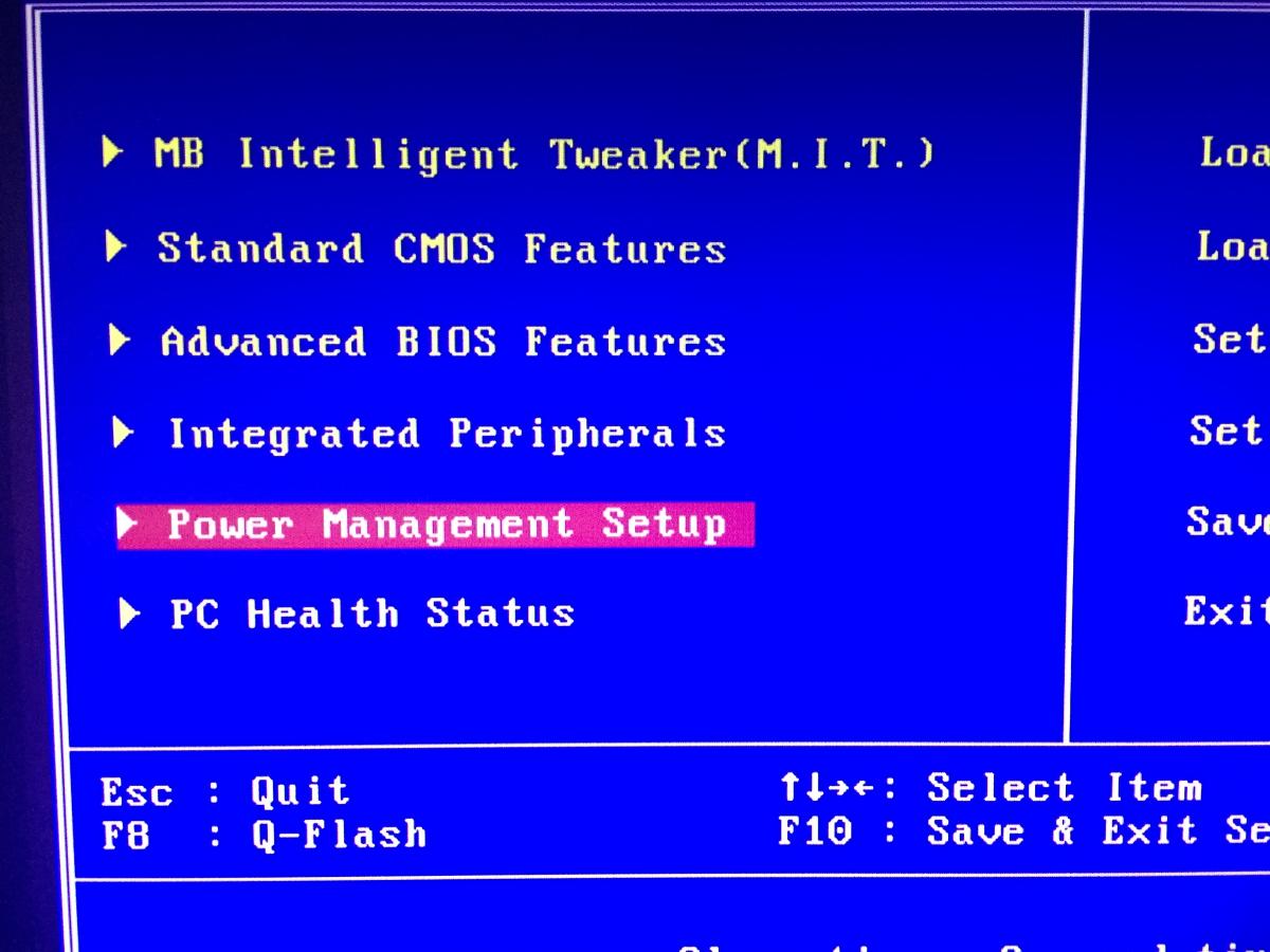

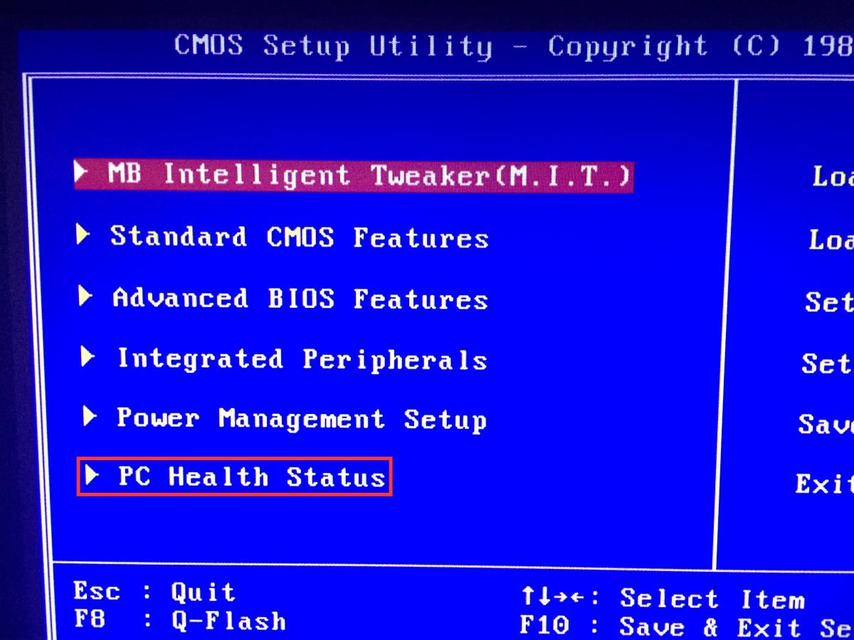

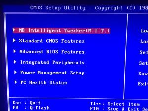

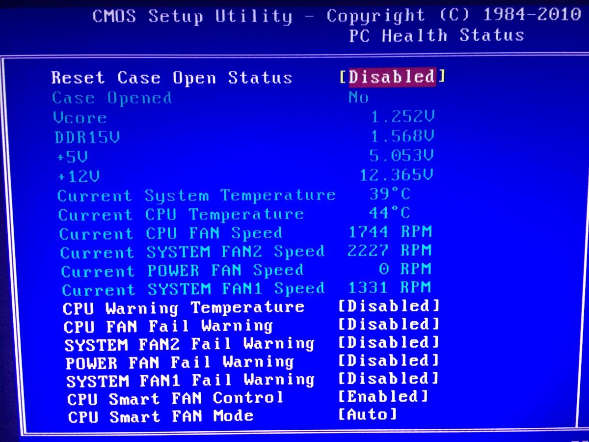

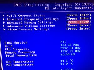

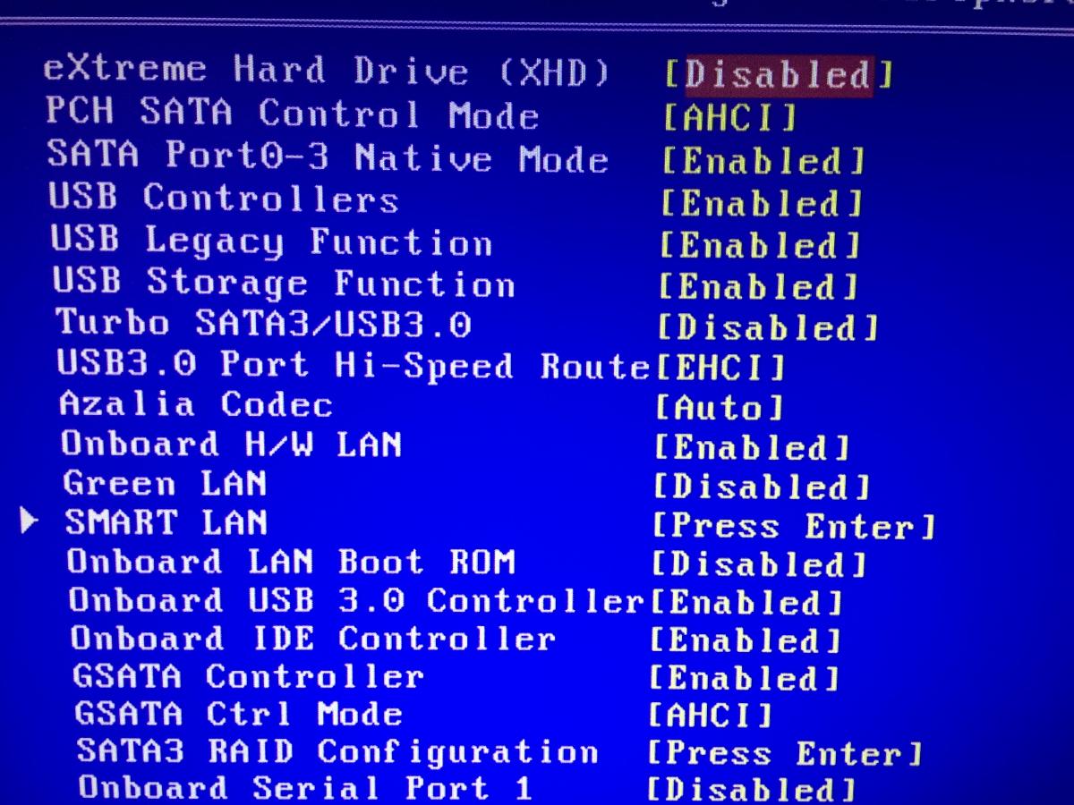

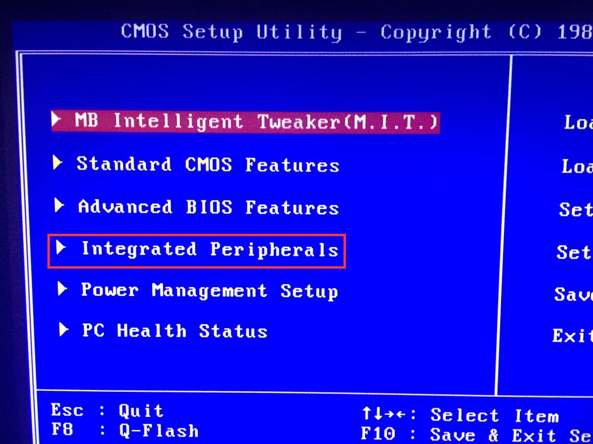

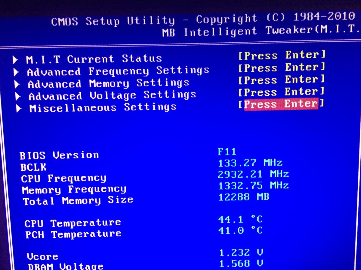

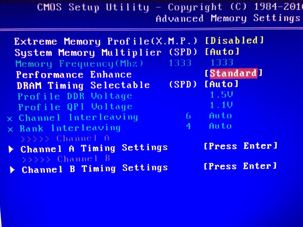

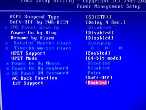

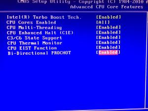

Bios settings: in image format.
These are in order from MB Intelligent Tweaker(M.I.T.) to PC Health Status including the sub menus from top to bottom.
I did forget to snap a pic of entering Avanced BIOS Features.
This may change if I find something to be in error or if someone sees a problem here that is breaking sleep.
I did forget to snap a pic of entering a few bios menus, annotated them with a red box.
Would have preferred to put these in a separate post or zip, but couldn't.
