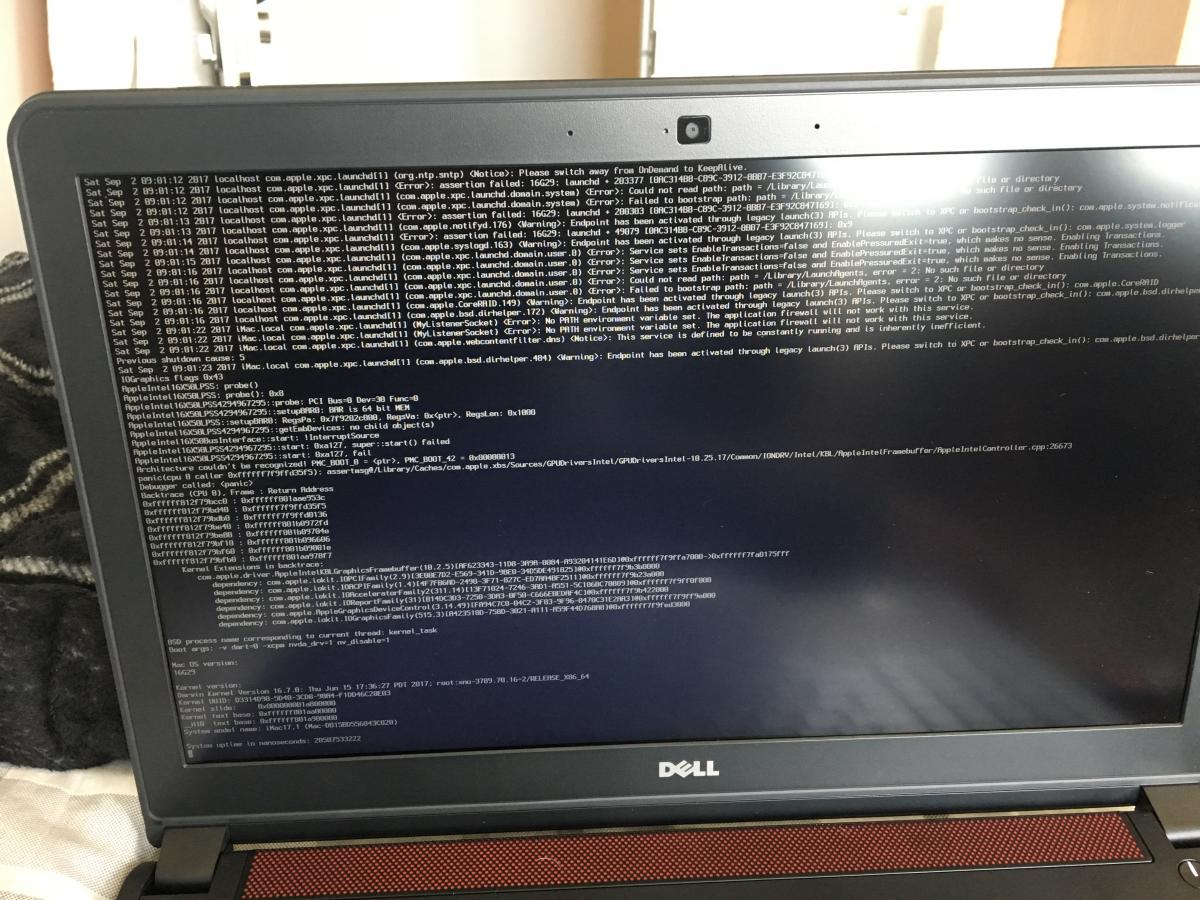

bravc Posted September 4, 2017 Share Posted September 4, 2017 Hello, I have been running into the same issue for some time now when trying to boot Mac OS 10.12.6. Attached is a picture of the crash. I have a good feeling it has to do with Kaby Lake graphics but I have attempted several fixes for those issues. Any help would be greatly apprecieted. Laptop Specs: i7-7700hq GTX 1050 4gb 8gb RAM 256gb SSD 1TB HDD https://www.amazon.com/dp/B06XFGF7SN/_encoding=UTF8?coliid=I3O4RRPKU6O7IV&colid=ZQNGLFFL9NTZ Link to comment https://www.insanelymac.com/forum/topic/326819-dell-inspiron-15-5577-kblgraphicsframebuffer-panic-on-boot/ Share on other sites More sharing options...
quangtrung.tran Posted October 10, 2017 Share Posted October 10, 2017 similar with my laptop but only 2GB of VRAM try this method boot with invailid platform id: 123465789 into system open config.plist with clover go Kernel and kext patches name: com.apple.driver.AppleIntelKBLGraphicsFramebuffer find: 00006002 00005001 replace: 00003001 00009000 Link to comment https://www.insanelymac.com/forum/topic/326819-dell-inspiron-15-5577-kblgraphicsframebuffer-panic-on-boot/#findComment-2512888 Share on other sites More sharing options...
