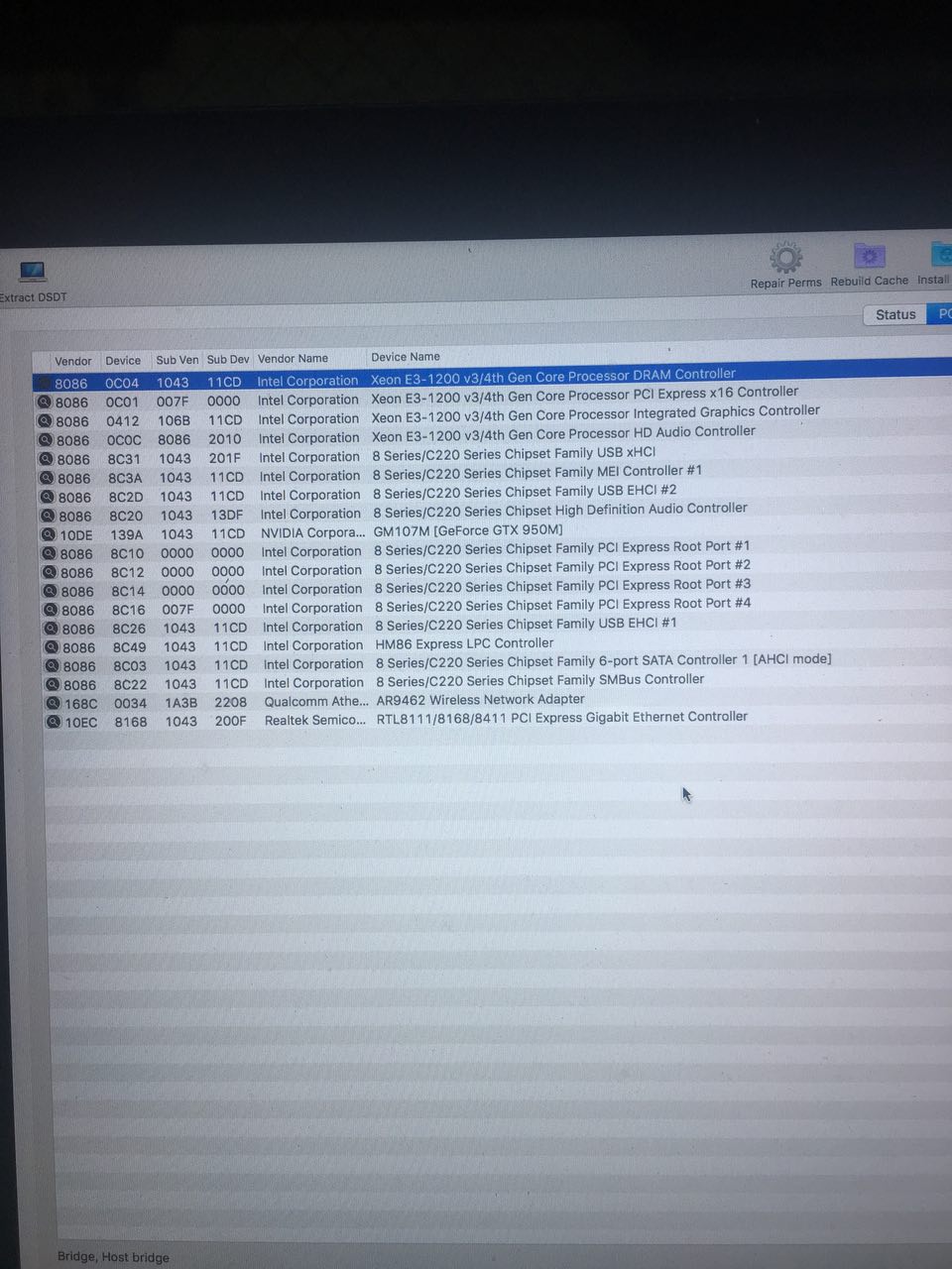

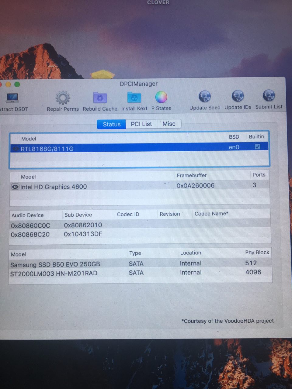

gengik84 Posted August 25, 2017 Share Posted August 25, 2017 Scarica DPCIManager.zip fai foto a status e PCI list, postale entrambe Link to comment https://www.insanelymac.com/forum/topic/326498-post-installazione-asus-n550jx/#findComment-2484829 Share on other sites More sharing options...
pista Posted August 25, 2017 Author Share Posted August 25, 2017 eccole qua!:-) Link to comment https://www.insanelymac.com/forum/topic/326498-post-installazione-asus-n550jx/#findComment-2484953 Share on other sites More sharing options...

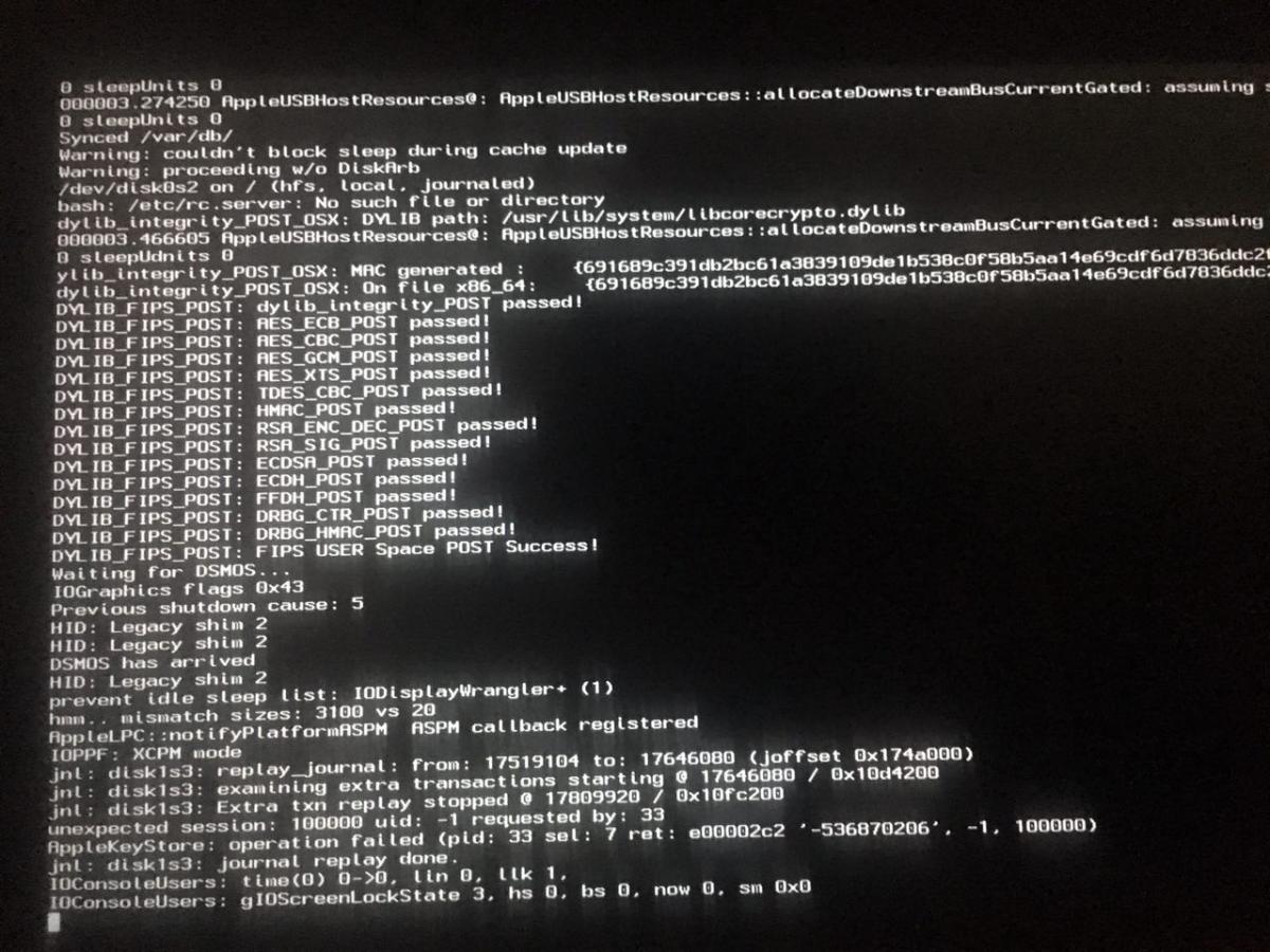

pista Posted August 26, 2017 Author Share Posted August 26, 2017 l'ho messa, ma al boot rimane così Link to comment https://www.insanelymac.com/forum/topic/326498-post-installazione-asus-n550jx/#findComment-2485154 Share on other sites More sharing options...
gengik84 Posted August 26, 2017 Share Posted August 26, 2017 Scarica questo kext e collocalo in EFI insieme al resto Link to comment https://www.insanelymac.com/forum/topic/326498-post-installazione-asus-n550jx/#findComment-2485156 Share on other sites More sharing options...

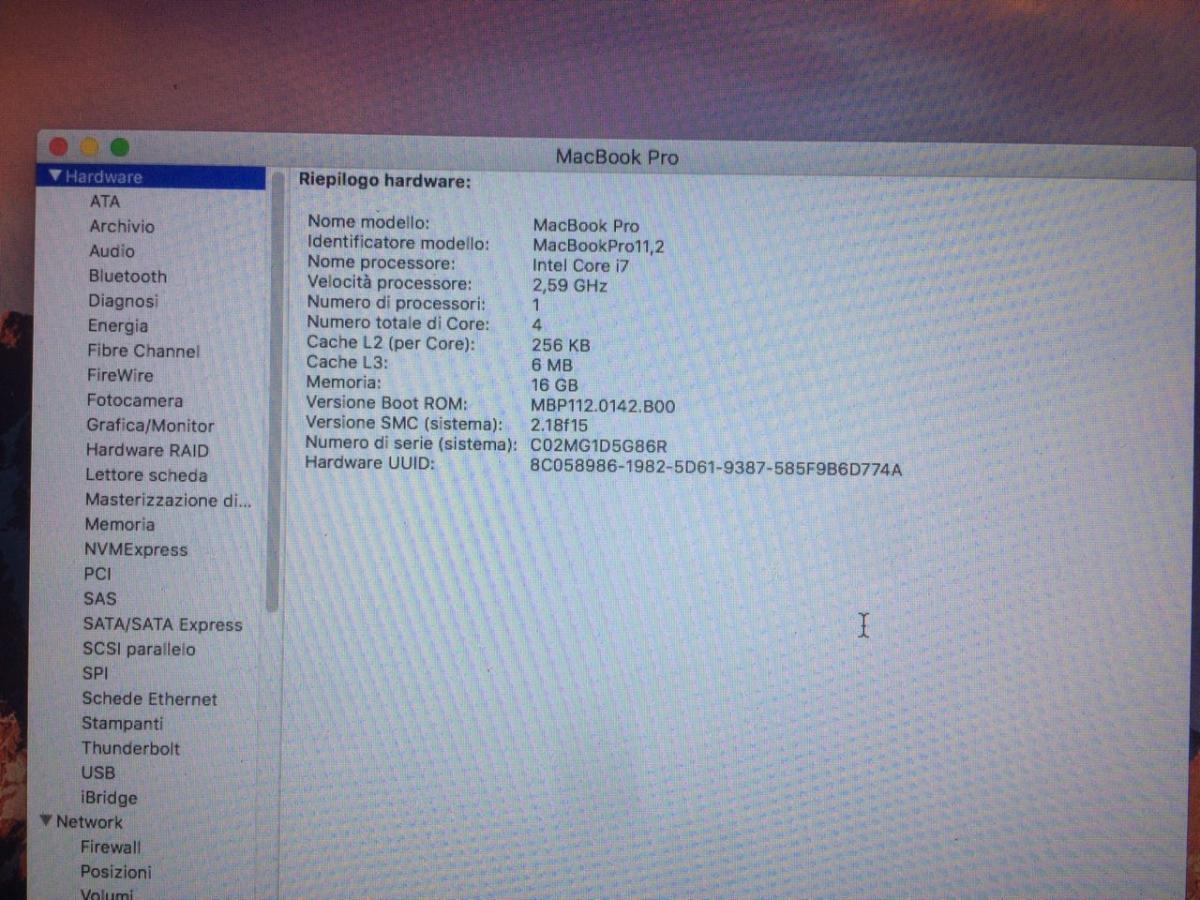

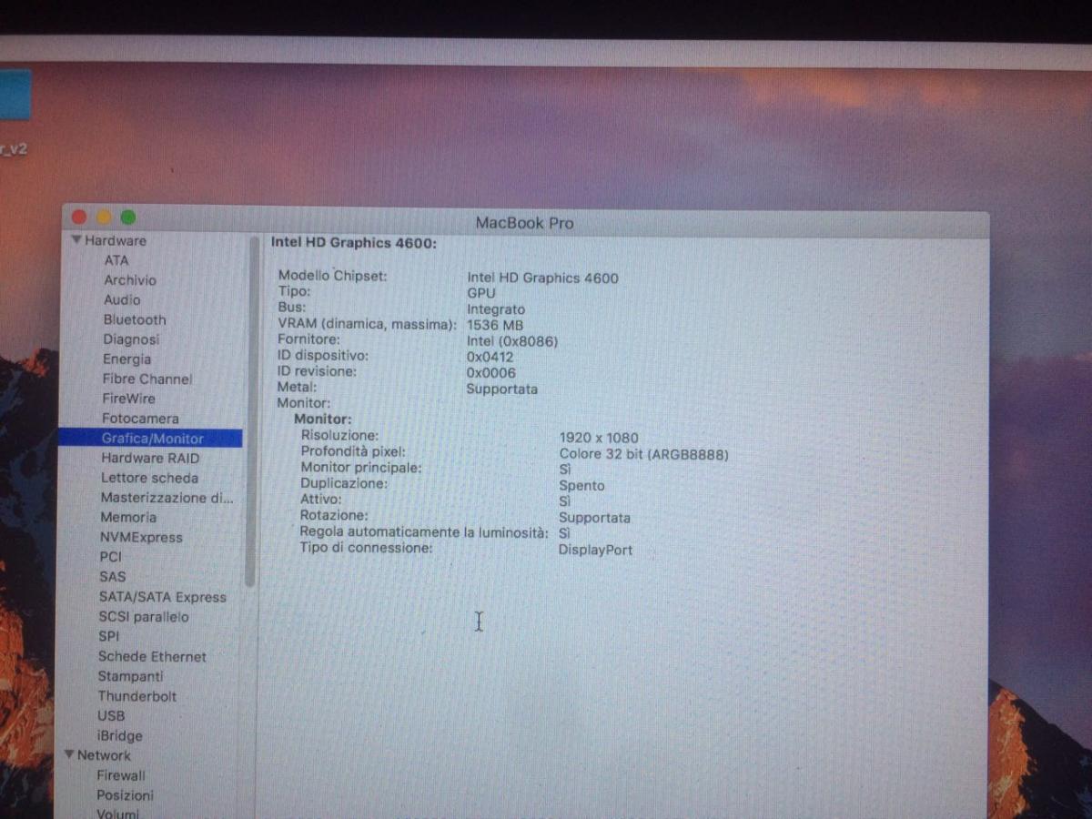

gengik84 Posted August 26, 2017 Share Posted August 26, 2017 Sostituisci...CLOVER 3.zip fai la foto a info di sistema Link to comment https://www.insanelymac.com/forum/topic/326498-post-installazione-asus-n550jx/#findComment-2485205 Share on other sites More sharing options...
pista Posted August 26, 2017 Author Share Posted August 26, 2017 l'ho messo e il problema si è risolto...grazie ancora.Ho notato un ultima cosa, il pc rileva la scheda audio ma l'audio non và,sai il motivo Link to comment https://www.insanelymac.com/forum/topic/326498-post-installazione-asus-n550jx/#findComment-2485291 Share on other sites More sharing options...

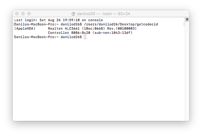

gengik84 Posted August 26, 2017 Share Posted August 26, 2017 Buono la Nvidia è disattivata... Per l'audio bisogna sapere il codec esatto, per caso mica hai installato o provato a configurarlo in qualche modo? Lancia il command allegato e posta il risultato getcodecid (Andy.V).zip Link to comment https://www.insanelymac.com/forum/topic/326498-post-installazione-asus-n550jx/#findComment-2485292 Share on other sites More sharing options...
pista Posted August 26, 2017 Author Share Posted August 26, 2017 no, non ho provato a fare nulla... Link to comment https://www.insanelymac.com/forum/topic/326498-post-installazione-asus-n550jx/#findComment-2485334 Share on other sites More sharing options...
gengik84 Posted August 26, 2017 Share Posted August 26, 2017 Ok... sul config, nella sezione Devices/Audio/inject trovi il numero 3 devi provare 20-27-28-29 uno alla volta, salvare la modifica al config, riavviare e controllare Link to comment https://www.insanelymac.com/forum/topic/326498-post-installazione-asus-n550jx/#findComment-2485336 Share on other sites More sharing options...
pista Posted August 26, 2017 Author Share Posted August 26, 2017 ho provato come hai detto tu e questi sono i risultati: Con il 29 casse no, cuffie si Con il 28 casse no, cuffie disturbato Con il 27 casse no, cuffie no Con il 20 non va Link to comment https://www.insanelymac.com/forum/topic/326498-post-installazione-asus-n550jx/#findComment-2485351 Share on other sites More sharing options...
