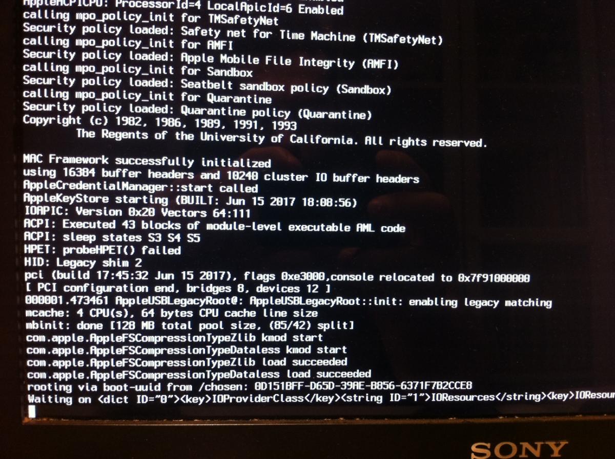

b31k Posted August 18, 2017 Share Posted August 18, 2017 (edited) Hello My system isAsus Z170-P Motherboardi5 6600K ProcessorNVIDIA GeForce GTX 1050 Ti 4095 MBBe-quiet 500W PSUCrucial 16 GB 2400 MHz DDR4BIOS:xHCI Handoff enableSerial Port disableSATA AHCI modeIOAPIC 24-119 Entries (enable y disable) two mode stuckI can not build a robust and stable system, The system Sierra is already installed but when I restart or shut down, I get the error Still waiting for root device error, but after too many reboot ( from 2 times to 9) start correctly or other times leave too minutes, with prohibited symbol and finally starts.Once started recognised correctly HDD. Also I tried with a new EVO860 nvme SSD , but I have the same problem. I dont know because sometimes yes sometimes no, the system stuck in this error I add some information files and logs. sudo touch /System/Library/Extensions && sudo kextcache -u / kext-dev-mode allowing invalid signature -67030 0xFFFFFFFFFFFEFA2A for kext HackrNVMeFamily-10_12_6.kext kext-dev-mode allowing invalid signature -67062 0xFFFFFFFFFFFEFA0A for kext FakeSMC.kext kext-dev-mode allowing invalid signature -67062 0xFFFFFFFFFFFEFA0A for kext BrcmPatchRAM2.kext kext-dev-mode allowing invalid signature -67062 0xFFFFFFFFFFFEFA0A for kext BrcmFirmwareRepo.kext thank you. Solution by Rehabman;Extracting my native/clean DSDT using Clover F4. and check with diff DSDT file. My SystemMemory addresses in DSDT are mismatched: SPEEDY-NUCatched rehabman$ diff ../origin/ ../patched/|grep SystemMemory < OperationRegion (GNVS, SystemMemory, 0xC74EC000, 0x06D5) > OperationRegion (GNVS, SystemMemory, 0xC74FE000, 0x06D5) < OperationRegion (CPSB, SystemMemory, 0xC6CC0F98, 0x10) > OperationRegion (CPSB, SystemMemory, 0xC6CD2F98, 0x10) and other mistake in OperationRegion(PNVA,SystemMemory,PNVB,PNVL) < Name (PNVB, 0xC74F1018) > Name(PNVB,0xC7503018) My system after too many month , keep stable the still waiting error no appear again, it seems that the problem was with the memory addresses in my DSDT. Edited May 26, 2018 by b31k Link to comment https://www.insanelymac.com/forum/topic/326312-solved-still-waiting-for-root-device-randomly/ Share on other sites More sharing options...
