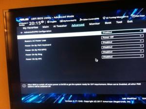

arsradu Posted July 23, 2017 Share Posted July 23, 2017 I just checked all the bios options but it does not exist, wake from USB keyboard only wake from LAN Have you checked all the options under the Advanced tab/menu? Especially those related to USB? Maybe "Platform Misc" too...? Whatever that is. Anyway, this is what I've got. And it works beautifully. I would say you should have this too. Or at least something similar. I'm kinda surprised, to be honest. I had higher hopes from Asus. Link to comment Share on other sites More sharing options...
b31k Posted July 23, 2017 Author Share Posted July 23, 2017 I test with; Erp: Enable s5 Enable s4+s5 Disable but still no wake from sleep Link to comment Share on other sites More sharing options...
arsradu Posted July 23, 2017 Share Posted July 23, 2017 I test with; Erp: Enable s5 Enable s4+s5 Disable but still no wake from sleep Well, I don't think that's the option you need... And I'm not aware of another method to accomplish the same thing. Link to comment Share on other sites More sharing options...
