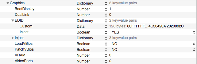

artur_pt Posted July 15, 2017 Share Posted July 15, 2017 hello try this 00FFFFFF FFFFFF00 0DAF9215 00000000 35130103 801D1078 0A07F59A 574E8726 1E505400 00000101 01010101 01010101 01010101 01014C1D 56CA5000 1D303C28 460058C1 10000018 000000FE 004E3135 3642362D 4C30420A 20200000 00FE0043 4D4F0A20 20202020 20202020 000000FE 004E3135 3642362D 4C30420A 2020002C in clover something like this good hack Link to comment https://www.insanelymac.com/forum/topic/325301-monitor-preferences-doesnt-open/#findComment-2463208 Share on other sites More sharing options...
