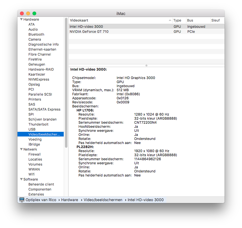

Just removed the HD 3000 patch from DSDT, set injectintel to true in config.plist without specifying fakeid and platformid, also works fine.
I did however rename GFX0 to IGPU and PEG0 to GFX0, but it worked fine with the default names too

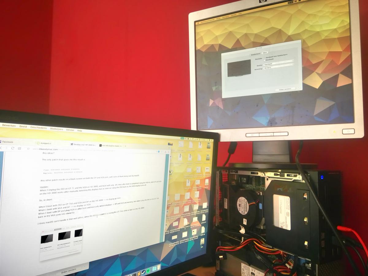

So regarding VGA I've made some progress. I am able to boot with both DP and VGA connected on the HD 3000 and DVI on the GT 710.
macOS is seeing all three displays, though the VGA goes in standby as soon as macOS is booted...
Any ideas?
The only patch that gives me this result is
Find: 02050000 00040000 07000000
Replace: 06020000 00040000 07000000
Any other patch results in a black screen on both the DP and VGA port, with none of them being seen by macOS
Update:
When I Unplug the DVI on GT 71 and the VGA on HD 3000, and boot with only  DP, then after boot is completed I plug the VGA in, both DP and VGA on the HD 3000 works after manually detecting the displays but as soon as I plug the DVI back in, the VGA display turns off.
So, in short:
When I boot with DVI on GT 710 and VGA and DP on the HD 3000 -> no display on VGA
When I boot with VGA and DP -> no display on VGA
When I boot with DP and plug VGA in after boot and manually detect displays -> DP and VGA are working, but when I plug the DVI on the GT 710 back in the VGA goes into stand-by
I think macOS can't handle it that well either, since the VGA is reported as being the GT 710, while in fact it is the HD 3000:
Update 2: DVI, DP and VGA are working as I speak, but I have no idea why  :hysterical:
I just woke the computer out of sleep and all three displays turned on...
Guest ricoc90
Okay so I've tested some more: I can boot with DVI on the GT 710, and both DP and VGA on the HD 3000. The VGA will go in standby as soon as macOS is booted.
When I log into macOS and put the computer in sleep and wake it up again, the VGA comes up too.
Does somebody have any idea why that is and more important: how i can fix it?

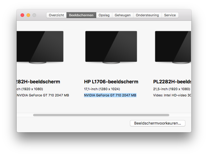

Changing the portnumbers doesn't make any difference. With the original portnumbers aswell as the portnumbers reported by IOReg, I'm able to use both DP and VGA simultaneously but I have some issues that I'm trying to figure out:
  1. VGA only works when after macOS is booted, I put my system into sleep and wake it up again
  2. After doing as described in 1. the VGA output works, but it looks like the VGA is preventing my system from going into sleep.
    The monitors connected to DVI (GT 710) and DP (HD 3000) will go in standby, but the monitor connected to VGA will stay active as well as the computer itself
  3. In About this Mac, the VGA is reported as being on the GT 710 instead of HD 3000. However, this might be just cosmetic

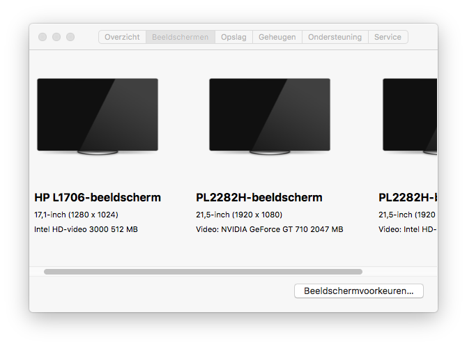

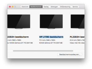

Note: I'm using the SMBios for imac13,1 because on macbookpo8,1 as well as macmini5,1 or imac12,1 my GT 710 is not working.
I've tried on macmini5,1 and imac12,1 without the GT 710 plugged in, but the result is the same (VGA only comes up after I put the system in sleep).
Also, SysProfiler reports it correctly, it's jus About This Mac -> Displays that reports the VGA as being on the GT 710:
