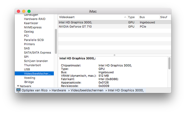

Guest ricoc90 Posted July 15, 2017 Share Posted July 15, 2017 Did you find solution for both display PCIe and HD 3000 ? I've made some steps. I am able to boot with the PCIe card still plugged in, both are seen by macOS but I only get a display on HD 3000. offtopic: don't mind the "," the buffer is one character longer than the string graphics glitches, you may want to try & patch the HD3000 kext to increase VRAM to, say, 1Go. Though 512Mo is usually sufficient. Details of the patch are available here. I am using the snb-platform-id for laptops I believe... 0x00010000. Works fine now without glitches. Still need to look at VGA though, but I'm that kind of guy that does 27 things at the same time Link to comment https://www.insanelymac.com/forum/topic/325283-desktop-intel-hd-3000-graphics/page/2/#findComment-2463250 Share on other sites More sharing options...
chris1111 Posted July 15, 2017 Share Posted July 15, 2017 I've made some steps. I am able to boot with the PCIe card still plugged in, both are seen by macOS but I only get a display on HD 3000. offtopic: don't mind the "," the buffer is one character longer than the string Schermafbeelding 2017-07-15 om 17.12.10.png I am using the snb-platform-id for laptops I believe... 0x00010000. Works fine now without glitches. Still need to look at VGA though, but I'm that kind of guy that does 27 things at the same time Please share your DSDT Patch for using both GPU thanks Link to comment https://www.insanelymac.com/forum/topic/325283-desktop-intel-hd-3000-graphics/page/2/#findComment-2463251 Share on other sites More sharing options...
Guest ricoc90 Posted July 15, 2017 Share Posted July 15, 2017 Please share your DSDT Patch for using both GPU thanks In BIOS enable multi display support. For now I only added the HD 3000 in DSDT: _SB/PCI0/GFX0: Method (_DSM, 4, NotSerialized) { If (LEqual (Arg2, Zero)) { Return (Buffer (One) { 0x03 }) } Return (Package (0x06) { "device-id", Buffer (0x04) { 0x26, 0x01, 0x00, 0x00 }, "model", Buffer (0x17) { "Intel HD Graphics 3000" }, "AAPL,snb-platform-id", Buffer (0x04) { 0x00, 0x00, 0x01, 0x00 } }) } You'll need to change the snb-platform-id to the one you are using. Then in config.plist I set Inject intel to false Link to comment https://www.insanelymac.com/forum/topic/325283-desktop-intel-hd-3000-graphics/page/2/#findComment-2463260 Share on other sites More sharing options...

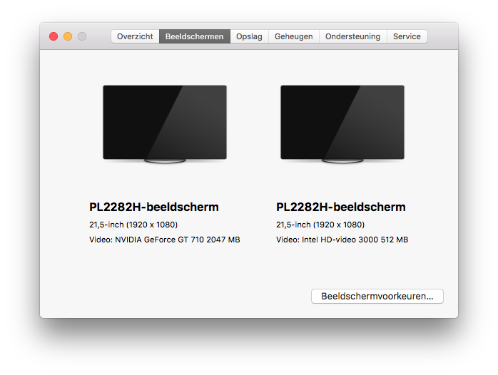

Guest ricoc90 Posted July 15, 2017 Share Posted July 15, 2017 You know what I not see because if you dont Connect the Graphics card PCIe the VIDEO options is disappears Now its ok the video is there in settings Both displays are working now So, rather than putting the info in config.plist, i placed them in my DSDT; set inject intel to false, enabled multiple displays in BIOS et voilà Link to comment https://www.insanelymac.com/forum/topic/325283-desktop-intel-hd-3000-graphics/page/2/#findComment-2463305 Share on other sites More sharing options...

Guest ricoc90 Posted July 15, 2017 Share Posted July 15, 2017 Both displays are not working here one in the display Port and other to the HDMI port to the 5450 HD Hmm... here they both work fine. DP and DVI on GT 710, but tried HDMI on GT 710 and that works too... I need to say that macOS picks my GT 710 as primary (I assume, since that's the one being reported in About this Mac): Link to comment https://www.insanelymac.com/forum/topic/325283-desktop-intel-hd-3000-graphics/page/2/#findComment-2463335 Share on other sites More sharing options...
