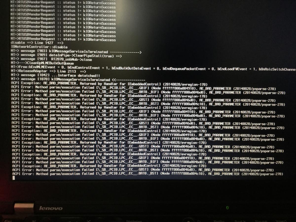

Sekkio Posted July 10, 2017 Author Share Posted July 10, 2017 -> Dump DSDT Start Pc, at Clover Menu, press F4, wait 10-15 sec, boot OSX You will find DSDT in EFI/Clover/ACPI/origin. Open with MaciASL https://sourceforge.net/projects/maciasl/ Compile, remove bugs, put compiled DSDT.aml in /EFI/CLOVER/ACPI/patched/ Extracting dsdt was a success, it showed no errors but many warnings. I used the newly created dsdt to boot up which was also successful. However, I installed the kext and rebooted and now I'm stuck on a loop in verbose mode. First it said appleintelsnbgraphicsFB failed to load, ACPI errors and MlmeDynamicTxrateswitchingagsv2 Looping.Extracting dsdt was a success, it showed no errors but many warnings. I used the newly created dsdt to boot up which was also successful. However, I installed the kext and rebooted and now I'm stuck on a loop in verbose mode. First it said appleintelsnbgraphicsFB failed to load, ACPI errors and MlmeDynamicTxrateswitchingagsv2 Looping.Pulled tp-link wifi adapter out And now the mlme dynamic error stopped.(Fixed by deleting appleintelsnbgraphicsFB.kext via single user mode) Now it only shows: Quote Link to comment https://www.insanelymac.com/forum/topic/325109-no-qeci-acceleration-in-intel-hd-3%CC%B60%CC%B60%CC%B60%CC%B6/#findComment-2459819 Share on other sites More sharing options...

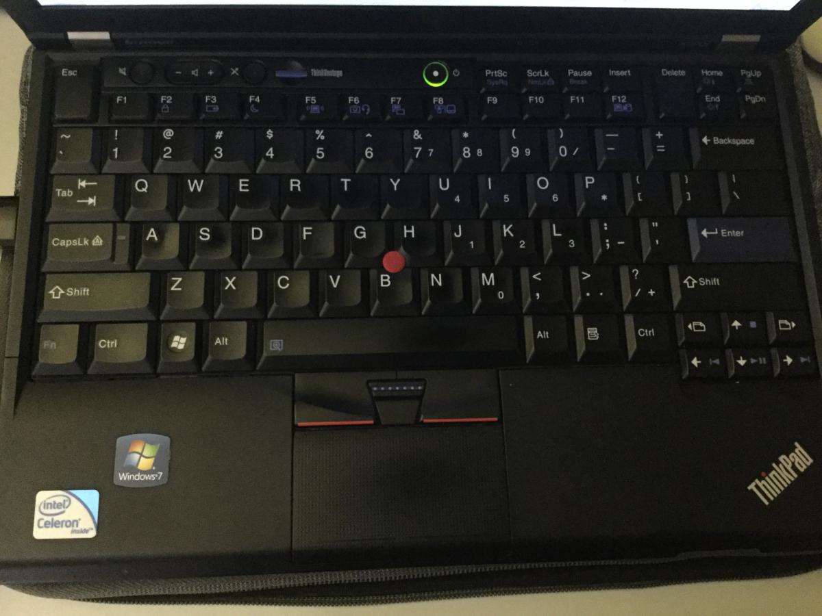

Sekkio Posted July 11, 2017 Author Share Posted July 11, 2017 Device ids are not injected in the way you've looked for. Why don't you post your zipped DSDT? By the way, Lenovo do not list the X220i with a Celeron CPU so maybe yours was a replacement... http://www.mediafire.com/file/h6qvnx6y36uj7xv/ltwbook_2013.pdf That's quite weird, there's a celeron sticker on my laptop. I don't know the history of my laptop as it originally belonged to a school which they had given for free-- my sibling got one for me. DSDT.aml.zip Quote Link to comment https://www.insanelymac.com/forum/topic/325109-no-qeci-acceleration-in-intel-hd-3%CC%B60%CC%B60%CC%B60%CC%B6/#findComment-2460616 Share on other sites More sharing options...
Sekkio Posted July 11, 2017 Author Share Posted July 11, 2017 Celeron-based X220i were apparently a small production for some specific markets: https://forum.thinkpads.com/viewtopic.php?p=677045 Hence, no reference to that model or Celeon-based motherboards on the Lenovo web site and maintenance manuals... I've checked your DSDT and there's nothing injected via a _DSM method under iGPU device VID @00020000. Anyway, no point wasting more time on this; there's no graphics support for that platform, sorry. Alright, I will be reverting back to the old dsdt with no qe/ci support, thank you for your help! Checked my laptop:http://pcsupport.lenovo.com/au/en/products/laptops-and-netbooks/thinkpad-x-series-laptops/thinkpad-x220/4290/4290em6/r9g6tyb It seems that my laptop is not Lenovo x220i but x220, well my sibling misinformed me... Quote Link to comment https://www.insanelymac.com/forum/topic/325109-no-qeci-acceleration-in-intel-hd-3%CC%B60%CC%B60%CC%B60%CC%B6/#findComment-2460632 Share on other sites More sharing options...
