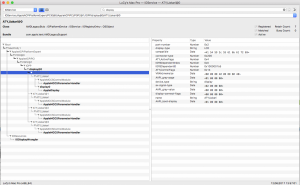

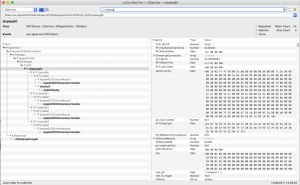

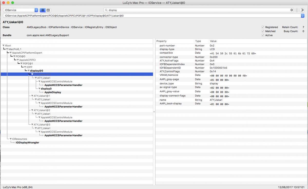

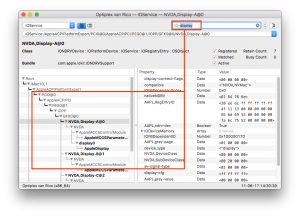

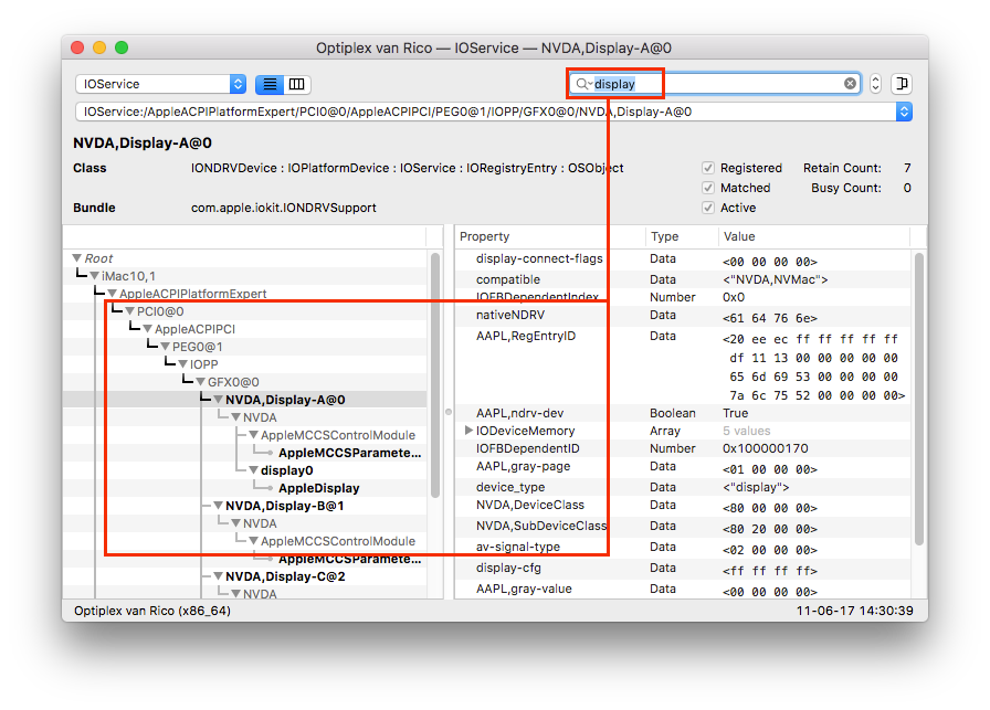

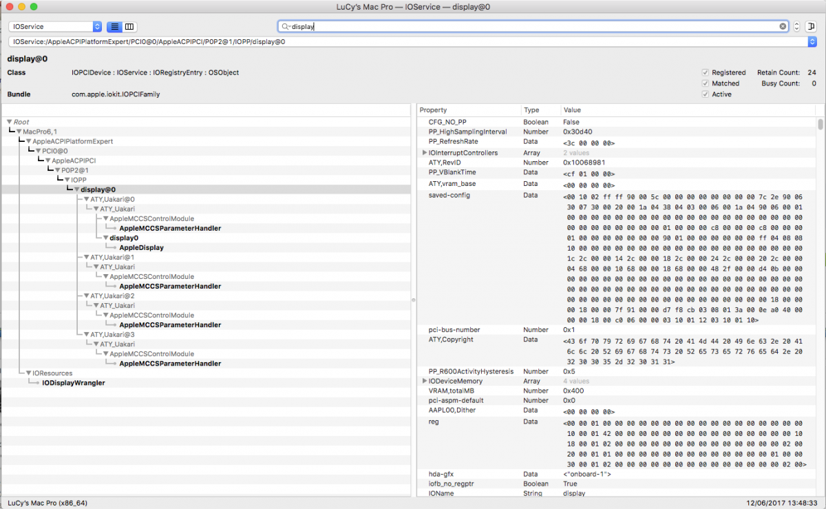

Guest ricoc90 Posted June 11, 2017 Share Posted June 11, 2017 I don't think it's your DSDT, but your motherboard. Someone reported that for non-apple AMD cards, you'll need a helper GPU. Your motherboard does not have one... That might be the reason why cedroxim's card IS working, because his mobo does have integrated graphics -- Could you run this app for me? While in it. search for "display" and tell me the location of your graphics card IORegistryExplorer 3.zip Link to comment https://www.insanelymac.com/forum/topic/324279-radeon-hd-5870/page/3/#findComment-2441835 Share on other sites More sharing options...
Lucy183 Posted June 12, 2017 Author Share Posted June 12, 2017 I don't think it's your DSDT, but your motherboard. Someone reported that for non-apple AMD cards, you'll need a helper GPU. Your motherboard does not have one... That might be the reason why cedroxim's card IS working, because his mobo does have integrated graphics -- Could you run this app for me? While in it. search for "display" and tell me the location of your graphics card Schermafbeelding 2017-06-11 om 14.31.04.png In Sierra not High Sierra right? Link to comment https://www.insanelymac.com/forum/topic/324279-radeon-hd-5870/page/3/#findComment-2442768 Share on other sites More sharing options...
