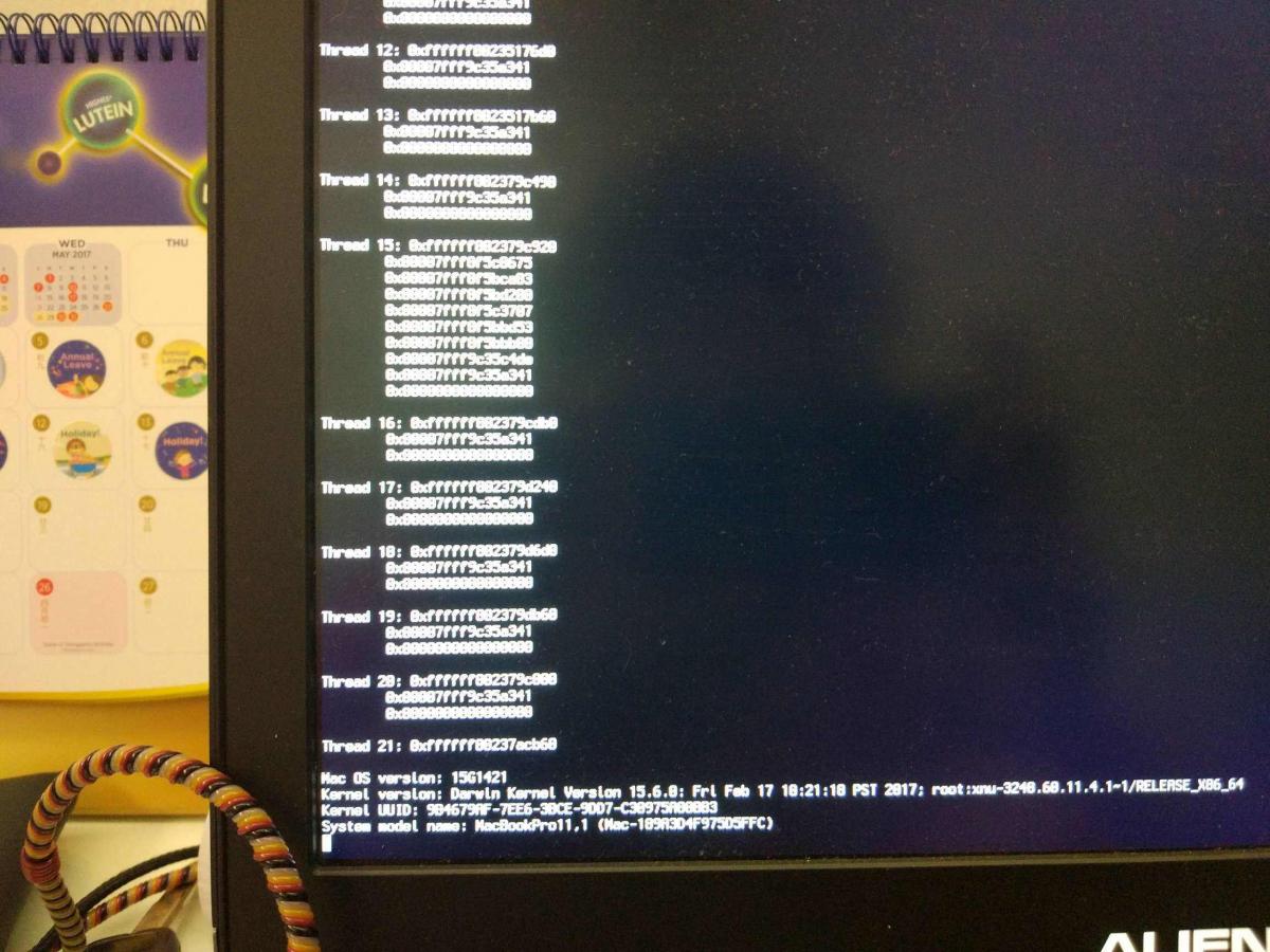

newlich Posted May 13, 2017 Author Share Posted May 13, 2017 Alienware laptops with Ivy Bridge CPUs and newer have TSCSync problem, trust me on this one Last night, I tested with VoodooTSCSync with IOCPUNumber=7, and it works perfectly! Four cores, 8 threads running up (confirmed with Activity Monitor). Today, I face booting problem, it shows a lot of "thread 1, thread 2, .... thread 21" then restart. So I keep trying, there is very rare chances able to boot into macOS, and all core running fluent. I tried remove and reinstall the VoodooTSCSync again (Kext Wizard), but it doesn't solve the issue. Any idea? Am I missing some steps for VoodooTSCSyncs? Link to comment Share on other sites More sharing options...
vusun123 Posted May 13, 2017 Share Posted May 13, 2017 Remove any patched dsdt and try again, also you have to create an SSDT for your CPU using Pike's ssdtPRGen Link to comment Share on other sites More sharing options...

newlich Posted May 13, 2017 Author Share Posted May 13, 2017 Remove any patched dsdt and try again, also you have to create an SSDT for your CPU using Pike's ssdtPRGen All DSDT/SSDT removed. Created new DSDT(removed error) and SSDT(ssdtPRGen). Still same problem as above. I managed to boot in a second time randomly, I use Kext Wizard to check loaded kext, and I saw VoodooTSCSync is running. If I boot in with CPUS=1, I see that VoodooTSCSync not loaded. Is that normal for CPUS=1? Or I'm having problem that VoodooTSCSync won't load during booting. post ur full clover folder here As requested. CLOVER attached. CLOVER.zip Link to comment Share on other sites More sharing options...
