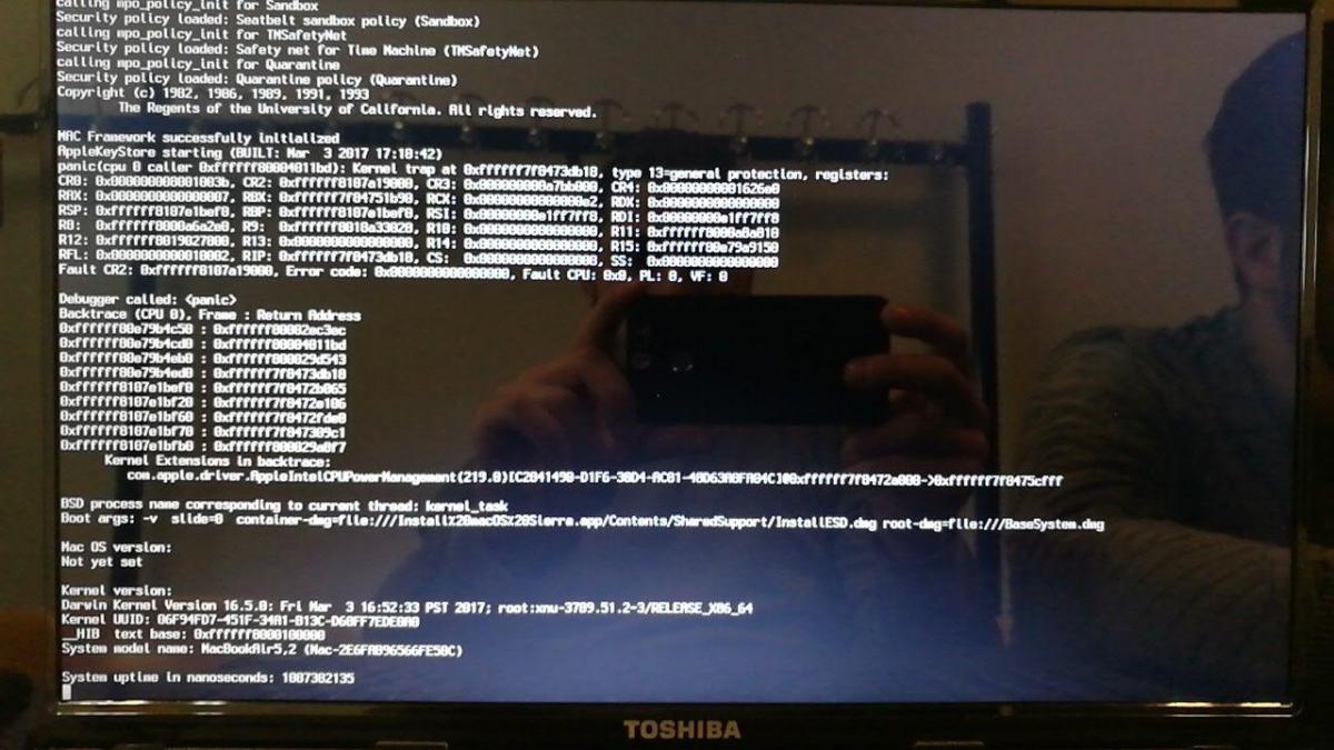

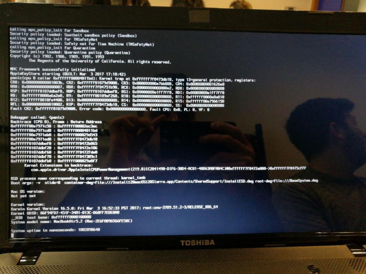

gengik84 Posted May 2, 2017 Share Posted May 2, 2017 avvia in verbose e posta la foto.. Link to comment https://www.insanelymac.com/forum/topic/323331-amd-radeon-hd-7610m-con-sierra/#findComment-2415911 Share on other sites More sharing options...
Spike32 Posted May 2, 2017 Author Share Posted May 2, 2017 Eccola Link to comment https://www.insanelymac.com/forum/topic/323331-amd-radeon-hd-7610m-con-sierra/#findComment-2415942 Share on other sites More sharing options...
gengik84 Posted May 2, 2017 Share Posted May 2, 2017 Seleziona Asus Aicpupm sul conifg, lo trovi nella sezione kernel ad kext patches Link to comment https://www.insanelymac.com/forum/topic/323331-amd-radeon-hd-7610m-con-sierra/#findComment-2415945 Share on other sites More sharing options...
Spike32 Posted May 2, 2017 Author Share Posted May 2, 2017 Resta sempre bloccato, ti rimando il verbose se serve. Link to comment https://www.insanelymac.com/forum/topic/323331-amd-radeon-hd-7610m-con-sierra/#findComment-2415947 Share on other sites More sharing options...

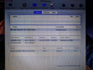

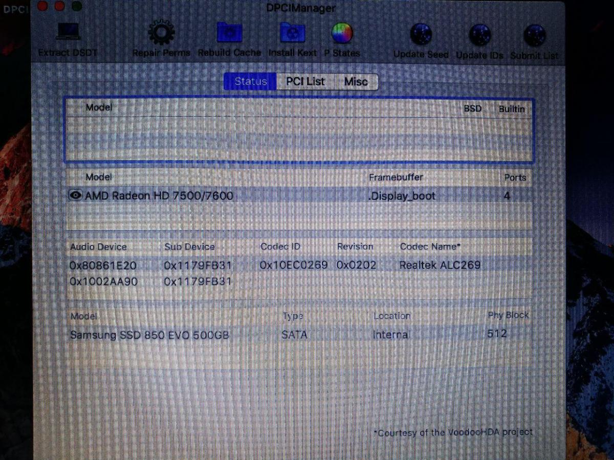

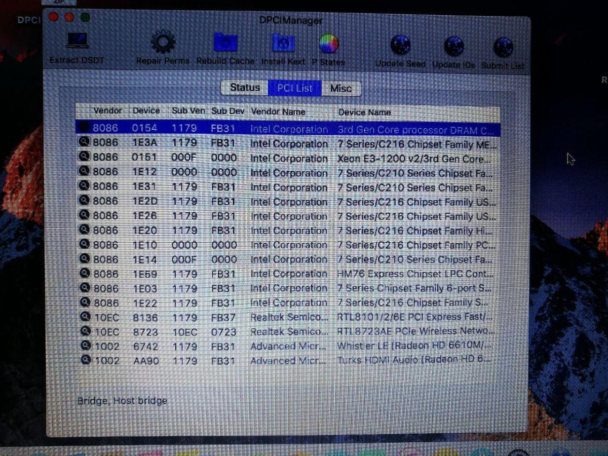

gengik84 Posted May 2, 2017 Share Posted May 2, 2017 Scarica DPCI Manager, fai una foto e postala alla parte status e pci list Link to comment https://www.insanelymac.com/forum/topic/323331-amd-radeon-hd-7610m-con-sierra/#findComment-2416241 Share on other sites More sharing options...
Spike32 Posted May 2, 2017 Author Share Posted May 2, 2017 Ecco quà. Link to comment https://www.insanelymac.com/forum/topic/323331-amd-radeon-hd-7610m-con-sierra/#findComment-2416250 Share on other sites More sharing options...
gengik84 Posted May 2, 2017 Share Posted May 2, 2017 vai in System/Library/Extensions Trova AMDRadeonX4000.kext e AMD7000Controller.kext Comprimili e postali entrambi Apri l'app allegata, poi clicca su file, salva il risultato e postalo IORegistryExplorer.zip Link to comment https://www.insanelymac.com/forum/topic/323331-amd-radeon-hd-7610m-con-sierra/#findComment-2416257 Share on other sites More sharing options...
