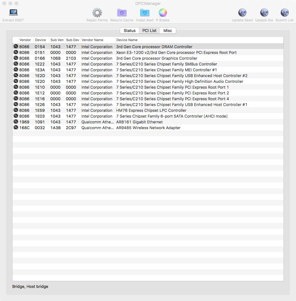

MaLd0n Posted May 2, 2017 Share Posted May 2, 2017 Use DPCIManager https://sourceforge.net/projects/dpcimanager/files/latest/download and post here screenshot PCI List 1 Link to comment https://www.insanelymac.com/forum/topic/323322-help-usb-30-port-work-in-20-speed-only/#findComment-2416248 Share on other sites More sharing options...
hunganh100494 Posted May 3, 2017 Author Share Posted May 3, 2017 Yeah I got it Link to comment https://www.insanelymac.com/forum/topic/323322-help-usb-30-port-work-in-20-speed-only/#findComment-2416601 Share on other sites More sharing options...
MaLd0n Posted May 3, 2017 Share Posted May 3, 2017 i dont see any usb3 Link to comment https://www.insanelymac.com/forum/topic/323322-help-usb-30-port-work-in-20-speed-only/#findComment-2416710 Share on other sites More sharing options...
