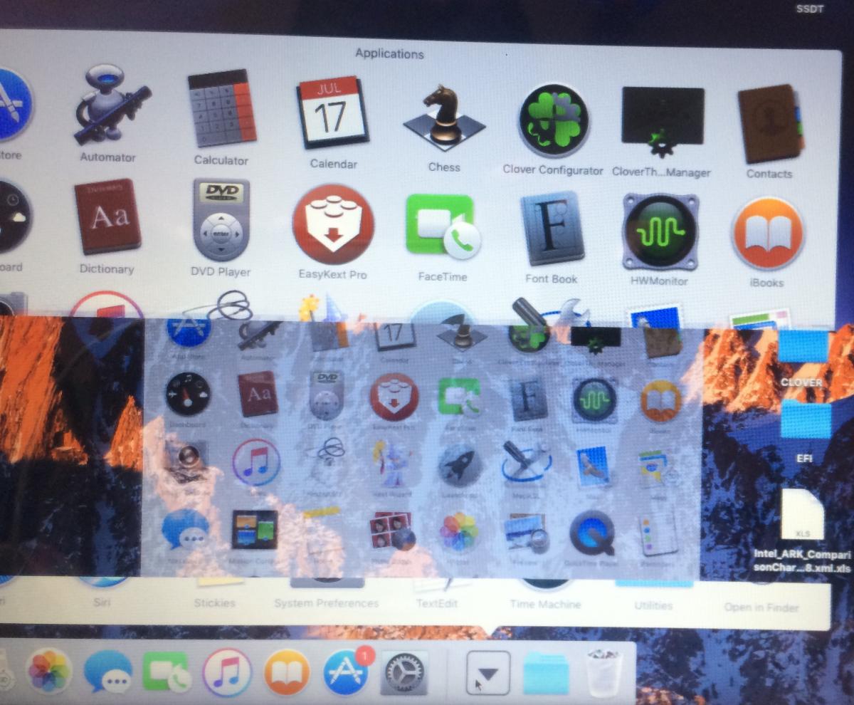

soumaxetuirk Posted April 9, 2017 Author Share Posted April 9, 2017 Battery work? After patching DSDT followed by previous post of NicoM4491.Battery is working after moving the kext to S/L/E. Only few glitches with dock animations. Link to comment https://www.insanelymac.com/forum/topic/322611-lenovo-ideapad-310-7th-gen-i5-intel-hd-620/#findComment-2401139 Share on other sites More sharing options...
MaLd0n Posted April 9, 2017 Share Posted April 9, 2017 I think the patch solve glitches Devices/AddProperties Device IntelGFX Key AAPL,GfxYTile Value 01000000 Value Type DATA By Piker Send me one ioreg Extract with IoregExplorer IORegistryExplorer 3.app.zip Link to comment https://www.insanelymac.com/forum/topic/322611-lenovo-ideapad-310-7th-gen-i5-intel-hd-620/#findComment-2401227 Share on other sites More sharing options...
soumaxetuirk Posted April 9, 2017 Author Share Posted April 9, 2017 I already tried this but same issue. Here is IOreg output. IOdevice.zip Link to comment https://www.insanelymac.com/forum/topic/322611-lenovo-ideapad-310-7th-gen-i5-intel-hd-620/#findComment-2401235 Share on other sites More sharing options...
MaLd0n Posted April 9, 2017 Share Posted April 9, 2017 Have a full patched in Devices Check here config.plist.zip use patch rename HECI to IMEI and GFX0 to IGPU Have in Acpi Section, just add Link to comment https://www.insanelymac.com/forum/topic/322611-lenovo-ideapad-310-7th-gen-i5-intel-hd-620/#findComment-2401236 Share on other sites More sharing options...

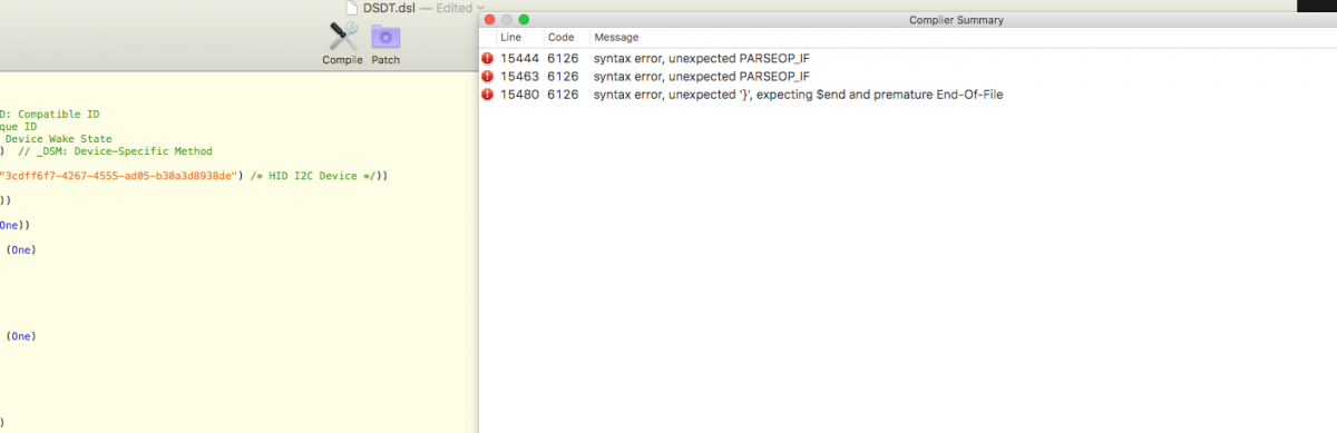

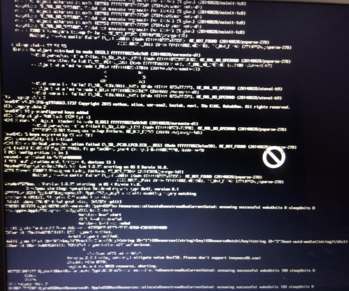

gulios Posted June 27, 2017 Share Posted June 27, 2017 Hi,spec:wifi: replaced to Broadcom BCM94352Z M.2 NGFFCPU: Kaby Lake i7-7500U Intel HD Graphics 620RAM: 8GBHDD: 512 GB SSD M.2I'm trying to install macOS 10.12.5 but i stucked at boot installer so i'm trying to patch DSDT first fromI've extracted(via clover F4) files without any problems but when i'm trying to compile DSDT via Macials it gives me errors(attachments) which i cannot fix ;( no matter which version i use.Second problem is that when i force installer to run my keyboard and trackpad did not work(config.plist+kext in attachments) and i don;t see my HDD M.2In the past i didn't have a problems with hack Maximus VII and Asus g551jx but now with that one i stucked on installer ;(Can you help me with this?Thank you Archive.zip ASUS-UX430.zip 1 Link to comment https://www.insanelymac.com/forum/topic/322611-lenovo-ideapad-310-7th-gen-i5-intel-hd-620/#findComment-2452538 Share on other sites More sharing options...
MaLd0n Posted June 27, 2017 Share Posted June 27, 2017 Hi, spec: wifi: replaced to Broadcom BCM94352Z M.2 NGFF CPU: Kaby Lake i7-7500U Intel HD Graphics 620 RAM: 8GB HDD: 512 GB SSD M.2 I'm trying to install macOS 10.12.5 but i stucked at boot installer so i'm trying to patch DSDT first from I've extracted(via clover F4) files without any problems but when i'm trying to compile DSDT via Macials it gives me errors(attachments) which i cannot fix ;( no matter which version i use. Second problem is that when i force installer to run my keyboard and trackpad did not work(config.plist+kext in attachments) and i don;t see my HDD M.2 In the past i didn't have a problems with hack Maximus VII and Asus g551jx but now with that one i stucked on installer ;( Can you help me with this? Thank you DSDT.gulios.zip Link to comment https://www.insanelymac.com/forum/topic/322611-lenovo-ideapad-310-7th-gen-i5-intel-hd-620/#findComment-2452554 Share on other sites More sharing options...
gulios Posted June 27, 2017 Share Posted June 27, 2017 Thx, but MaciASL doesn't want to open that file for editing ;( so i will not be able to patch it. 1 Link to comment https://www.insanelymac.com/forum/topic/322611-lenovo-ideapad-310-7th-gen-i5-intel-hd-620/#findComment-2452571 Share on other sites More sharing options...
MaLd0n Posted June 27, 2017 Share Posted June 27, 2017 use acpi6.1 https://bitbucket.org/RehabMan/os-x-maciasl-patchmatic/downloads/RehabMan-MaciASL-2016-0423.zip the DSDT is full patched, put in folder, reboot and test Link to comment https://www.insanelymac.com/forum/topic/322611-lenovo-ideapad-310-7th-gen-i5-intel-hd-620/#findComment-2452581 Share on other sites More sharing options...
gulios Posted June 27, 2017 Share Posted June 27, 2017 Ok, thank you i can edit it with newer version. I've passed througth installer and now trying to boot on HDD but again another strange issue"AppleLMUController::start Error: Could not get SMCProvider" ;( The newest FakeSMS is in kextx folder. 1 Link to comment https://www.insanelymac.com/forum/topic/322611-lenovo-ideapad-310-7th-gen-i5-intel-hd-620/#findComment-2452595 Share on other sites More sharing options...
