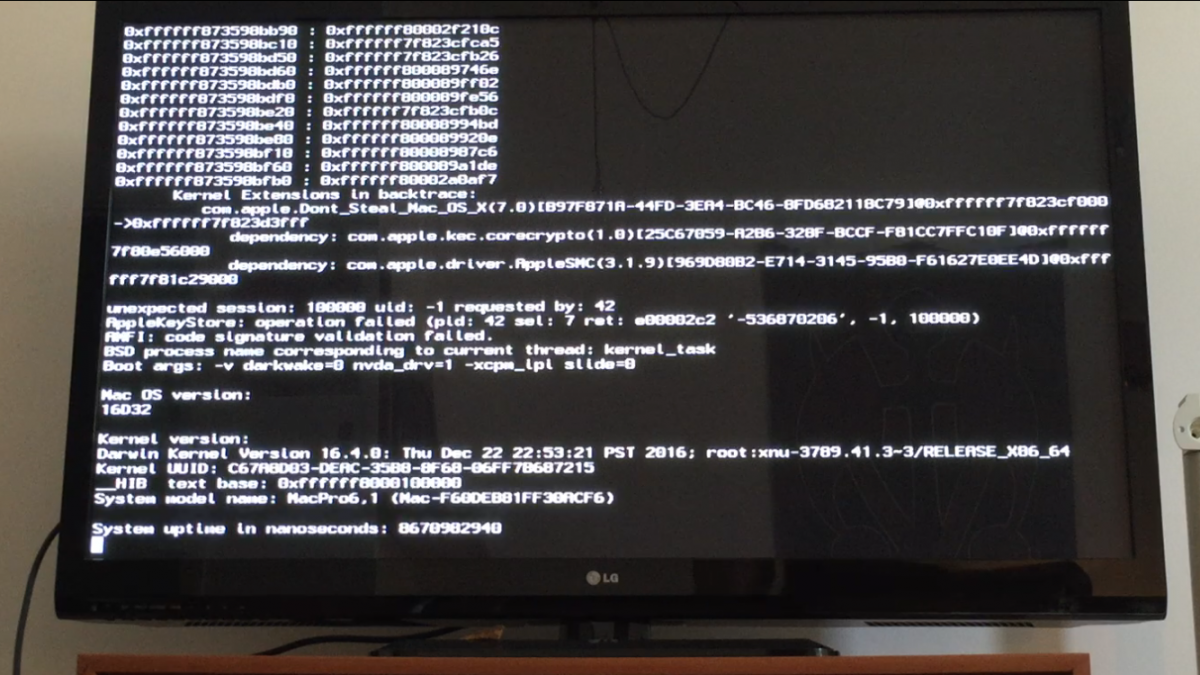

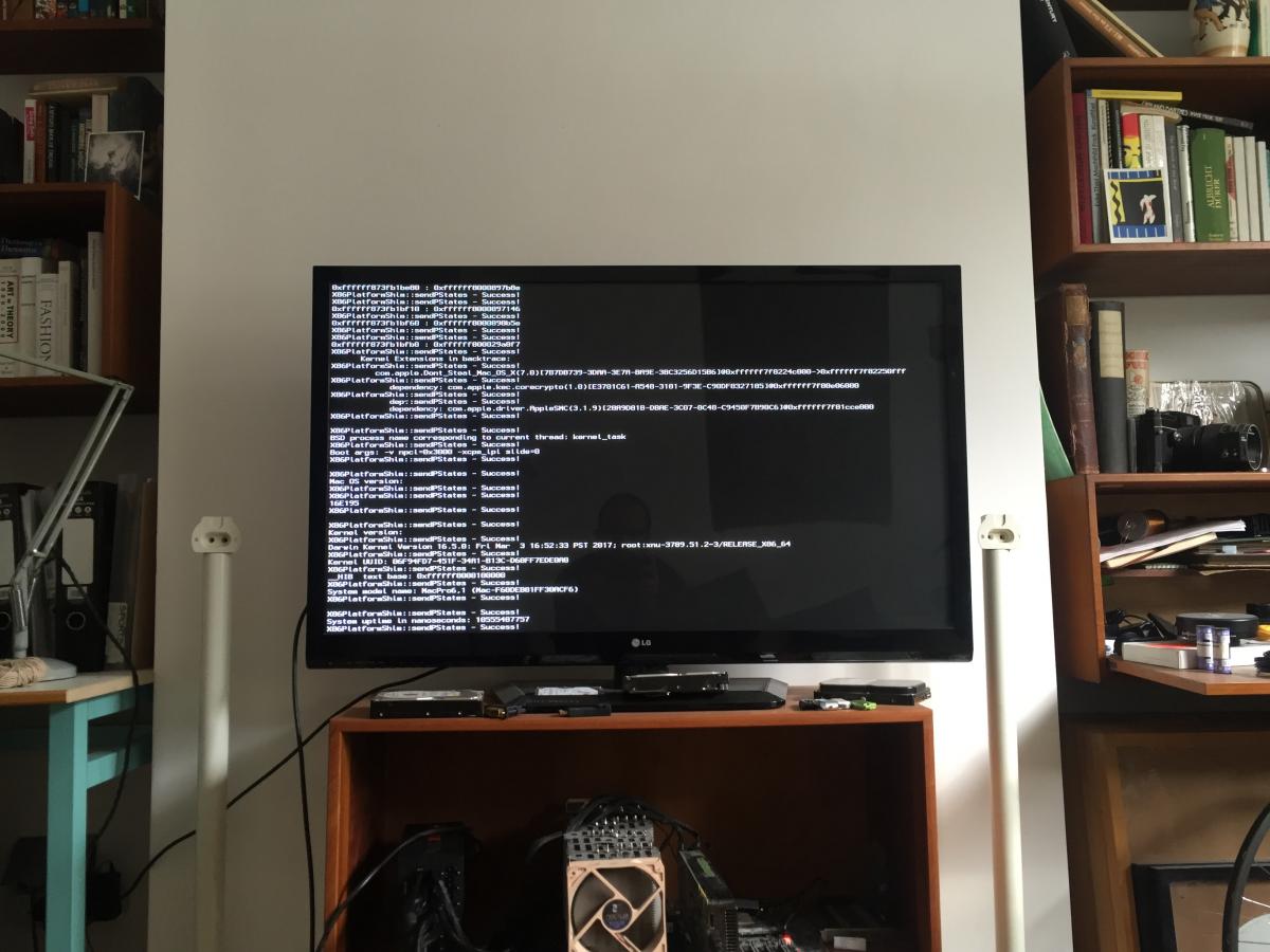

fluxus123 Posted March 27, 2017 Share Posted March 27, 2017 Hi peeps, I don't know what I've done to be honest, the last thing I did was installing an atheros card. Worked great once properly set up, but soon after, the machine developed kernel panics. 1 out of 10 times it would boot. Please see screenshots attached. What I've done to no avail: Reset bios to defaults Take out wifi card Tried last working dsdt and clover config Downloaded the latest fakeSMC Any help would be greatly appreciated Link to comment Share on other sites More sharing options...

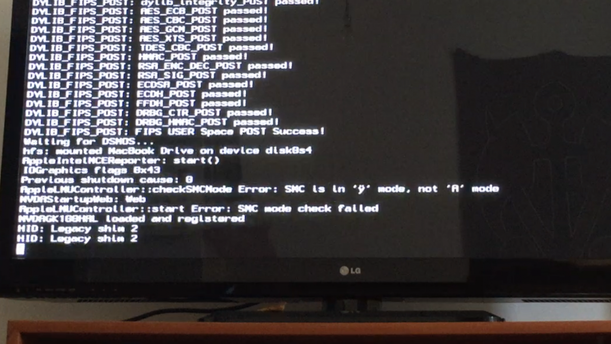

TheRacerMaster Posted March 27, 2017 Share Posted March 27, 2017 It has nothing to do with that, DSMOS.kext is probably failing to read OSK0/OSK1 (through AppleSMC) due to FakeSMC not working properly. 1 Link to comment Share on other sites More sharing options...
fluxus123 Posted March 28, 2017 Author Share Posted March 28, 2017 It boots fine from usb with the latest fakeSMC. After putting that into the ESP of my hard drive it booted fine 1st time around and then after that KPs again. The other thing I remember that started before developing KPs is this mystery: I turned hyper threading off in BIOS to see how it affects bench score and this caused half of my devices to disappear from DCPI manager and IOReg at least - 25 of them! After turning it back on, they all showed up again, but after the next restart they were all gone again. I don't know what's happening here, something seems to be really screwed? Link to comment Share on other sites More sharing options...
