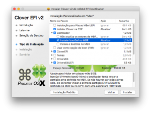

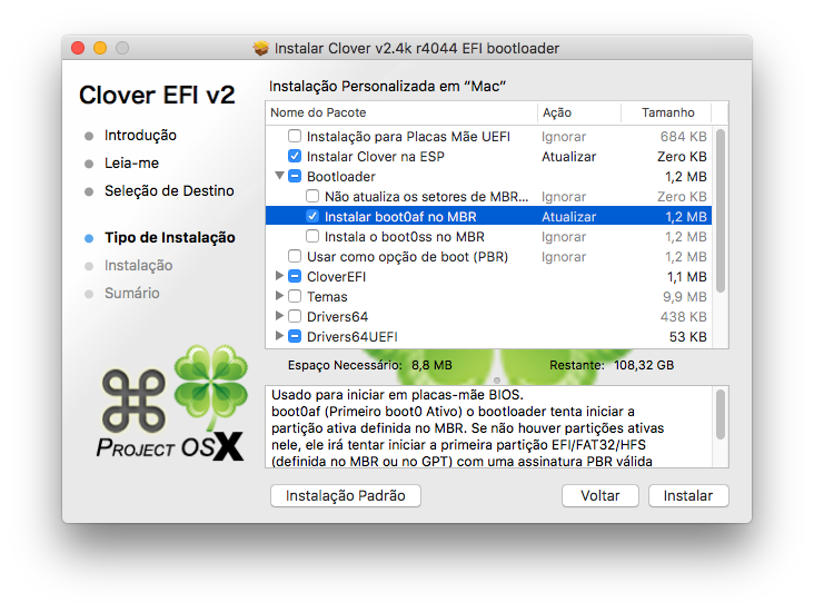

MaLd0n Posted March 25, 2017 Share Posted March 25, 2017 The mobos ASrock have sleep problem, many cases, need disable third party usb in bios(like ASmedia), but ur mobo dont have My sugestions use a fresh install, dont use any automatic installer for post installation Install Clover in UEFI mode and replace Clover folder or if u have problems with UEFI, use it or boot0ss and replace files U have all files now, just install and replace 1 Link to comment https://www.insanelymac.com/forum/topic/322136-clover-takes-about-1min-20-seconds-to-boot/page/2/#findComment-2391072 Share on other sites More sharing options...
