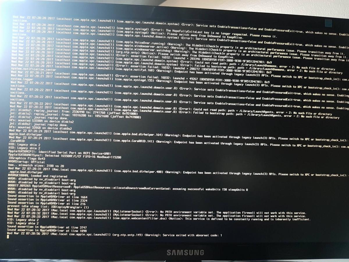

newguy2 Posted March 22, 2017 Author Share Posted March 22, 2017 use GT740 and disable intelgraphics in bios ur mobo is UEFI? update ur clover https://sourceforge.net/projects/cloverefiboot/files/Installer/ use it CLOVER.zip Used GT740, yes, motherboard support UEFI. Updated Clover, used your folder. Now booting barely starts, text is shown as on attached picture and after few seconds it restarts.. 1 Link to comment https://www.insanelymac.com/forum/topic/322094-msi-h81i-i7-4770-gt-740-cant-reach-installer/#findComment-2389400 Share on other sites More sharing options...

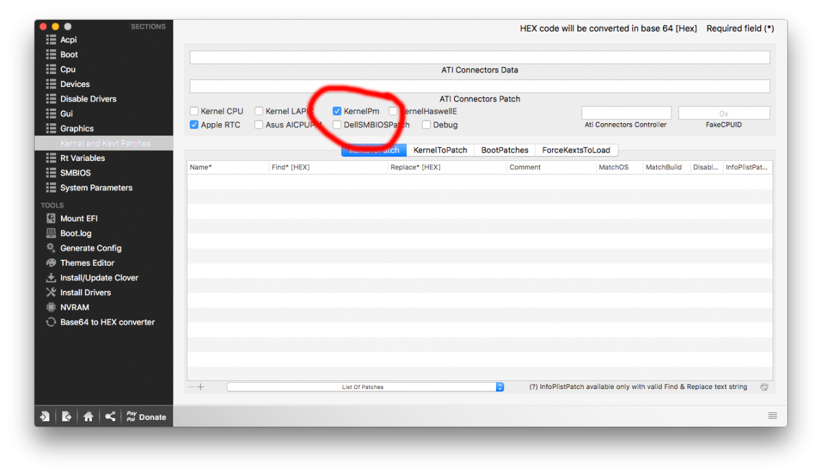

MaLd0n Posted March 22, 2017 Share Posted March 22, 2017 try a Kernel Pm Link to comment https://www.insanelymac.com/forum/topic/322094-msi-h81i-i7-4770-gt-740-cant-reach-installer/#findComment-2389410 Share on other sites More sharing options...
newguy2 Posted March 22, 2017 Author Share Posted March 22, 2017 try a Kernel Pm Do you mean this: http://www.insanelymac.com/forum/topic/302376-guide-patching-the-kernel-for-haswell-cpus-xcpm-early-reboot/? Can I use that tutorial for Sierra? 1 Link to comment https://www.insanelymac.com/forum/topic/322094-msi-h81i-i7-4770-gt-740-cant-reach-installer/#findComment-2389413 Share on other sites More sharing options...
MaLd0n Posted March 22, 2017 Share Posted March 22, 2017 Clover Link to comment https://www.insanelymac.com/forum/topic/322094-msi-h81i-i7-4770-gt-740-cant-reach-installer/#findComment-2389431 Share on other sites More sharing options...

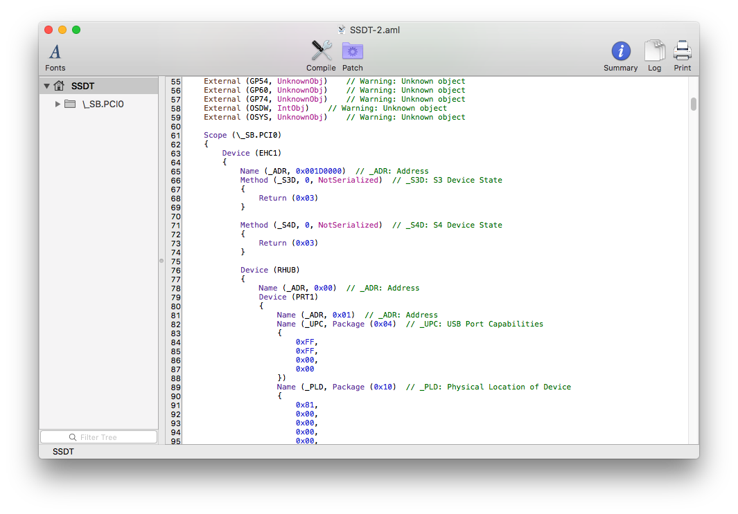

Allan Posted March 22, 2017 Share Posted March 22, 2017 USB 3.0 seems problematic, rarely recognises the device and transfer speed are terribly slow(less then few kb/s), often doesn't recognise. Tried fixing with FakePCIID.kext and FakePCIID_XHCIMux.kext, didn't help at all. Looking furtherer for solutions, need it working. Maybe you'll need to create SSDT-HACK for you. Do a research and you'll find some RehabMan's guides about that. 2 Link to comment https://www.insanelymac.com/forum/topic/322094-msi-h81i-i7-4770-gt-740-cant-reach-installer/#findComment-2389733 Share on other sites More sharing options...
MaLd0n Posted March 22, 2017 Share Posted March 22, 2017 replace full folder CLOVER.zip reboot send me new ioreg after reboot U have a RENESAS USB3 too I put GenericUSB, TRY Maybe you'll need to create SSDT-HACK for you. Do a research and you'll find some RehabMan's guides about that. dont need, just put into DSDT too 1 Link to comment https://www.insanelymac.com/forum/topic/322094-msi-h81i-i7-4770-gt-740-cant-reach-installer/#findComment-2389734 Share on other sites More sharing options...
Allan Posted March 23, 2017 Share Posted March 23, 2017 dont need, just put into DSDT too Nice! I took a look into the DSDT that you've modified for him, and, it's not necessary rename the EHCx to EH0x? 2 Link to comment https://www.insanelymac.com/forum/topic/322094-msi-h81i-i7-4770-gt-740-cant-reach-installer/#findComment-2389743 Share on other sites More sharing options...
MaLd0n Posted March 23, 2017 Share Posted March 23, 2017 look at ioreg and tables original apple This rename is only needed for usbinjectall(USB intel), but, if u like original, just edit kext third party 2 Link to comment https://www.insanelymac.com/forum/topic/322094-msi-h81i-i7-4770-gt-740-cant-reach-installer/#findComment-2389748 Share on other sites More sharing options...

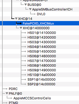

MaLd0n Posted March 23, 2017 Share Posted March 23, 2017 Replace two files in Clover/Acpi/Patched newguy2.zip remove FakePCIID_XHCIMux and FakePCIID and run it Olarila.command.zip Generate SSDT for power management with Pike work run it and save file and compile, if u can post here ssdtPRGen.command.zip New ioreg after reboot It's getting good https://github.com/Piker-Alpha?tab=repositories 1 Link to comment https://www.insanelymac.com/forum/topic/322094-msi-h81i-i7-4770-gt-740-cant-reach-installer/#findComment-2390022 Share on other sites More sharing options...
newguy2 Posted March 23, 2017 Author Share Posted March 23, 2017 Replace two files in Clover/Acpi/Patched newguy2.zip remove FakePCIID_XHCIMux and FakePCIID and run it Olarila.command.zip Generate SSDT for power management with Pike work run it and save file and compile, if u can post here ssdtPRGen.command.zip New ioreg after reboot It's getting good https://github.com/Piker-Alpha?tab=repositories Hey, thanks for prompt replies So I did what you said, replaces files, removed kexts, run your script. This is IOreg after all that: https://www.dropbox.com/s/nwu5egk0tfkdrwk/before_Adding.ioreg?dl=1 After, I created SSDT with Pike script, renamed ssdt.aml to SSDT-4.aml and added it to Clover/Apci/Patched. This is IOreg after doing that: https://www.dropbox.com/s/wf2vwswogpxwwzx/after_adding.ioreg?dl=1 ------- just a note that might help you: Before all this, I was able to boot with USB receiver for mouse and USB receiver for keyboard in USB3 ports. It all run normal and I was able to use keyboard and mouse. But if I plugged anything when already macOS booted, it didn't work. After doing all this, if I plug anything in USB3, boot is terribly slow and macOS restarts after some time just randomly. So I unplugged everything on USB3, now boots okay 1 Link to comment https://www.insanelymac.com/forum/topic/322094-msi-h81i-i7-4770-gt-740-cant-reach-installer/#findComment-2390402 Share on other sites More sharing options...
MaLd0n Posted March 23, 2017 Share Posted March 23, 2017 remove FakePCIID_XHCIMux and FakePCIID i see it in ioreg Check S/L/E and L/E too use it or usbinjectall, not both PM work now 1 Link to comment https://www.insanelymac.com/forum/topic/322094-msi-h81i-i7-4770-gt-740-cant-reach-installer/#findComment-2390451 Share on other sites More sharing options...

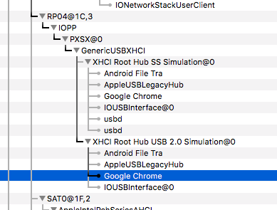

newguy2 Posted March 23, 2017 Author Share Posted March 23, 2017 Missed it in L/E. Removed and run your script again. Now it is gone from IOreg: https://www.dropbox.com/s/qd60dxhqpaqr50j/latest.ioreg?dl=1 USBInjectAll still here. But can't still get USB3 to work Great to see PM work! This motherboards seems great besides USB3 Link to comment https://www.insanelymac.com/forum/topic/322094-msi-h81i-i7-4770-gt-740-cant-reach-installer/#findComment-2390462 Share on other sites More sharing options...

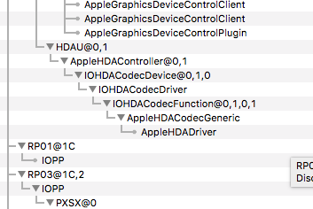

MaLd0n Posted March 23, 2017 Share Posted March 23, 2017 I apply HDMI audio too, if u can test... see generic usb, work dont appear in system profile but work ur mobo USB 3.0 • 2 x USB 3.0 ports by Intel® H81 (2 ports on the front panel) • 2 x USB 3.0 ports by RENESAS UPD720202 (2 ports on the back panel) Link to comment https://www.insanelymac.com/forum/topic/322094-msi-h81i-i7-4770-gt-740-cant-reach-installer/#findComment-2390472 Share on other sites More sharing options...

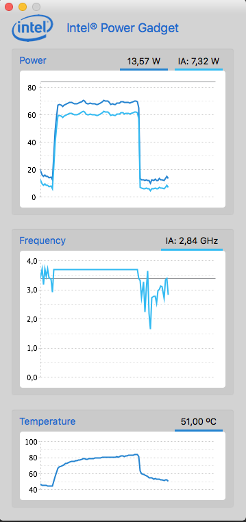

newguy2 Posted March 24, 2017 Author Share Posted March 24, 2017 You are right, it works at back panel perfectly! Front panel doesn't work, sometimes Hackintosh restarts when plugged in front panel, but never mind. There's one unused USB2.0 connector on mobo, it will access it if needed any other ports. Hackintosh works great. Been working whole evening at it without problems. Thank you so much! Done some benchmarking: https://browser.geekbench.com/v4/cpu/2167883 After Macbook Air 2014, this is really quick for me Attached Intel Power Gadget screen shot while testing CPU with Cinebench. Seems I will need to do some case modding to get CPU temperatures lower under load. (CPU states working can be seen as well) But will check what happens when rendering video, that's most intensive task I'd do on this PC. I will try to make an tutorial for this configuration since you helped me so much, so maybe I can help someone else 1 Link to comment https://www.insanelymac.com/forum/topic/322094-msi-h81i-i7-4770-gt-740-cant-reach-installer/#findComment-2390484 Share on other sites More sharing options...
MaLd0n Posted March 24, 2017 Share Posted March 24, 2017 the temps is very good, in strees test, it's good I did not settle for the usb Nice bench 4770 Link to comment https://www.insanelymac.com/forum/topic/322094-msi-h81i-i7-4770-gt-740-cant-reach-installer/#findComment-2390490 Share on other sites More sharing options...

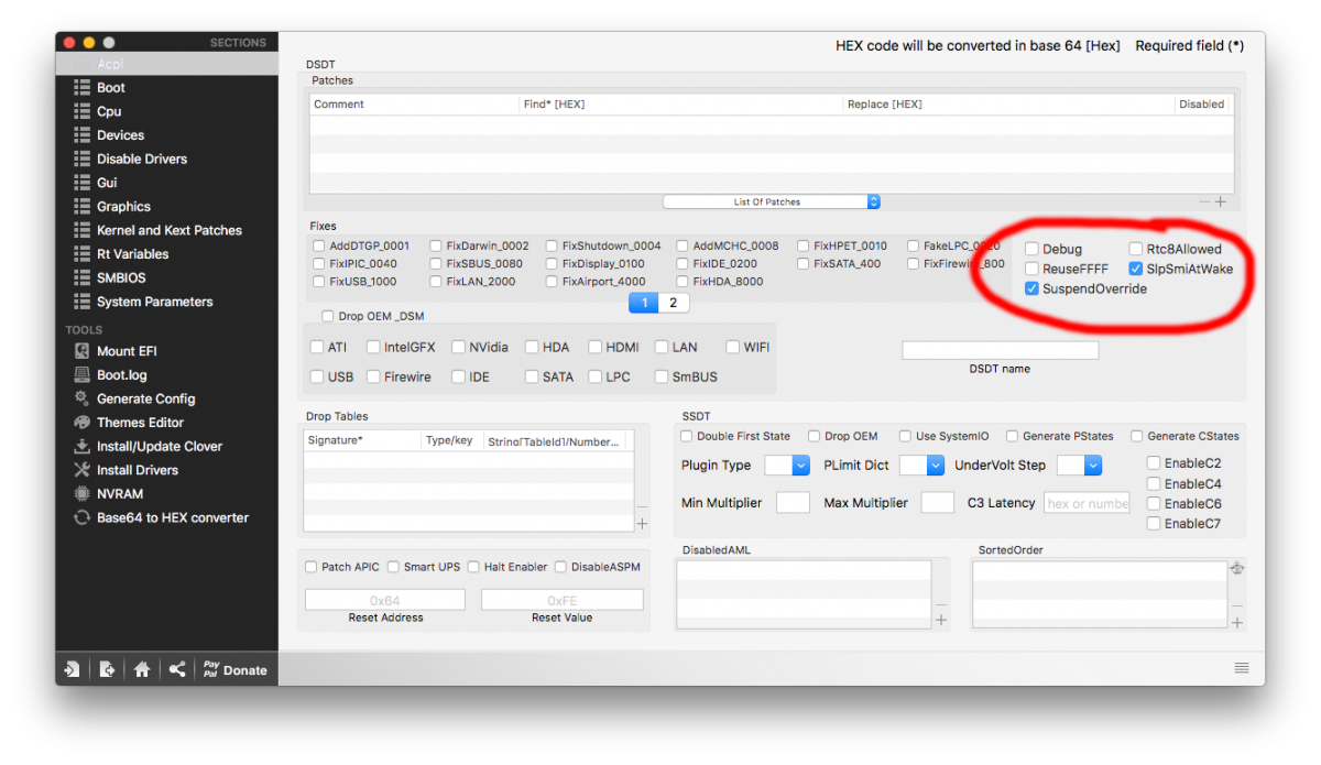

newguy2 Posted March 24, 2017 Author Share Posted March 24, 2017 aah don't worry, you helped me a bunch! Now can't spend any more days trying to make all USB ports work, got a lot of work to do on new Hackintosh but if that really bothers you, I will try your suggestions Last evening, I put it to sleep and this morning is off. I turn it on, clover opens as usual, I go to my Sierra installation disk and..nothing happens. There is just a dash at top left edge of screen and it stays that way. Restarted, tried few times, same thing happens. Then tried to boot from recovery HD, it loaded. Then I restarted and gone to Sierra installation again - and now it works. Is it maybe 4+ hours sleeps problem(I seen it somewhere).. 1 Link to comment https://www.insanelymac.com/forum/topic/322094-msi-h81i-i7-4770-gt-740-cant-reach-installer/#findComment-2390553 Share on other sites More sharing options...
MaLd0n Posted March 24, 2017 Share Posted March 24, 2017 try a SlpSmiAtWake, It adds SLP_SMI_EN=0 at every wake. It may help solve sleep and shutdown issues on UEFI boot. open Clover Configurator or other program if u like and go to Acpi Section 1 Link to comment https://www.insanelymac.com/forum/topic/322094-msi-h81i-i7-4770-gt-740-cant-reach-installer/#findComment-2390657 Share on other sites More sharing options...
