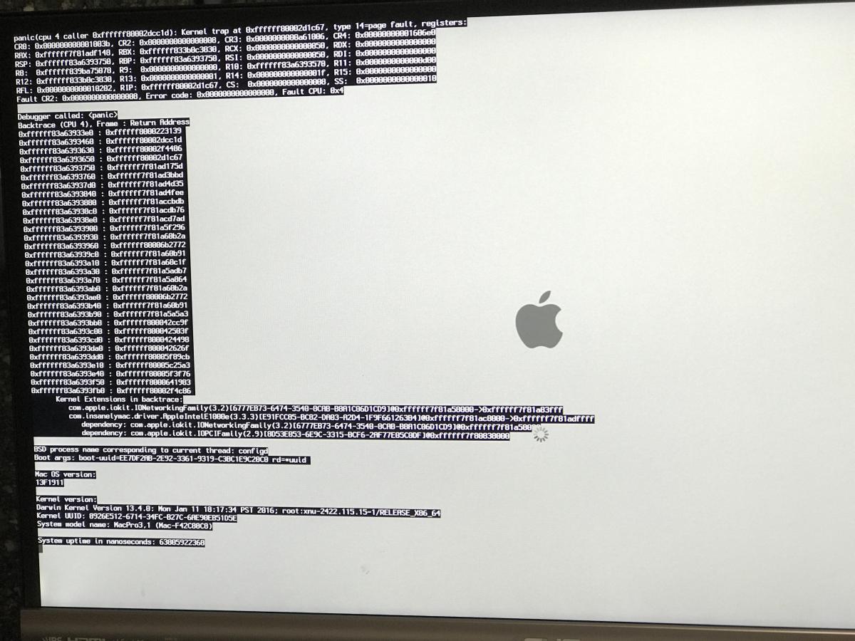

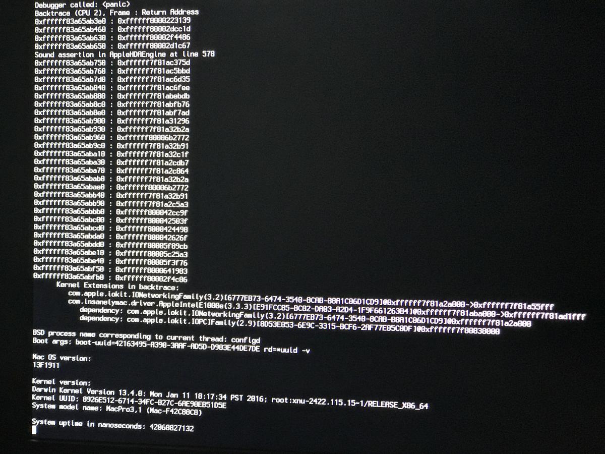

srmusico Posted March 2, 2017 Share Posted March 2, 2017 Hi, im leaving Mavericks in my Hackintosh to Sierra. I have toons of plugins and all my music apps stable and working. I want to get this SSD cloned to my other HD. I have tried Carboon Copy Cloner and SuperDuper! But with both programs isn't botable and both copies with the same problem. After of cloning i tried to start the bootloader (I have chimera in this Mavericks) Then tried to start. No Chimera, so i reintalled. Then again i tried to start. At this time, chimera boot and i can select this new clone HD. In normal mode, the Apple logo appear and then crash with this reports: (Image 1 Attached) In verboose mode, the same with this report: (Image 2 Attached) What can i do to get it botable ? Thanks guys!! Link to comment https://www.insanelymac.com/forum/topic/321573-clone-mavericks-ssd-for-backup-notable-hackintosh/ Share on other sites More sharing options...
0000-1248 Posted March 2, 2017 Share Posted March 2, 2017 IONetworkingFamily.kext is the problem. This is most likely due to modified kexts which cause a kernel panic. Replace it with the vanilla one and you should be fine. If it is the vanilla one, replace it with the correct kext for your Ethernet card. Best regards, - Matt Link to comment https://www.insanelymac.com/forum/topic/321573-clone-mavericks-ssd-for-backup-notable-hackintosh/#findComment-2376794 Share on other sites More sharing options...
