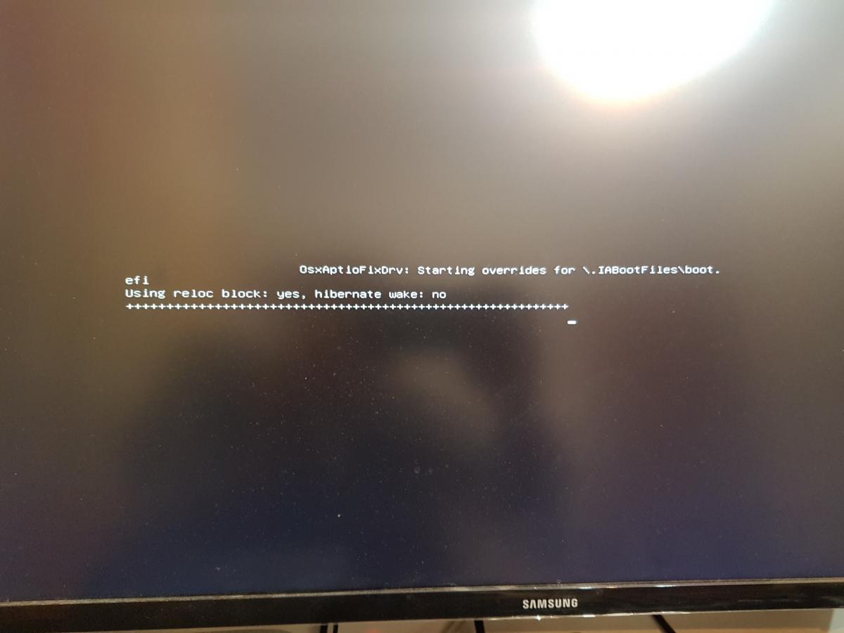

cobra118 Posted March 9, 2017 Author Share Posted March 9, 2017 Si blocca qui Link to comment https://www.insanelymac.com/forum/topic/321561-nuova-installazione-su-z270/#findComment-2381333 Share on other sites More sharing options...
gengik84 Posted March 9, 2017 Share Posted March 9, 2017 Posta la efi... come già detto... Link to comment https://www.insanelymac.com/forum/topic/321561-nuova-installazione-su-z270/#findComment-2381336 Share on other sites More sharing options...

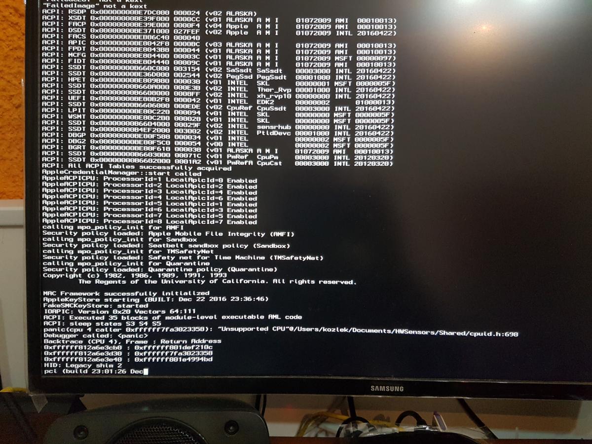

cobra118 Posted March 9, 2017 Author Share Posted March 9, 2017 Piccolo passo avanti ma si blocca Link to comment https://www.insanelymac.com/forum/topic/321561-nuova-installazione-su-z270/#findComment-2381363 Share on other sites More sharing options...
gengik84 Posted March 9, 2017 Share Posted March 9, 2017 Prova il config allegato config.plist.zip Link to comment https://www.insanelymac.com/forum/topic/321561-nuova-installazione-su-z270/#findComment-2381366 Share on other sites More sharing options...

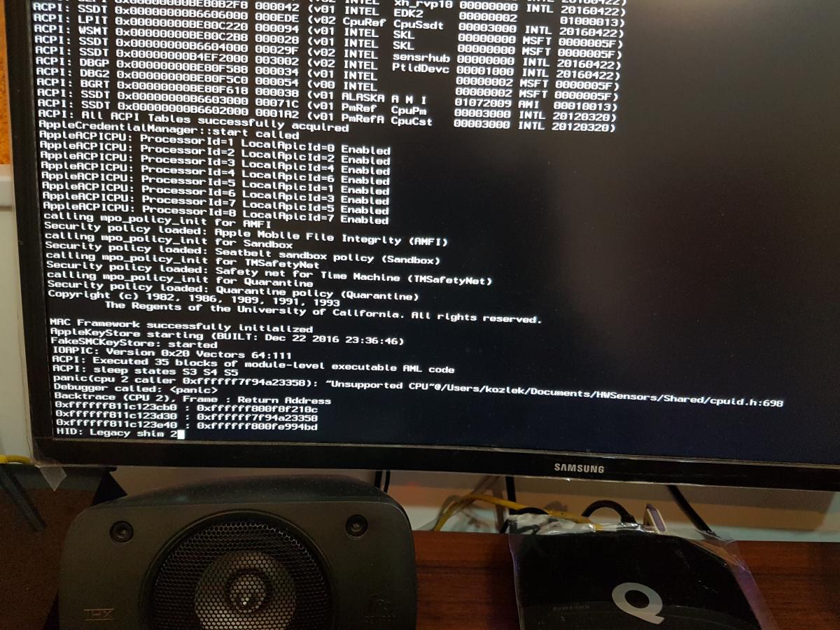

cobra118 Posted March 9, 2017 Author Share Posted March 9, 2017 Nulla Devo settare qualcosa nel BIOS? Link to comment https://www.insanelymac.com/forum/topic/321561-nuova-installazione-su-z270/#findComment-2381403 Share on other sites More sharing options...
gengik84 Posted March 9, 2017 Share Posted March 9, 2017 Prova sostituisci Fake con quello allegato come Cpu hai un I7 6700k? Poi certo che il bios devi impostarlo a modo.. sia per grafica integrata ecc... Aggiungi anche questo kext nella EFI e l'altro allegato FakeSMC.kext.zip AHCIPortInjector+200.kext.zip Link to comment https://www.insanelymac.com/forum/topic/321561-nuova-installazione-su-z270/#findComment-2381412 Share on other sites More sharing options...
fasullo Posted March 10, 2017 Share Posted March 10, 2017 Questo potrebbe aiutarti: SATA MODE : AHCI EHCI HANDOFF : Enabled xHCI HANDOFF : Enabled HPET : Enabled HPET Mode : 64 Bit OS Type : Other OS Link to comment https://www.insanelymac.com/forum/topic/321561-nuova-installazione-su-z270/#findComment-2381685 Share on other sites More sharing options...
cobra118 Posted March 10, 2017 Author Share Posted March 10, 2017 Sul BIOS ho trovato solo il 1 e 6 punto è sono settati bene Ho messo i kext allegato in clover/10.12 ma no n va Link to comment https://www.insanelymac.com/forum/topic/321561-nuova-installazione-su-z270/#findComment-2381696 Share on other sites More sharing options...
fasullo Posted March 10, 2017 Share Posted March 10, 2017 Stai provando in modalita legacy? Prova a vedere con se va avanti inserendo cpus=1 Link to comment https://www.insanelymac.com/forum/topic/321561-nuova-installazione-su-z270/#findComment-2381717 Share on other sites More sharing options...
Jolly Posted March 10, 2017 Share Posted March 10, 2017 Durante le installazioni è meglio evitare i kext sensor, usa il solo fakesmc, tutto il resto si risolve dopo Link to comment https://www.insanelymac.com/forum/topic/321561-nuova-installazione-su-z270/#findComment-2381732 Share on other sites More sharing options...
gengik84 Posted March 10, 2017 Share Posted March 10, 2017 Fake che sta usando è senza sensor, ed ultima versione... Usare una CPU skylake su una mobo Kabylake non è una buona regola... avevo anche chiesto se alle volte la firma era sbagliata ma non ho avuto risposta... Link to comment https://www.insanelymac.com/forum/topic/321561-nuova-installazione-su-z270/#findComment-2381738 Share on other sites More sharing options...

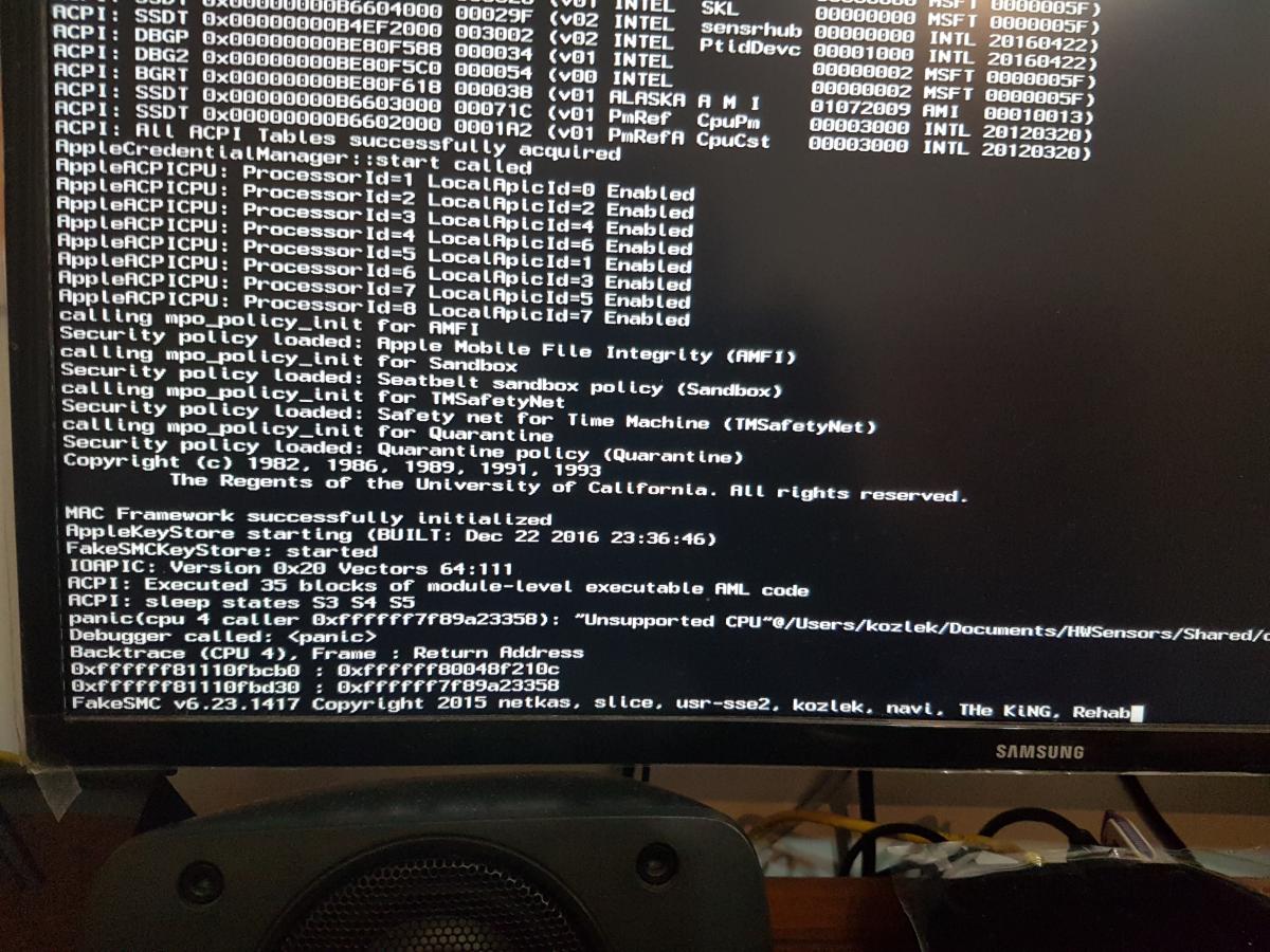

cobra118 Posted March 10, 2017 Author Share Posted March 10, 2017 Scusa gengik84 se non ho risposto, si ho i7 6700k Ho provato con cpus=1 e non va nemmeno Sono in modalità legacy all'interno della scheda madre per ora mi sono acconto che ho installato clover uefi. potrebbe centrare? Link to comment https://www.insanelymac.com/forum/topic/321561-nuova-installazione-su-z270/#findComment-2381789 Share on other sites More sharing options...
gengik84 Posted March 10, 2017 Share Posted March 10, 2017 a livello hardware è una scelta pessima questo "mix"... scusami ma devo dirtelo Link to comment https://www.insanelymac.com/forum/topic/321561-nuova-installazione-su-z270/#findComment-2381795 Share on other sites More sharing options...
cobra118 Posted March 10, 2017 Author Share Posted March 10, 2017 Come mai?? Sono compatibili tra di loro Link to comment https://www.insanelymac.com/forum/topic/321561-nuova-installazione-su-z270/#findComment-2381799 Share on other sites More sharing options...
MaLd0n Posted March 10, 2017 Share Posted March 10, 2017 provare CLOVER.zip Link to comment https://www.insanelymac.com/forum/topic/321561-nuova-installazione-su-z270/#findComment-2381801 Share on other sites More sharing options...
gengik84 Posted March 10, 2017 Share Posted March 10, 2017 Hai problemi riguardo a fakesmc e cpu... Fake allegato è la versione più aggiornata hai l'ultima versione del bios disponibile? Link to comment https://www.insanelymac.com/forum/topic/321561-nuova-installazione-su-z270/#findComment-2381804 Share on other sites More sharing options...

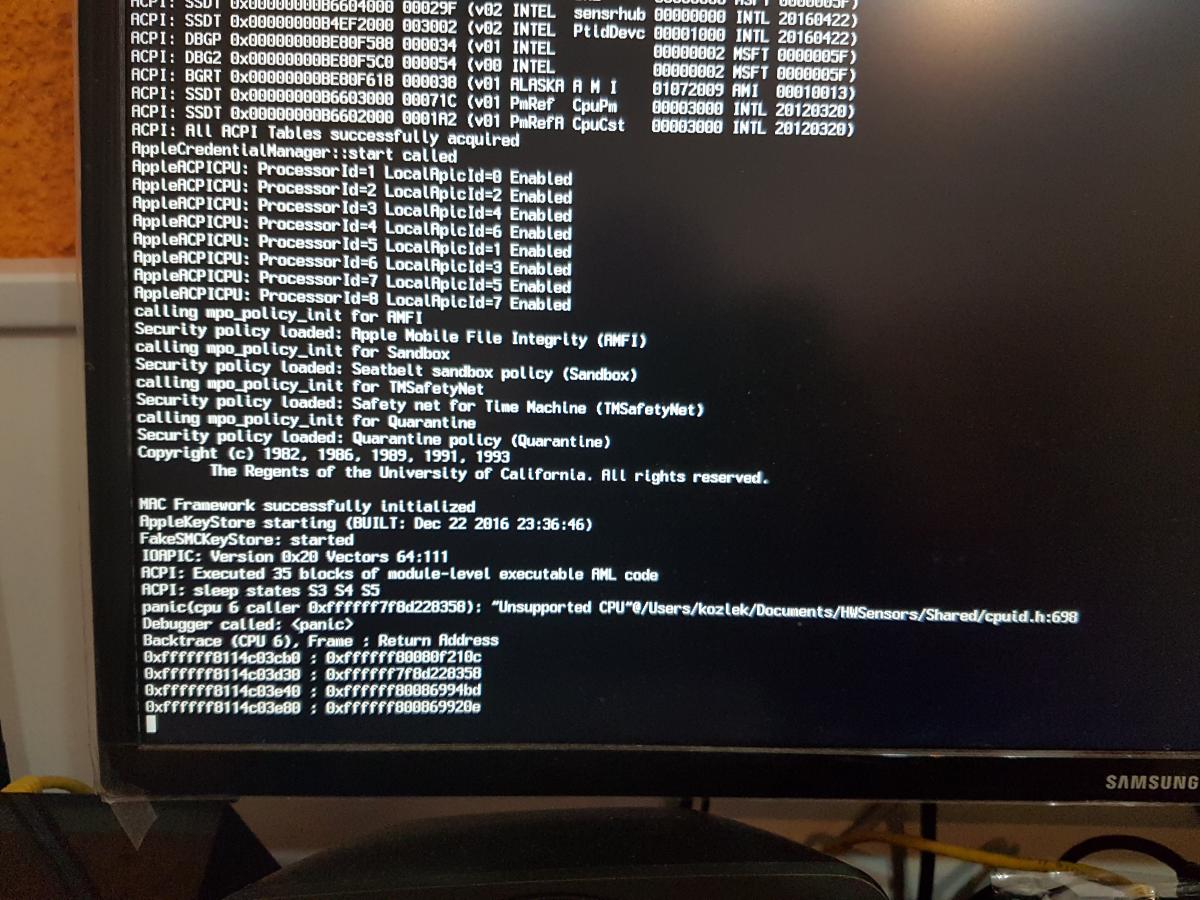

cobra118 Posted March 10, 2017 Author Share Posted March 10, 2017 Si ho installo l'ultimo bios f5 della casa madre Provo a mettere clover postato su Nulla si blocca qui Link to comment https://www.insanelymac.com/forum/topic/321561-nuova-installazione-su-z270/#findComment-2381805 Share on other sites More sharing options...
