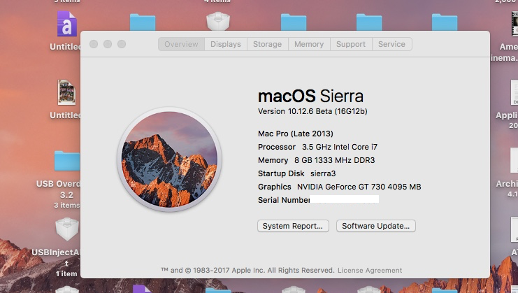

ndungu6678 Posted June 1, 2017 Share Posted June 1, 2017 GT 730 ZOTAC working fine here-full VRAM 4GB and full acceleration: Link to comment https://www.insanelymac.com/forum/topic/321449-geforce-gt730-2-gb-ddr3-only-1024-detect/#findComment-2433755 Share on other sites More sharing options...
