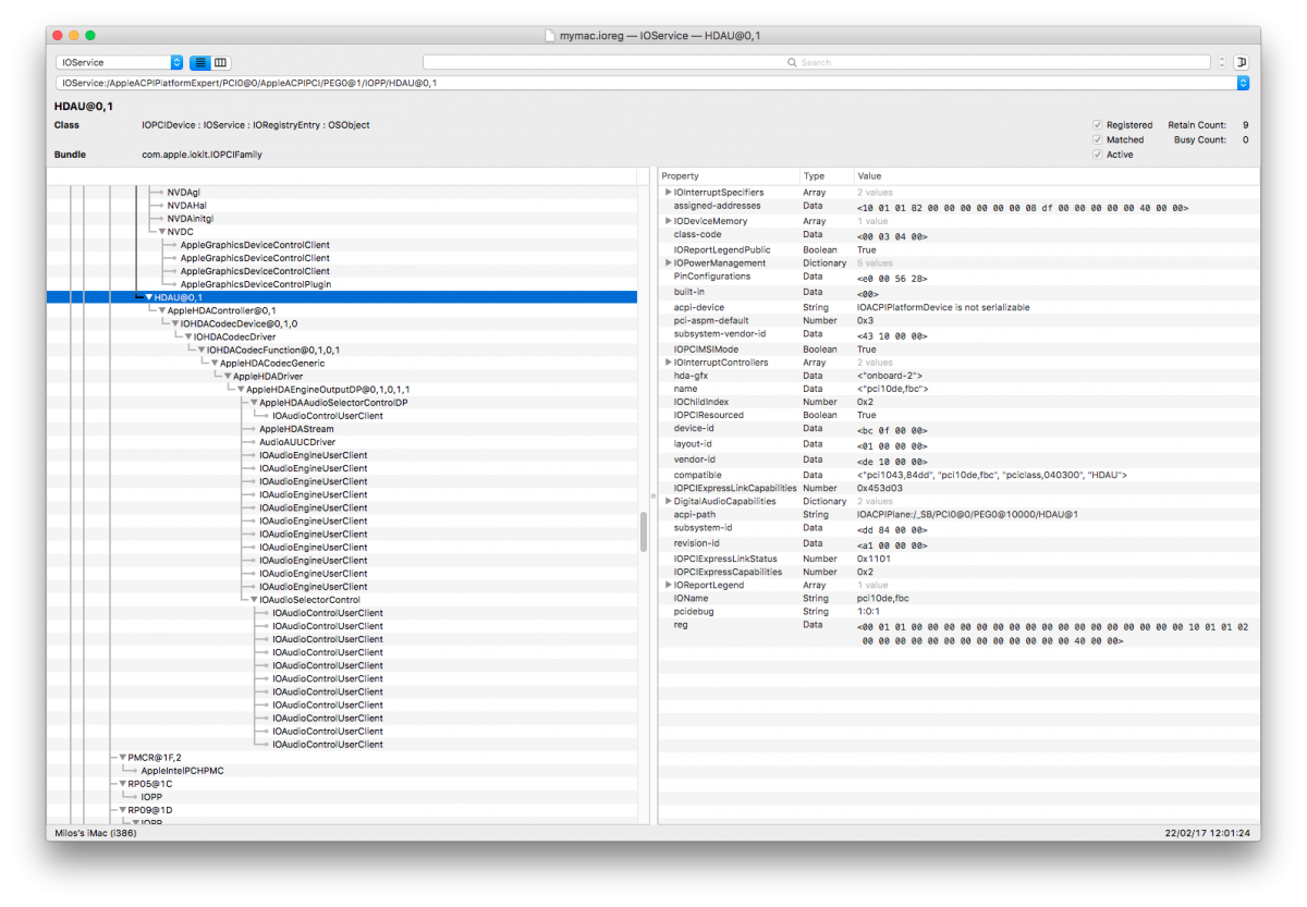

mirochan Posted February 22, 2017 Author Share Posted February 22, 2017 Thanks! No changes at the wake, HDMI audio also still not playing. I attached the new IOreg! mymac.zip 1 Link to comment https://www.insanelymac.com/forum/topic/321348-reboot-at-wake-power-management-general-optimization-asrock-h110m/#findComment-2371304 Share on other sites More sharing options...
MaLd0n Posted February 22, 2017 Share Posted February 22, 2017 u try a fresh instal and use new files? HDMI appear in ioreg, go to sound and check try it with correct pmbase DSDT.PMBASE.zip u can try a fresh install? 1 Link to comment https://www.insanelymac.com/forum/topic/321348-reboot-at-wake-power-management-general-optimization-asrock-h110m/#findComment-2371308 Share on other sites More sharing options...
mirochan Posted February 23, 2017 Author Share Posted February 23, 2017 Didn't help unfortunately. The HDMI audio is appearing in the settings but no sound is coming out. Maybe I should just rerun toledas script? I also didn't use the olarila command, should I do that every time I update the CLOVER folder? I attached the updated ioreg! Thanks again for trying to solve this! A fresh install I would definitely try but would need to push it off til I finished my current project. I'm running a SSD with a Windows partition and a Sierra partition. If I'd reinstall, can I keep CLOVER as it is in my EFI partition and just install OS X again or would I need to delete CLOVER from my EFI partition and reinstall it from the USB stick following your guide? 1 Link to comment https://www.insanelymac.com/forum/topic/321348-reboot-at-wake-power-management-general-optimization-asrock-h110m/#findComment-2371752 Share on other sites More sharing options...
MaLd0n Posted February 23, 2017 Share Posted February 23, 2017 ReRun script again. after ur current project, try a fresh install, clean hd with disk utility and install again the DSDT have all patches u need, HDMI in ssdt and power management too. 1 Link to comment https://www.insanelymac.com/forum/topic/321348-reboot-at-wake-power-management-general-optimization-asrock-h110m/#findComment-2371758 Share on other sites More sharing options...

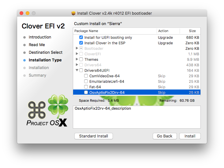

MaLd0n Posted March 2, 2017 Share Posted March 2, 2017 use clover 4003, uncheck all patches in acpi section and use nv_disdable=1 use OsxAptioFixDrv-64.efi 1 Link to comment https://www.insanelymac.com/forum/topic/321348-reboot-at-wake-power-management-general-optimization-asrock-h110m/#findComment-2376390 Share on other sites More sharing options...
mirochan Posted March 2, 2017 Author Share Posted March 2, 2017 Thanks, that worked! When I will install it on the HDD, should I use the same settings? Link to comment https://www.insanelymac.com/forum/topic/321348-reboot-at-wake-power-management-general-optimization-asrock-h110m/#findComment-2376458 Share on other sites More sharing options...
MaLd0n Posted March 2, 2017 Share Posted March 2, 2017 ofc use clover UEFI mode, OsxAptioFixDrv-64.efi replace folder, add ur hdmi audio again use clover 4003 1 Link to comment https://www.insanelymac.com/forum/topic/321348-reboot-at-wake-power-management-general-optimization-asrock-h110m/#findComment-2376515 Share on other sites More sharing options...

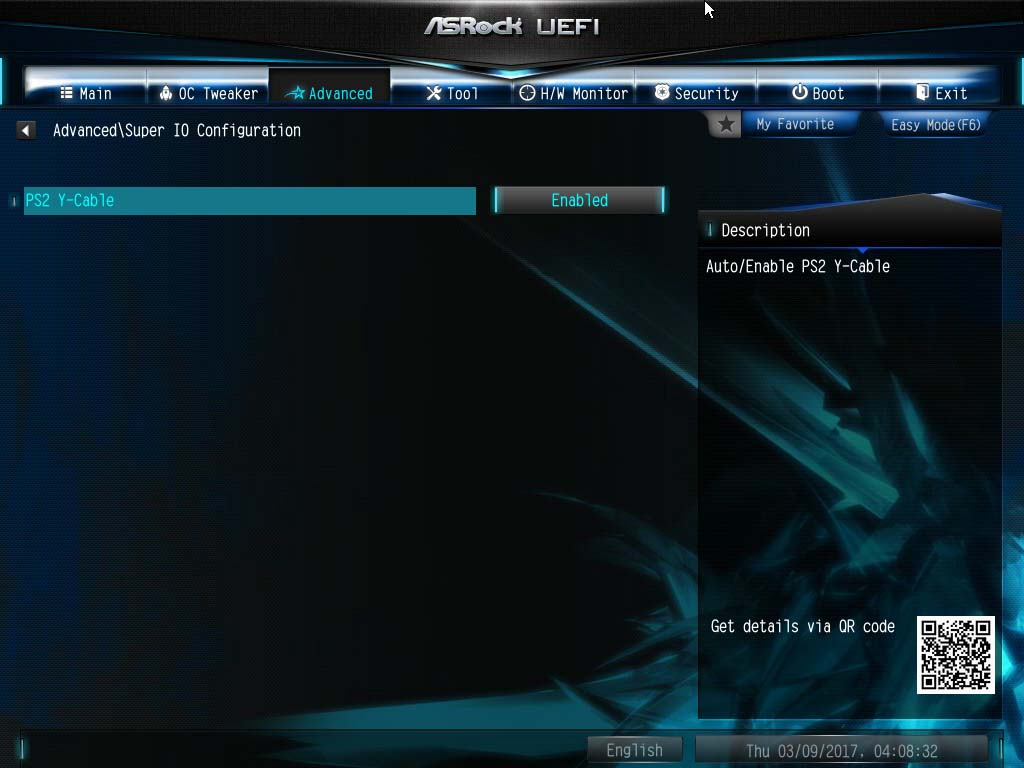

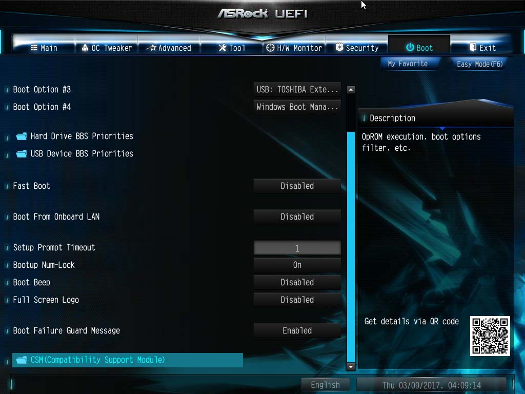

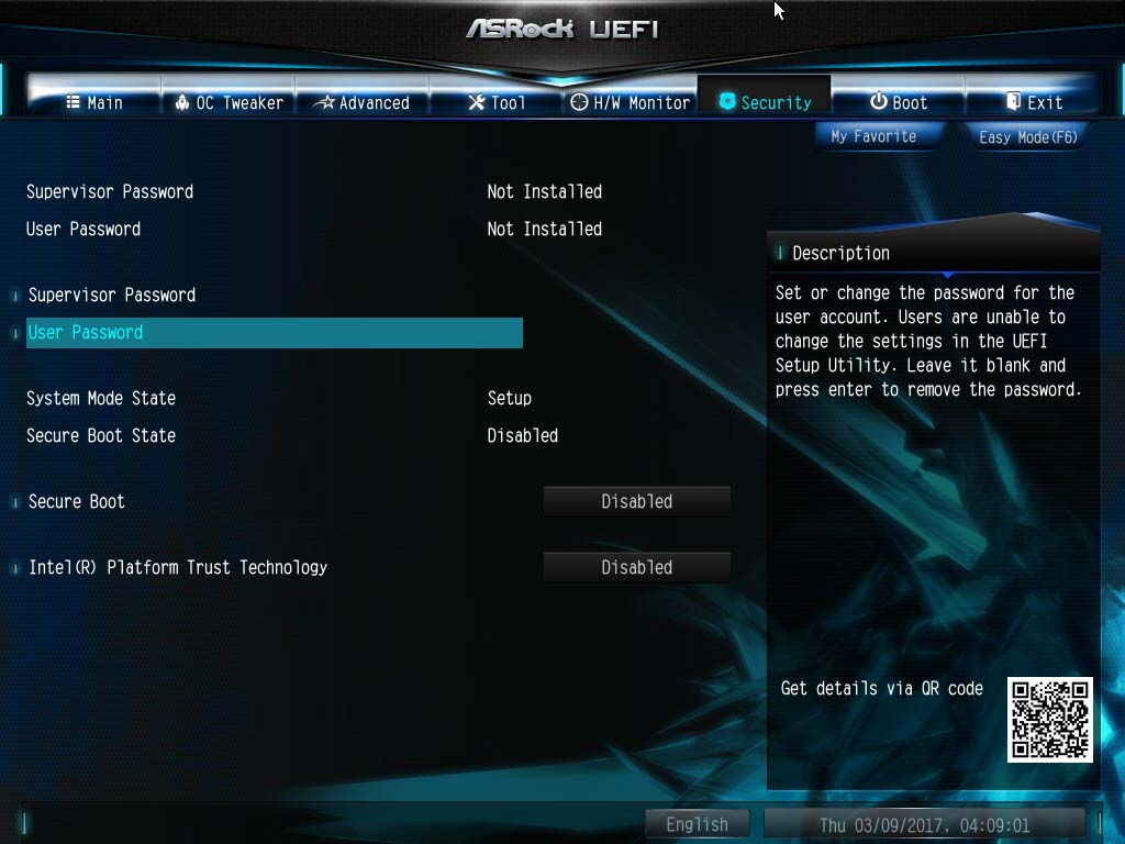

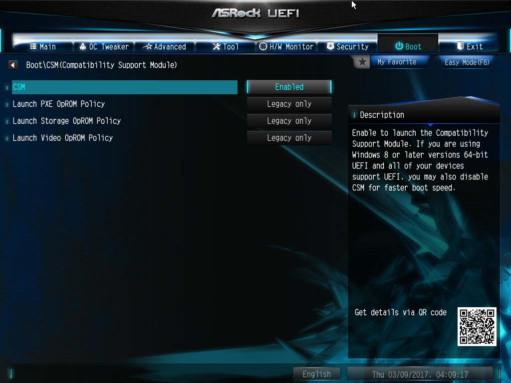

MaLd0n Posted March 8, 2017 Share Posted March 8, 2017 ur bios have option USB third party? btw Pulse led work in sleep? 1 Link to comment https://www.insanelymac.com/forum/topic/321348-reboot-at-wake-power-management-general-optimization-asrock-h110m/#findComment-2380637 Share on other sites More sharing options...

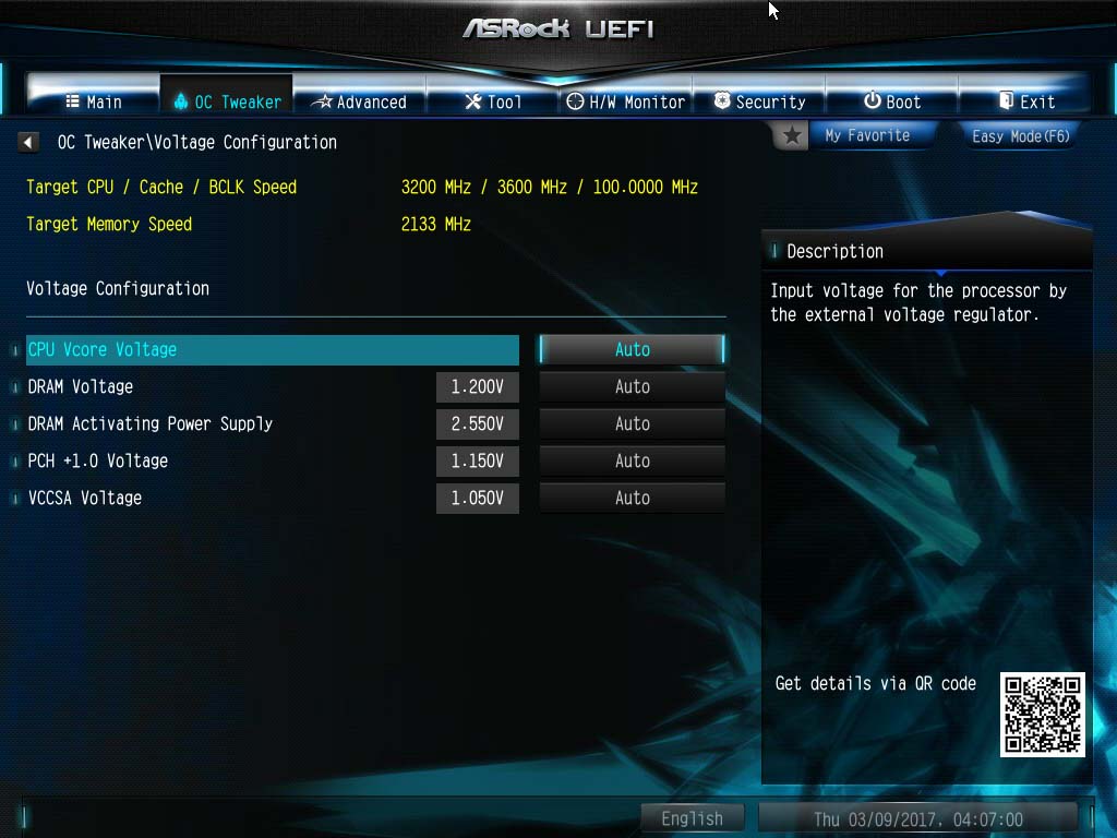

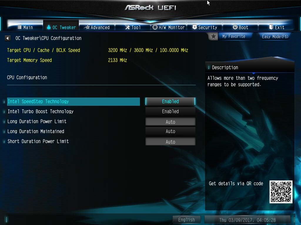

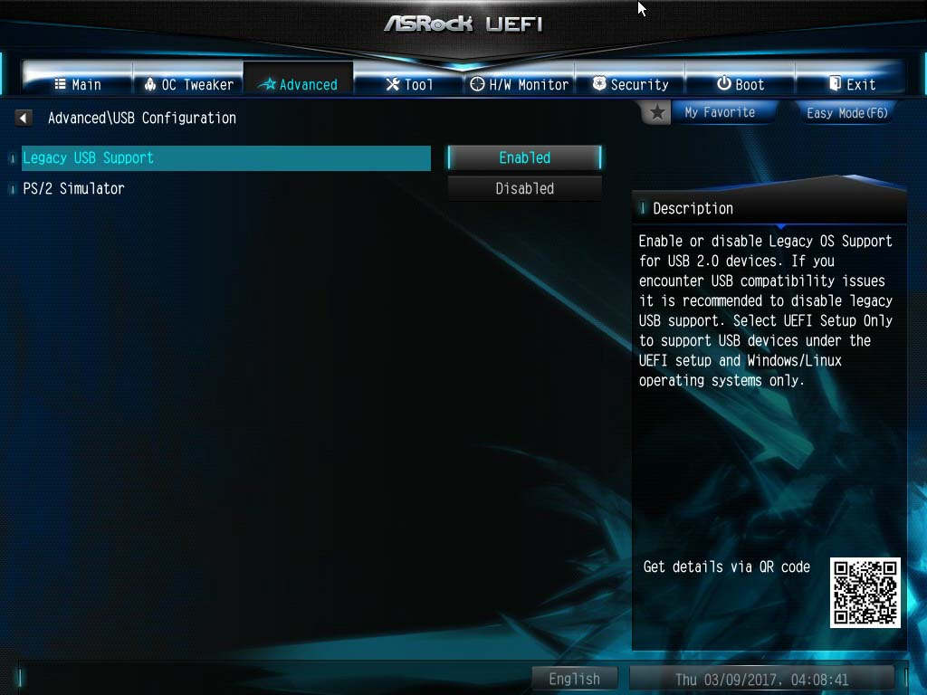

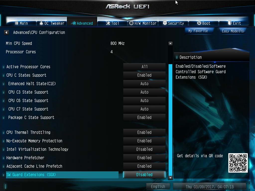

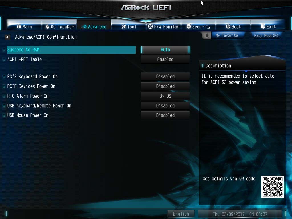

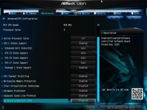

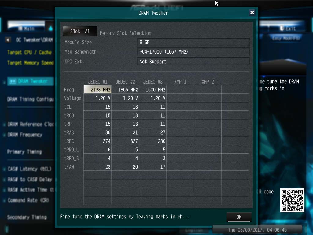

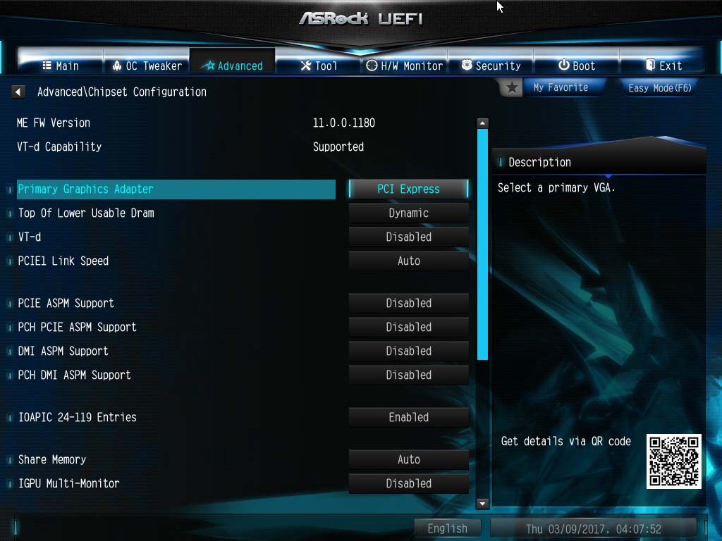

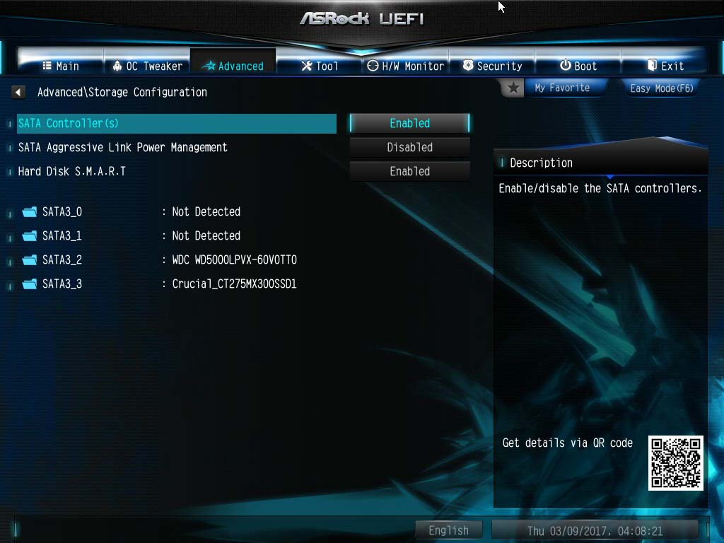

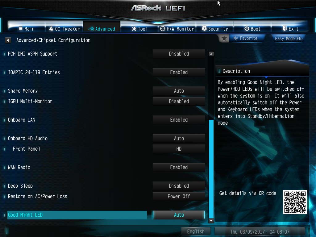

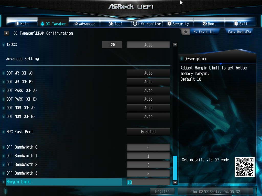

mirochan Posted March 9, 2017 Author Share Posted March 9, 2017 Pulse led is working and actually pulsing, when Windows 10 sets the computer to sleep, it's just blinking. I just have a legacy option. I attached screenshots from my BIOS settings. Thanks! 1 Link to comment https://www.insanelymac.com/forum/topic/321348-reboot-at-wake-power-management-general-optimization-asrock-h110m/#findComment-2380920 Share on other sites More sharing options...
MaLd0n Posted March 9, 2017 Share Posted March 9, 2017 u can try two options? 1 Link to comment https://www.insanelymac.com/forum/topic/321348-reboot-at-wake-power-management-general-optimization-asrock-h110m/#findComment-2380928 Share on other sites More sharing options...

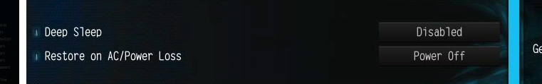

mirochan Posted March 9, 2017 Author Share Posted March 9, 2017 I just tried Deep Sleep - enabled in C5 State and - enabled in C4-C5 State with Power On under Restore on AC/Power Loss, no luck The BIOS version is 1.30, I saw that on ASRock website they offer version 7, should I maybe update? 1 Link to comment https://www.insanelymac.com/forum/topic/321348-reboot-at-wake-power-management-general-optimization-asrock-h110m/#findComment-2380946 Share on other sites More sharing options...
MaLd0n Posted March 9, 2017 Share Posted March 9, 2017 ofc u need update bios, after update, extract new dsdt with f4 in clover boot screen and send me, i edit again send me new ioreg too remove DSDT before update 1 Link to comment https://www.insanelymac.com/forum/topic/321348-reboot-at-wake-power-management-general-optimization-asrock-h110m/#findComment-2380950 Share on other sites More sharing options...
