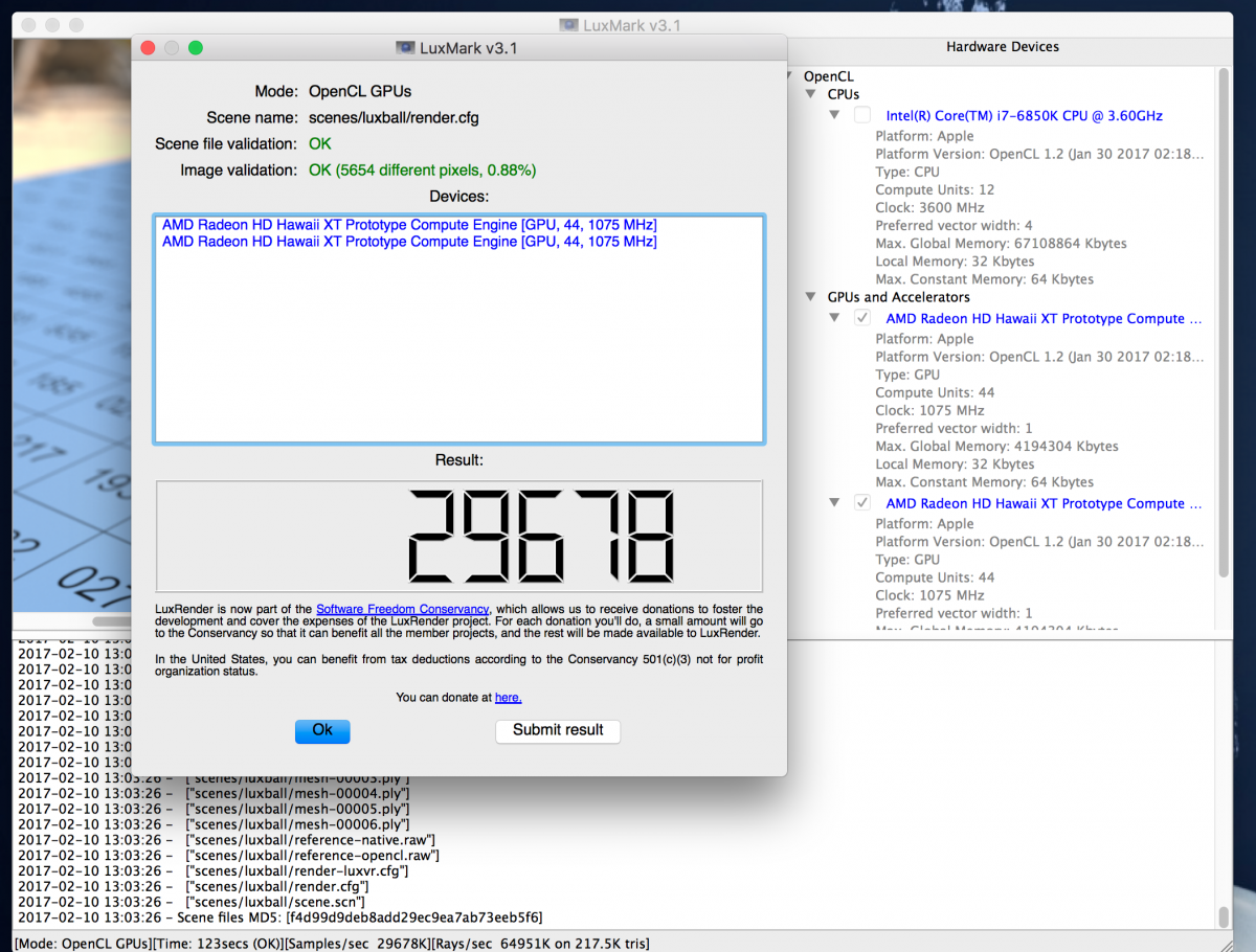

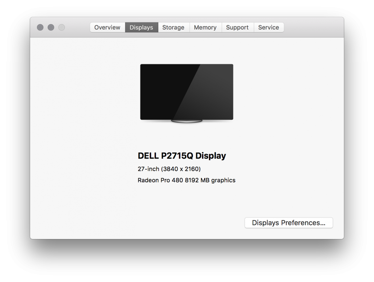

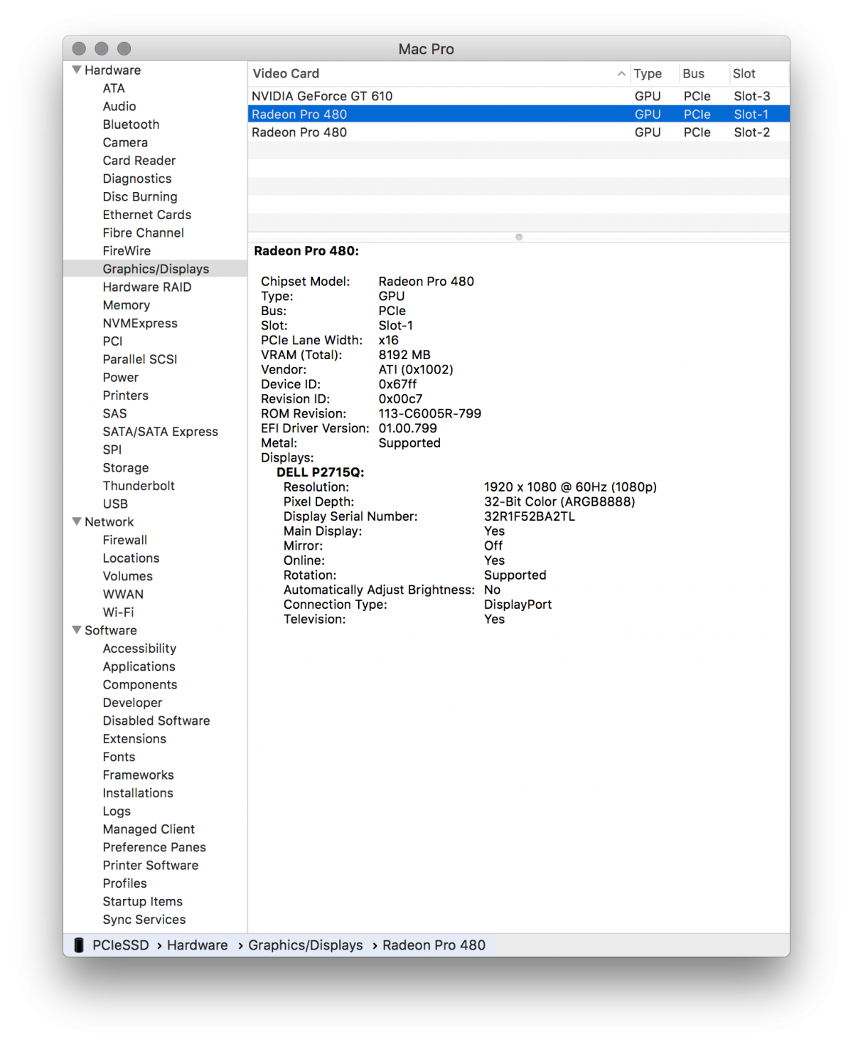

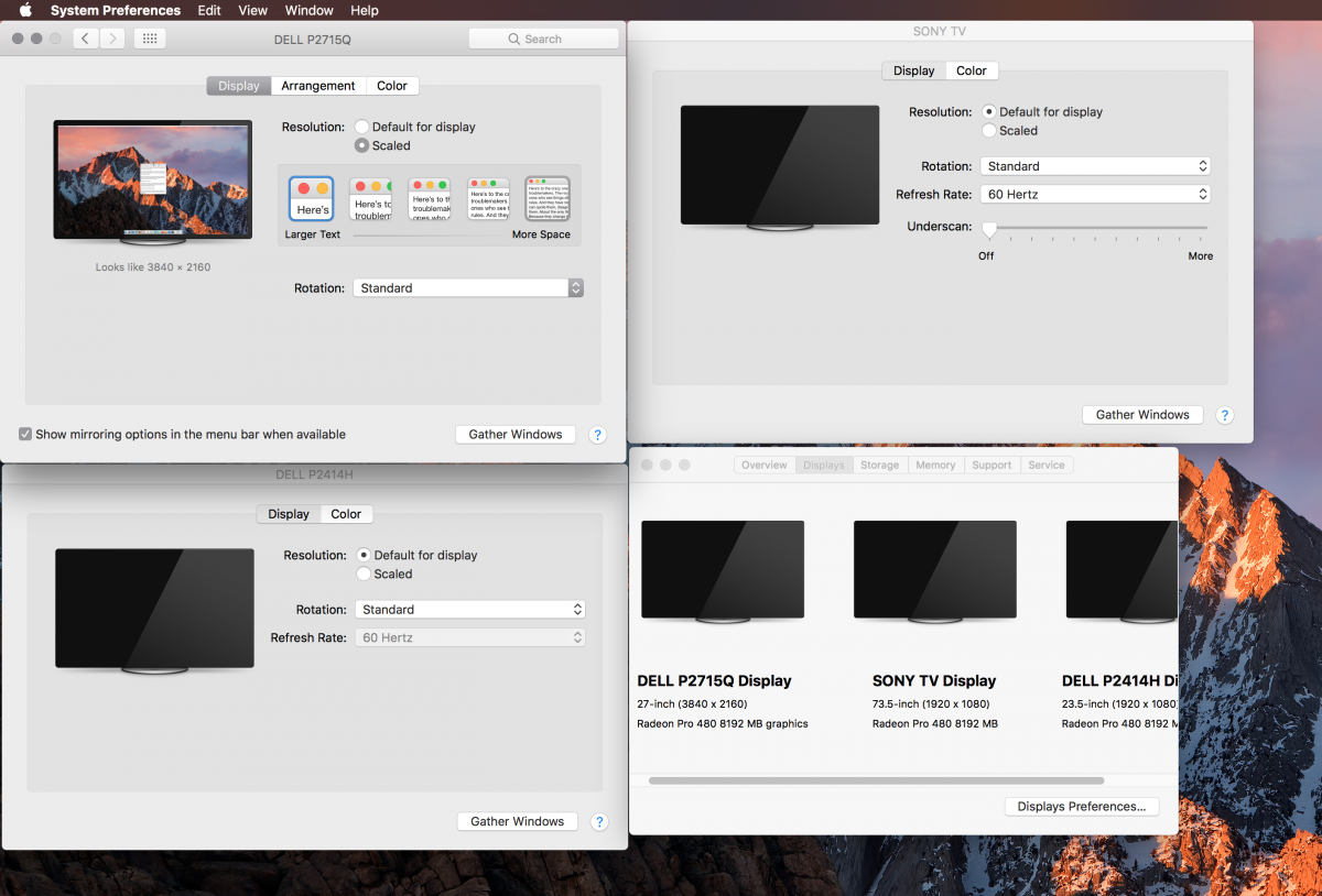

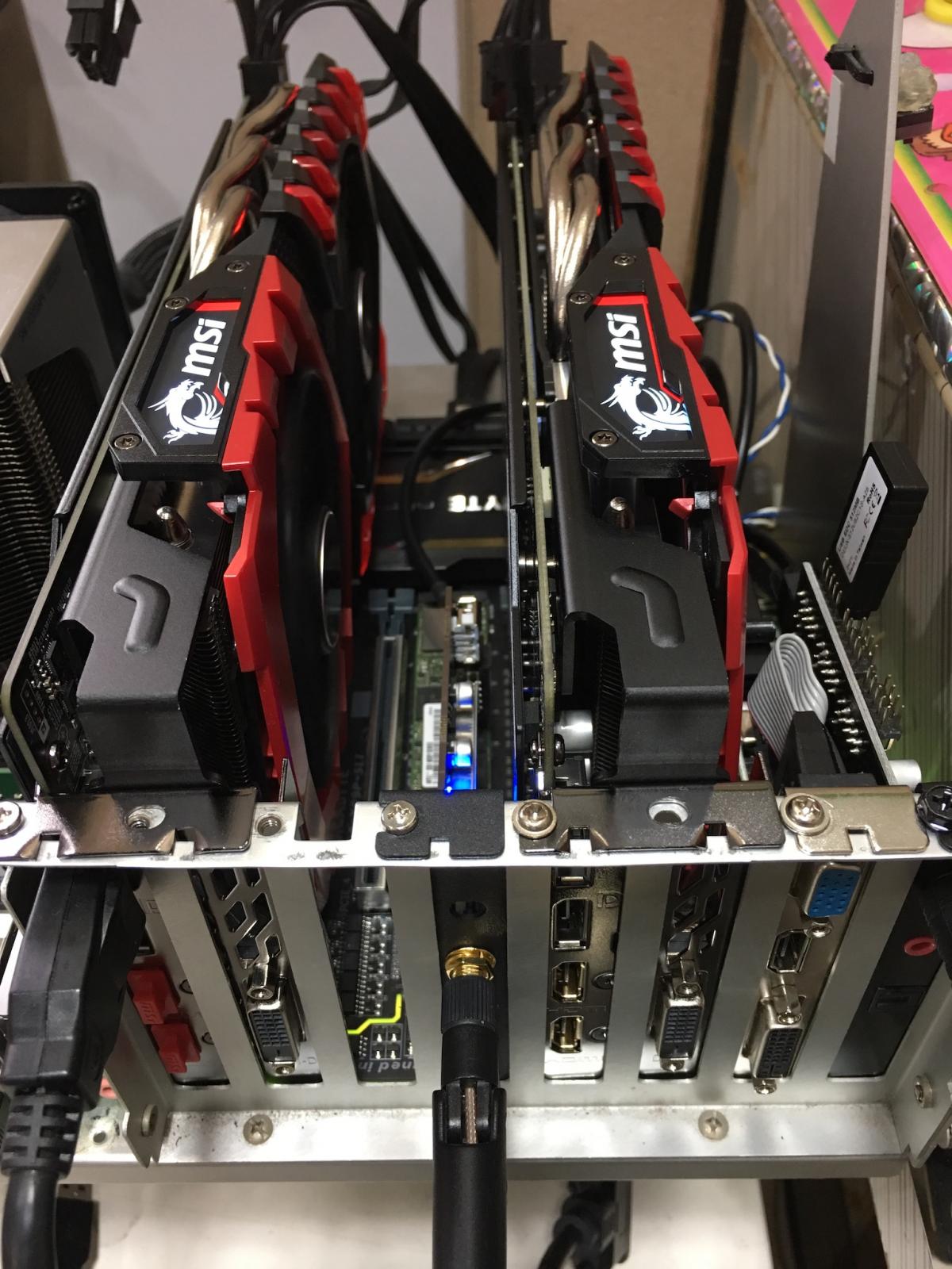

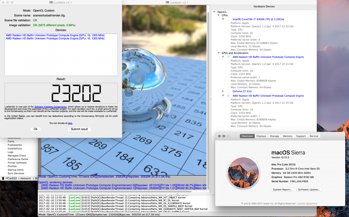

Ascent Yeh Posted February 10, 2017 Share Posted February 10, 2017 Hi I have use little trick let macOS Sierra run 2x AMD Radeon RX 480 GPU. Just see the result. Let NVIDIA GT 610 first display GUI OpenCL Score drop a little. About this mac 4K Display and RX 480 Trick mode 3 display output. 1 Link to comment https://www.insanelymac.com/forum/topic/321029-x99p-sli-with-2x-amd-radeon-rx-480-on-sierra/ Share on other sites More sharing options...
okrasit Posted February 10, 2017 Share Posted February 10, 2017 You'll have to apply a patch to get it running with 36 compute units. It's also possible to run it without the gt610! 2 Link to comment https://www.insanelymac.com/forum/topic/321029-x99p-sli-with-2x-amd-radeon-rx-480-on-sierra/#findComment-2365802 Share on other sites More sharing options...
ekwipt Posted February 10, 2017 Share Posted February 10, 2017 I don't think it's possible without the helper card... well I haven't seen it yet @okrasit Link to comment https://www.insanelymac.com/forum/topic/321029-x99p-sli-with-2x-amd-radeon-rx-480-on-sierra/#findComment-2365833 Share on other sites More sharing options...
Matthew82 Posted February 10, 2017 Share Posted February 10, 2017 I don't think it's possible without the helper card... well I haven't seen it yet @okrasit It is possible... Link to comment https://www.insanelymac.com/forum/topic/321029-x99p-sli-with-2x-amd-radeon-rx-480-on-sierra/#findComment-2365857 Share on other sites More sharing options...

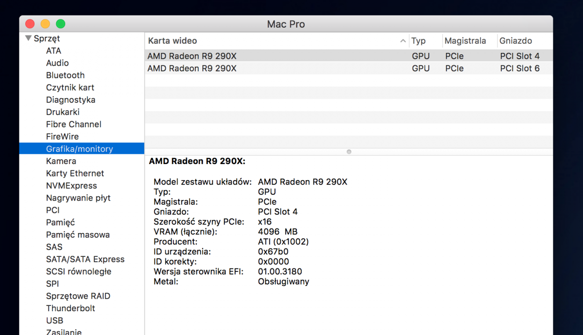

Ascent Yeh Posted February 12, 2017 Author Share Posted February 12, 2017 @Matthew82 R9 290X can without helper card. New RX4x0 can't without helper card. Link to comment https://www.insanelymac.com/forum/topic/321029-x99p-sli-with-2x-amd-radeon-rx-480-on-sierra/#findComment-2366811 Share on other sites More sharing options...
okrasit Posted February 12, 2017 Share Posted February 12, 2017 @Matthew82 R9 290X can without helper card. New RX4x0 can't without helper card. Actually, you can. 1 Link to comment https://www.insanelymac.com/forum/topic/321029-x99p-sli-with-2x-amd-radeon-rx-480-on-sierra/#findComment-2366832 Share on other sites More sharing options...

okrasit Posted May 19, 2017 Share Posted May 19, 2017 Stop the mobo's bios from loading the gpu vbios on boot -> edit the vbios to have invalid device ids. The downside is, you'll have no bootscreen. Link to comment https://www.insanelymac.com/forum/topic/321029-x99p-sli-with-2x-amd-radeon-rx-480-on-sierra/#findComment-2427465 Share on other sites More sharing options...
modzilla Posted May 19, 2017 Share Posted May 19, 2017 Okay and when u've changed the IDs, Inject the right ones with FakePCIID's or how? Gesendet von meinem ONEPLUS A3003 mit Tapatalk Link to comment https://www.insanelymac.com/forum/topic/321029-x99p-sli-with-2x-amd-radeon-rx-480-on-sierra/#findComment-2427534 Share on other sites More sharing options...
