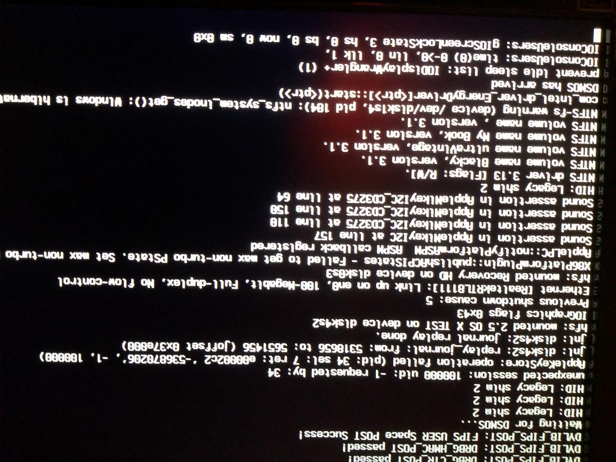

pduke Posted February 16, 2017 Author Share Posted February 16, 2017 you rock!!!! incredible progress.!!!! you solved "waiting for root device" after 6 months!!!! listing facts 1. i copied your clover folder to my sierra USB 2. managed to boot to my Yosemite clover installation with 16 cores (just testing, no actual use) 3. tried to boot SIERRA from installation partition and from the USB but i got "reason mac-f4238cc8" 4. started improvising.... so i returned to my old clover folder and i copied from yours the patched DSDT, the kext folder (10.12) and the boot flags from your plist 5. SIERRA loaded, installed and restarted (with XFX 280x on 6. loading from SIERRA hdd failed again and again with all bootlegs with message : AppleLPC::notifyPlatformASPM ASPM callback registered 7. figured that this should be the XFX so i switched back to the 9600 GT(funny thing is that working with this non UEFI card i have to imagine what is happening at the bios cause i have no picture until the OS boots up) 8. SIERRA loaded and finished install!!!!!!!! working ok now with sound and network and .... here i am at the very familiar land of "and-now-what?" a. should i first try the XFX? i got plenty of roms from ASUS cards but clover does not "see" them b. shall i try to install clover to the SIERRA hdd, stabilise that and go o to the GPU? any suggestions for this one? any guides? i already tried "b" failing badly. rebooted and went back to "waiting for root device" ..... any further help would be incredible but i already feel great and ready to dive into testing once more thanks a million my friend!!-Not to look a gift horse in the mouth, i still would really like to know what you have done, if you have the time. not knowing what this help was about didn't give me any knowledge 1 Link to comment https://www.insanelymac.com/forum/topic/320955-x79-usbs-dead-on-boot-xfx-vbios-wont-load/#findComment-2368967 Share on other sites More sharing options...

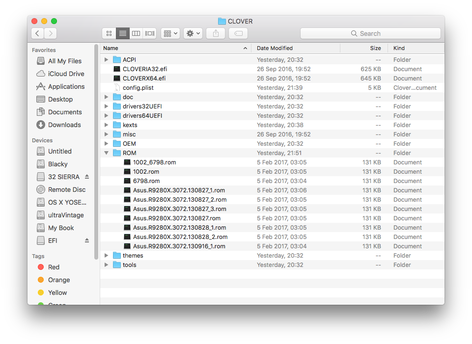

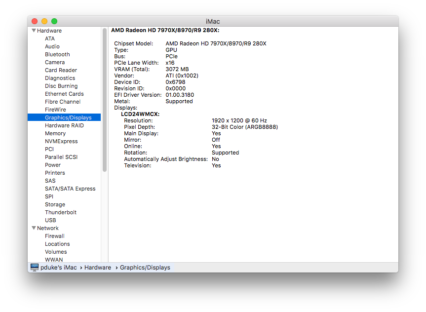

pduke Posted February 16, 2017 Author Share Posted February 16, 2017 ------UPDATE------------ XFX R9 280X black edition is working !!!! I have placed a bunch of roms like you see in the picture. just testing. in clover I ticked Inject ATI and Load Vbios and BOOM!!! it is working! the question is..... what made it work??? the rom, the ATI inject or both? --------UPDATE 2 ------the answer is BOTH. and the rom I used is this https://www.techpowerup.com/vgabios/149989/asus-r9280x-3072-130827-1 second DVI is not working. I can dual monitor with DVI and HDMI got much testing to do.my major problem is that my motherboard do not see Mac HDDs as bootable. it ignores them. USB is the only solution for now 1 Link to comment https://www.insanelymac.com/forum/topic/320955-x79-usbs-dead-on-boot-xfx-vbios-wont-load/#findComment-2369018 Share on other sites More sharing options...

pduke Posted February 17, 2017 Author Share Posted February 17, 2017 ok attached Clover from USB and saved file from ioreg I bought a SSD and installed clean SIERRA (I can't believe how easy is to install SIERRA after your help - THANKS AGAIN MAN!!!) it boots with the USB just fine every time I used EFI to install latest clover with your suggested settings at the SSD. NOTHING. my mobo does not read the SSD as bootable. not in the bios, not even in the boot menu after pressing F12. it is like that for ALL drives except windows ones. I really can't understand. Probably because it is a Lenovo...... CLOVER copy.zip pduke’s iMac.zip 1 Link to comment https://www.insanelymac.com/forum/topic/320955-x79-usbs-dead-on-boot-xfx-vbios-wont-load/#findComment-2369364 Share on other sites More sharing options...

pduke Posted February 18, 2017 Author Share Posted February 18, 2017 I tried it on my SSD but mobo does no see it as bootable.... as always when I use it on the USB I get the following screen... so I kinda lost you here. how do I use this folder? what are the correct post installation steps for Sierra? for example I copied FakeSMC.kext in l/e and I got a "waiting for root device" ...... again 1 Link to comment https://www.insanelymac.com/forum/topic/320955-x79-usbs-dead-on-boot-xfx-vbios-wont-load/#findComment-2369445 Share on other sites More sharing options...

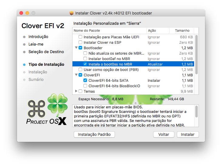

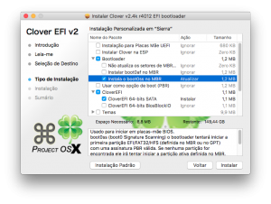

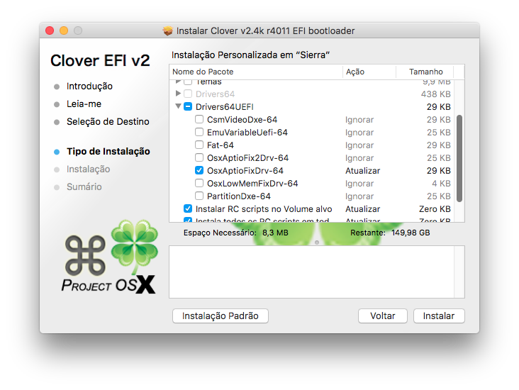

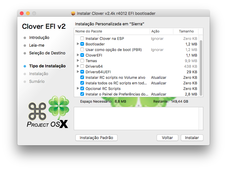

MaLd0n Posted February 18, 2017 Share Posted February 18, 2017 first, disconnect all hds, only mac osx hd connect dont copy any kext, use all kexts in Clover/Kexts/10.12 only voodoohda in s/l/e if u need install lat clover version Clover_v2.4k_r4012.pkg.zip thx Slice try with config after replace folder CLOVER.zip 1 Link to comment https://www.insanelymac.com/forum/topic/320955-x79-usbs-dead-on-boot-xfx-vbios-wont-load/#findComment-2369469 Share on other sites More sharing options...
pduke Posted February 18, 2017 Author Share Posted February 18, 2017 no nothing. I installed clover again with above settings, disconnected all drives, cleared CMOS but still I get this annoying Lenovo message: ERROR CODE 1962 - NO OPERATING SYSTEM FOUND I don't know if it has anything to do with it but when booting with USB:1. in every boot the desktop background always returns to original Sierra 2. CPU runs without turbo (Geekbench 4 reaches ~14500 while in windows ~16500 - Cinebnech 850Mac 1100windows )3. GPU reaches hardly half FPS (cinebench 42fps Mac - 95fps windows) I have a zalman fan controller with watt display and I can see even in stress Mac hardly uses 175 Watt while windows can reach up to 350W. I think I am going off topic though... shall I mark this solved and move to "Post installation Sierra". ?? Link to comment https://www.insanelymac.com/forum/topic/320955-x79-usbs-dead-on-boot-xfx-vbios-wont-load/#findComment-2369619 Share on other sites More sharing options...
